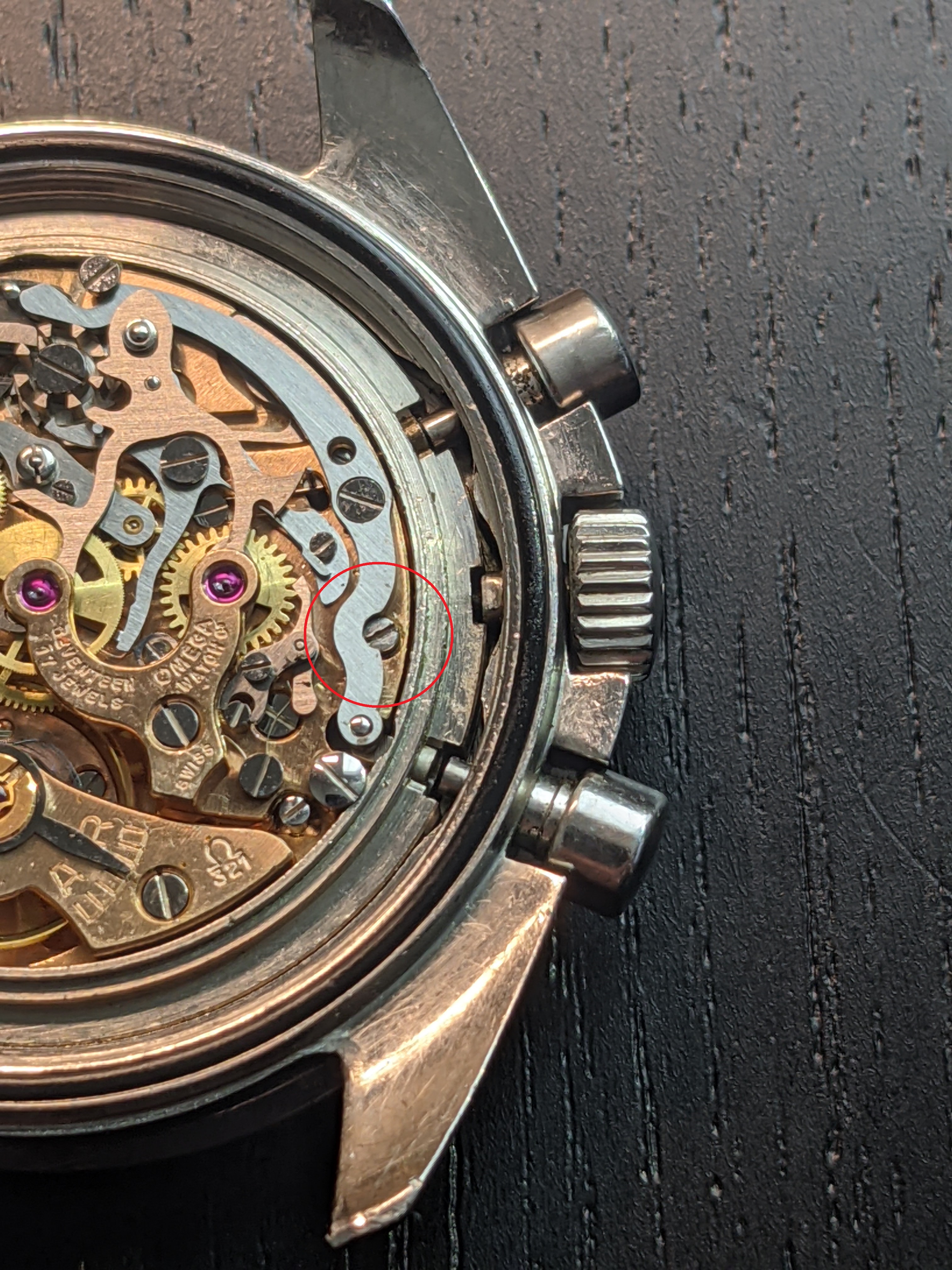

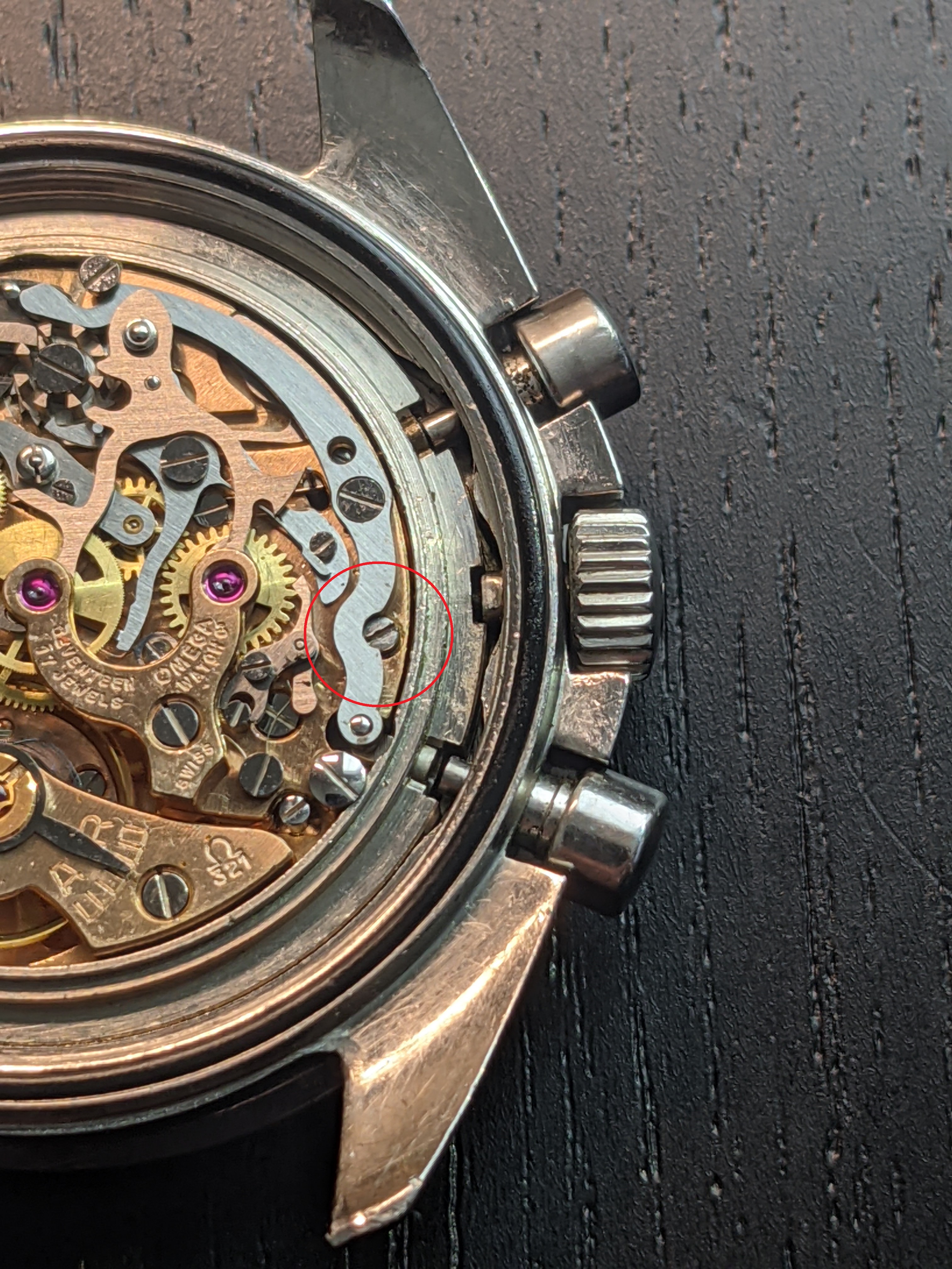

After pushing the crown stem back in place on my older Speedie, the screw holding the crown stem no longer tightens and appears to be sitting too high. And if course, if I can't secure the stem I cannot wind up the spring or adjust the time!
Help please!! Is this just an issue with the screw not sitting/mating properly or is it to do with the gears? Perhaps someone can anyone share how the gear mechanism inside works?

My guess is that you鈥檝e loosened it too far which will now require reassembly. Hope I鈥檓 wrong 馃憥
456
1,040
Oh boy! It needs a full service so during the process of rebuilding the movement I'm guessing that would be fixed (i.e. I've not broken anything?).
15,995
48,111
You鈥檝e not broken anything? How can you be certain? It may be the detent screw has been loosened too far, the threaded tip unscrewing from the set lever (detent). Or it could be the threaded tip of the detent screw has broken off. Either way, you are in for a significant repair bill.

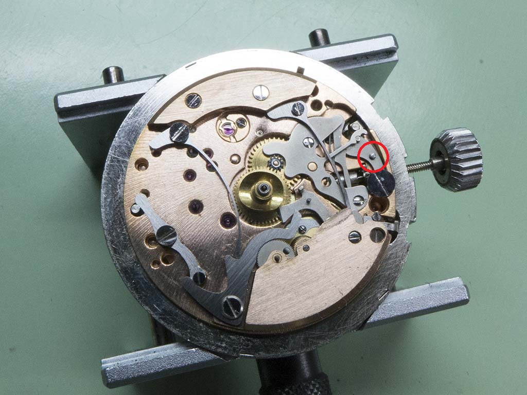

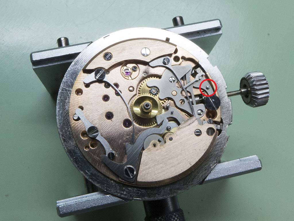

@Archer has already helped me just based upon his comments is that previous posts I looked through and now I'm understanding more on which screw has most likely been over-loosened from the image I found below. I'll ask my watchmaker to look at it tomorrow as I'll leave the hand/dial removal to the pros. I would be interested to see a movie or schematic of how the stem mechanism moves to set the time.

The mistake many make is not pressing down on the screw. The setting bridge arm which sits on the edge of the setting lever and acts like a little spring.
One should unscrew half a turn, press down on the screw and gently try to pull the crown and stem out. If it doesn't come out. 1/4 turn more and press down.
Most just keep unscrewing until the screw comes out of the setting lever. Might be able sometimes to screw it back in if you don't press too hard, but once you push the barrel of the lever out of its placement hole.
Have to remove the dial to get it back on
