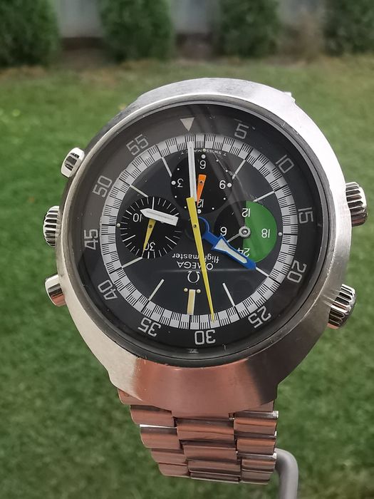

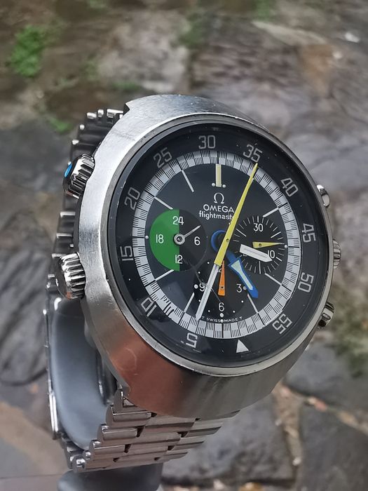

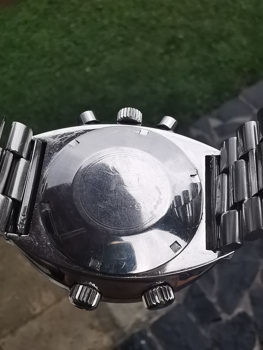

Hi

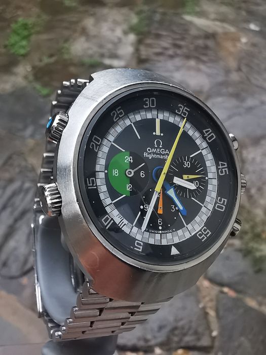

I intend to buy this watch from a local classified site. The seller make me an offer for 2500 Euro. Can you please let me know if it's a good example..please point me defects and advice if is a fair price. I notice that the glass has a scratch and the seller told me that the watch works perfectly..
Thank you and here are the pictures copied from the add.

Looks like an honest example. I do not follow recent prices, that's for you to evaluate.

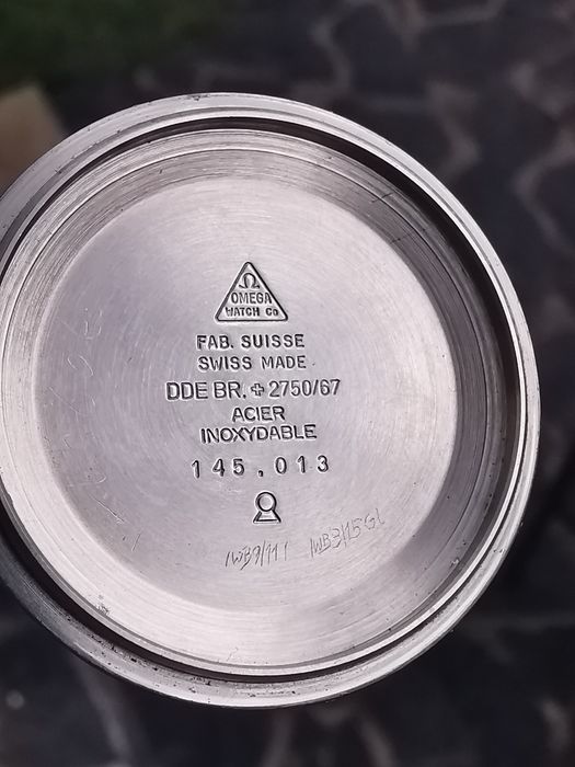

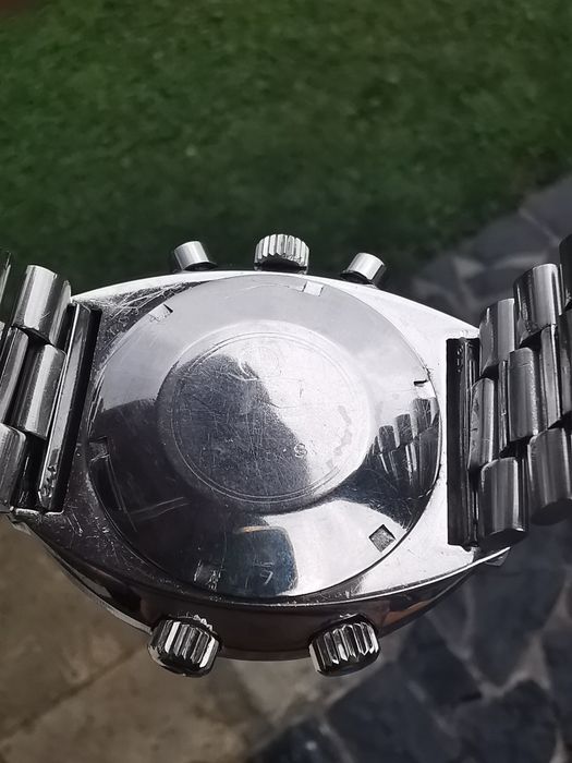

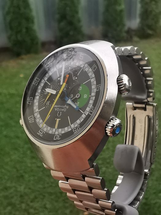

So the yellow subdial hand at 6 has been changed from the yellow to an orange one, but it does appear to be a genuine orange one. Otherwise it looks ok. Do your research and work out how the brushing on the case should look. The case edge looks sharp so I don't think it's has been polished, but bad polishing/brushing is the biggest issue with these.

Looks like a nice, honest example. Other than that sub-dial hand replacement, looks to be in very good condition. I think it is a fair price.
