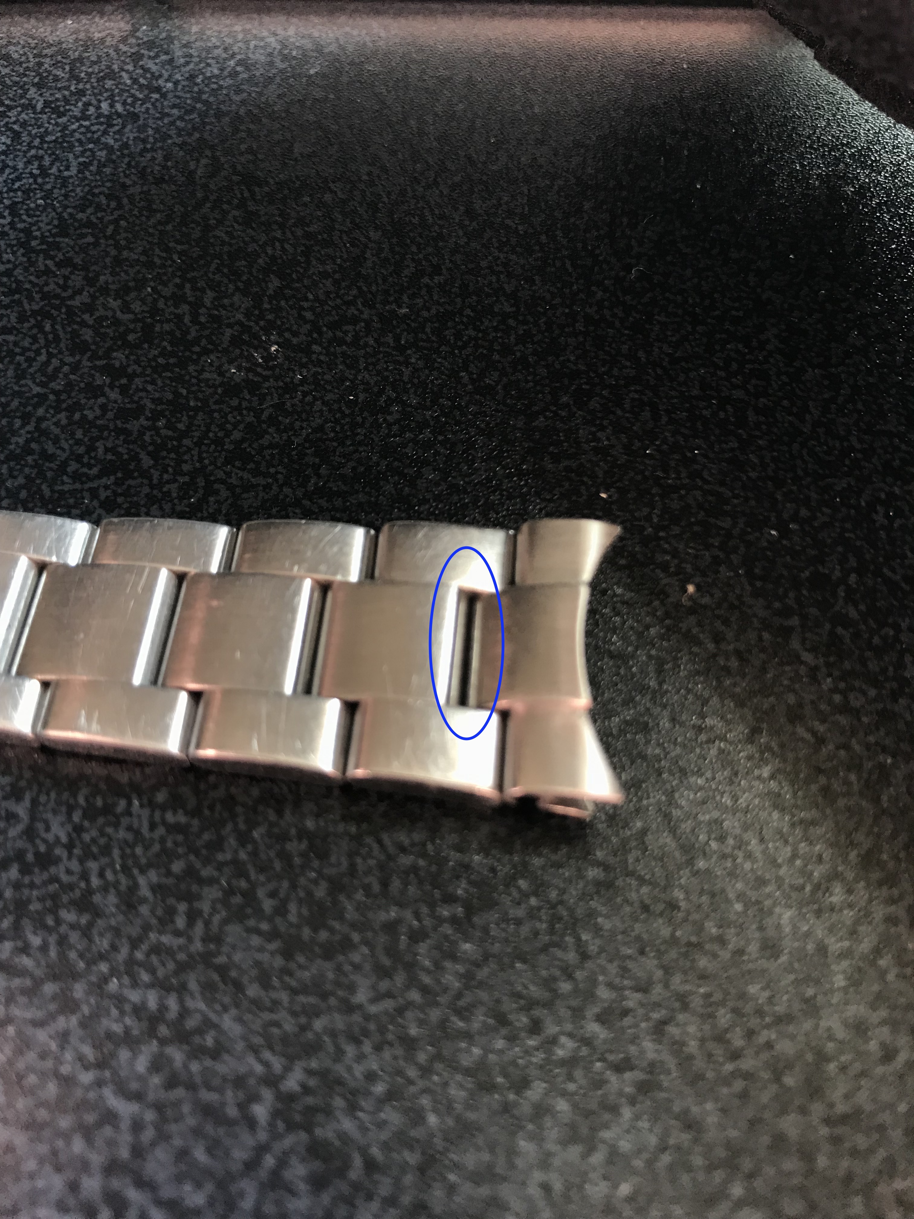

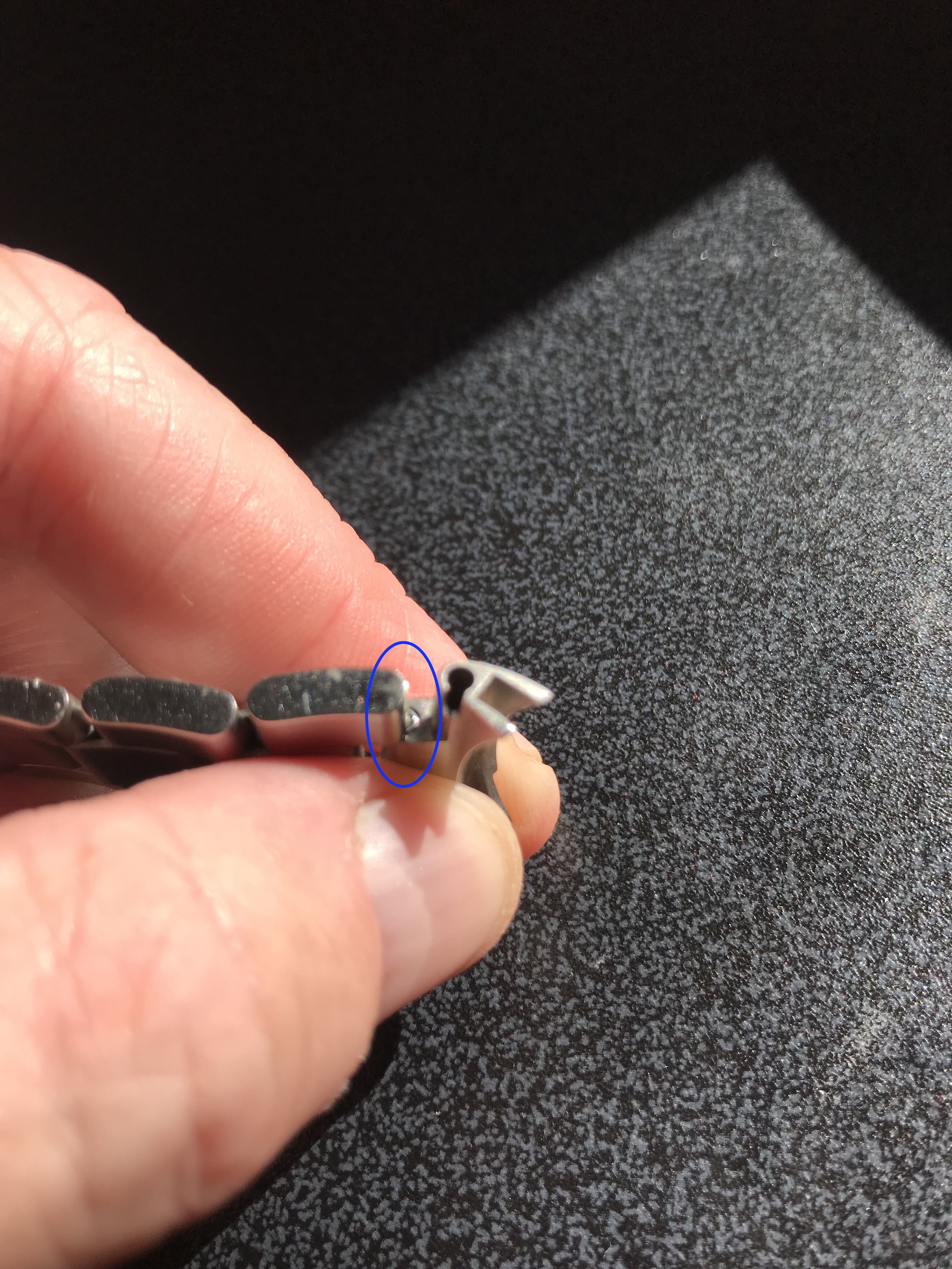

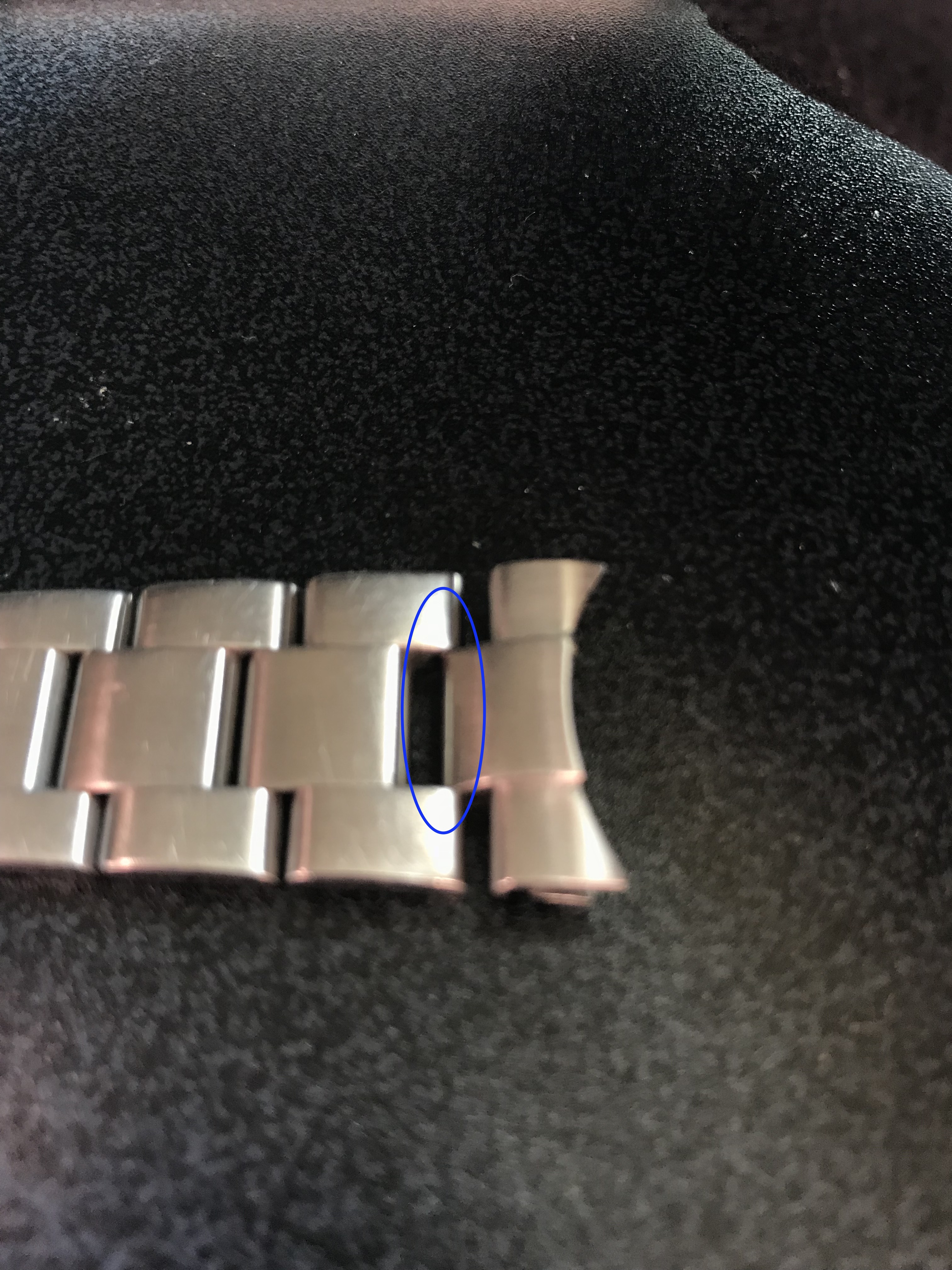

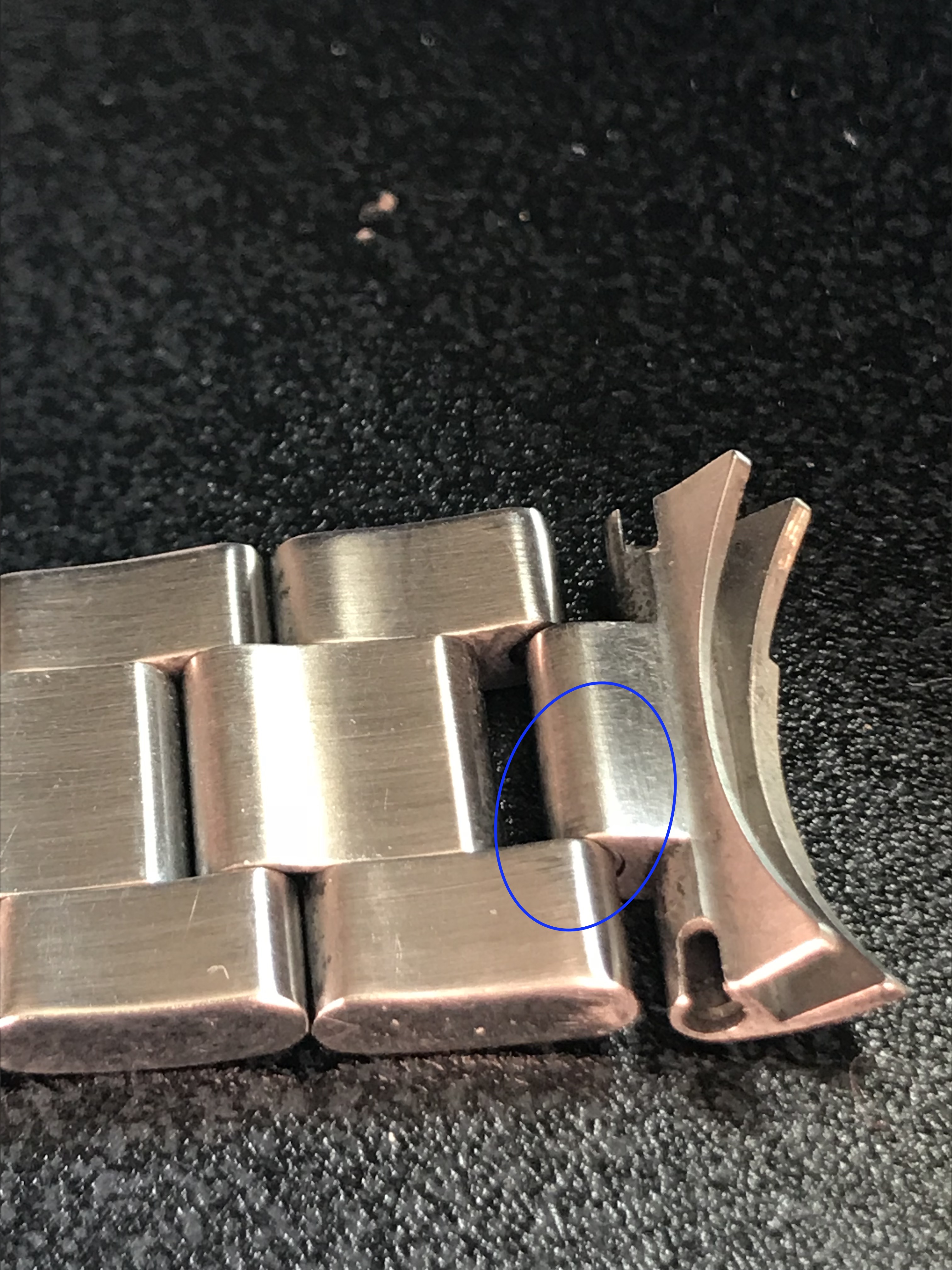

While shaving the other morning, I noticed in the mirror that there was a gap at the 12 o'clock side between the end link and the next "permanent" link. Upon examination, it seems that the pin in there has somehow got bent and there's now 2-3mm vertical "travel" between the two links. I have no idea how this happened, but I've just got it back from a "non-official" service centre where they were recalibrating the watch. I don't remember this gap being there before, but I can't be certain. Anyway. Here's a couple of pics..
So I take it to the AD and they take a look, get onto Rolex and get back to me saying no, it can't be repaired because it's a non-removable link. I'll have to buy a whole new bracelet, at a cost of £1010 😲 Now I don't know if they're just toeing the party line here, but I can't believe this can't be fixed. Does anyone know of a place in the UK who I could contact to ask? I've had a hunt around on the interweb and there are a couple of places who claim to be able to fix bracelets, but I thought I'd ask here first.

It's a "permanent" link. You can't just push the pin out..

Trust me…It’s worth it to have the original bracelet restored back to ‘factory condition’…and a damn sight cheaper, than a new one
The last thing you need, is the bracelet snapping,… and the Explorer bouncing down, the pavement
Michael Young’s work, is beyond excellent
Many people on this Forum can vouch for the quality of his work…I am sending a 1039 Omega to him, to have some springs replaced

He/his shop is recognized pretty universally as the best in the business of rehabbing vintage bracelets with no close peers.

Looking closely at your images, of the damaged bracelet…I would send it as soon as possible
It simply is not worth the risk…

Like I said, I'm in the UK. I've contacted Michael Young and had a look at his website, and the price is pretty reasonable.

Prices for basic restoration are reasonable but then the add on's...
Careful there. They may tell you you need a little laser welding, screws, etc.. And also be wary of the over polishing..
Just a heads up.
