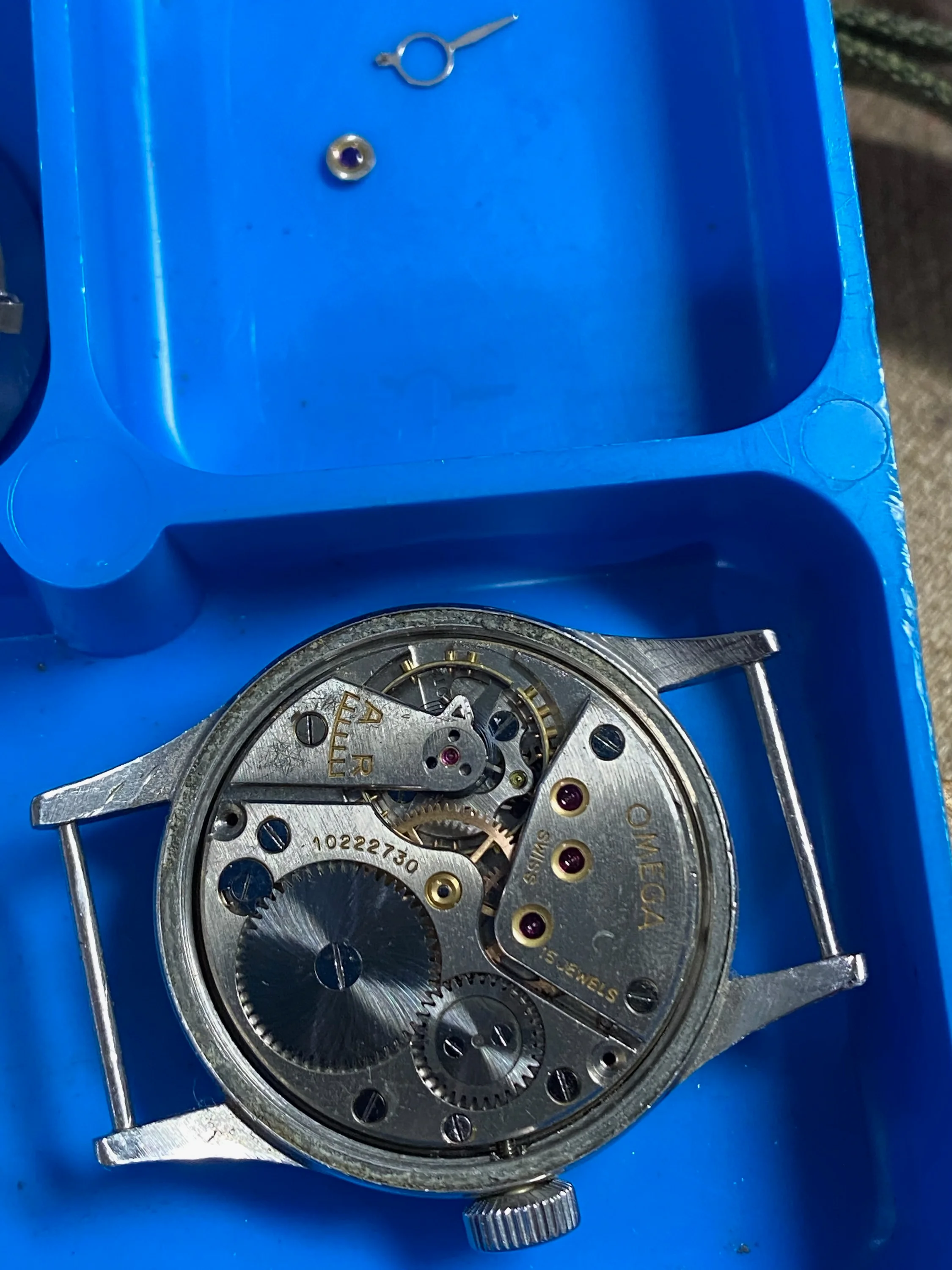

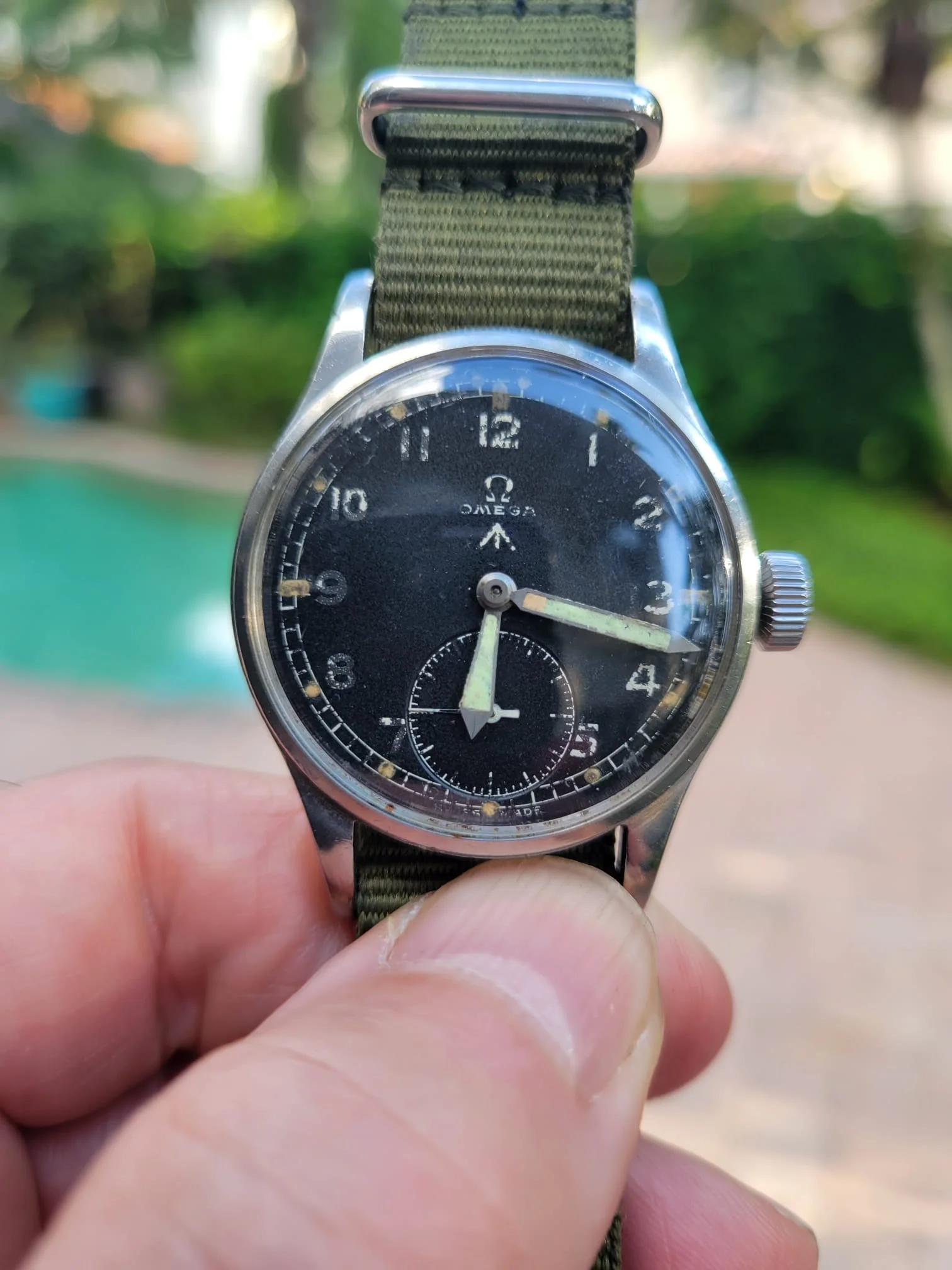

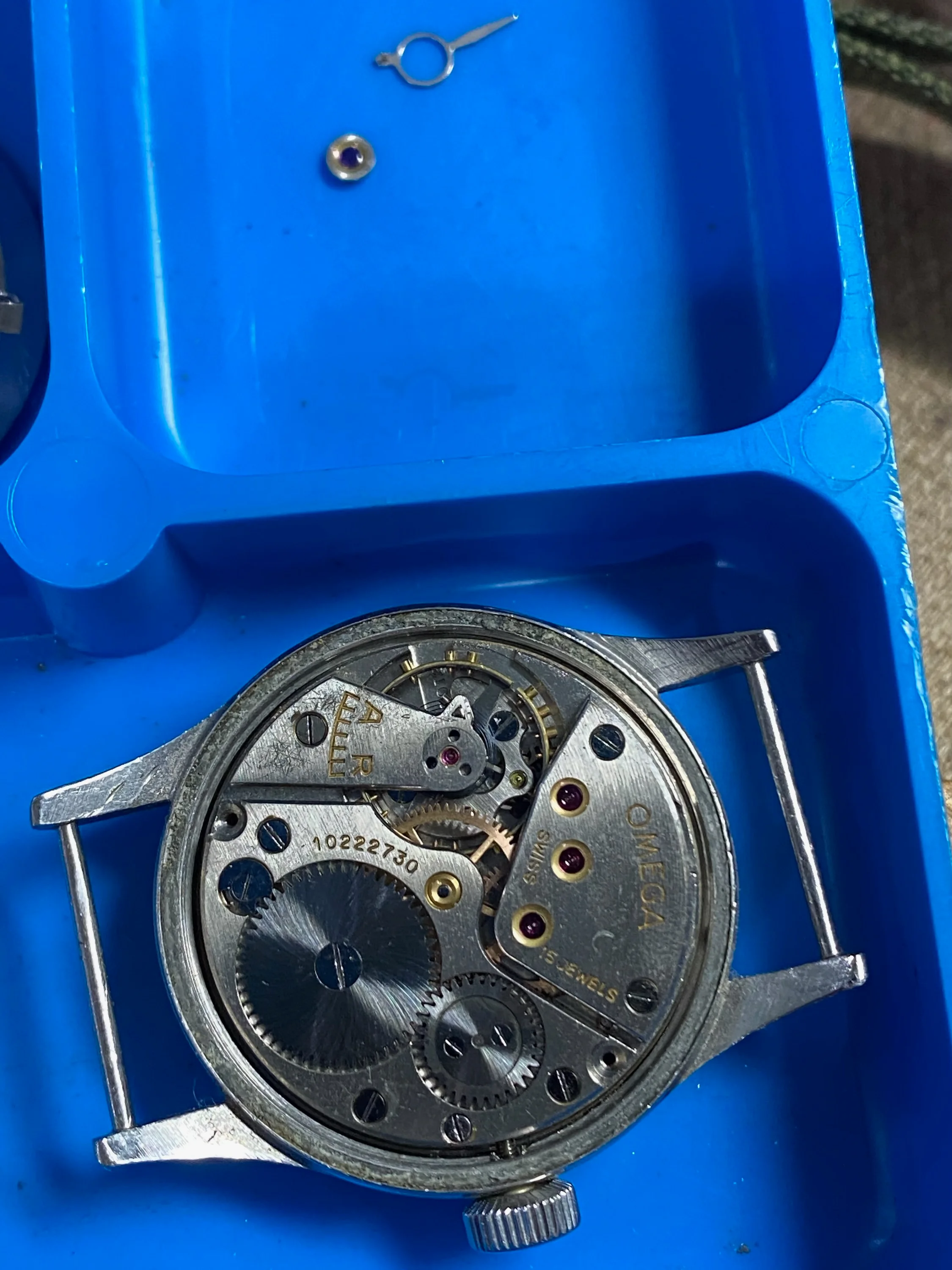

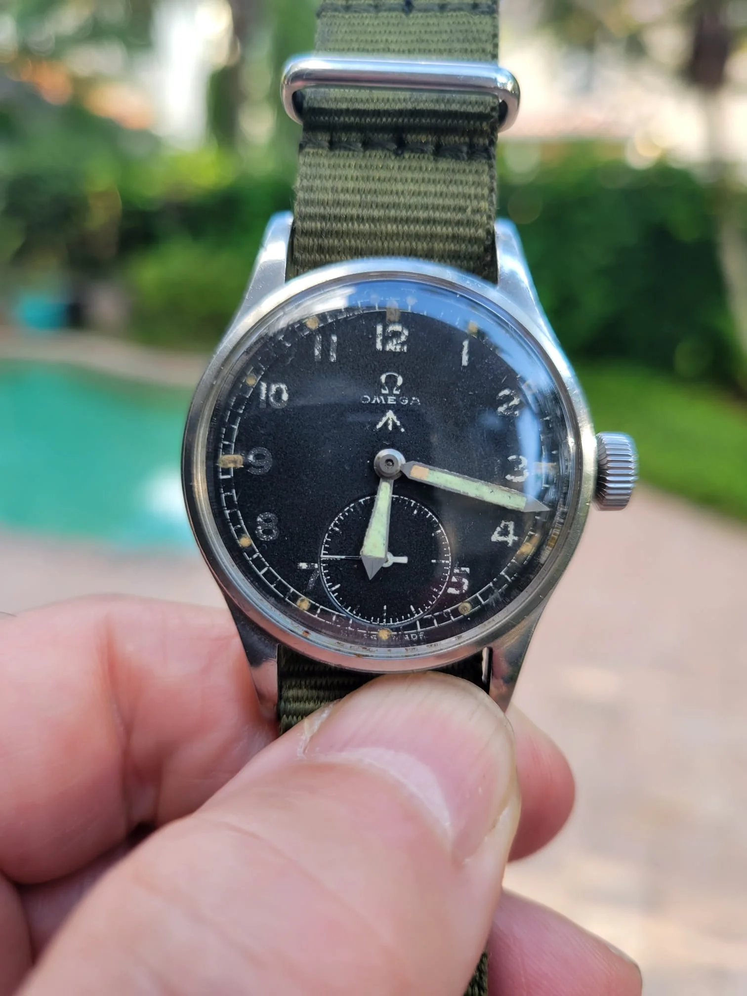

A family member owns what they think is an Omega dirty dozen. I sent it to my watchmaker for service--it had stopped running--and he doesn't think he can repair it, noting damage to the regulator and its jewel, the hairspring, and balance. I've attached a photo he sent. I thought that dirty dozen used a 30T2 caliber but this seems, if I am not mistaken, to be something else (I see what looks like a 16x on the plate.) So my first question is what cal. this is? Second question is this a genuine dirty dozen or a Franken? Third question is whether it can be repaired.

The movement is definitely a 30T2, you can see the 30T2 under the balance wheel. Its just not a shock-jewel version, so just a plain 30T2 (not a PC).
I don't know anything about this reference, but the dial seems to match. You're also missing a movement ring in that picture.
As far as a repair: There is a reasonable amount of movements and spare parts available even on ebay, ~$300 gets you a parts movement. ~$400 US gets you a complete balance, but unkown if that is a 30T2 or a 30T2 PC (https://www.ebay.com/itm/116472022661?)
So parts look available, so it seems repairable to me. Parts search without spending quite a bit of money is going to be your challenge, but the parts are somewhat available it looks, so 'repairable' comes down to 'how much do you want to spend' 😀
You'd probably do better finding a watchmaker that specializes in vintage repairs though, as they could possibly make parts/repair things like this. Hairspring repair/replacement (at least of a nonoriginal one) is a bit of a harder task vs just parts-swapping, but can save a bunch in that case.
