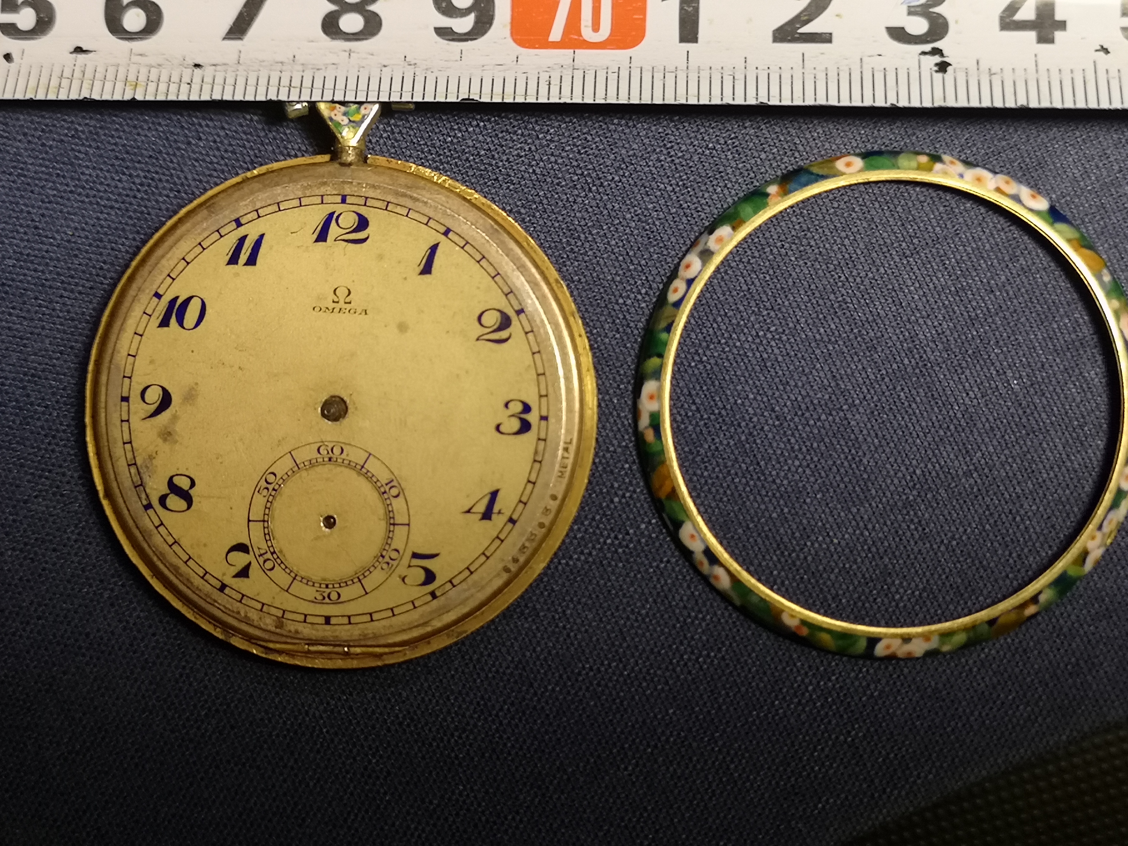

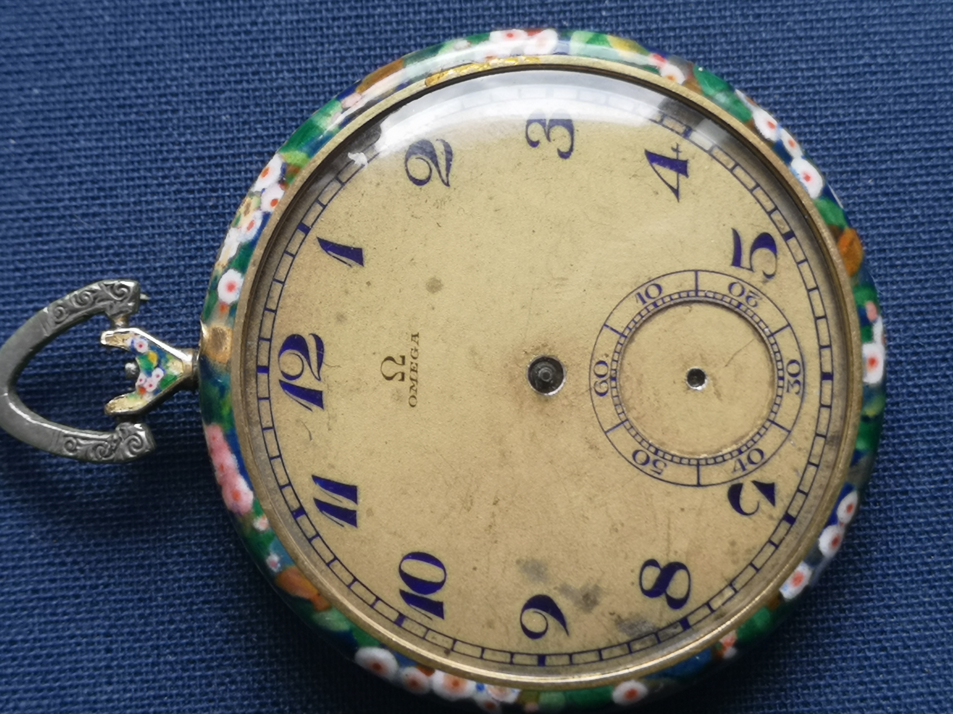

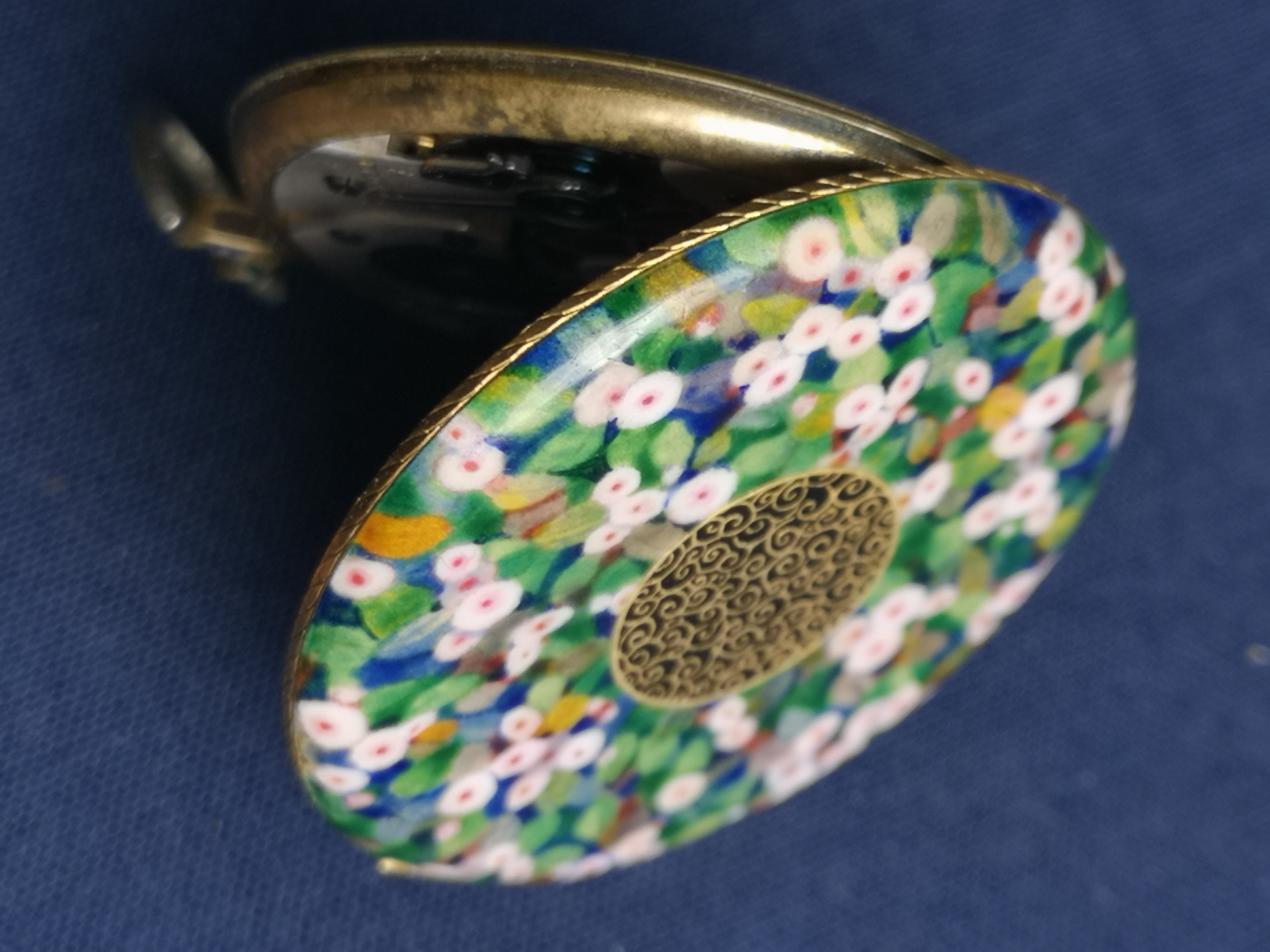

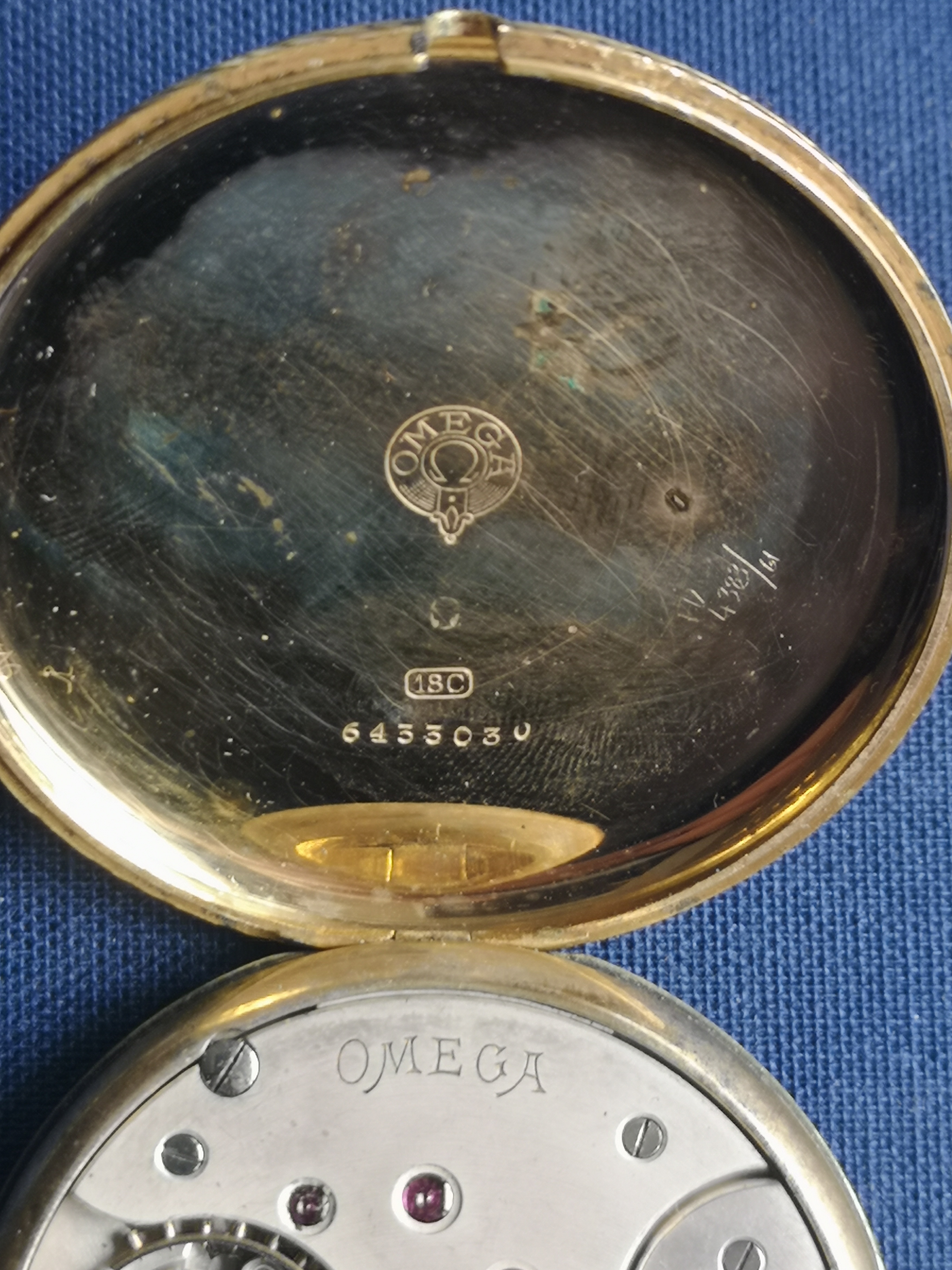

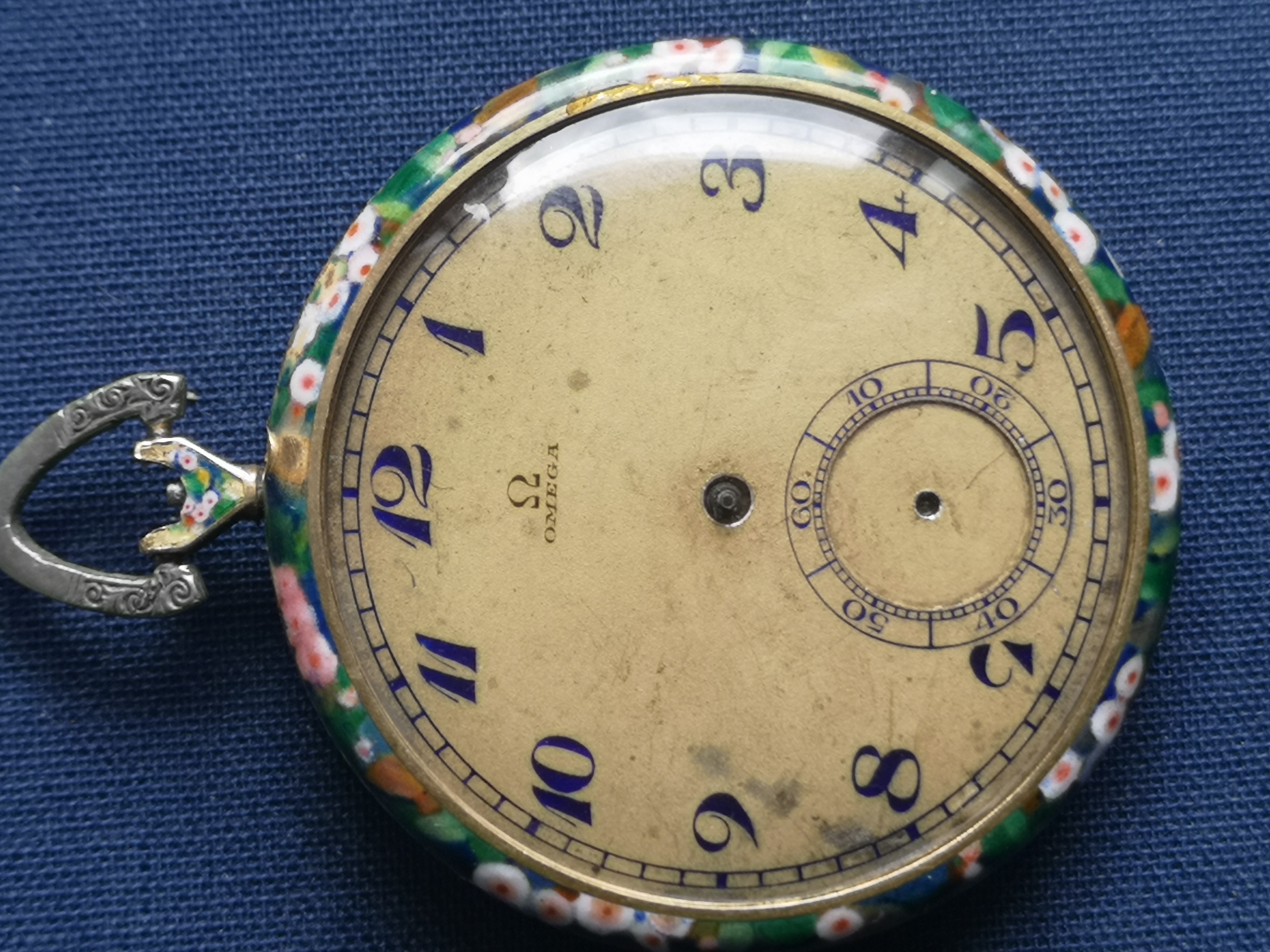

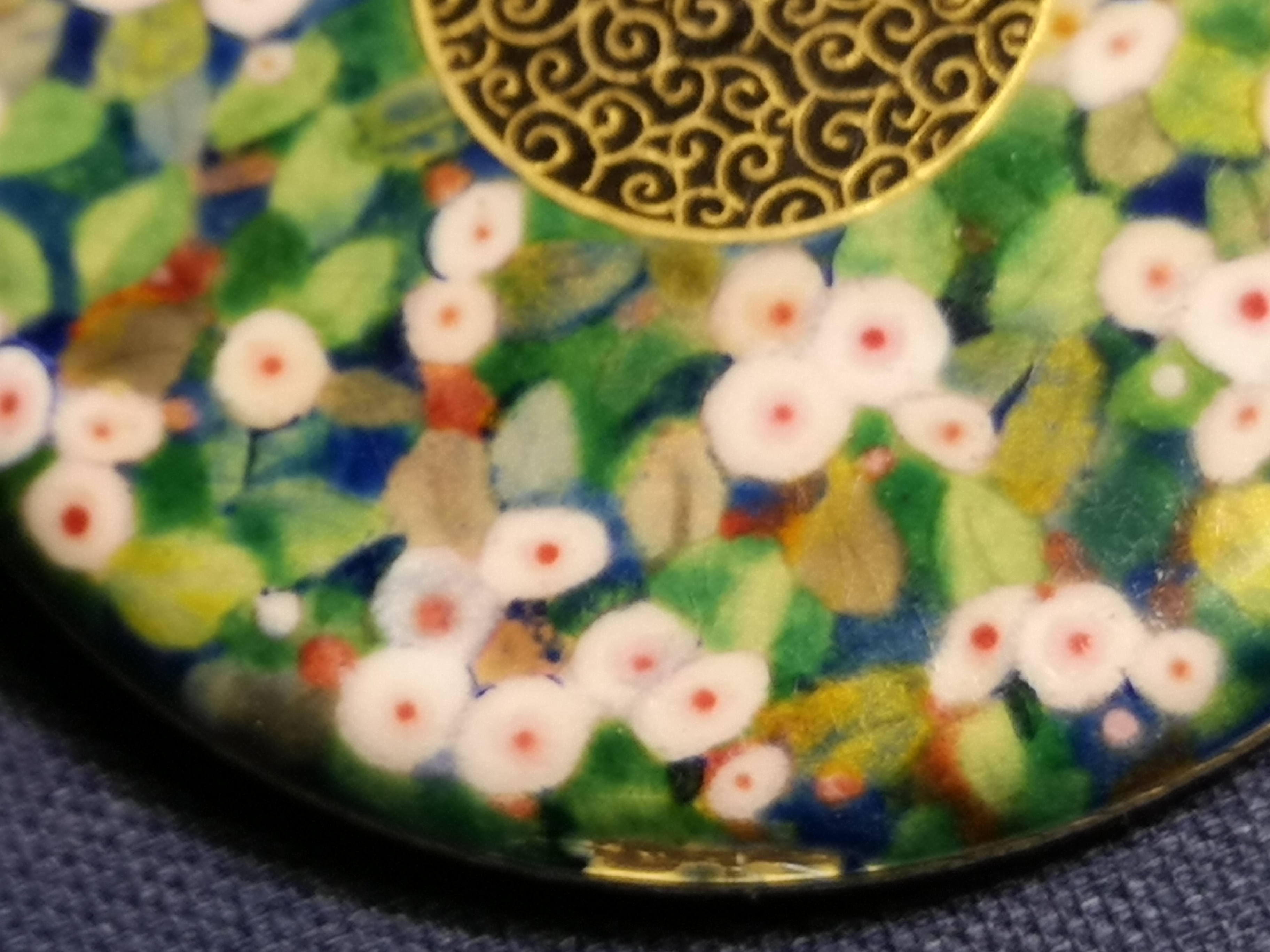

Pocket watch. No hands, 18ct, early 1920's.
15,995
48,111

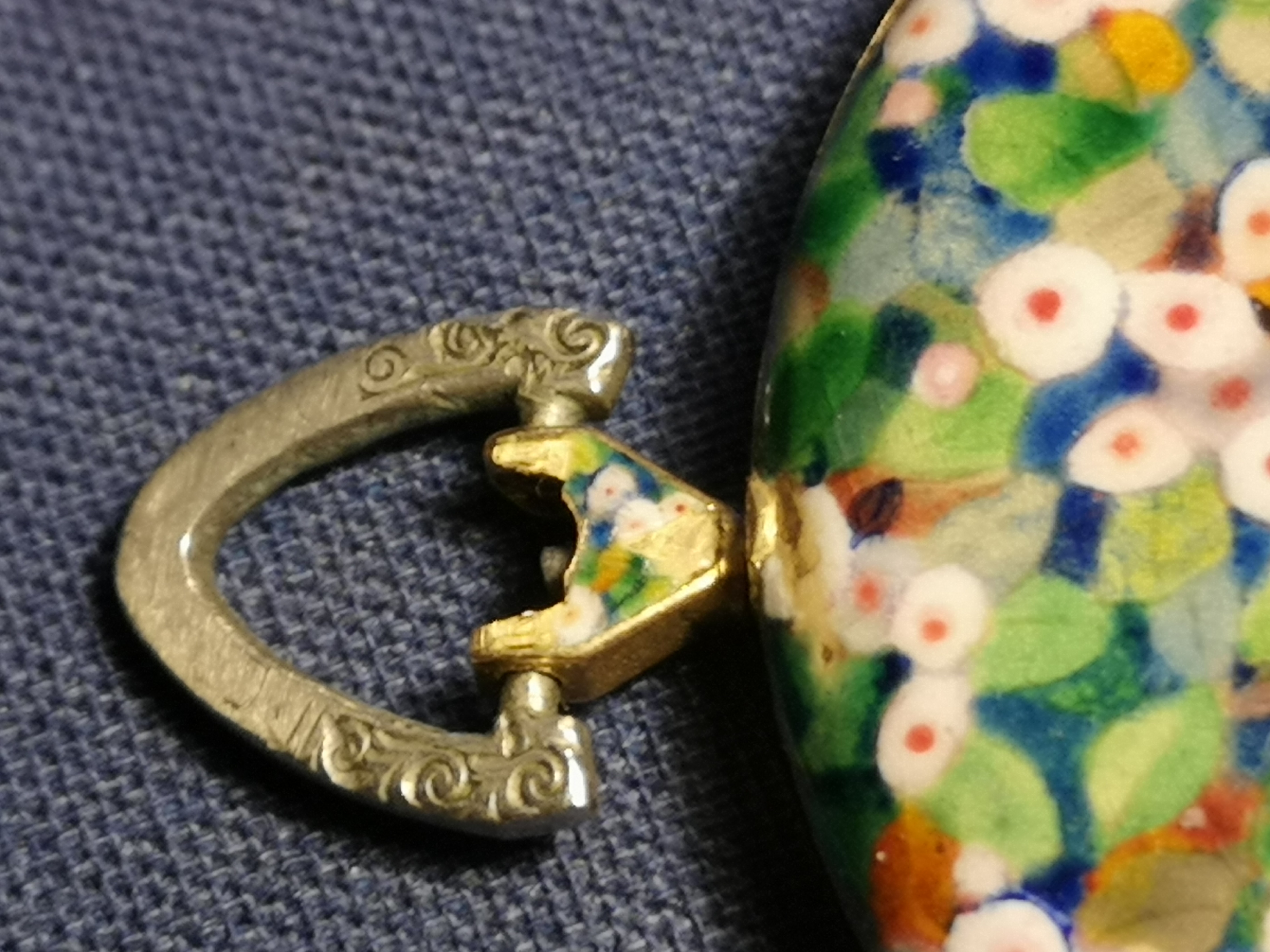

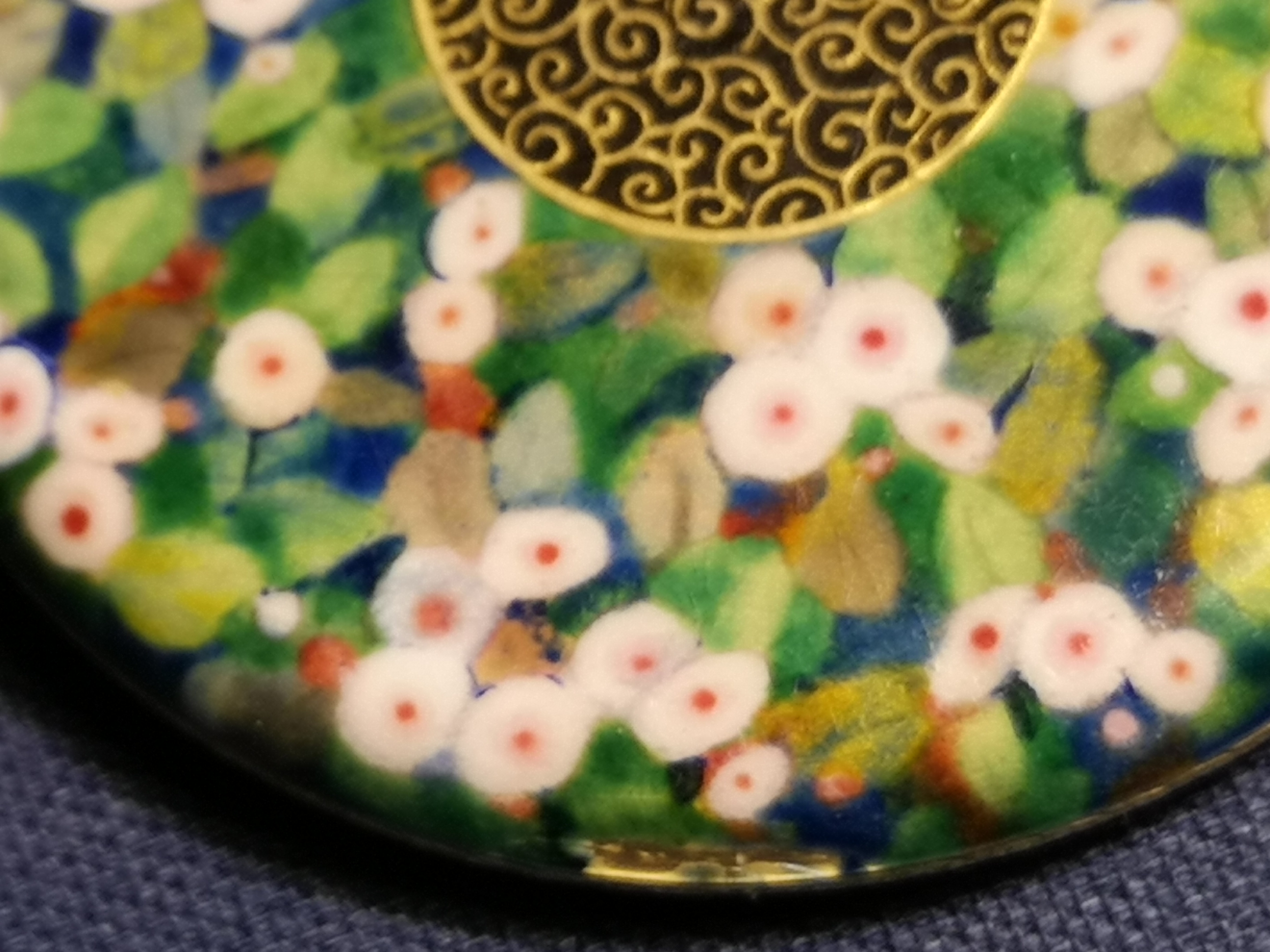

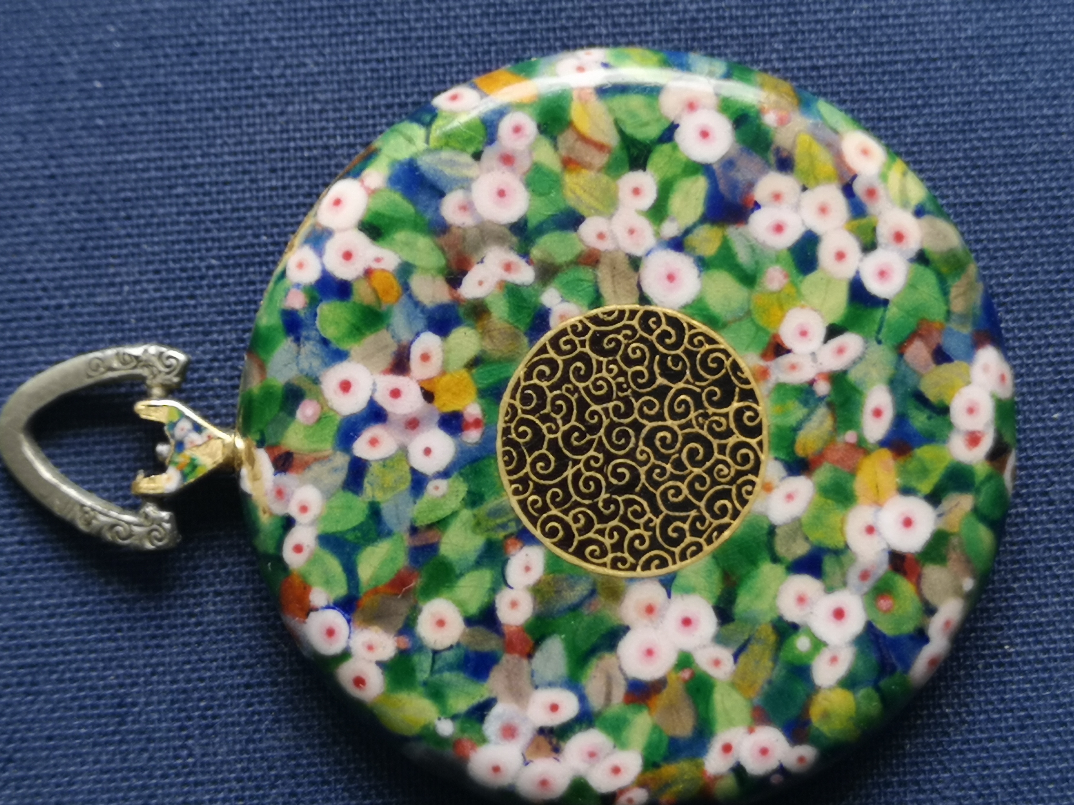

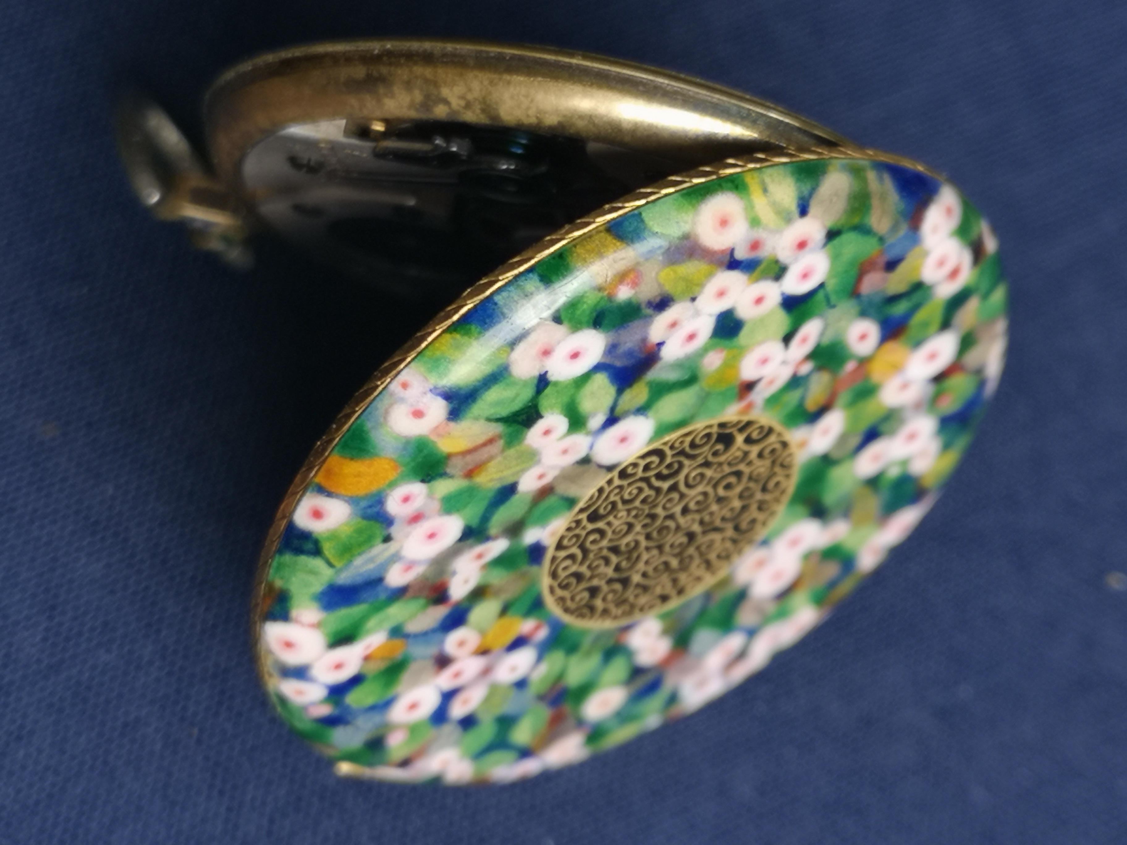

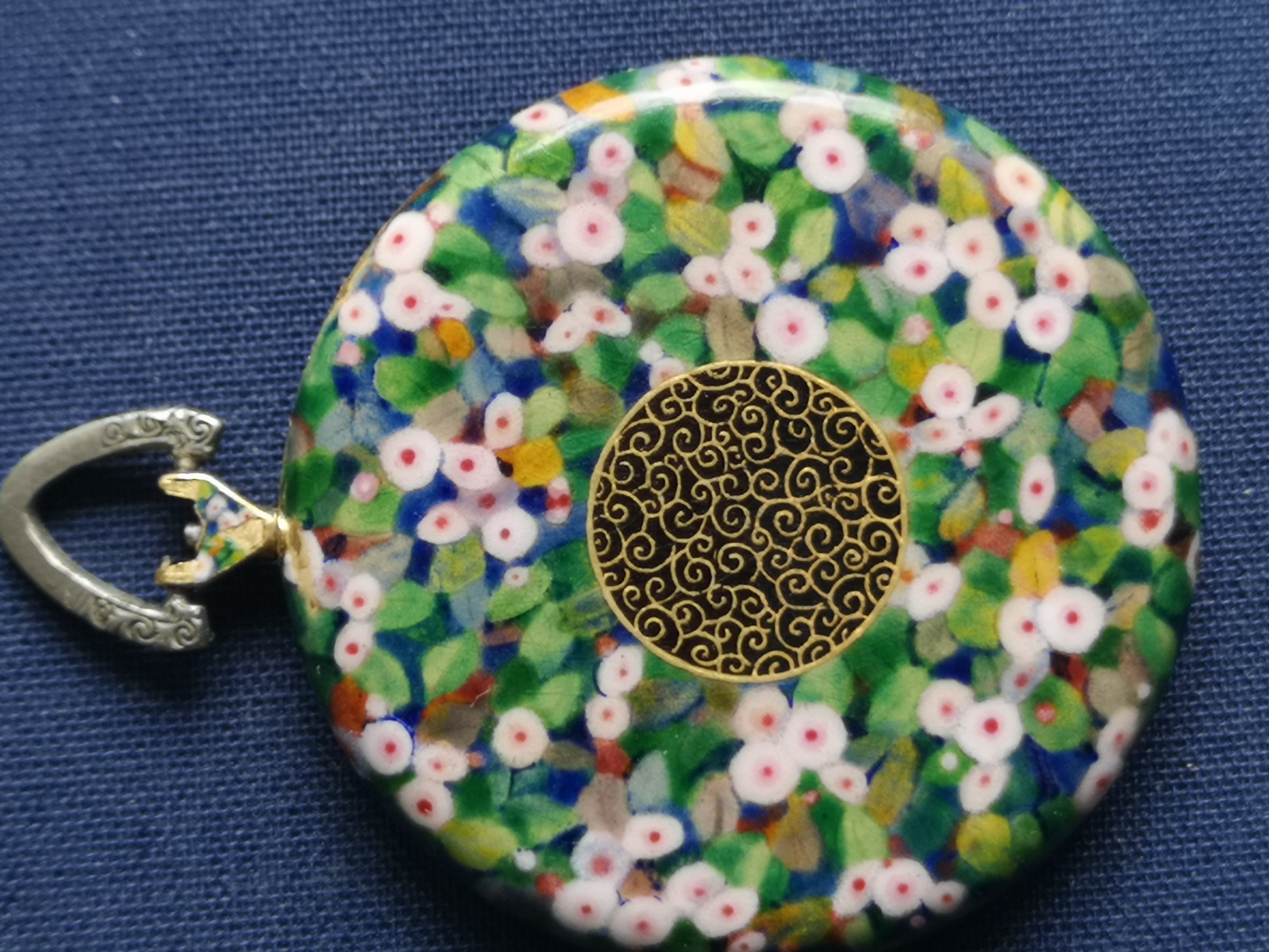

The case is decorated in what I would describe as Limoge enamel. Vari-coloured vitreous enamel, all hand painted. The amount of labor involved in producing such a splendid example would have been huge. I would guess there would be about six distinct colours of enamel, each colour would require a separate firing in a kiln. Vitreous enamel will last forever.......unless the item gets smacked around. The enamel on this one looks to be in superb condition. The cartouche with the black enamel appears to be done in cloisonnè enamel. The case is probably French. Worthy of being returned to operating condition!
6,833
10,502
I'm not particularly into pocket watches and no matter how uncommunicative the OP is, that case is stunning.
A mix of a sort of millefiori style enamelling and the contrasting centre panel of cloisonné looks like it is jumping off the screen -all in all , absolutely splendid.
I don't often tag people but I think @Syrte might enjoy seeing this piece.

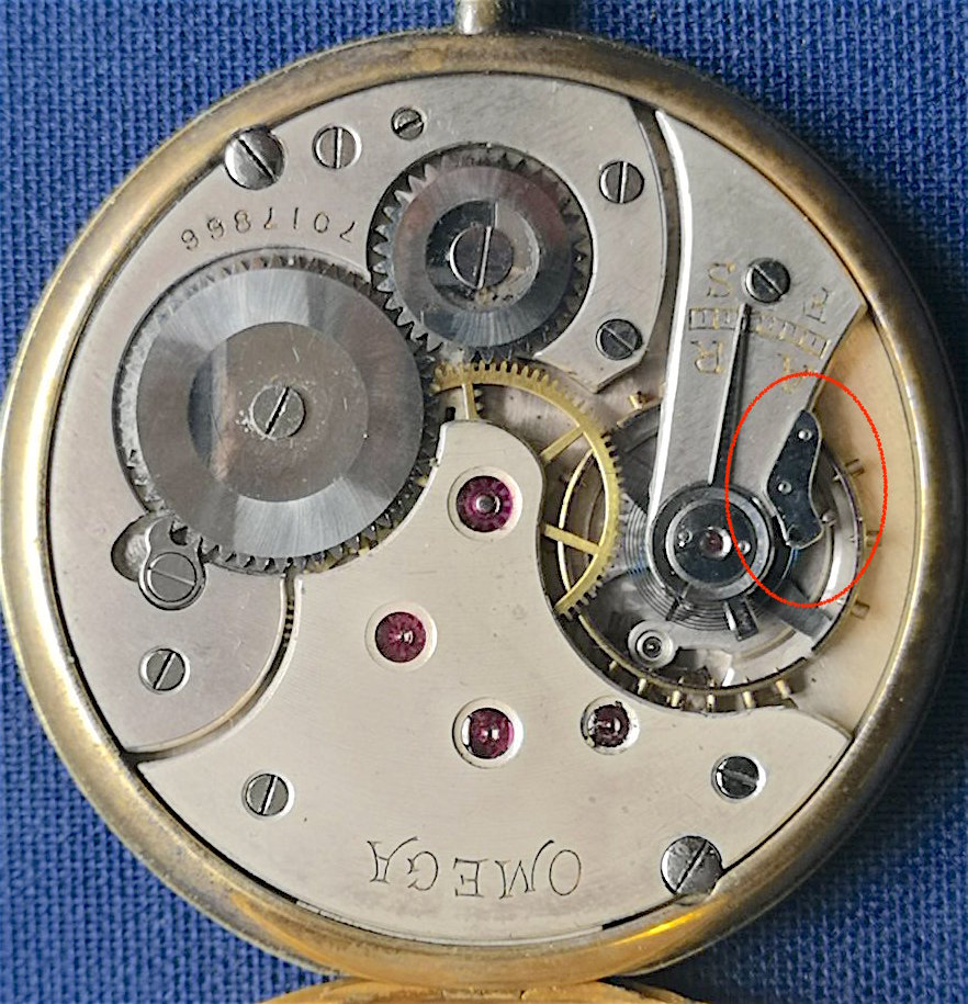

The movement does look somewhat out of place in such a high-quality case

Thank you, indeed— it is so beautiful, looks like a Klimt picture!!! to the OP:

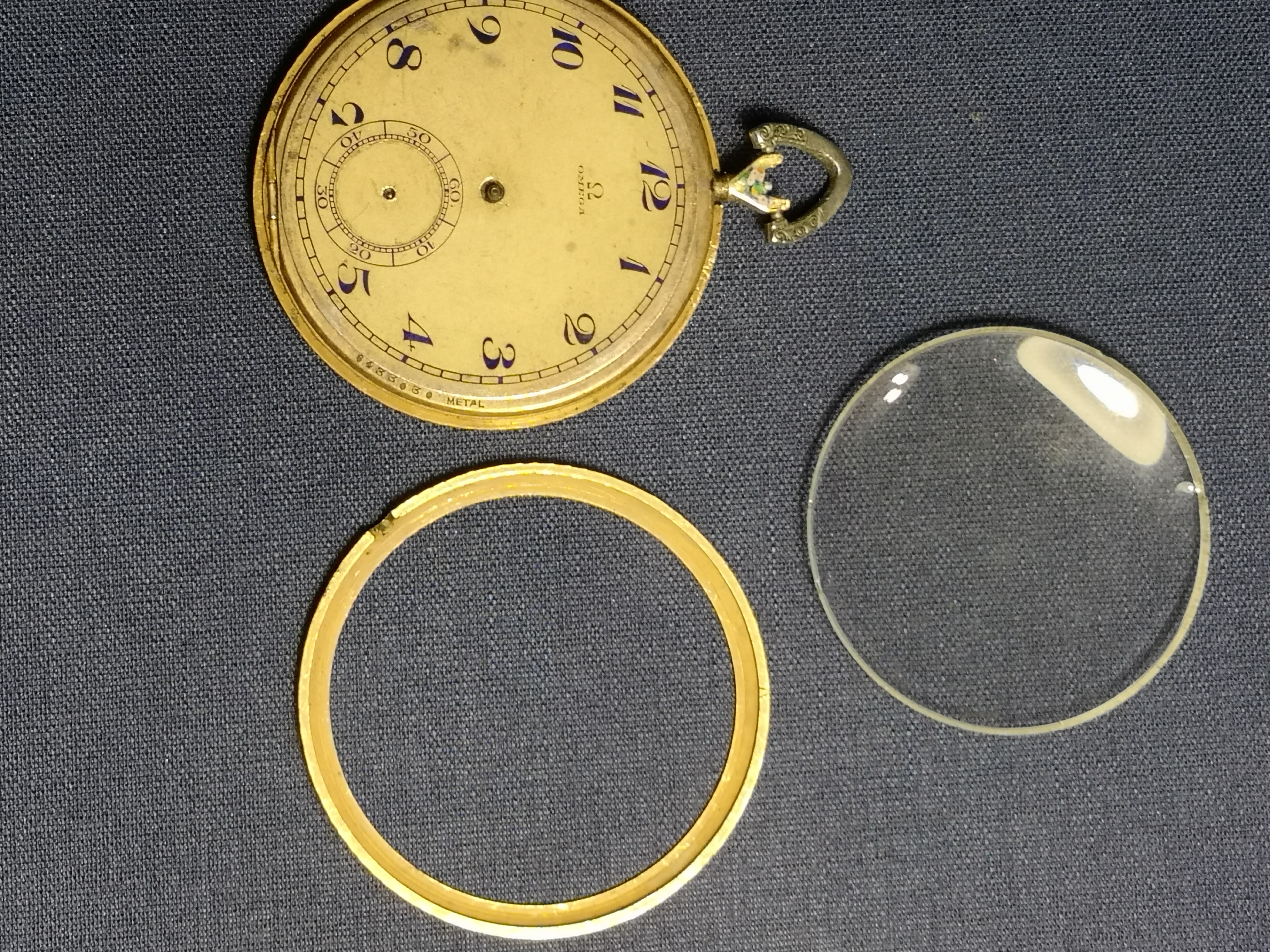

I try to attach other clear pictures.... may be relevant.

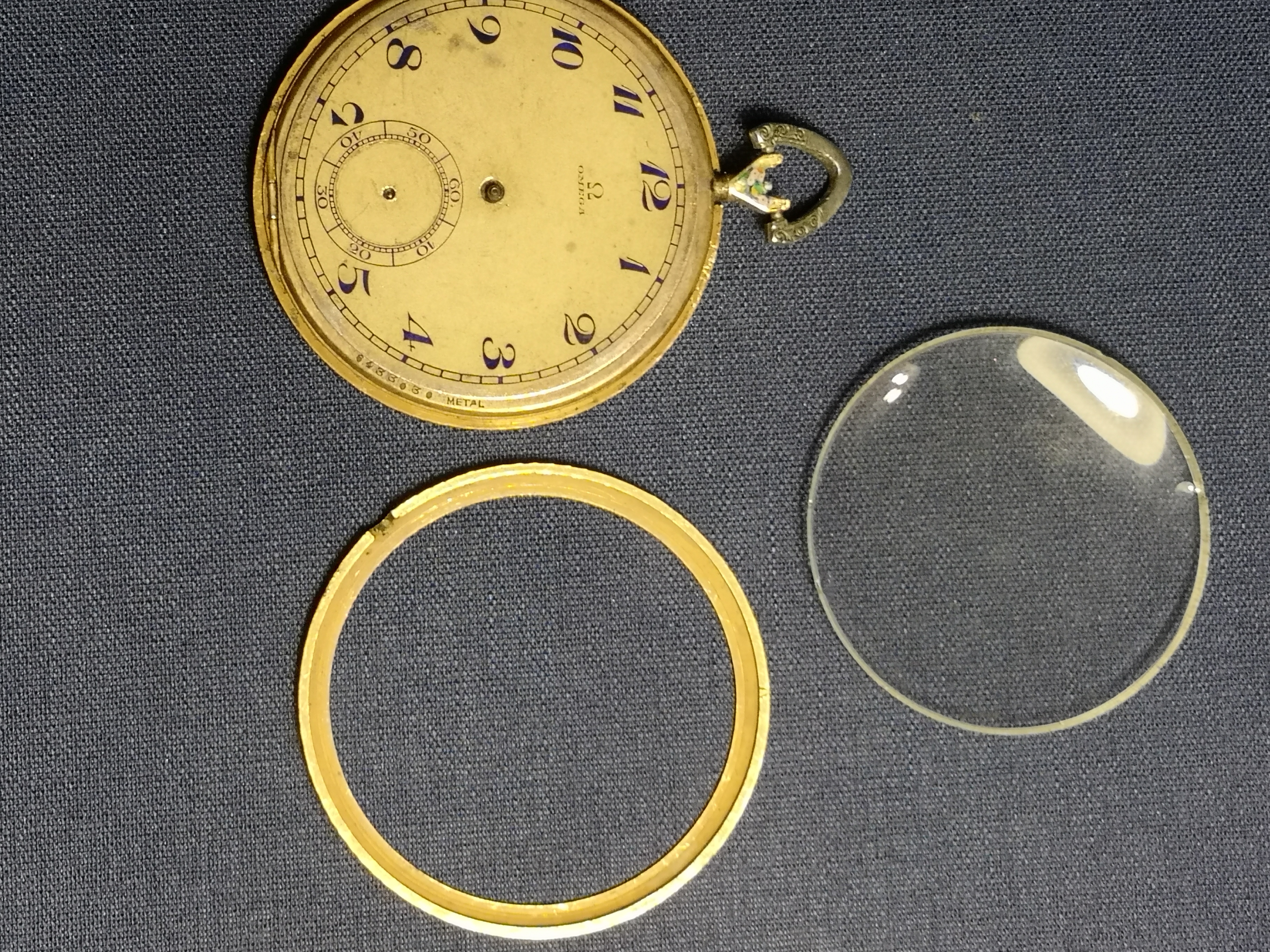

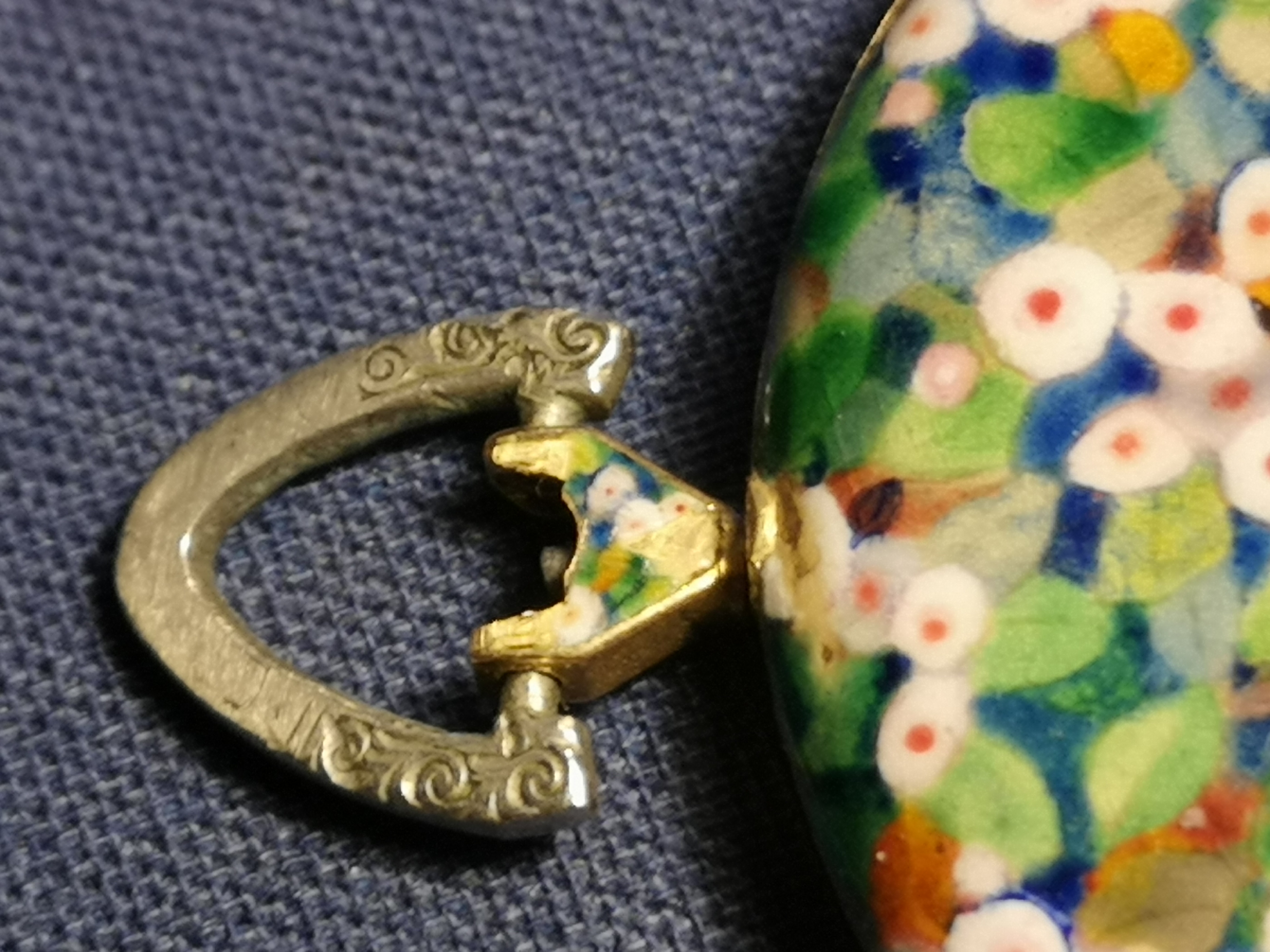

@1920

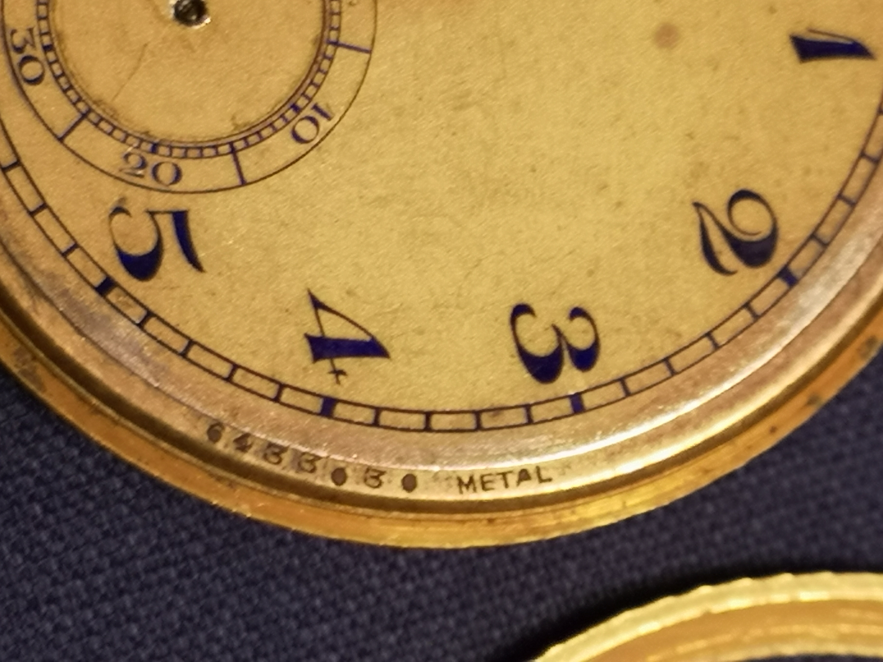

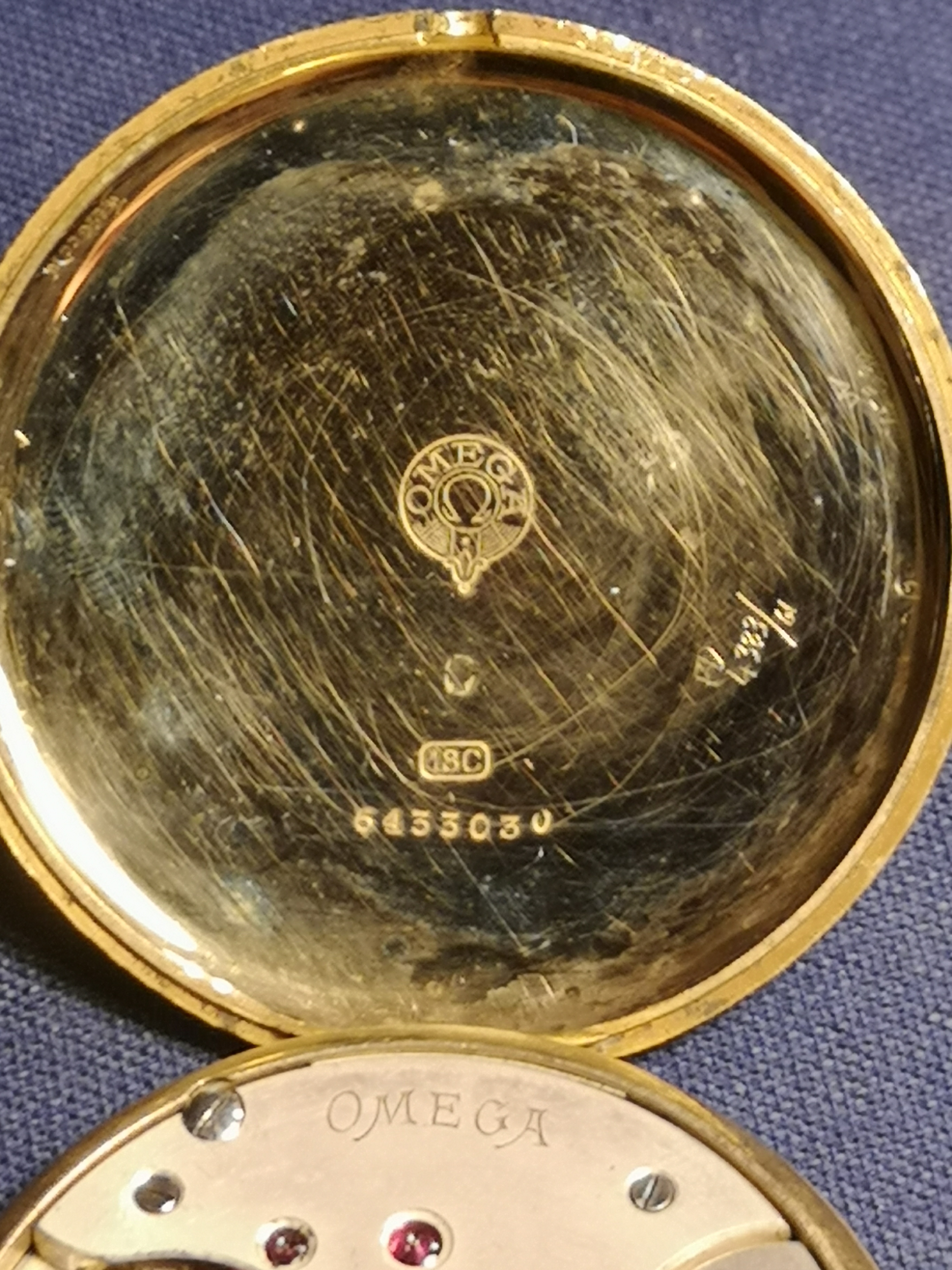

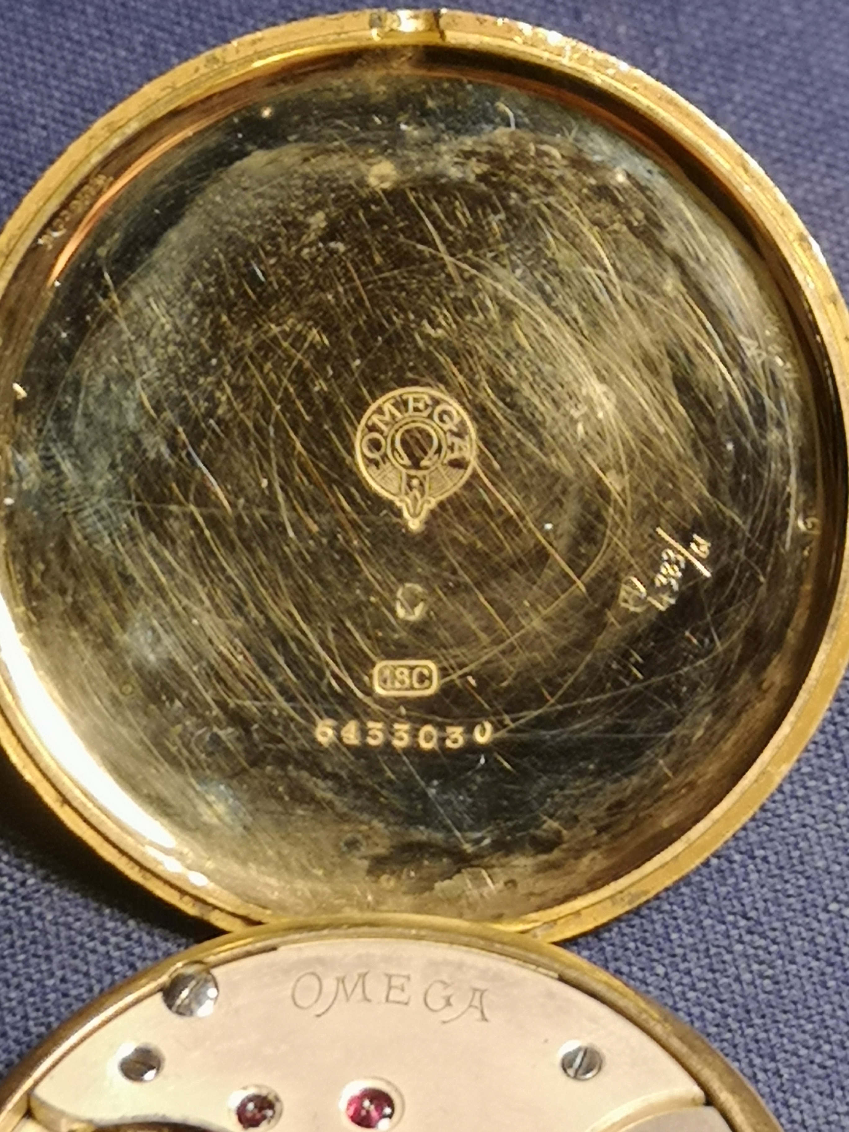

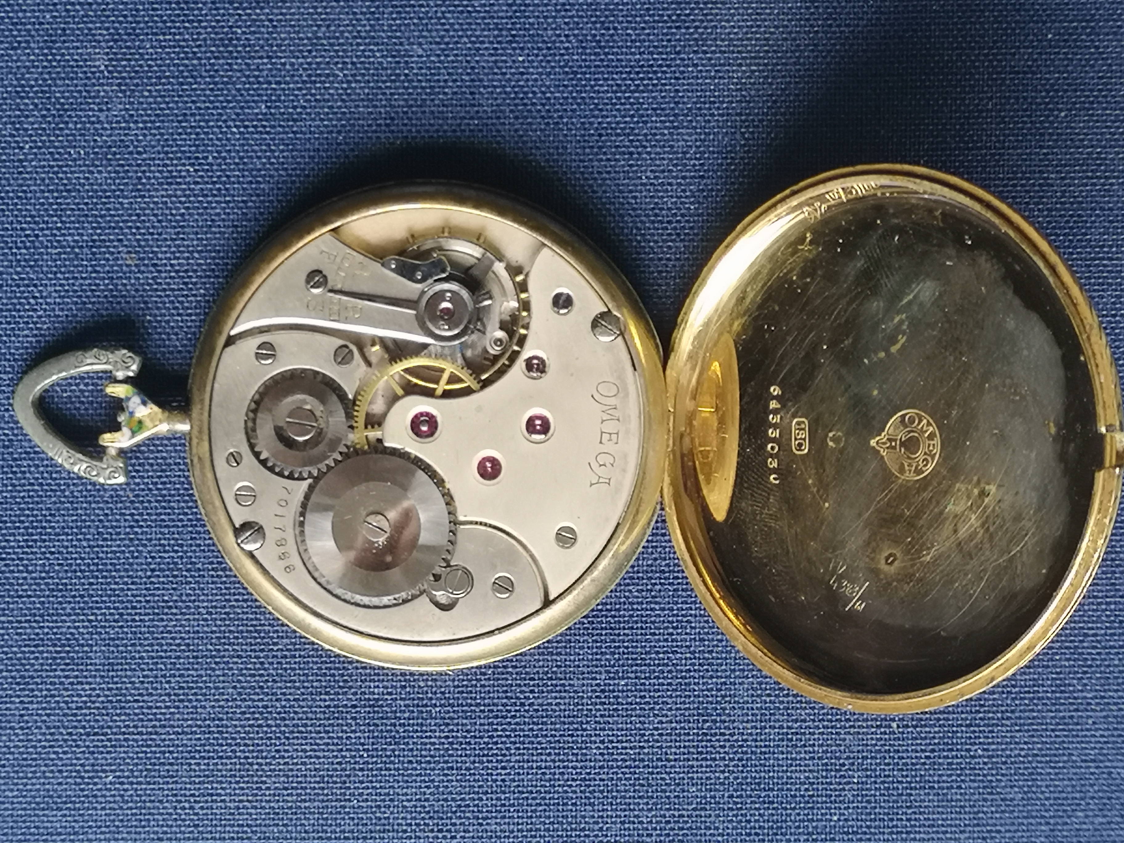

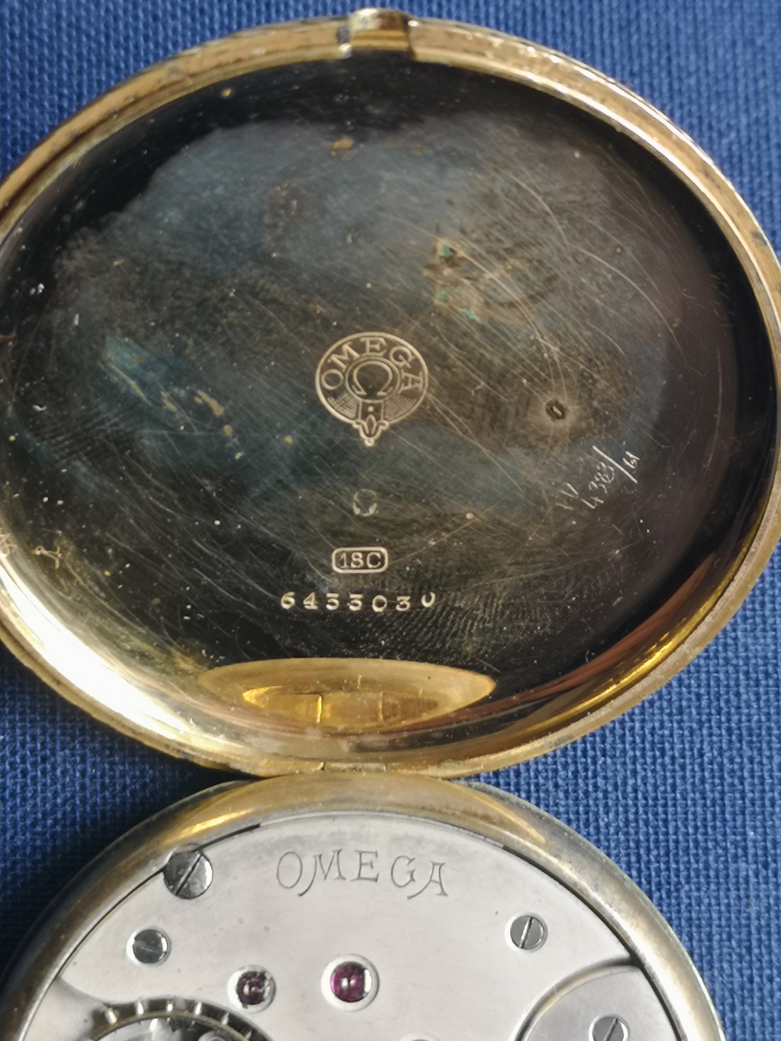

the gold hallmark is interesting in that it states just 18c. It almost looks like a Swiss Helvetica stamp above it for 18c, but its not quite right. I believe a French case would be 18k at that time.. but that doesn't mean that the enamel work was not done in France.

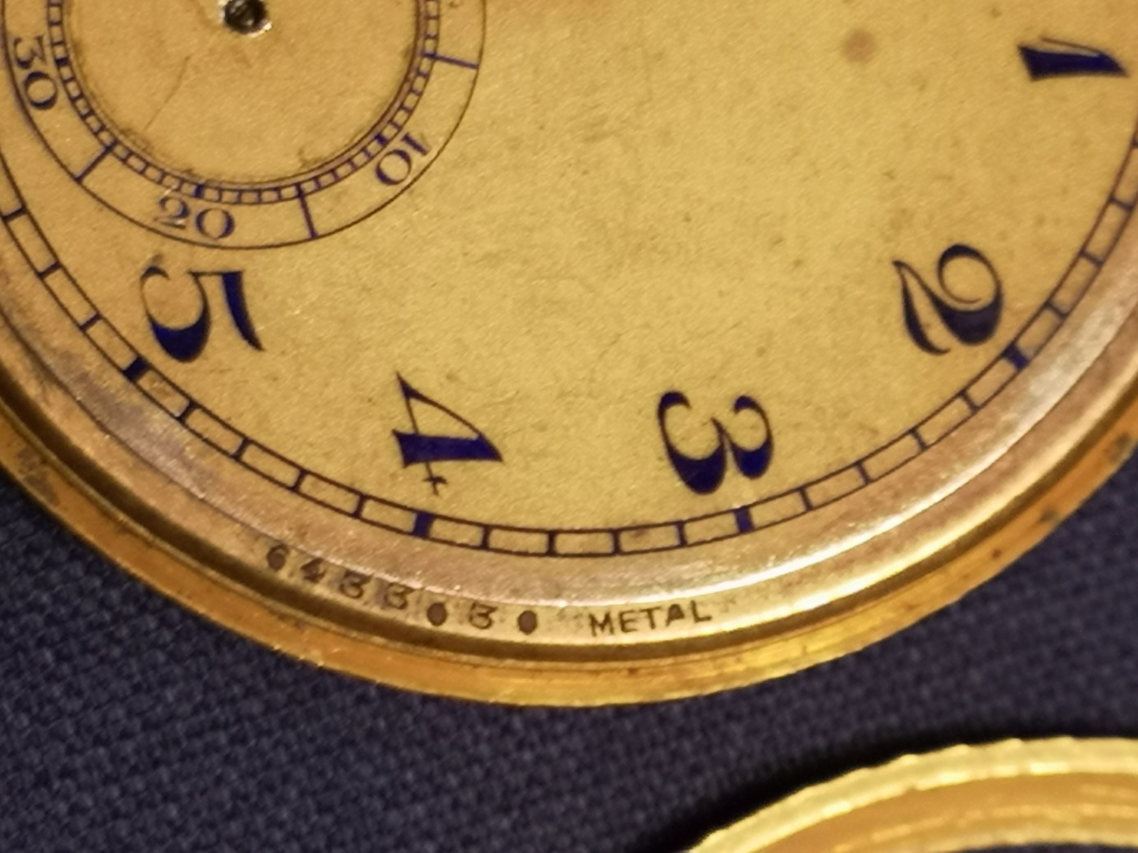

Seriously nice enamel work, source hands that work on it shouldn't be that hard... dial is still pretty attractive and goes well with the case.

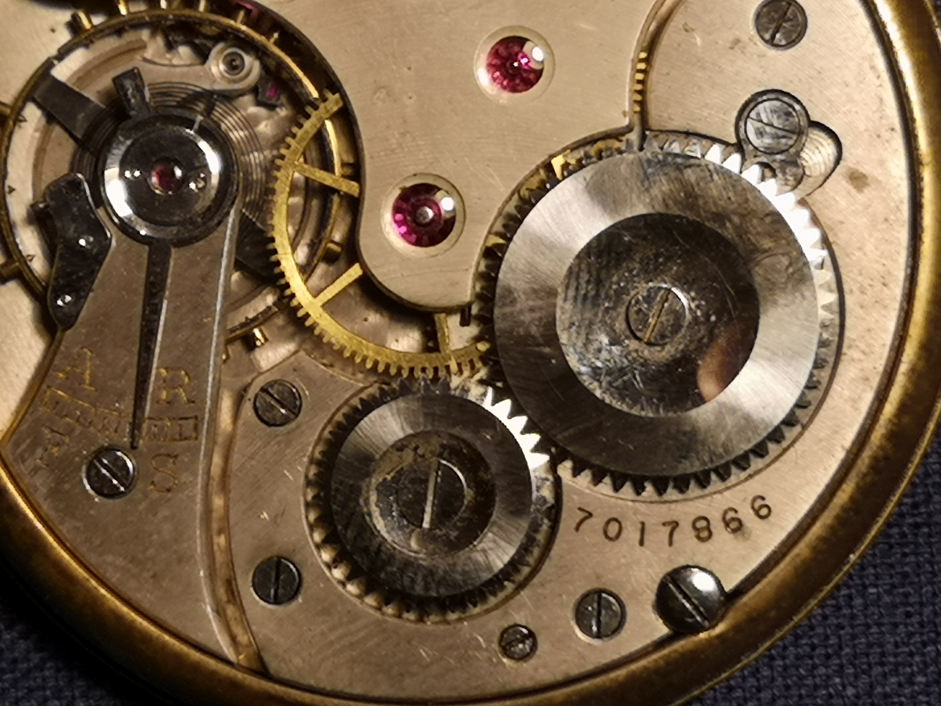

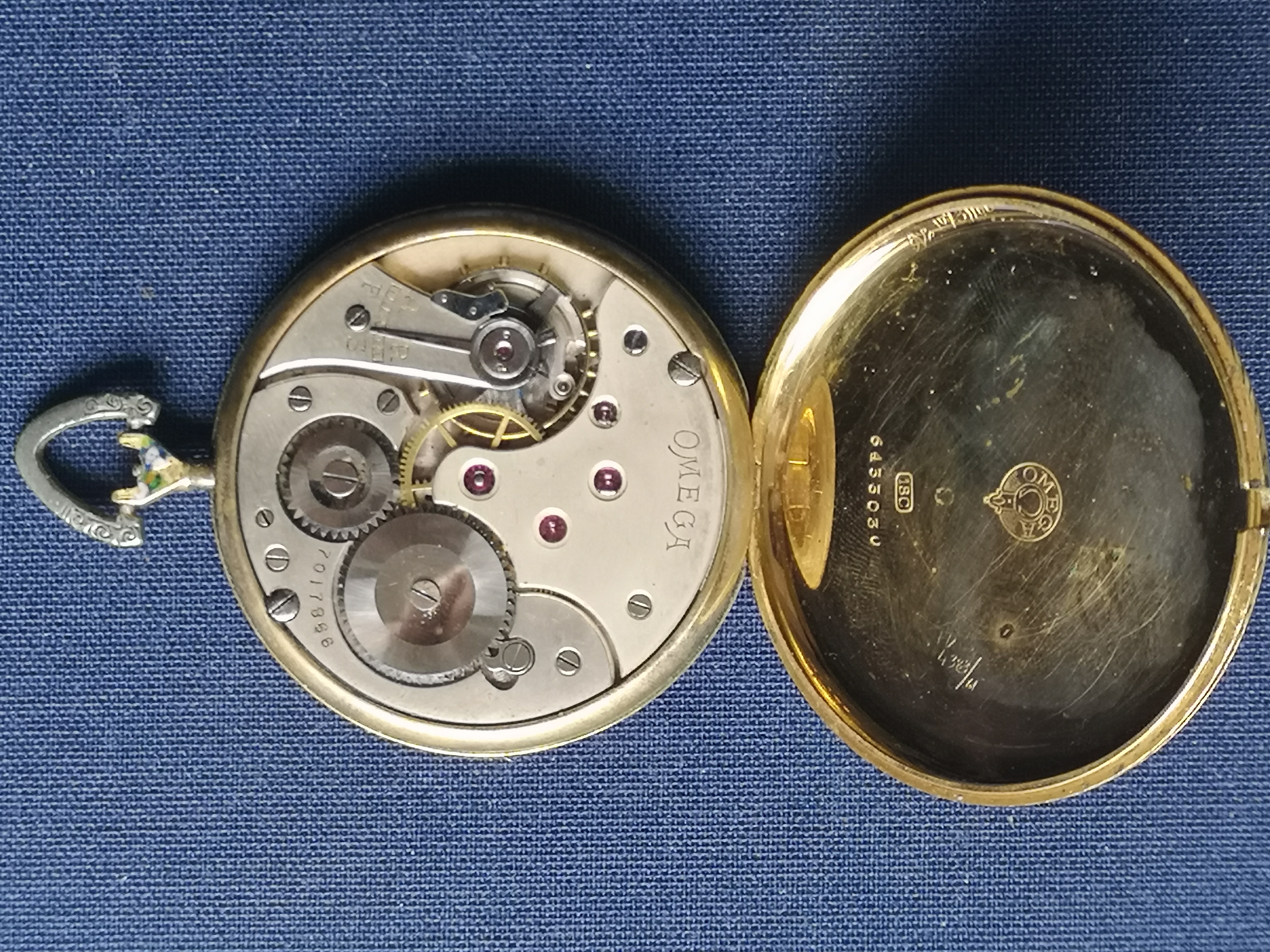

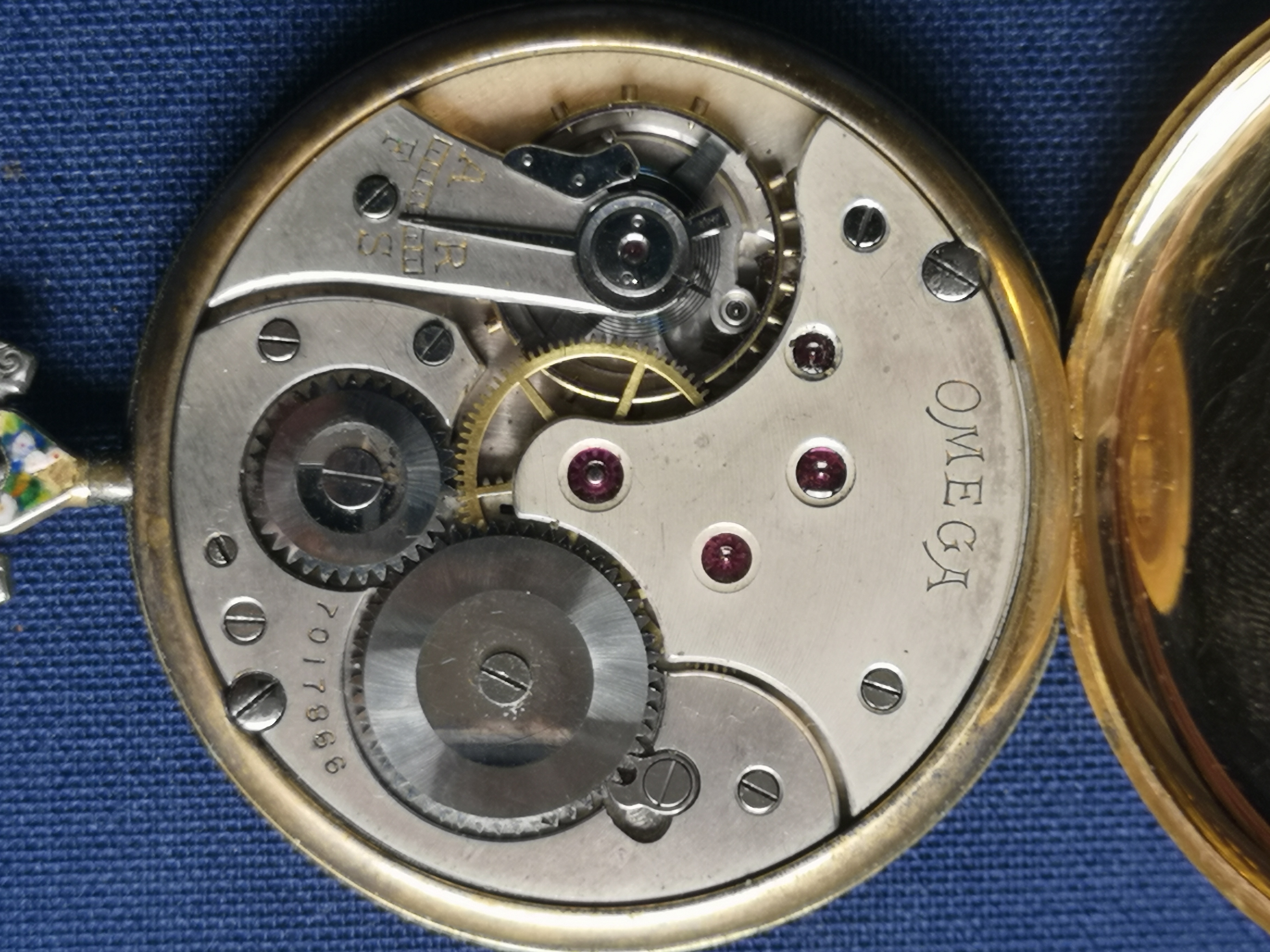

That's quite a watch and could be restored to its former glory. If the dial is enamel it will be very easy to clean up, if not enamel, it will need care.

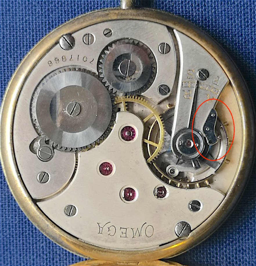

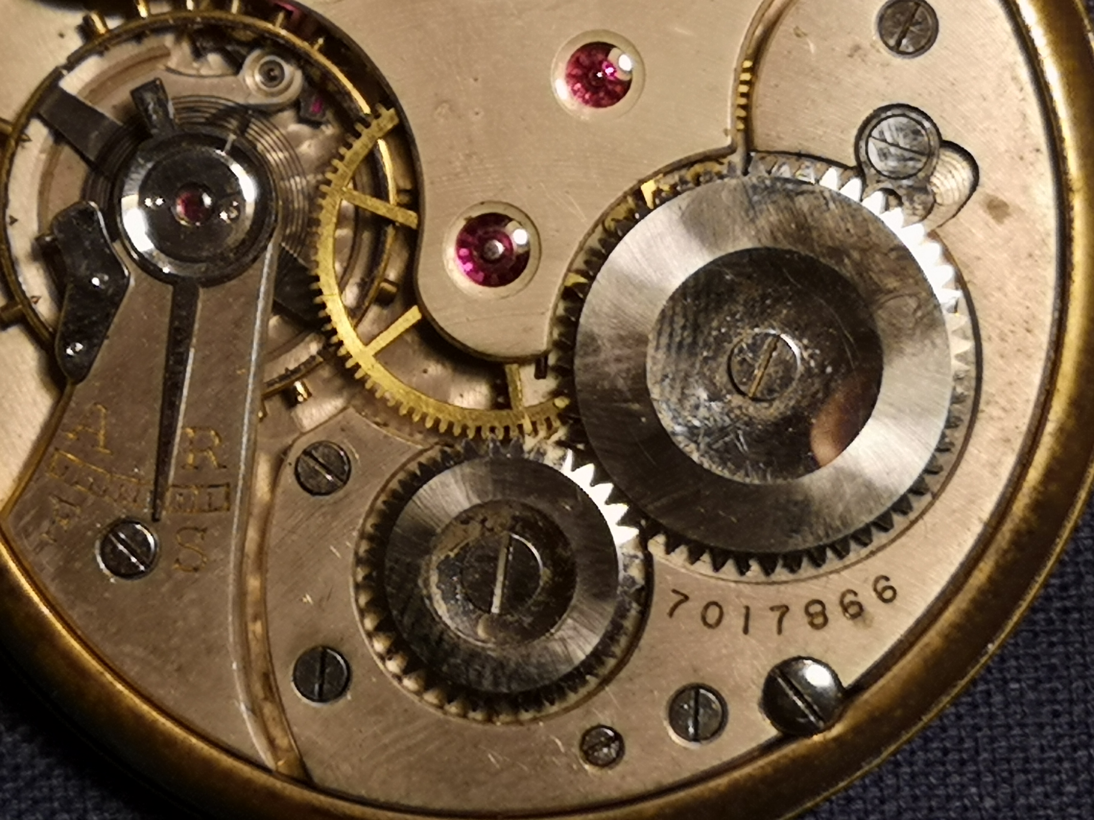

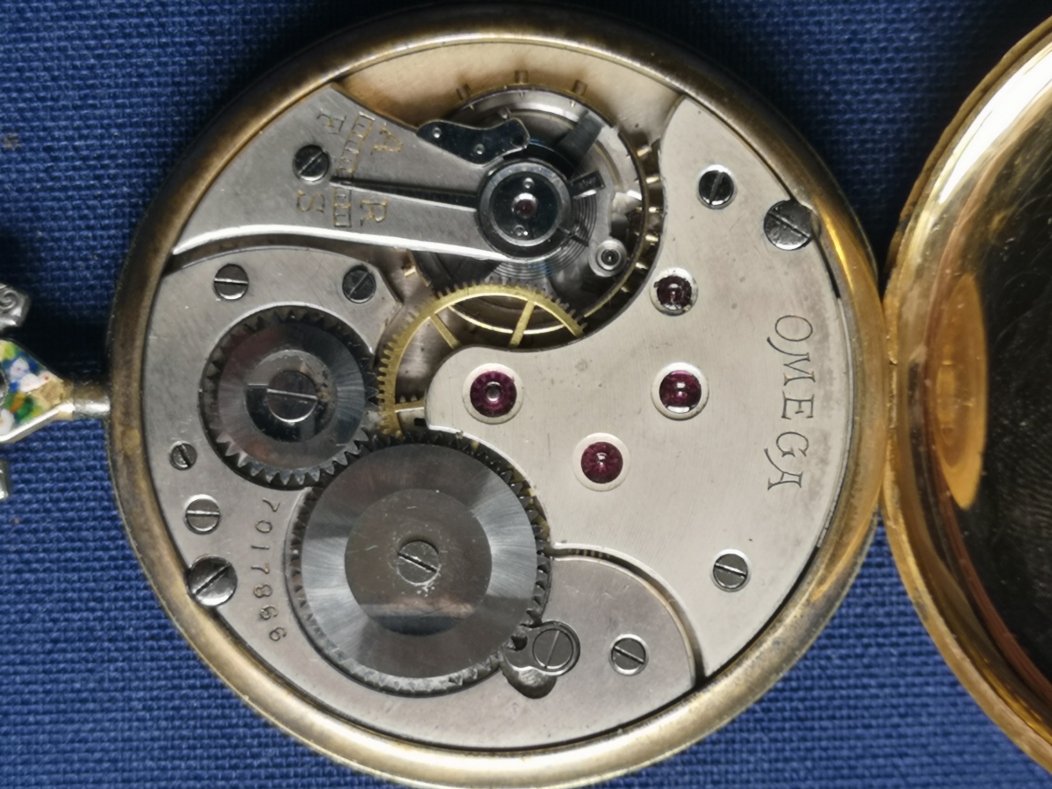

I don't think the movement is plain at all. Undecorated? Yes. But it is a 15 jewel (at least) movement. The belt/garter Ω symbol is sometimes used in French cases, so Foo may be right.
18,839
39,180
However, I can't pin down the caliber. It looks similar to may but the stud holder is unusual. I haven't seen that before.

In my french version of "A Journey through Time" on page 690 there's a picture of a similar watch (copy from a sales leaflet for an exhibition in 1925 too small to be copied here) with the description
6434431/435 Montre or 18kt avec décor émail Limoges. (gold watch with Limoges enamel decoration) @Canuck !
The price at the time was Fr. 3000.-- (and in those days the french franc was officially still on par with the Swiss franc 😗 )
And I agree with @Peemacgee that the quality of the movement does not quite reflect the aspect of the case.

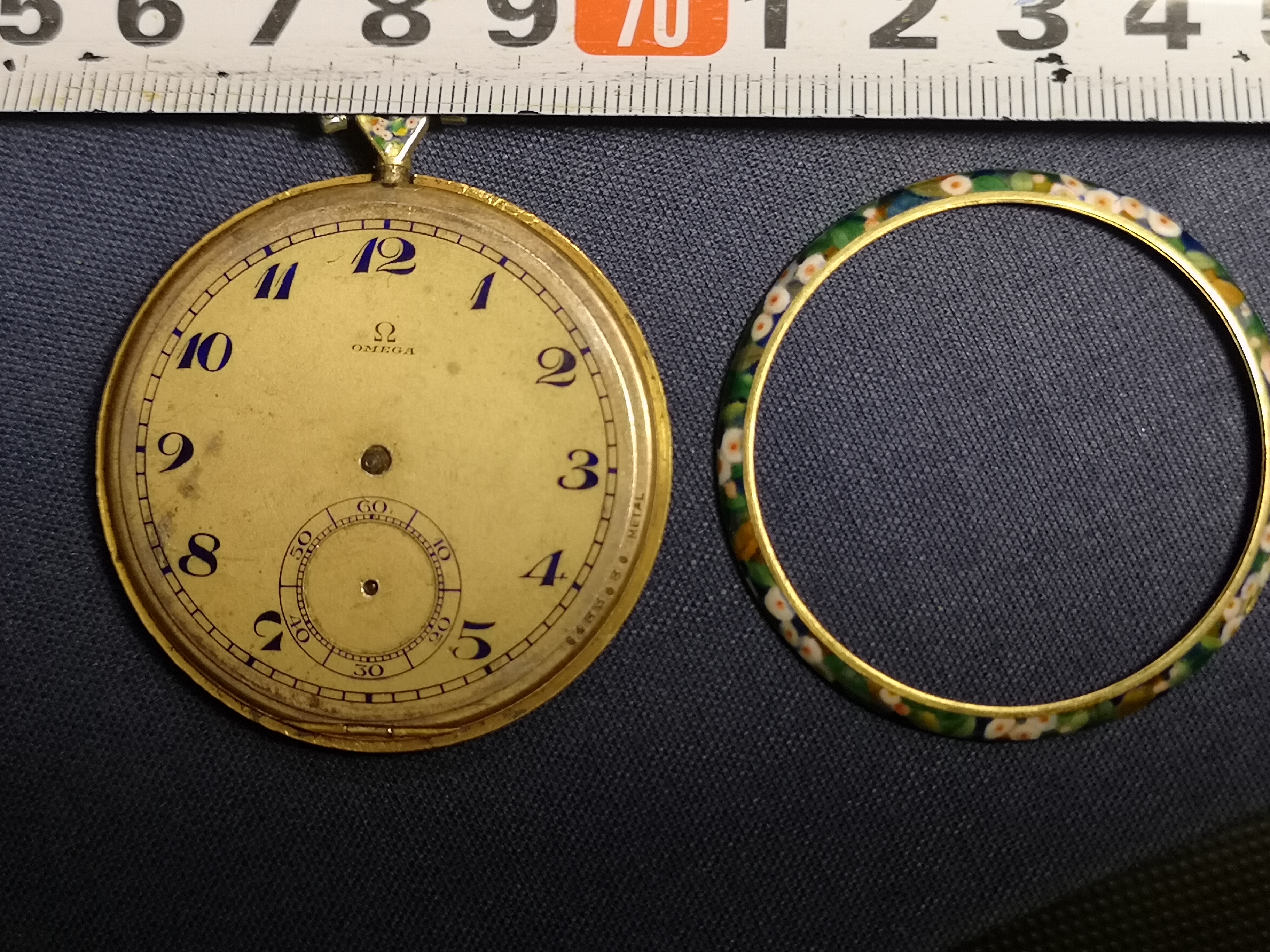

BTW @luckwatch an indication of the size of the movement would be helpful.
