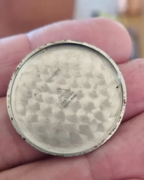

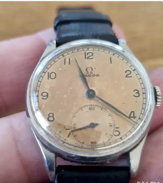

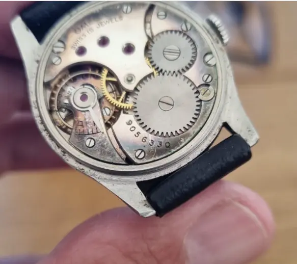

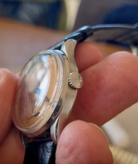

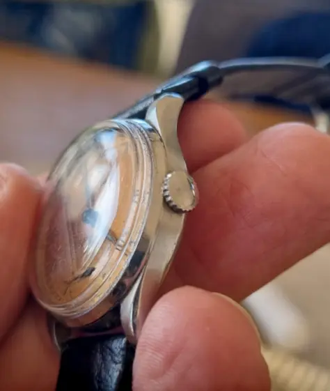

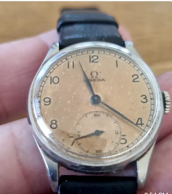

Can I get some thoughts on this c. 1940 Omega
3,969
8,984
I have really taken a liking to this, but out of my comfort zone. I am not sure of the ref, but possibly a CK 2385??
Any general thoughts on condition and of hands, crown, case, etc... It looks genuine to me, even the crown, but as I say, I am out of my comfort zone.
It looks like it might have started life as a salmon dial? What do you think?
2,346
1,475
26.5 movement so guessing small watch. Running fast, so add in the cost of servicing
What’s the selling price? If more than $250. Walk
Personally. I would pass on it myself. I’ve bought small cased models, but with more interesting solid cases
3,653
7,770
IMO it started with a silver coloured dial which is heavily discolored now.
@DON is right about movement and size.
I would also pass, it is not worth to spend much money on it
