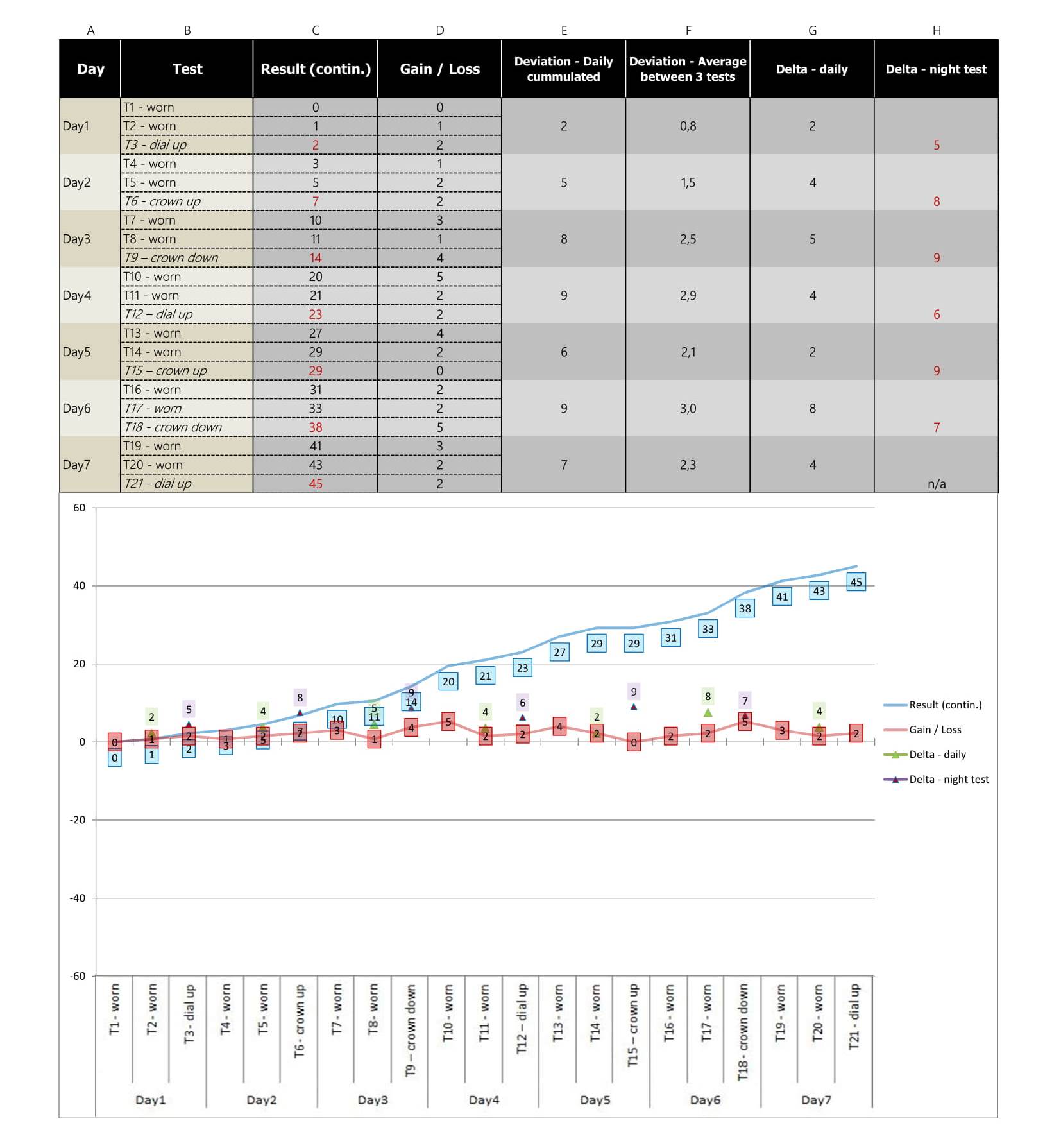

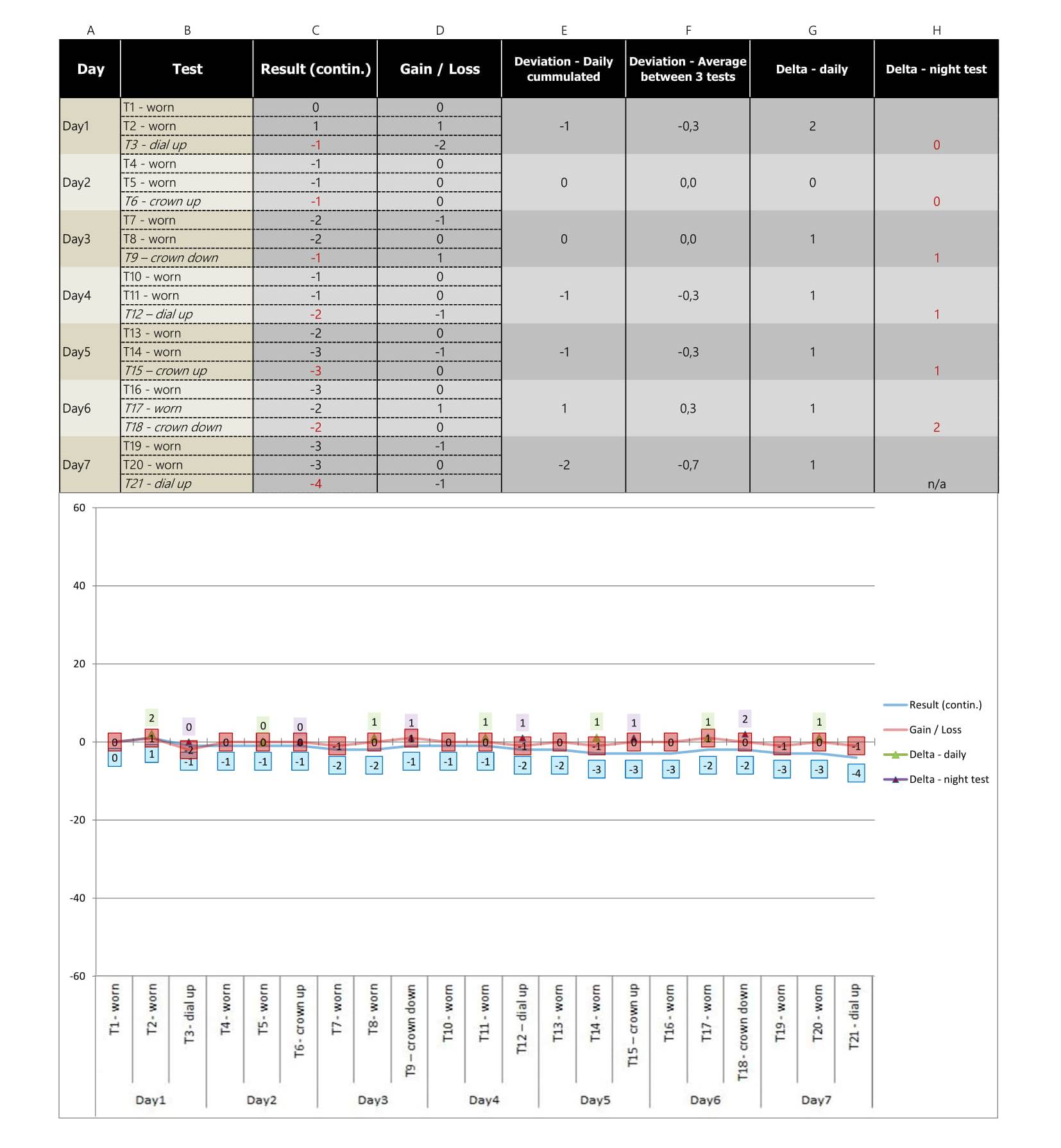

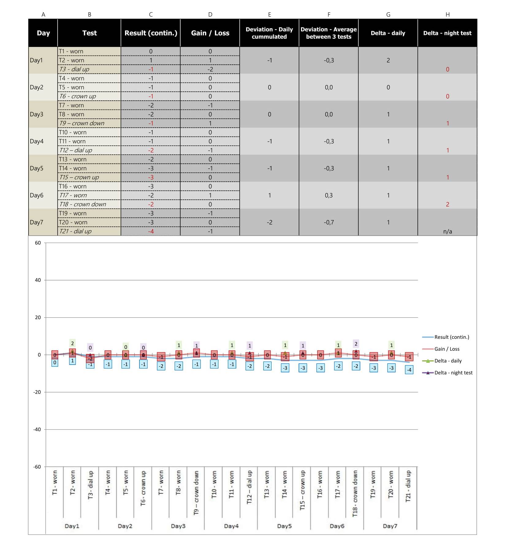

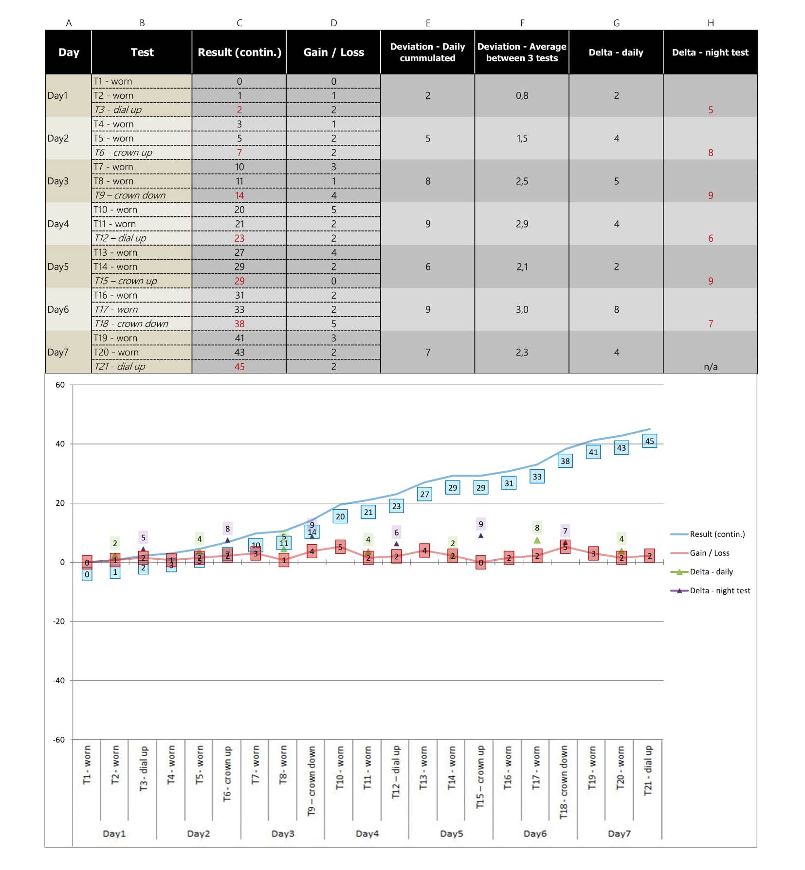

Hey SunTiger, sounds like you are tracking the watches just like me😀
'time.is' is my reference point, first I manually wind the watch up (fully) then wear the watch whole week and check the gain/loss 3 times per day, I do my best to do the check at the same/very similar hours, every 8 hours let's say.
For the night I put the watch crown up, or crown down of face up.
Then I put it into a spreadsheet and calculate delta(1) which is delta between 3 daily checks, and also delta(2) which is focused only on the night results when watch is resting in a various positions.
I think this is the simplest method to do your homemade-COSC-light test (temperature and atmospheric pressure I don't care).
Should the watch not run any faster when face up?
No, it is not a general rule, all depends on the watch/movement how it reacts to a various position, have a look here please;
This is my very consistent aka boring as hell watch which does not care much about the positions;
and here is the watch which does not like resting in "crown down" position.

It is probably each to their own. Some put a watch on a timegrapher, others will use apps to track the accuracy, I am not a fan of those apps as they measure an average between the days/test results, that's kinda funny method me thinks. Some other people will log the accuracy in the own tests.
As you are already on your own log, do consider checking a delta between the various horizontal&vertical positions😉
Have fun!

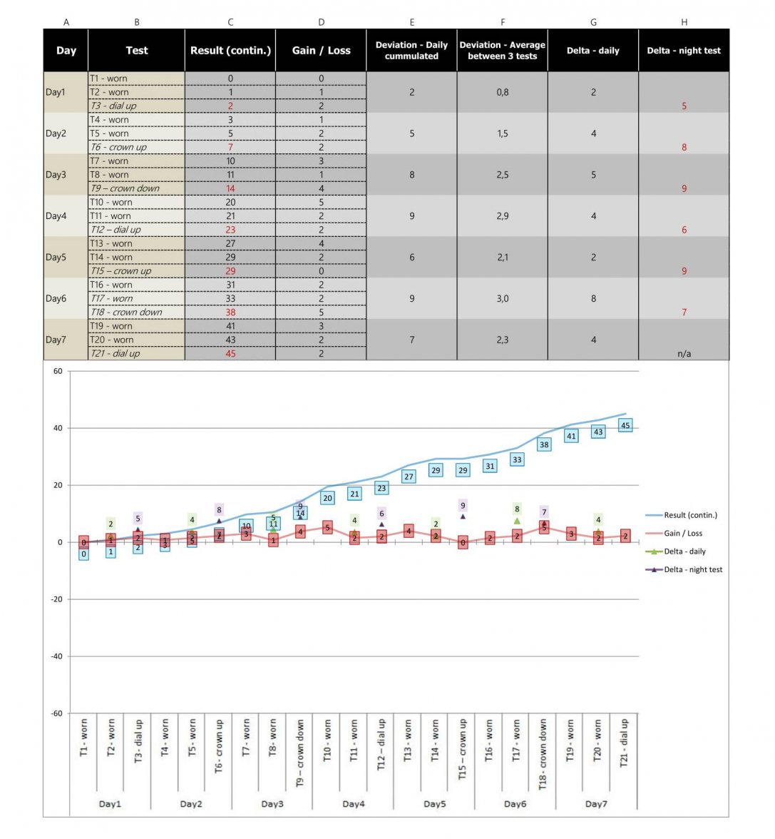

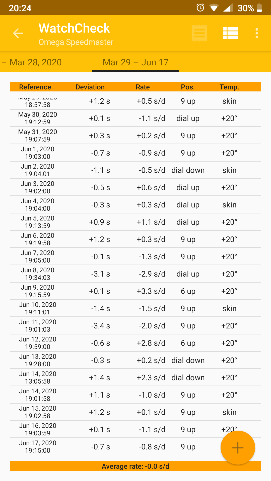

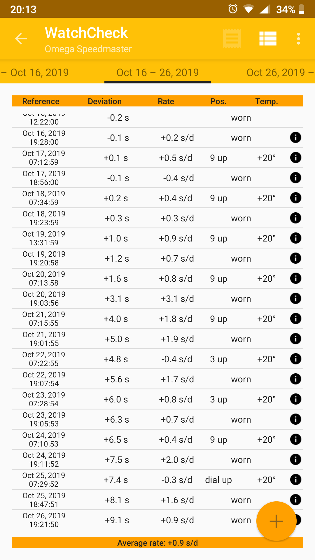

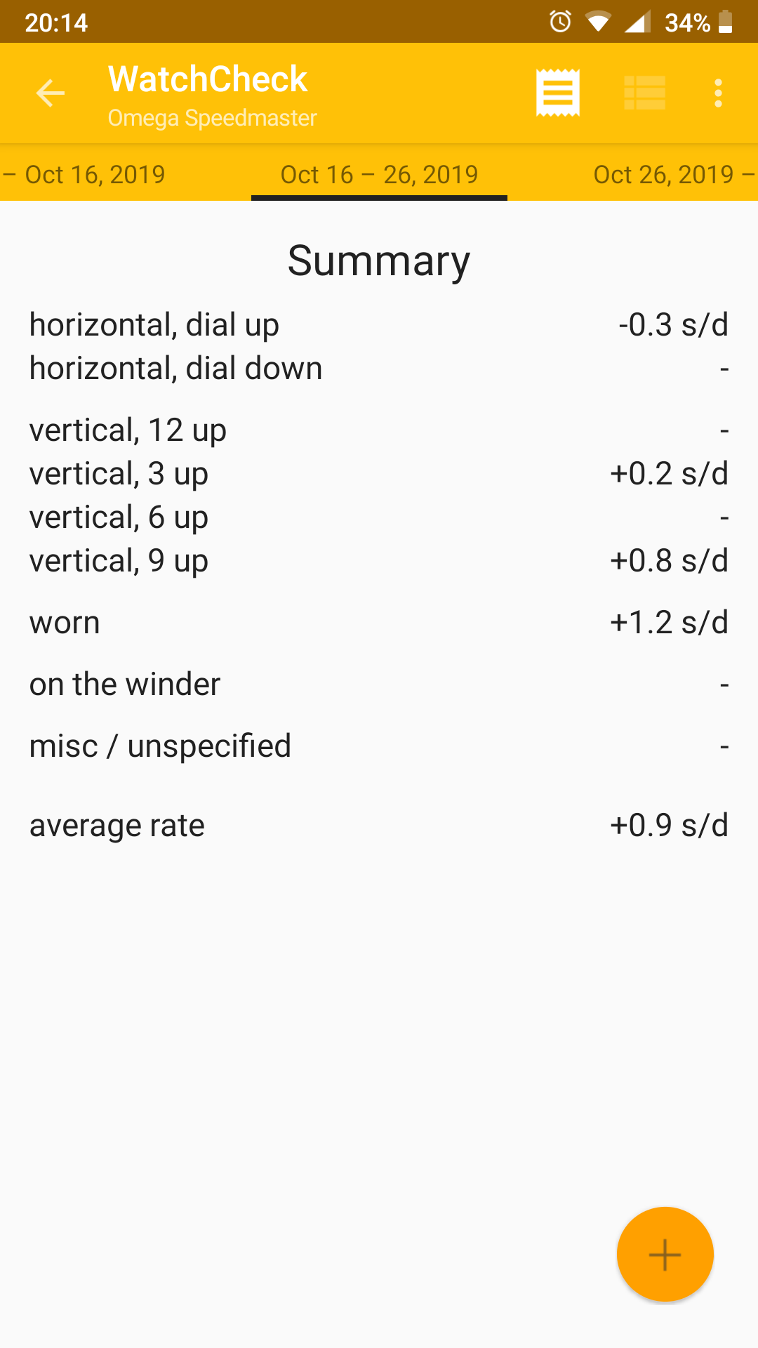

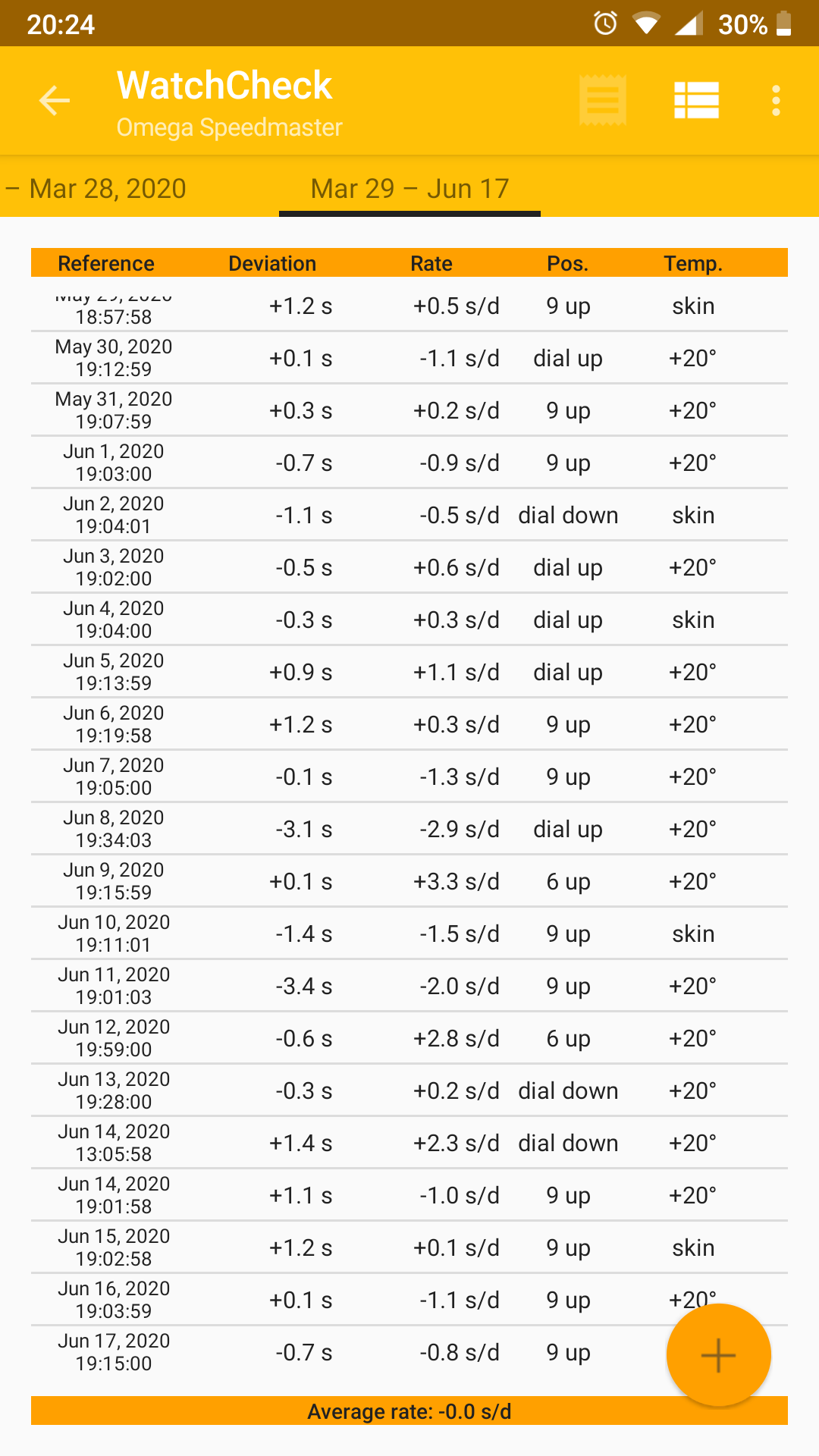

That's quite extensive tracking, I don't want to put much effort into it so an app is sufficient with 2 checks a day : 7 am(after resting) and 7 pm (after wearing). Gives me enough info what I need to do to keep the zero over time.
Added pic of current accuracy with 1 check a day which averages resting position and wear over a full day.
