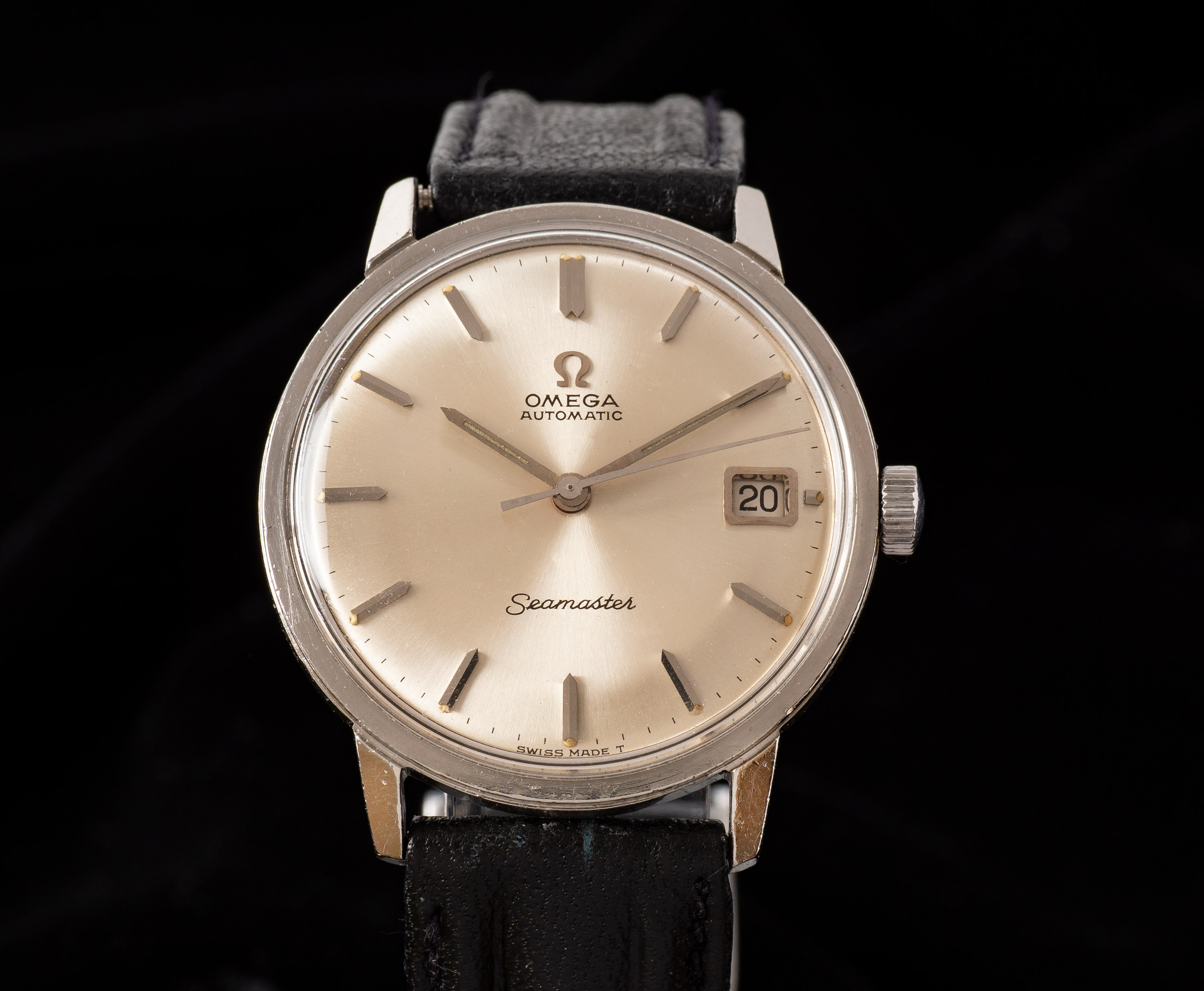

Can anyone give me an opinion on this please

How much would be a realistic price and are ther any glaring errors i've missed?

Always better to post the actual photos rather than the link but the seller gives nothing away in his description and you need to look carefully at the photos.
There's no indication of how it’s running, other than 'fair condition' or when it was serviced. The sweep second has moved in the photos so it’s probably running.
On the positive side, the crystal is signed which is generally a good sign. The buckle looks both old and original. The dial, in my opinion, is original and the case doesn’t seem polished. The fact that the strap is old would support that, for me.
The 562 movement looks clean and I’d guess that the crown might be original. I can’t see the details of the caseback but I’d guess it’s a 166.*** with a diameter of about 34.5. You’ll probably have to factor in a service for £100-150, and hope the parts are okay on this 55 year old watch.
There are already a number of bids in and with a day to go, I’d expect the price to rise by £100-£200. The seller is only selling this one watch and is probably not a dealer. His eBay reputation looks okay but it doesn’t say what he sold previously and he hasn’t traded since May 2019.
So, do you feel lucky?

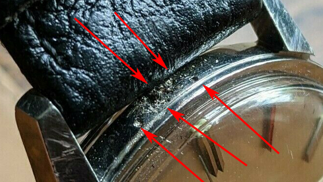

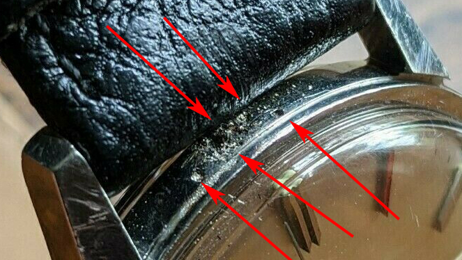

"The main bit of marking on the case is shown in one of the photos but is hidden by the strap."
Those craters belong on the moon not a watch case.

The seller has advised the watch was serviced 12 months ago (when he purchased it).

These craters are well described in one picture. I would have looked further for a better similar model. I also think that the watch has been relumed.
I thought that as well really by looking at that 3 o’clock and looking further. I’m just guessing but I would think so.

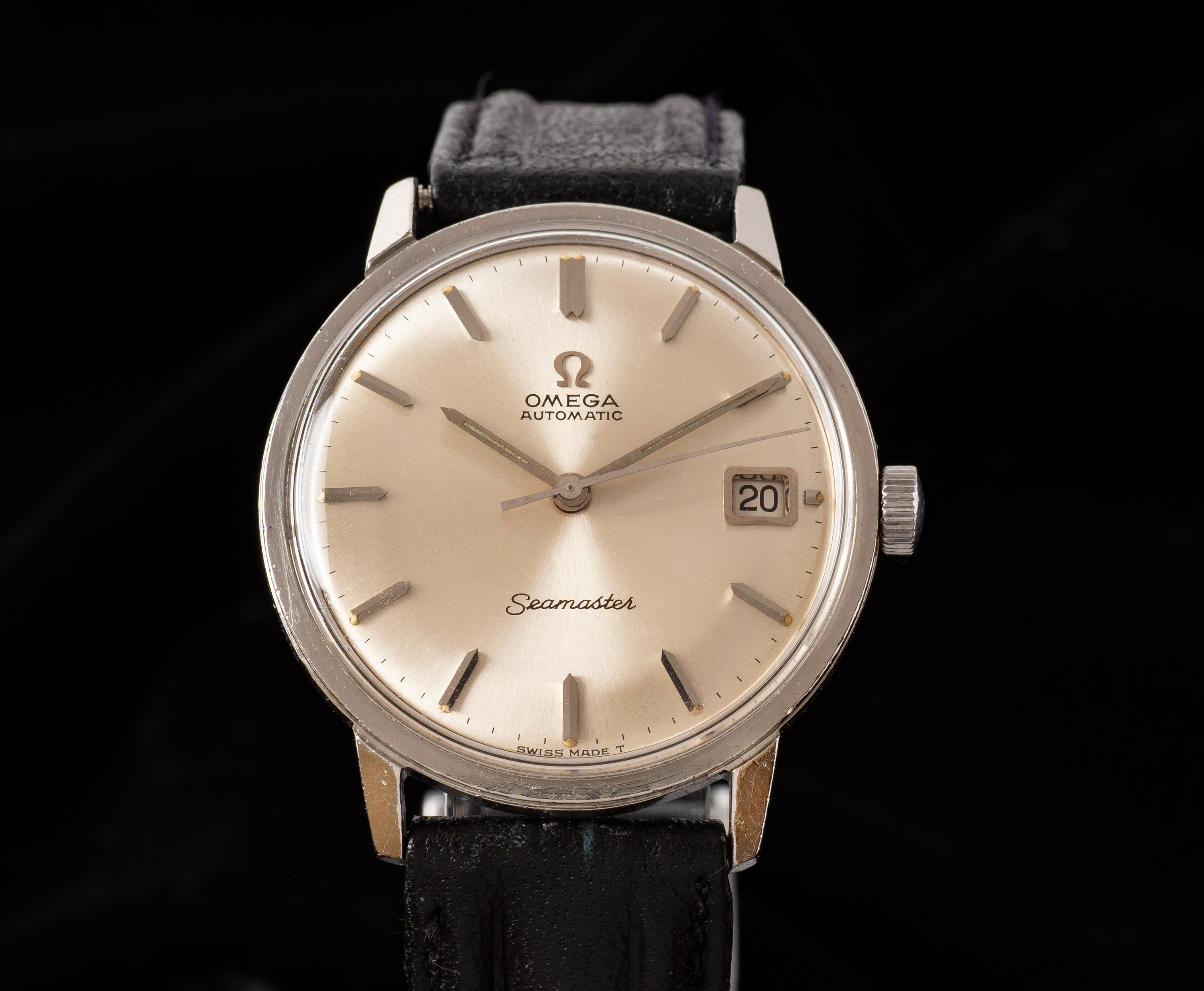

This reference is for me a classic and I think it´s never will go out of style. A clean dial with a case so beatifully designed and with a date function that actually is clearly visible and don´t disturb the design of the dial to much. "Less is more" 😀
Here is mine...
