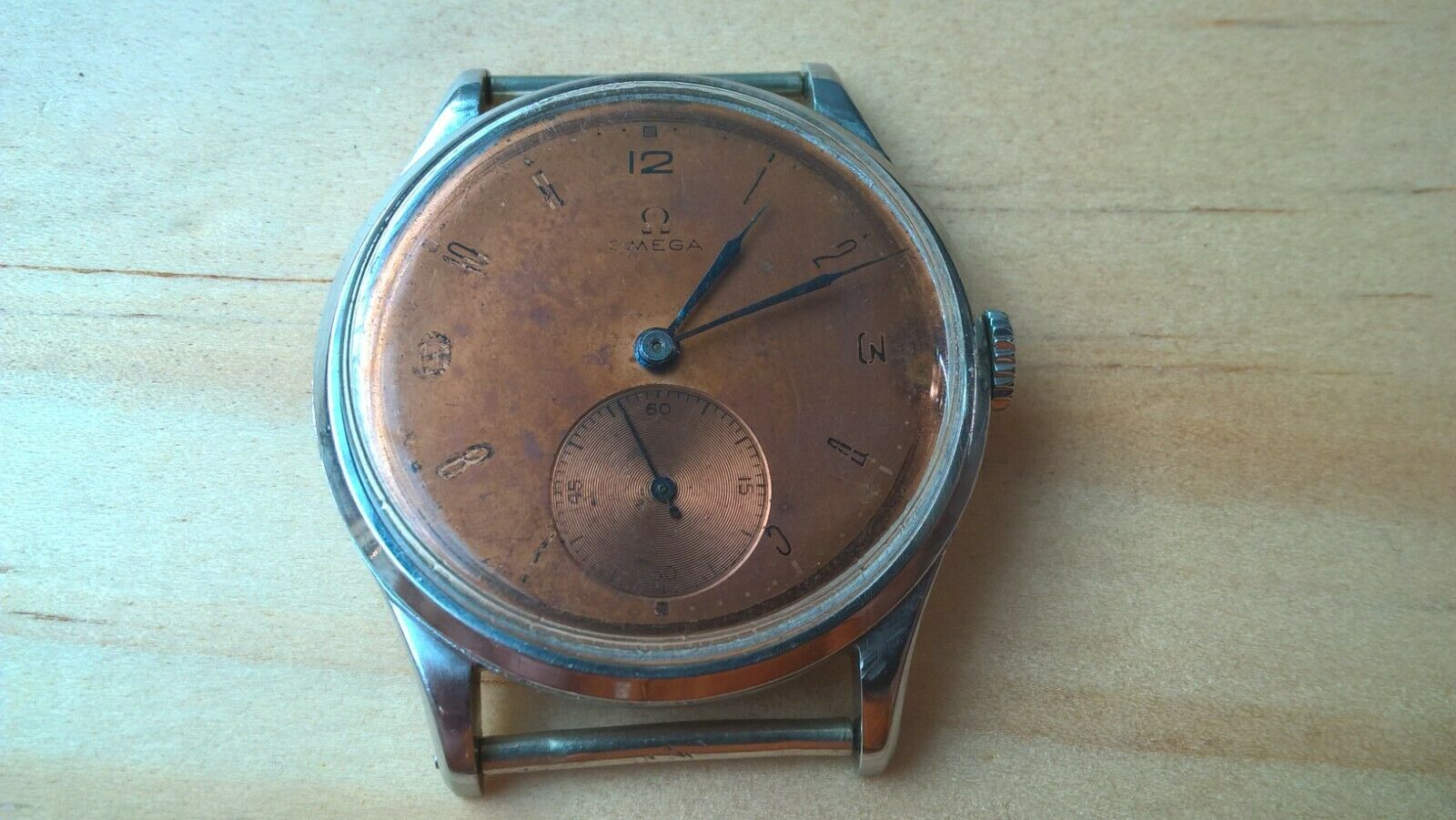

Why are you adverse to the thought (heat) blued hands are correct on a copper dial? I have seen them on an Omega at a major auction house (don´t recon which, I have only saved the photo as I liked the dial):

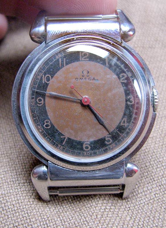

And here is one from my collection. I have found only a photo of the dial on my HD, the watch is in my bank vault atm.:
Both watches with cal. 30 T2

I've seen several copper Omega dials but can't recall any with blued hour and minute hands; that's why I was skeptical, Erich. But since there are examples of other references with blued hands complementing copper dials, then it's possible the original poster's example is correct.
I would feel more comfortable, though, if another example of ref MI 2214 with a copper dial and blued hands were found to confirm the likelihood of originality.
Best,
Art

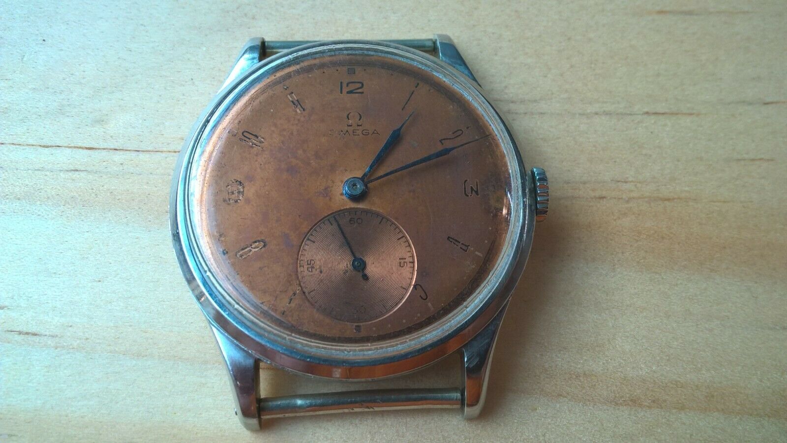

Art, sorry to contradict. You overlooked an important detail on the dial you showed: there are silvery metal dots at the uneven hours and there is a metallic "pearl minute track". So bright hands (white gold plated? rhodium plated?) make sense.
Here very aged blued hands on a cal. 23.4 Scarab... The minute hand has lost most of its blue colour but you can still see it on the hour hand:

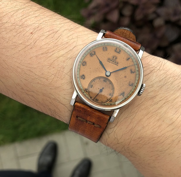

Thanks to Google search, here's copper dial from the same era . . .
. . . with blued hands all around. The likelihood of the original poster's MI 2214 having correct hands has gone up significantly.

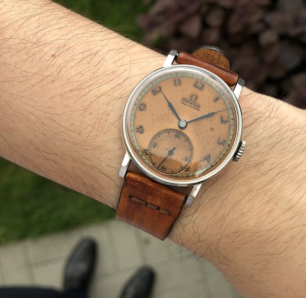

I came across this one too, so I'm inclined to concur (albeit with distinctly less knowledge 😵‍💫)
