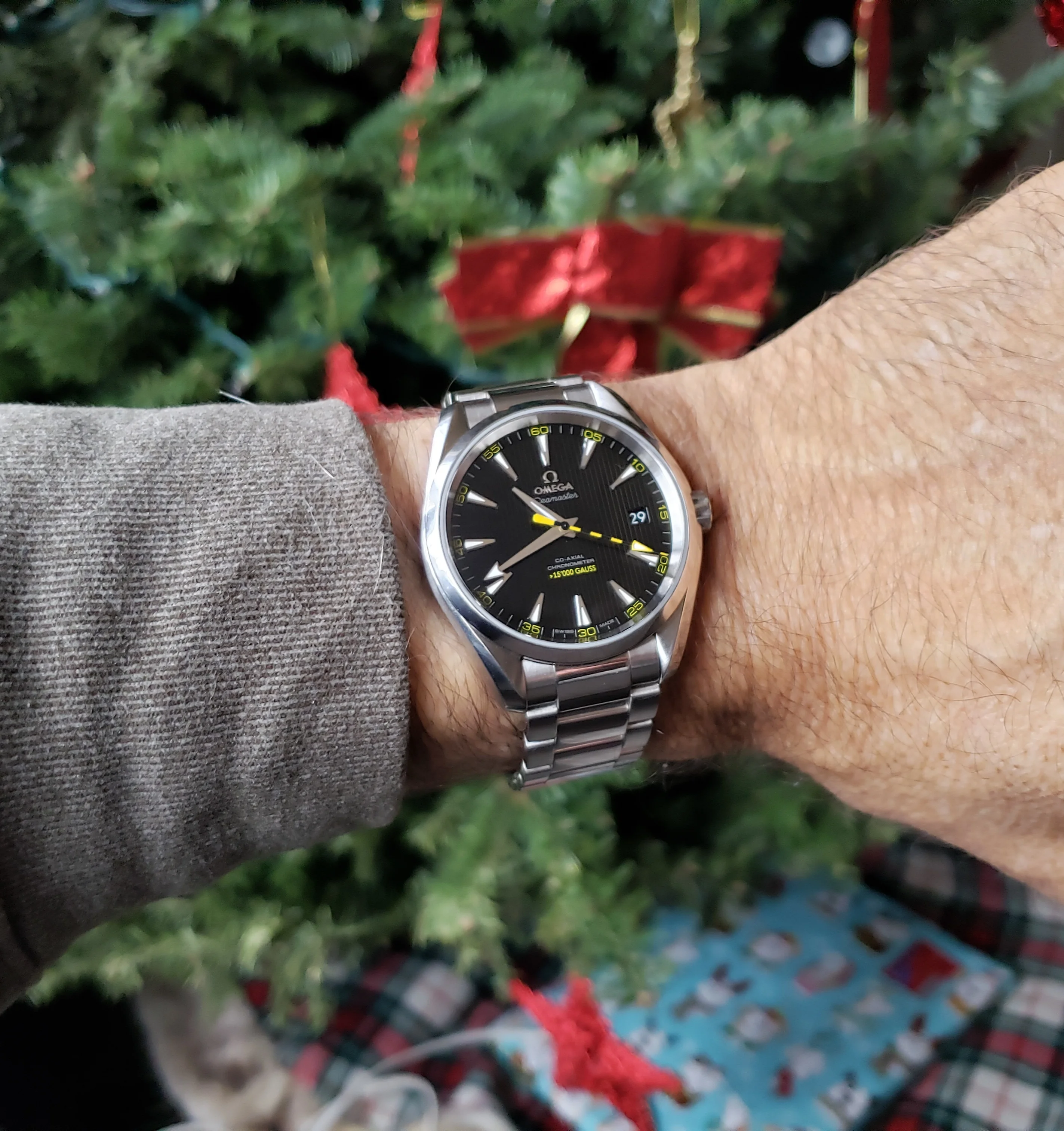

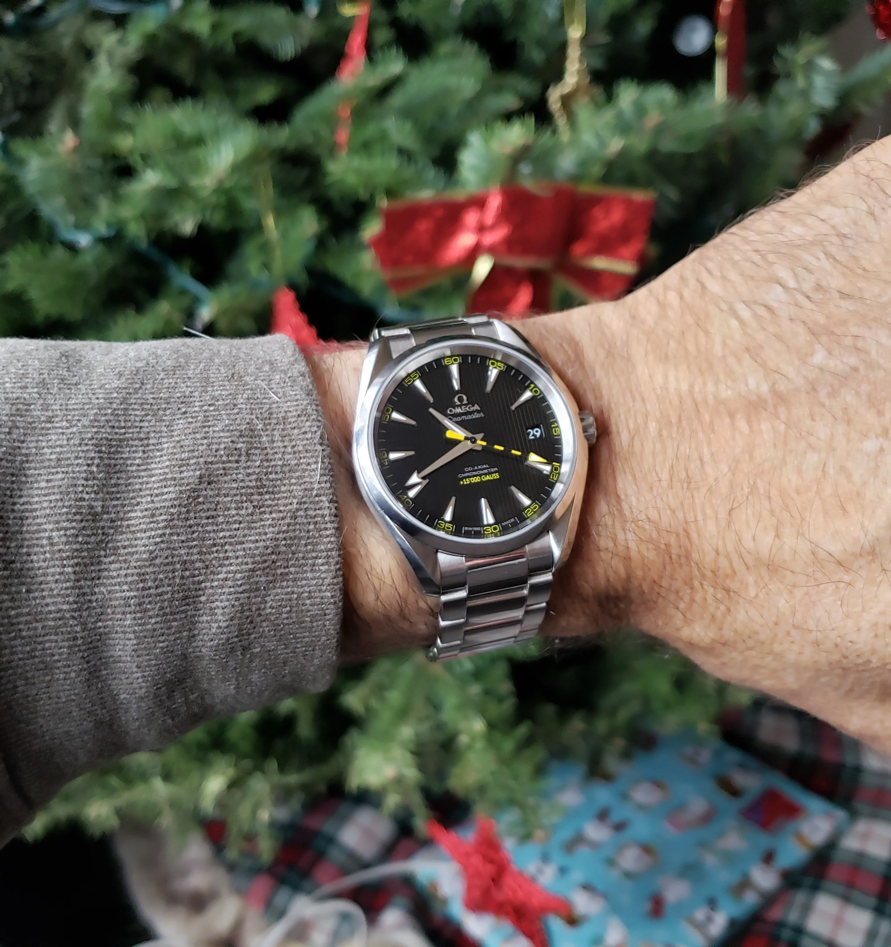

Did someone say Bumblebee? Funny thing was read the article on the forum a while back and always said "If I was going to add an AT, that would be the one." Right before Xmas this year, had the chance and wasn't going to pass on it.
The yellow and black second hand plays well against the vertical teak pattern and yellow accent color.
