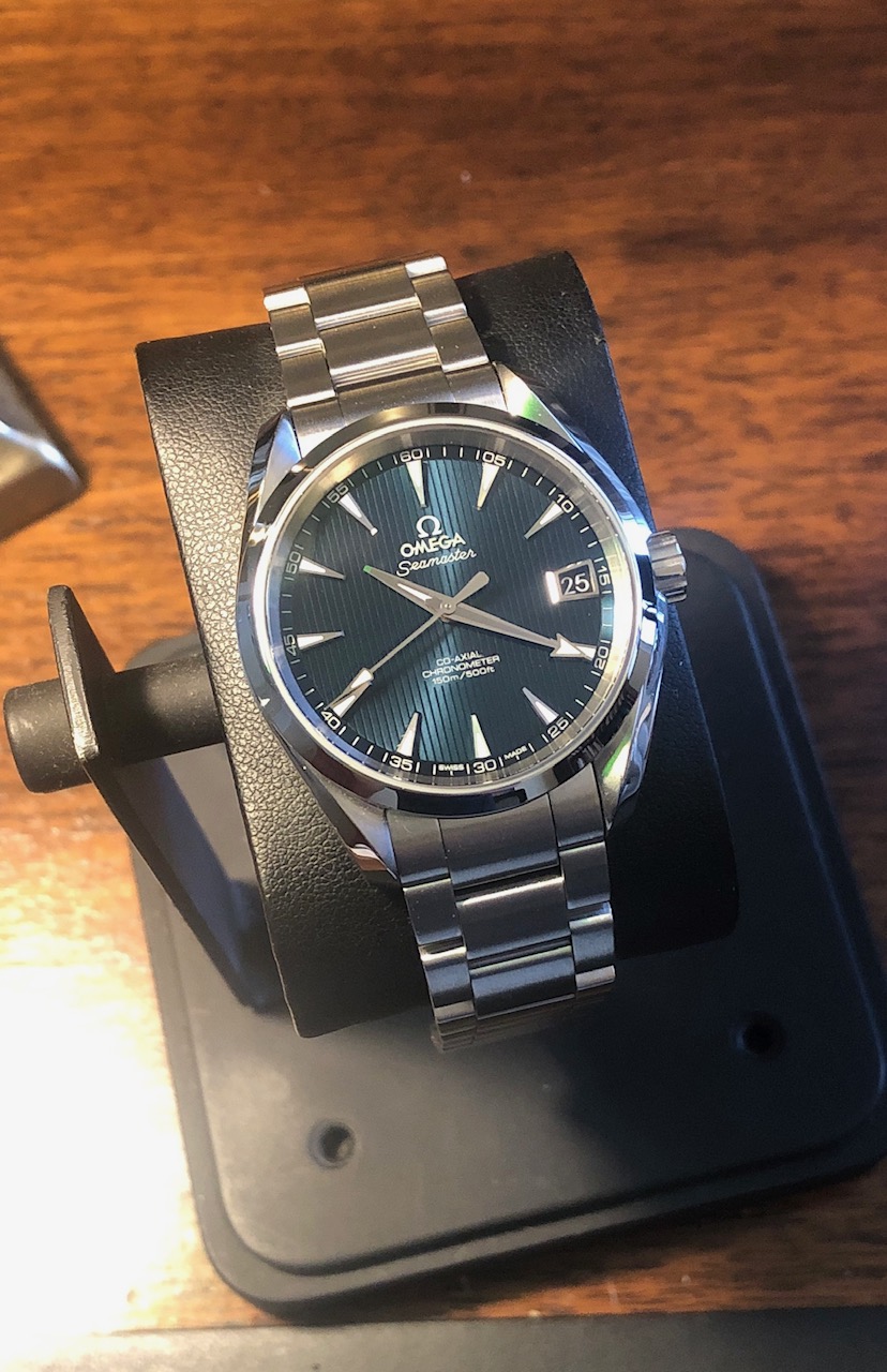

The Skyfall 38.5mm Aqua Terra I recently bought was made in 2013 or 2014. I'm near 100% certain now it will have the Si14 hairspring. Which is pretty cool.

We should know by the end of the day as it is out for delivery. 馃榾

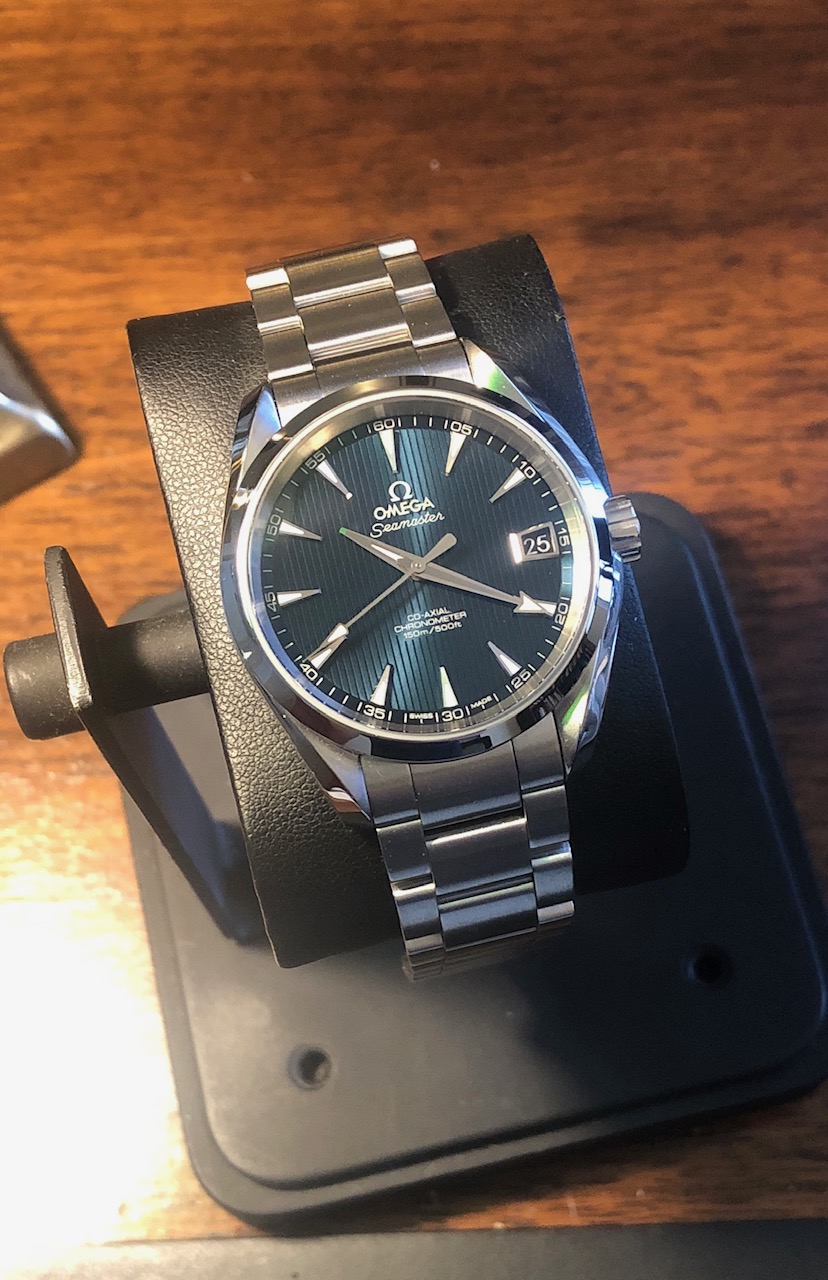

It's here. Hairspring is confirmed Si14. Both by checking the spokes on the balance wheel (it is etched with Si14) and the Pictogram card.
