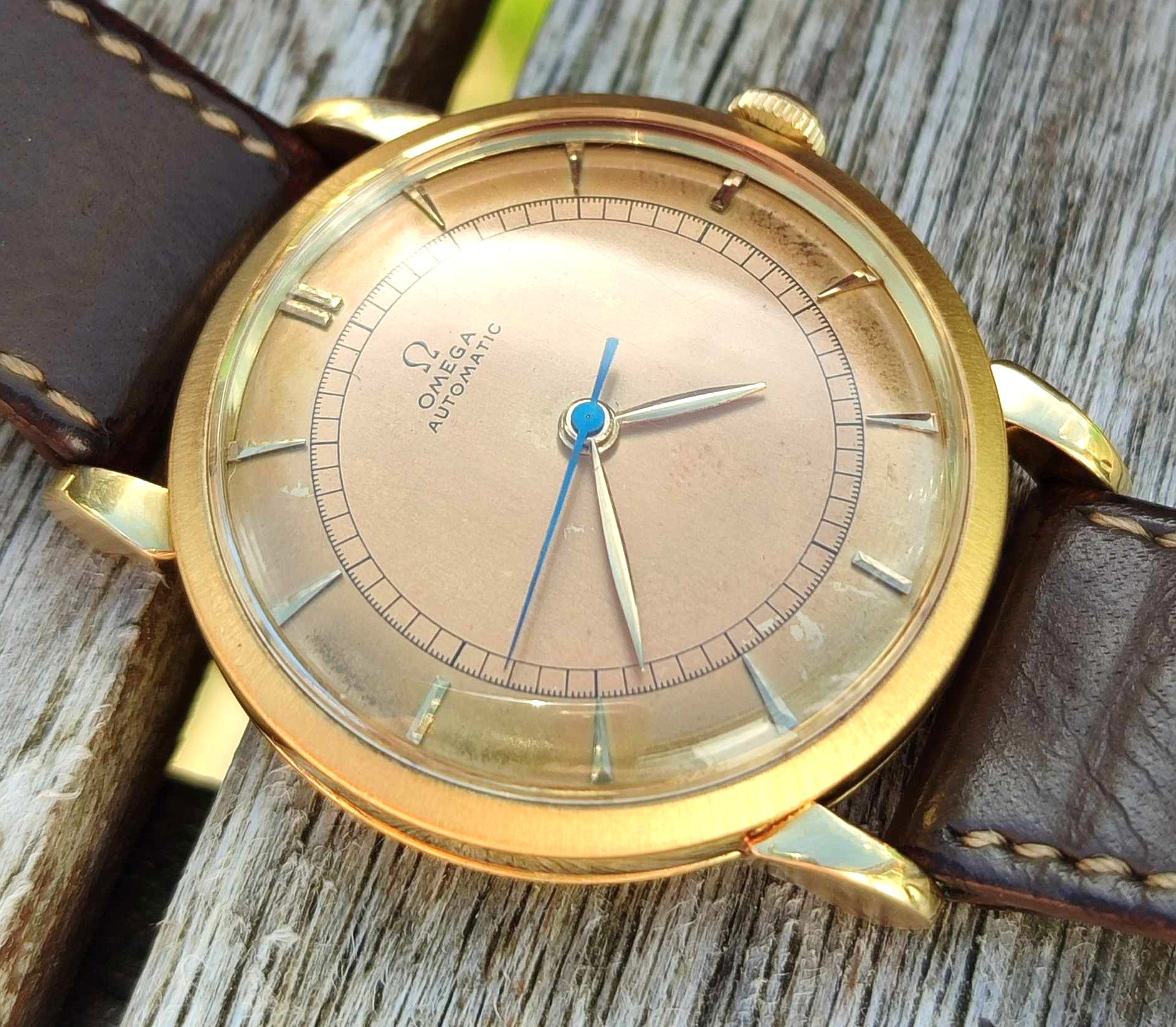

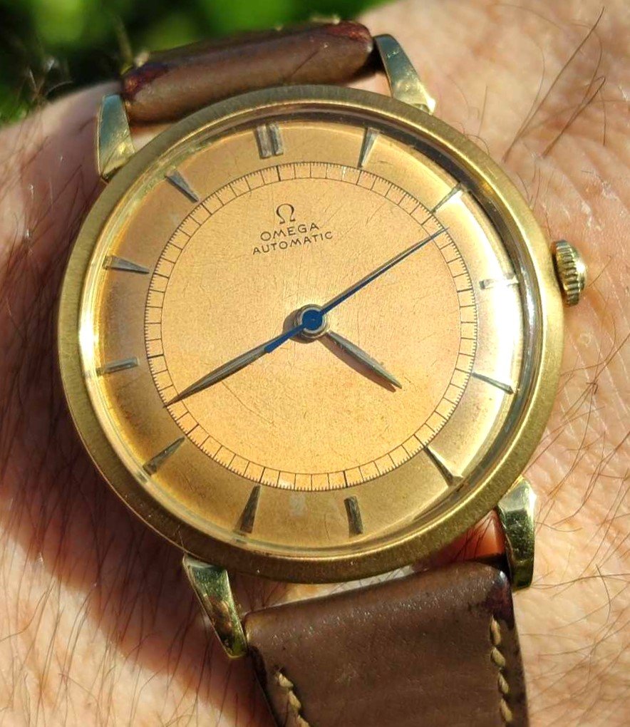

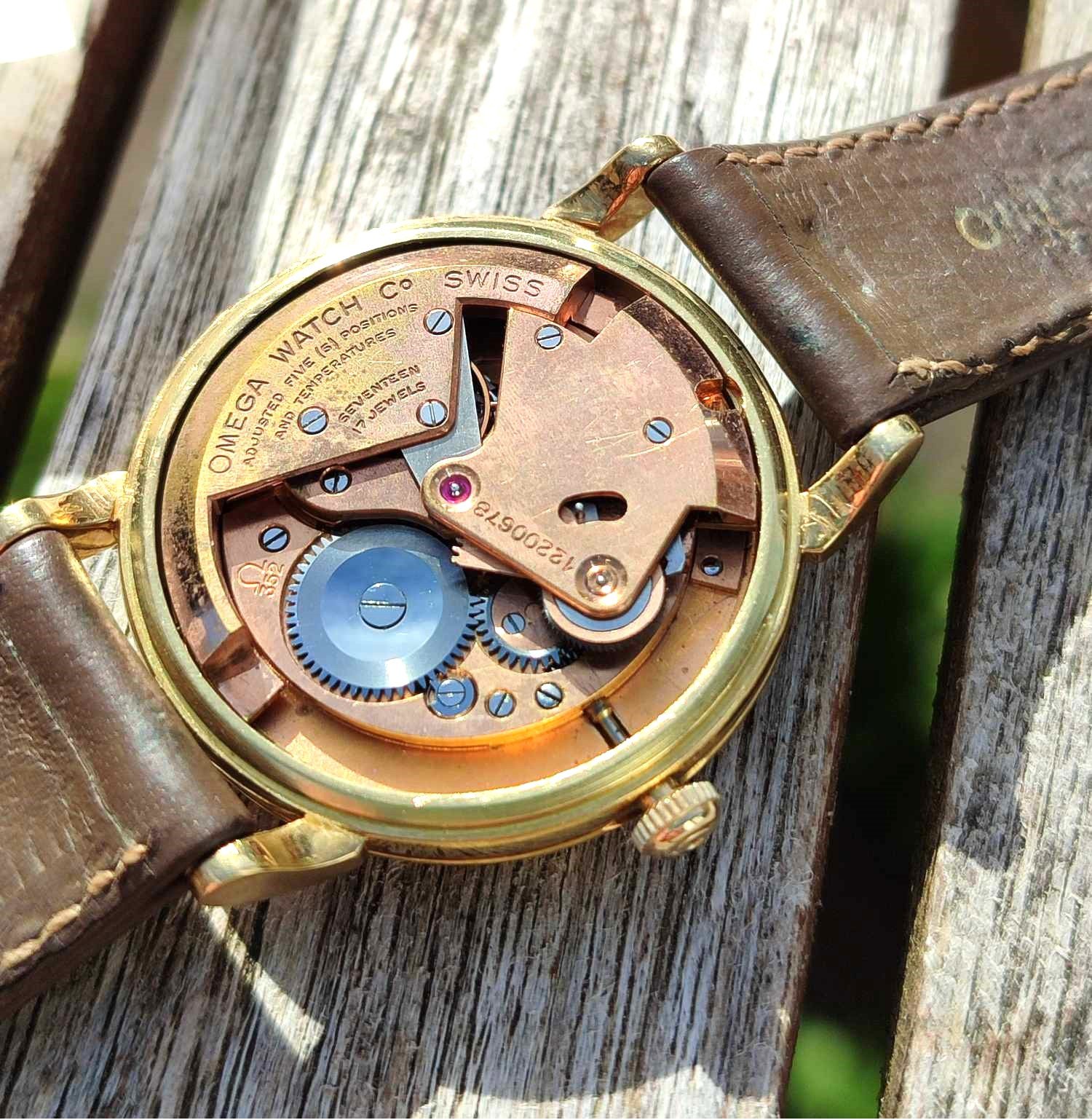

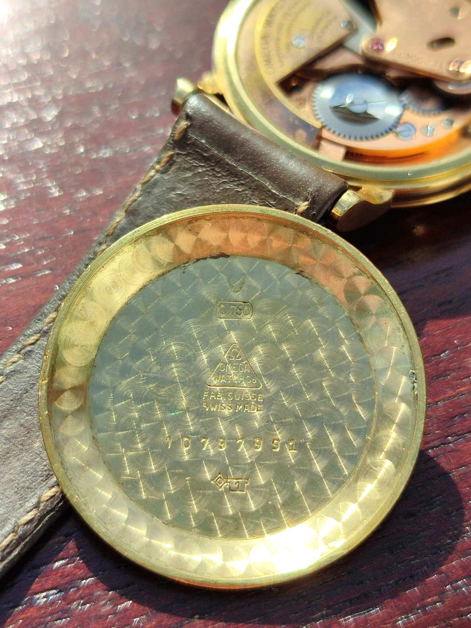

Have you come across a watch that has a movement cal 352 without a marking on the chronometer dial? It's nice, but isn't the case number 10 million too far from the movement number?
13,624
18,978
The general style and the case serial number says late 1940’s to me, but the cal. 352 movement wasn’t introduced until the early 1950’s.
My thought is that this piece was “upgraded” at some point.

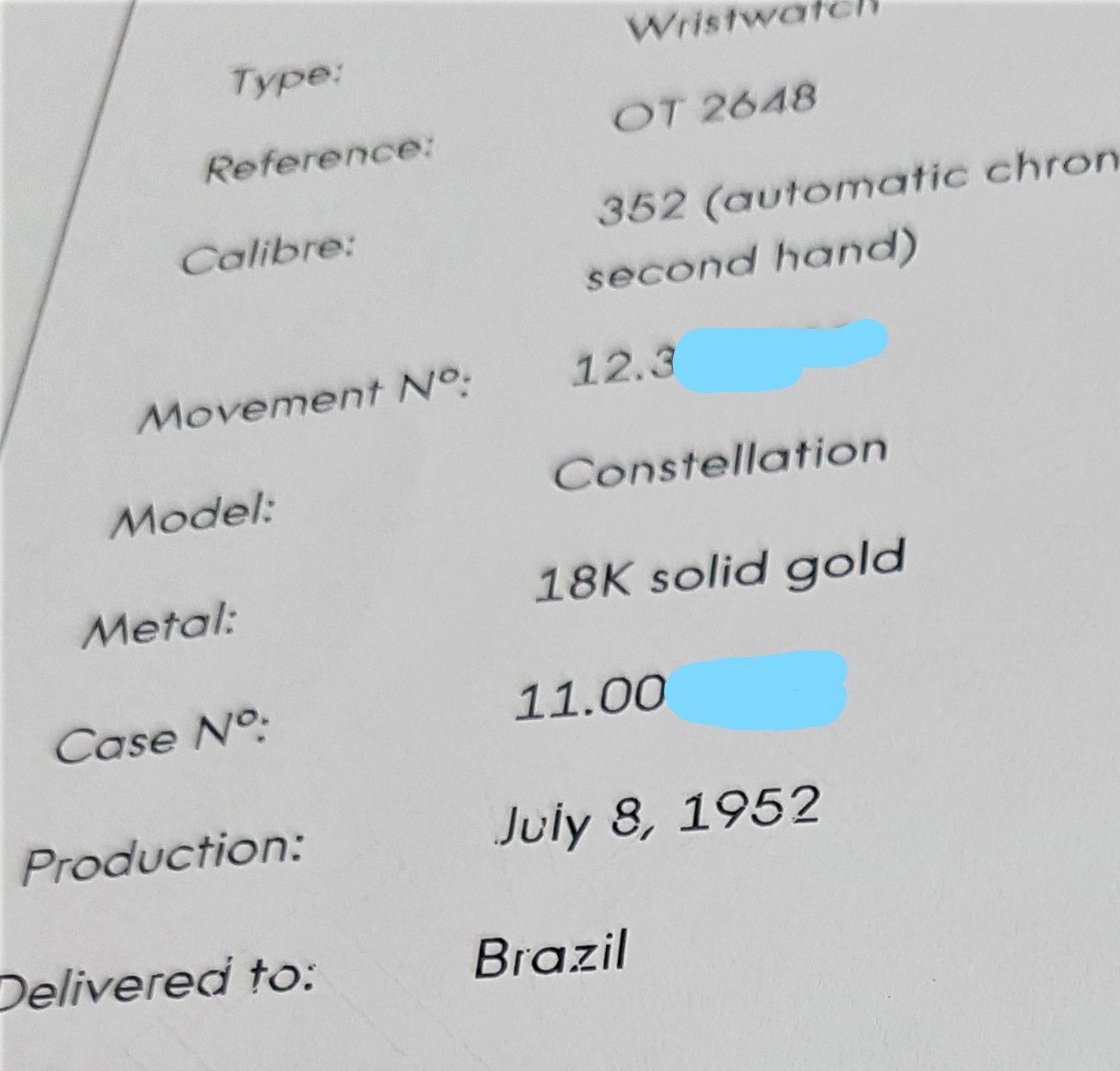

I thought so at the beginning, but when I started looking through case and movement 2648 numbers, the difference no longer scared me so much. It's a pity that 2517 didn't have a numbered case. Couldn't it be that in the early 1950s, before 2517, they put this movement in this case and added the Omega Automat dial?
In total, 2517 (1000 pieces) were tested on the chronometer and only after these tests was the chronometer added. Am I somewhat right?
Not sure what you are asking about here. My point was that chronometer rated movements were matched with dials that said “Chronometre”. Your watch does not have that. Therefore, either the movement or the dial was switched.
Somewhat. It is true that 1,000 consecutive Omega movements passed chronometer tests in 1949. These were all caliber 352. However, all had serial numbers earlier than your example. Also, I have not seen any of this group of movement serial numbers in an actual watch. You can read more about this here:
http://download1336.mediafire.com/y...p0t79p66ubj/Omega+History+Making+Movement.pdf
Hope this helps,
gatorcpa
