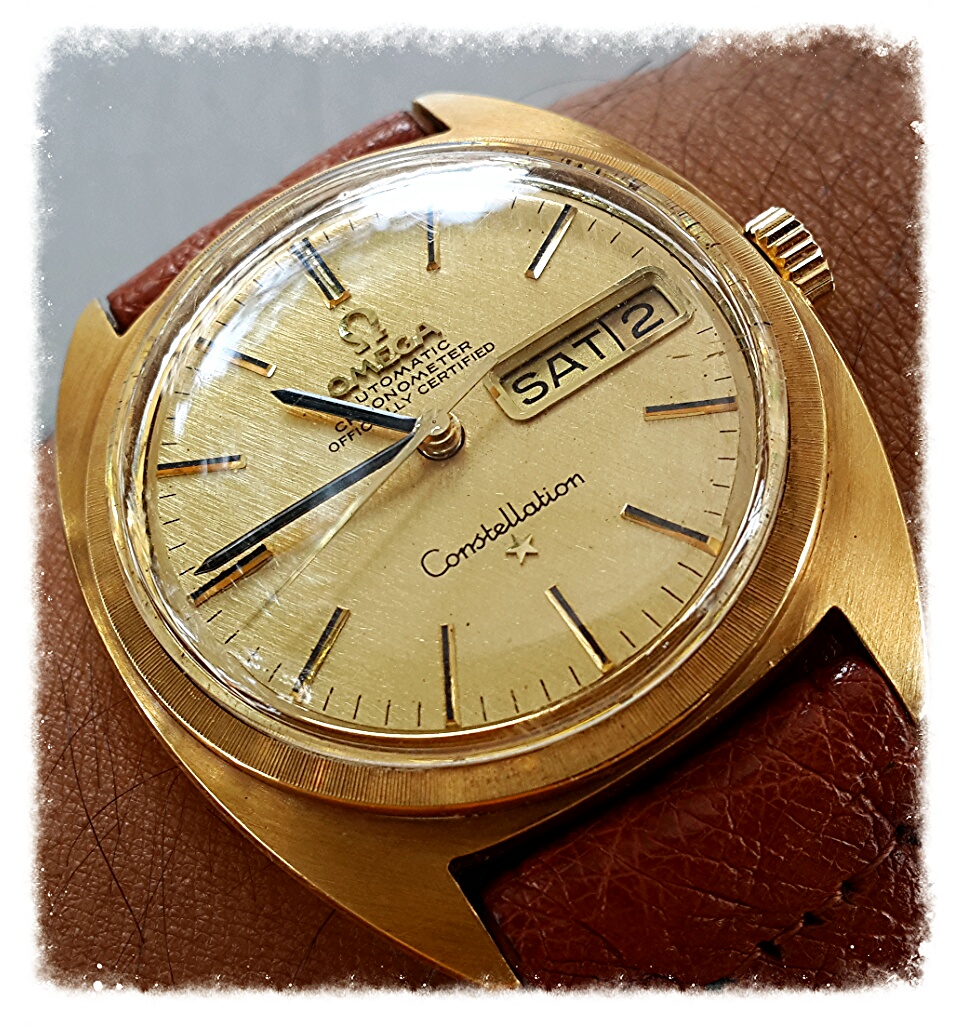

C Shape Connie Fake ?
1,026
570
I dont think it is fake.

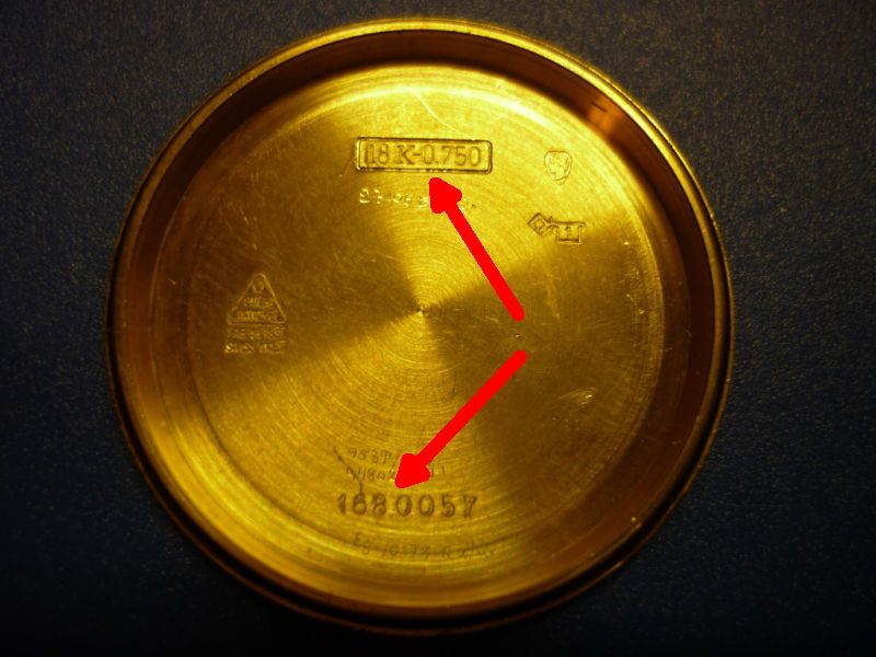

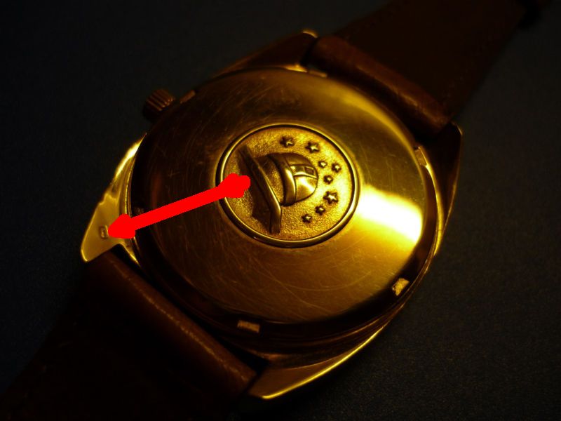

what hallmarks are you looking for?
1,026
570
for your reference
29
85
Thank you for the fast answer
I thought about hallmarks I marked in the pictures
It is my later C shape with the 1021

Didnt pay attention to that..
My bad i thought your were referring to the case back constellation/waterproof stamps
anyhow @ulackfocus is a C Connie master hopefully he will chime in.

Thank you
Congratulation ,a beautiful C Connie !
Dietmar
Thanks to ulackfocus that's one of the rarest c connies, I am glad it still have it (I thought of selling it a while back)

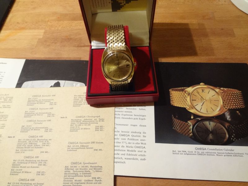

Hi
Im searching a C Connie 18k with the 751
http://www.ebay.de/itm/201229820461?_trksid=p2055119.m1438.l2649&ssPageName=STRK:MEBIDX:IT
I can see no hallmarks on the back side and a back case I never saw before ,only one mark
Fake or not ?
Dietmar
Something is not right with that watch. The caseback is wrong on both sides - as if it were made by somebody other than Omega. Look at the ring around the medallion to start, then the lack of hallmarks (inside caseback and back side of lugs as noted), and the way the bezel comes ALL THE WAY to the 9:00 edge of the case without the usual small brushed surface between the side of the case and bezel. Unless some other member can explain these discrepancies I'd pass on it.

I only can compare with my 168009 and the pictures above from my 1021.
@ aga 79 : can you please post a picture from the back.
