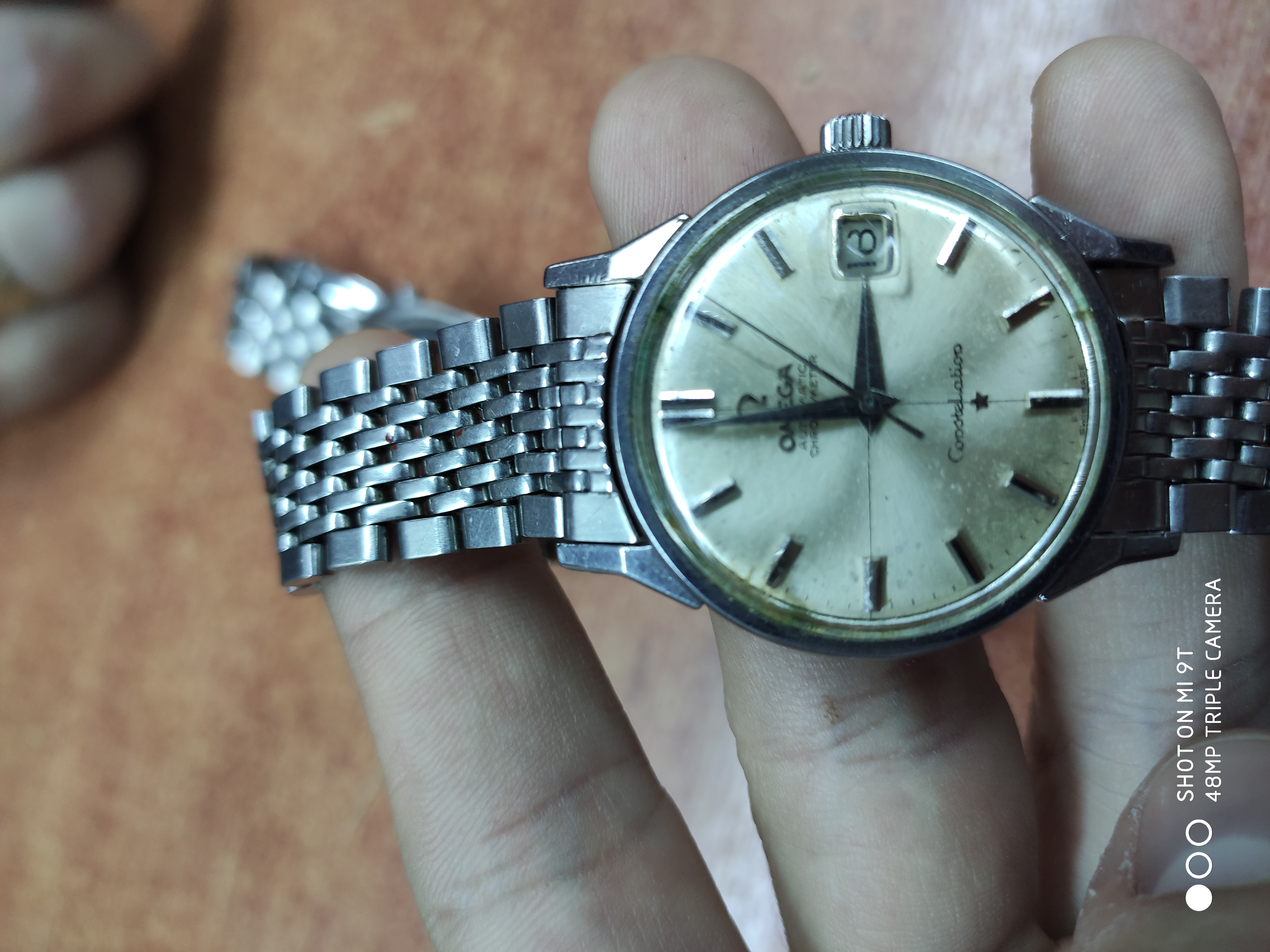

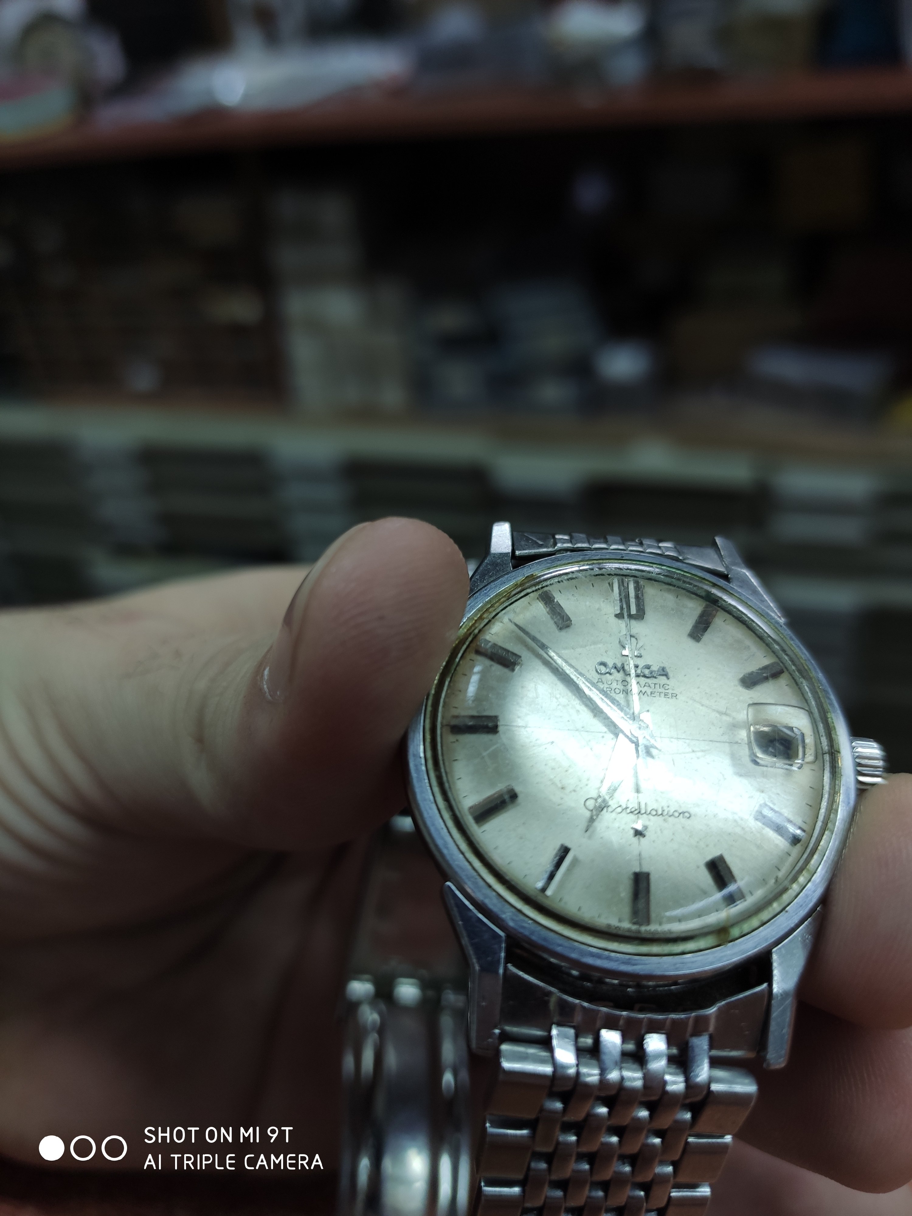

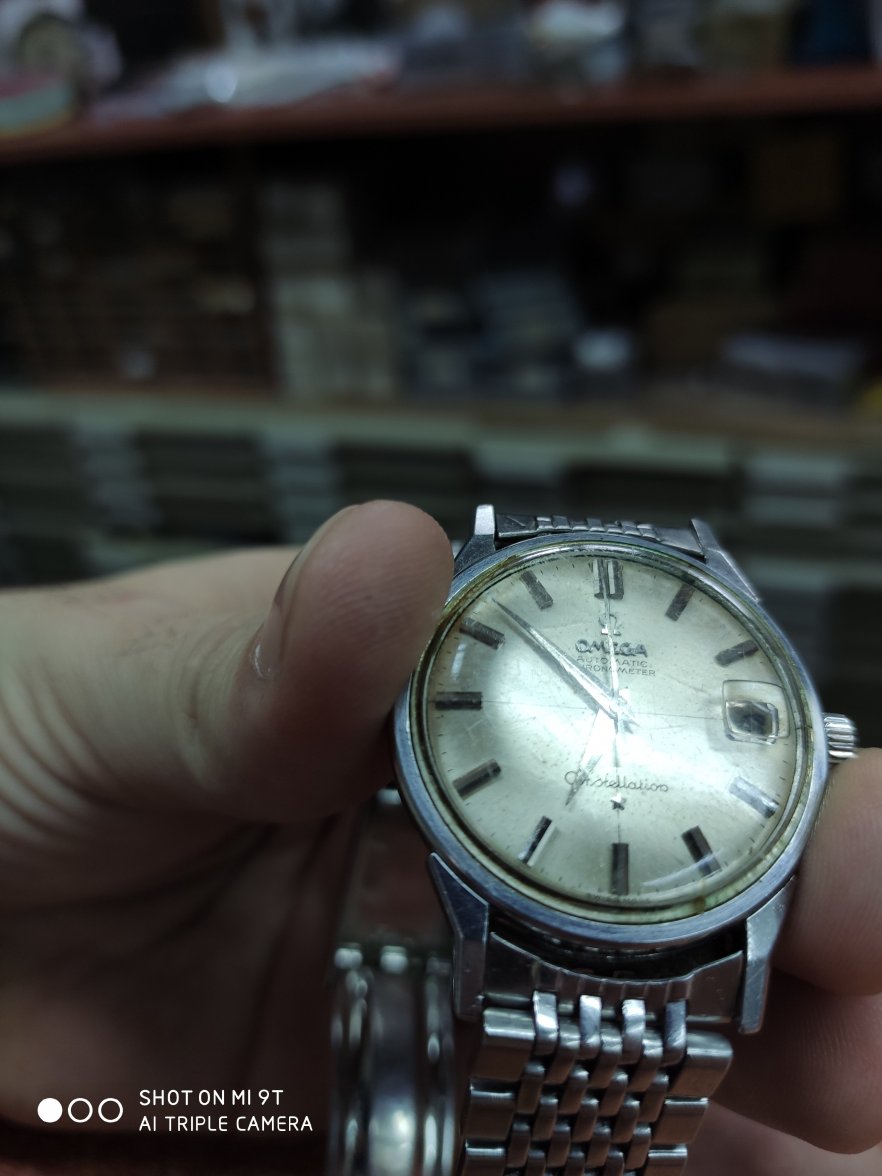

I couldn't agree more , ofcourse and I would like to buy a mint gold pie pan connie but my budget is not that high that's the reason Am aiming low with some work done this watch will look beautiful and as they say the beauty is in the eyes of the beholder in the end 😀 !! Few days in the omega forum and I learned so many things from you guys thank you , I really appreciate it!!

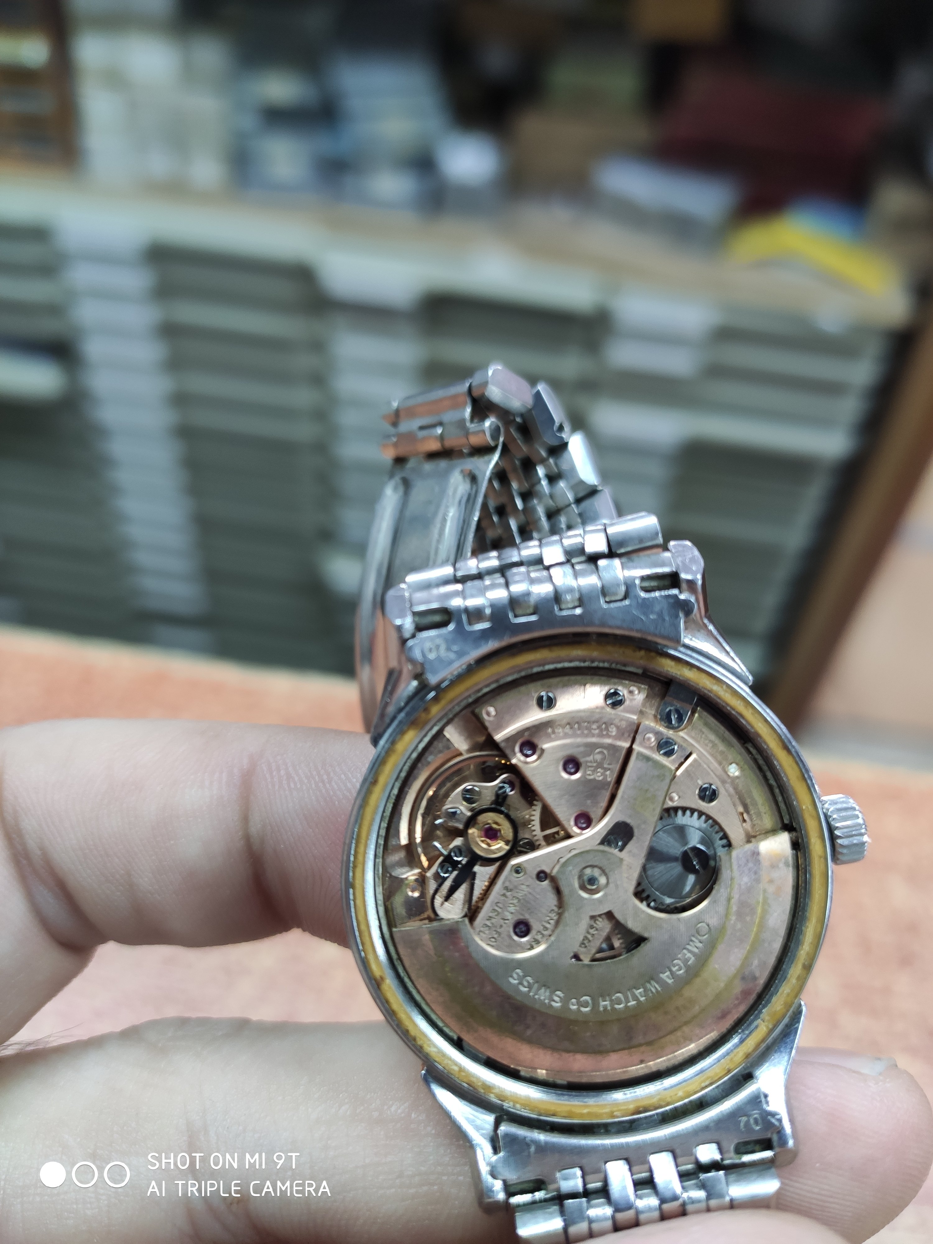

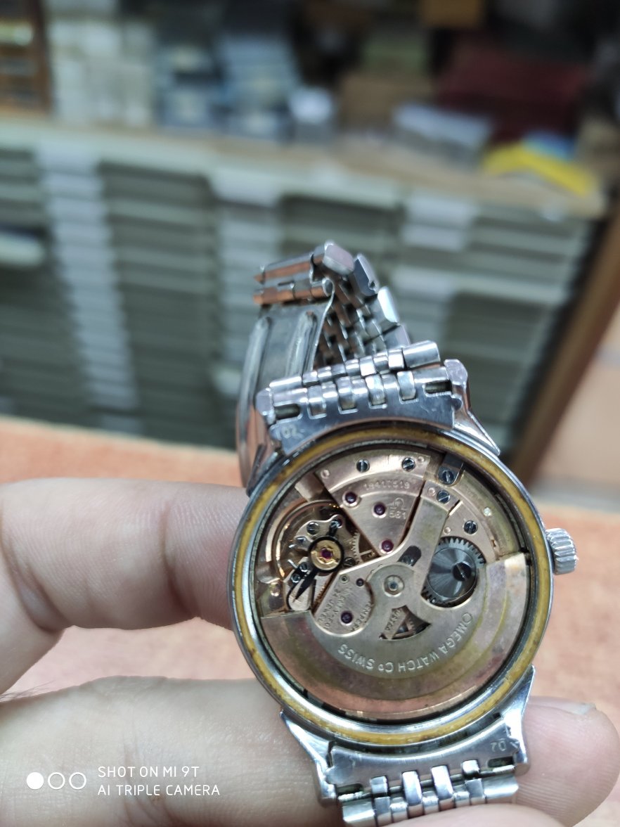

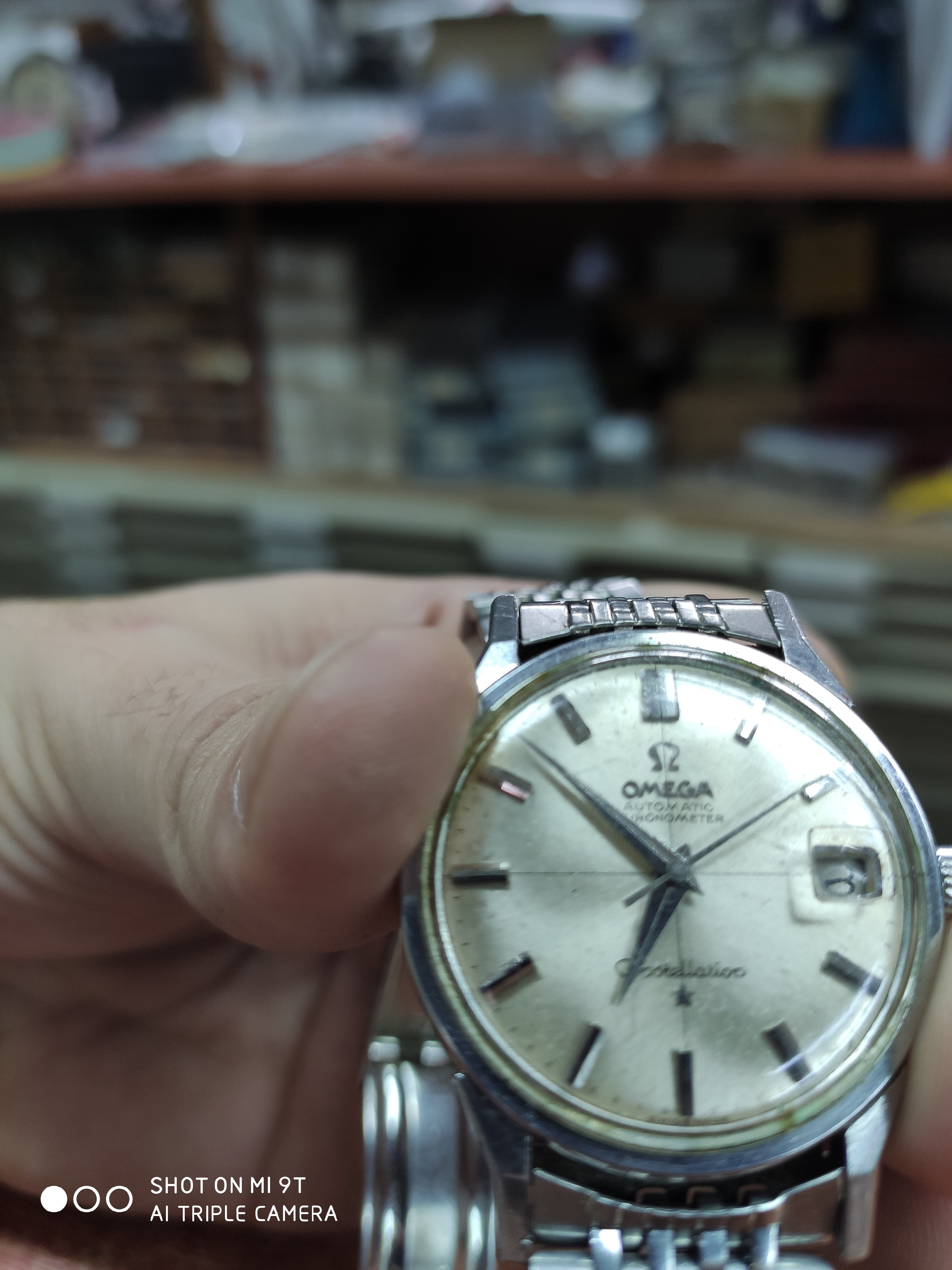

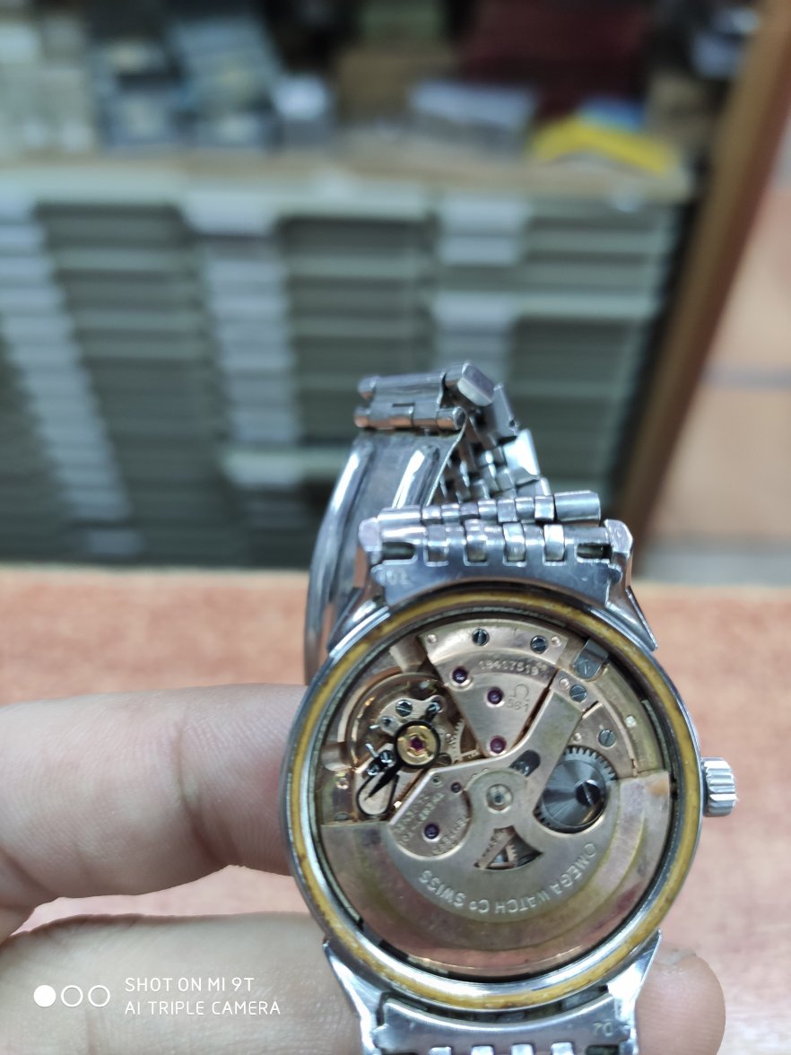

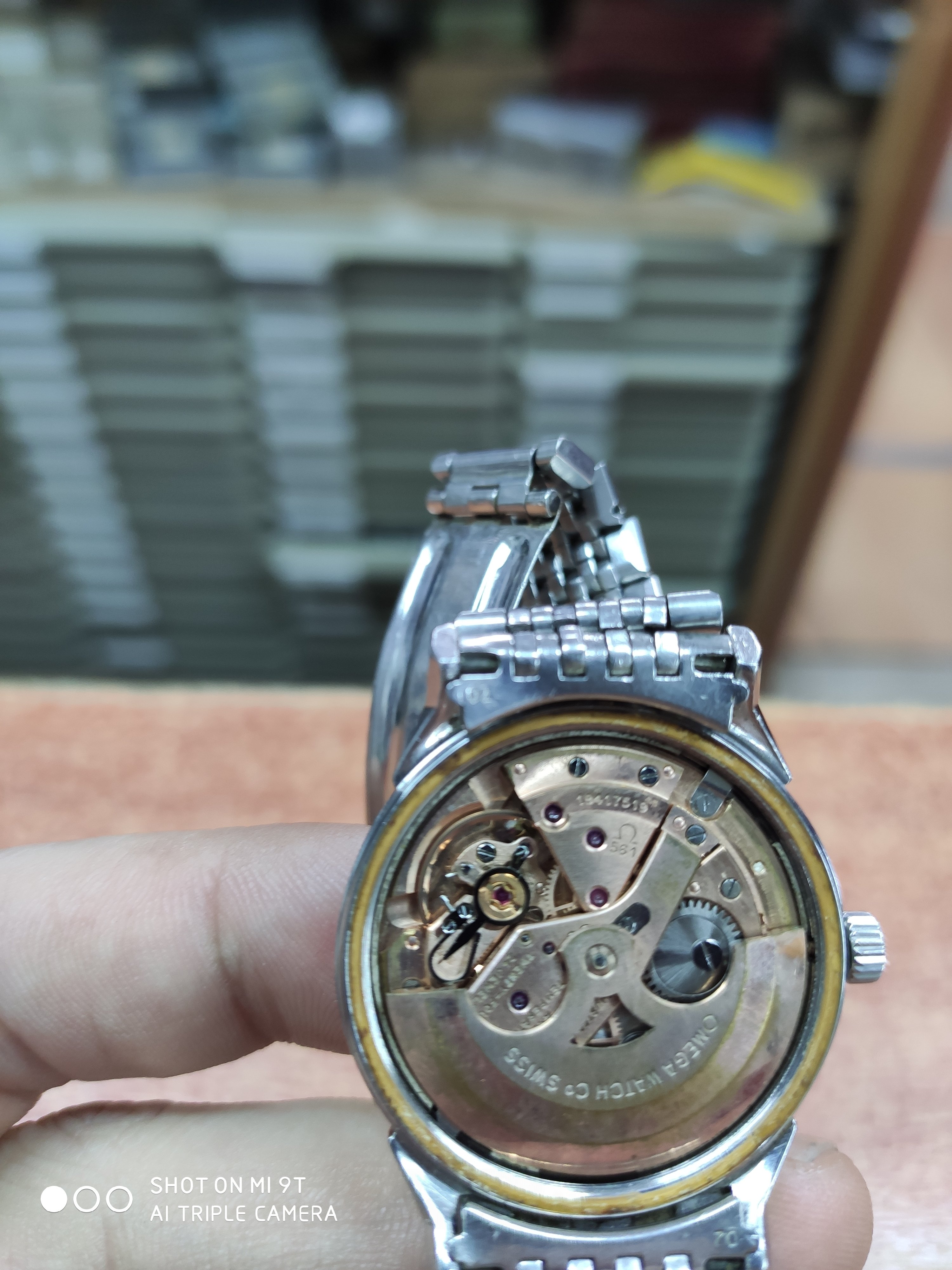

Quick update went to examine the watch a bit more the acrylic has a slight crack so it can't be polished , also i got a picture of the movement and a new price . He said he can sell it to me for €400 also for that price he will polish the watch , bracelet , service the movement and change the crystal .

I would do that deal. It would be worth the extra $50 or so to get the proper Omega crystal with a silver or “white” tension ring.
http://cgi.julesborel.com/cgi-bin/matcgi2?ref=Ome+cs#14902&submit=Search
I would also pass on the case and bracelet polishing. All it needs is to have the case and bracelet ultrasonically cleaned. Polish it too much and it will look like a melting ice cube which can never be repaired.
Good luck with purchase.
hlet himhim://cgi.julesborel.com/cgi-bin/matcgi2?ref=Ome cs#14902&submit=Search

Not even a little 😁?
Nope. Not even a little.
Buy this instead:
https://www.ebay.com/itm/Blitz-Two-...hing-Cloth-silver-gold-platinum-/383372544032
When the watch guy is finished, give it a surface wipe with that.
You do not want to take any edges off the lugs, or remove any more of the original finish on the watch case than necessary for sanitary purposes.

8,880
62,876
Address the rotor wear at service
Cool yellow case gasket.
At that price, a no brainer. Crosshair!

You will never find such kind of deal for a connie. At least for the next months.. If you like the aesthetics just grab it, And leave it alone. Just service and a little cleaning of case and bracelet with ultrasonic...
