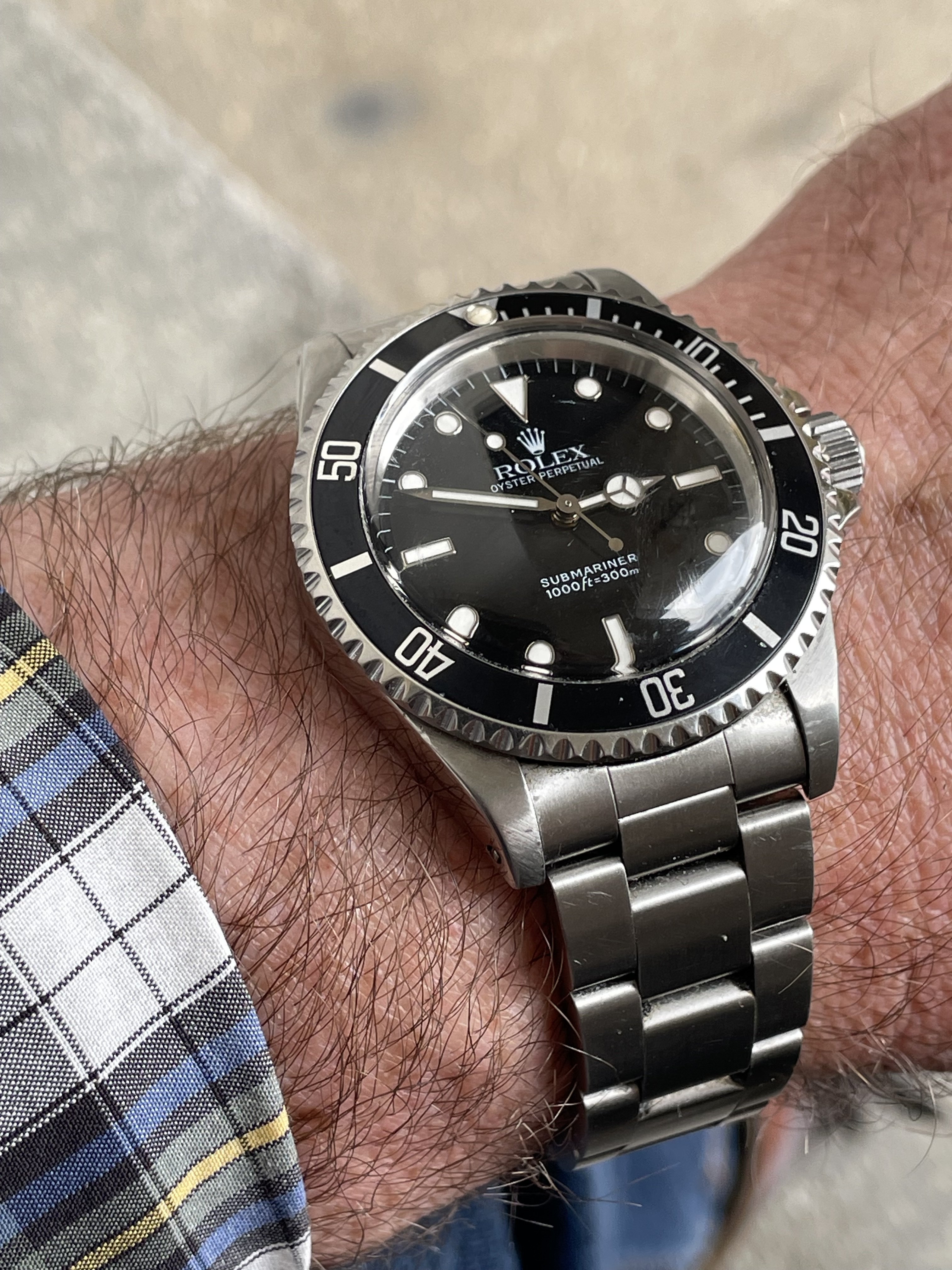

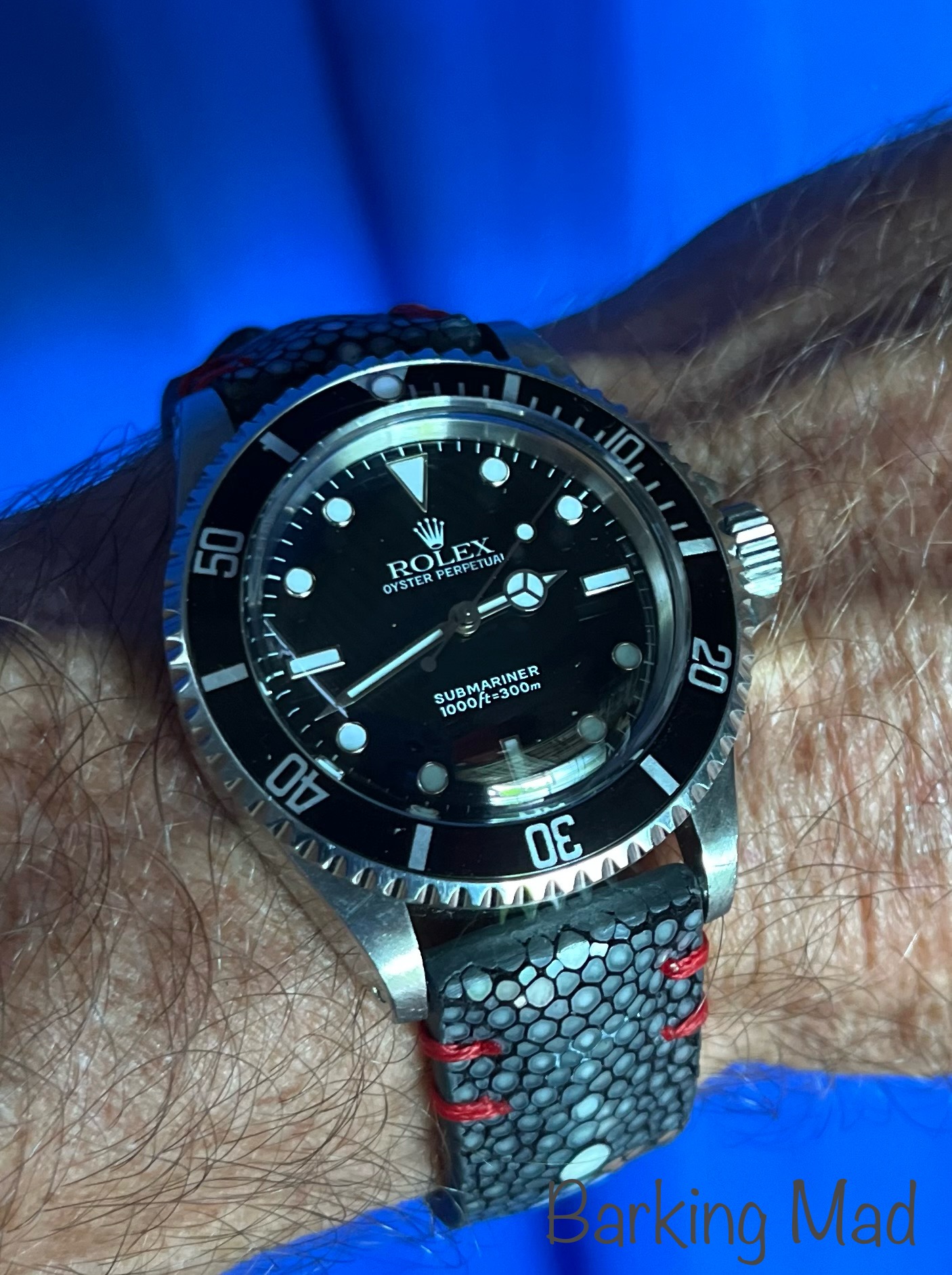

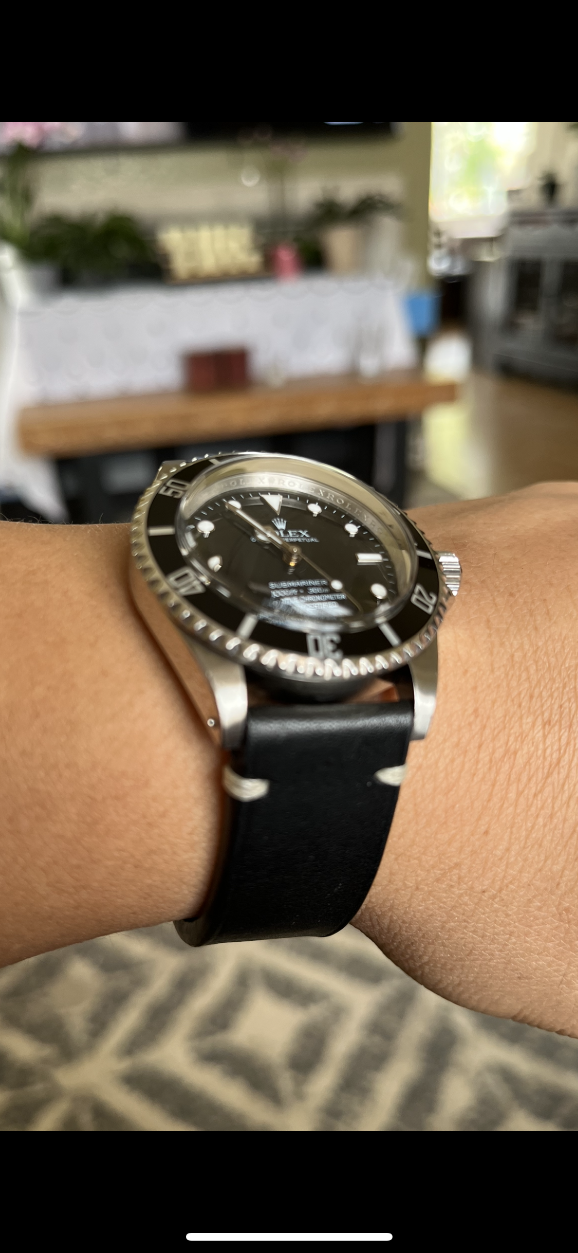

That’s awesome! So glad you were able to do it yourself. If you want to go for the tropic look, the one in my first posts was an Uncle Seiko Tropic strap- but I shaved down the lug end sides with a Dremel to curve like the vintage tropics did (last I checked Tropic Straps only did flat) not just becuase is was cool but because the US tropic rubbed the case due to the short holes to case distance (I’ve had this issue a lot using straps on the Sub- surprisingly short gap).

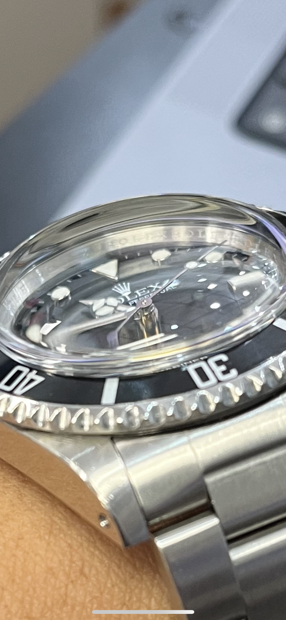

Last cool positive note I’ve noticed hehe… due to the curvature of the domed acrylic, the Rolex “rehaut” is magnified in certain angles and more pronounced 😀. I don’t think the “rehaut” was used on prior models with acrlic…

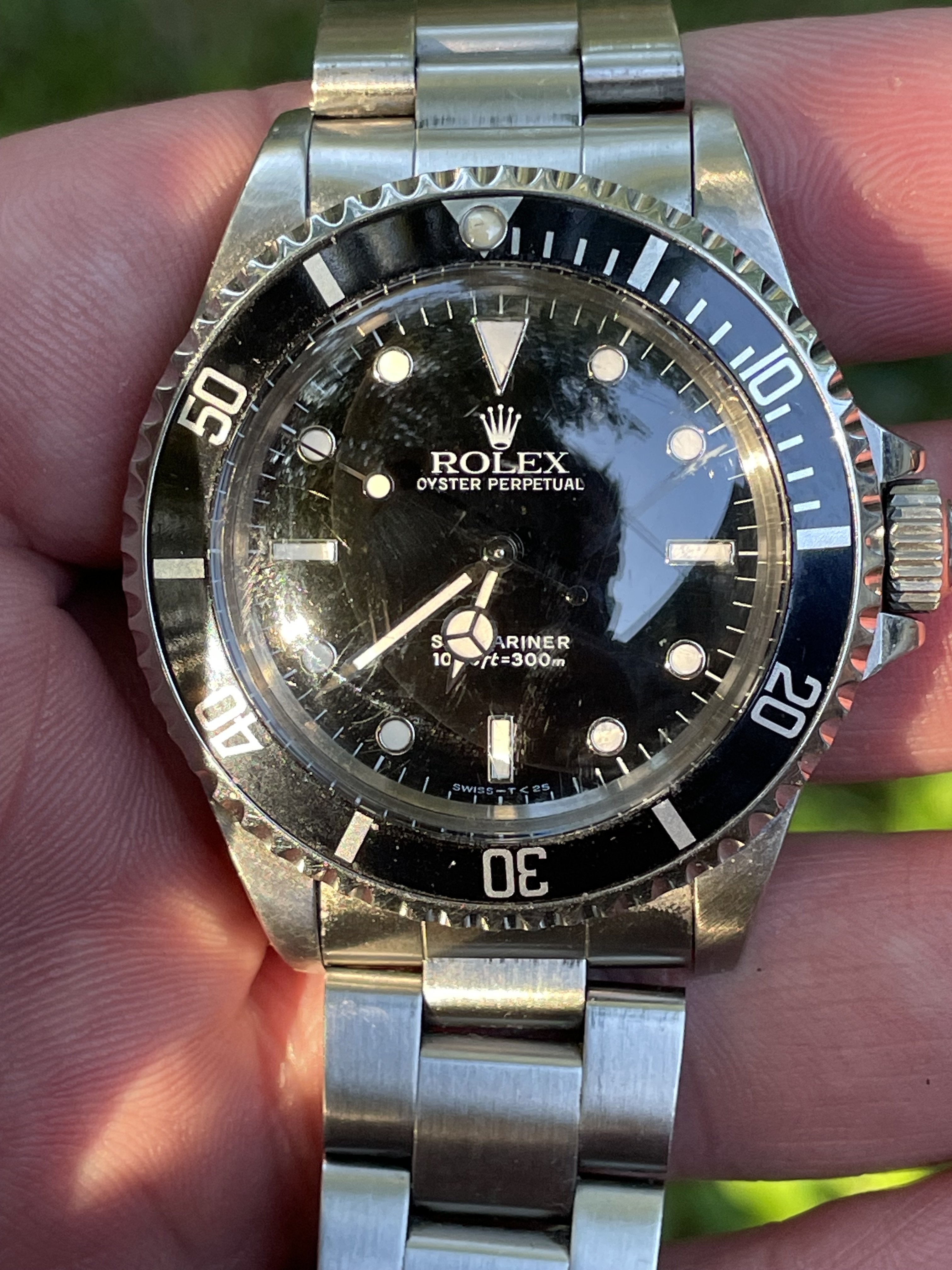

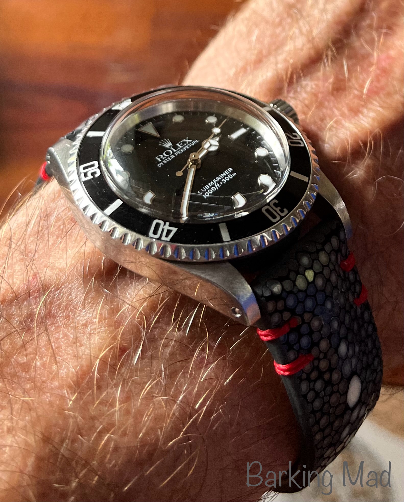

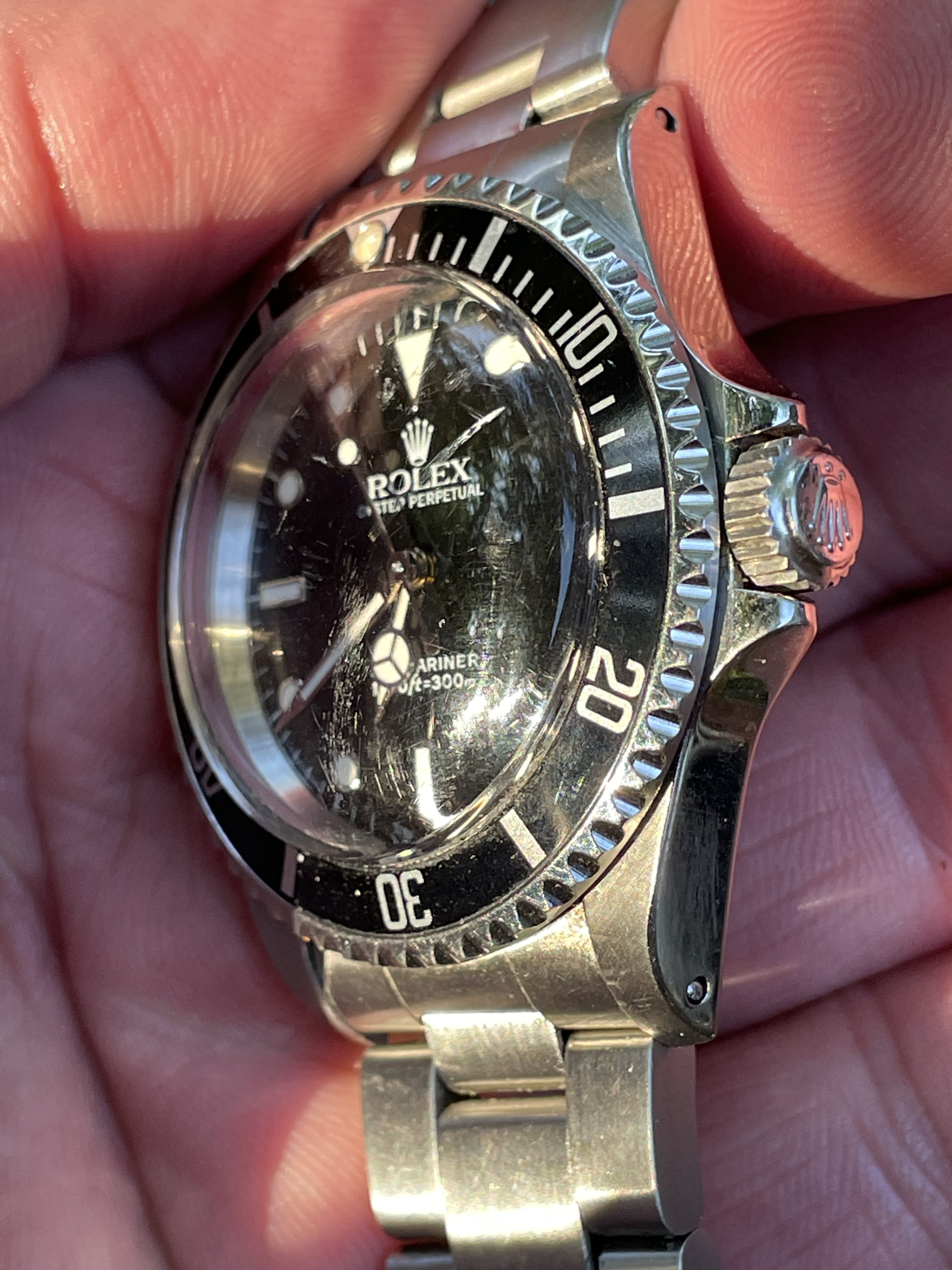

Over 3 years of weekly (probably 2-3 times a week) wear- and seen some pretty heavy field work and taken a few hard knocks. Haven’t poly’d or cleaned it once since I installed the crystal
And looking at my pic more closely…maybe it’s time to clean the watch 👎

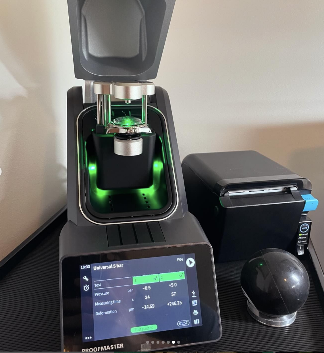

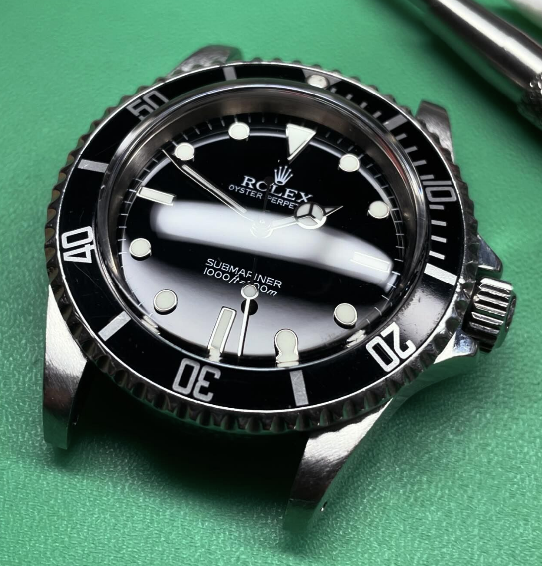

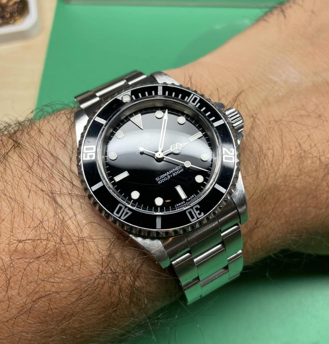

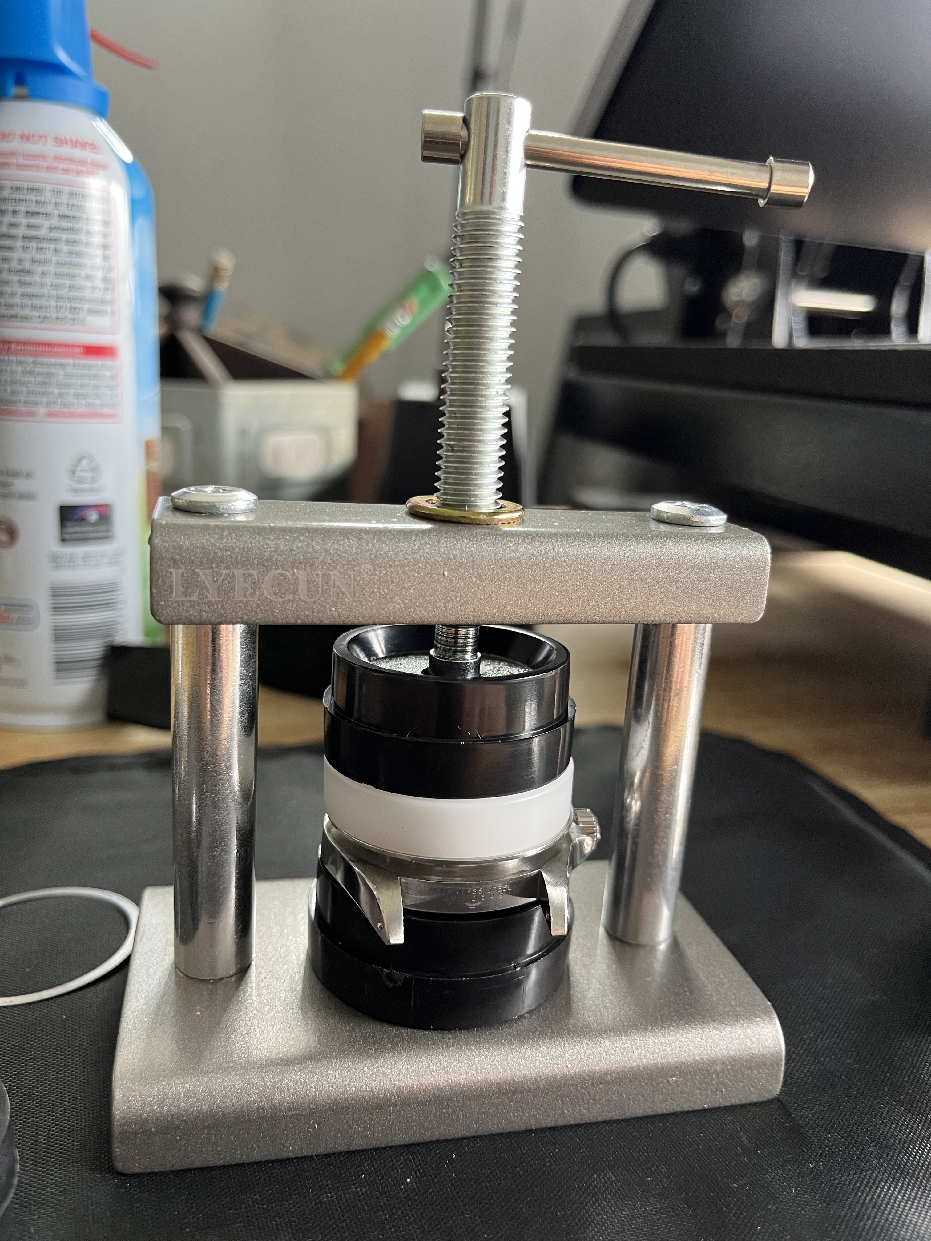

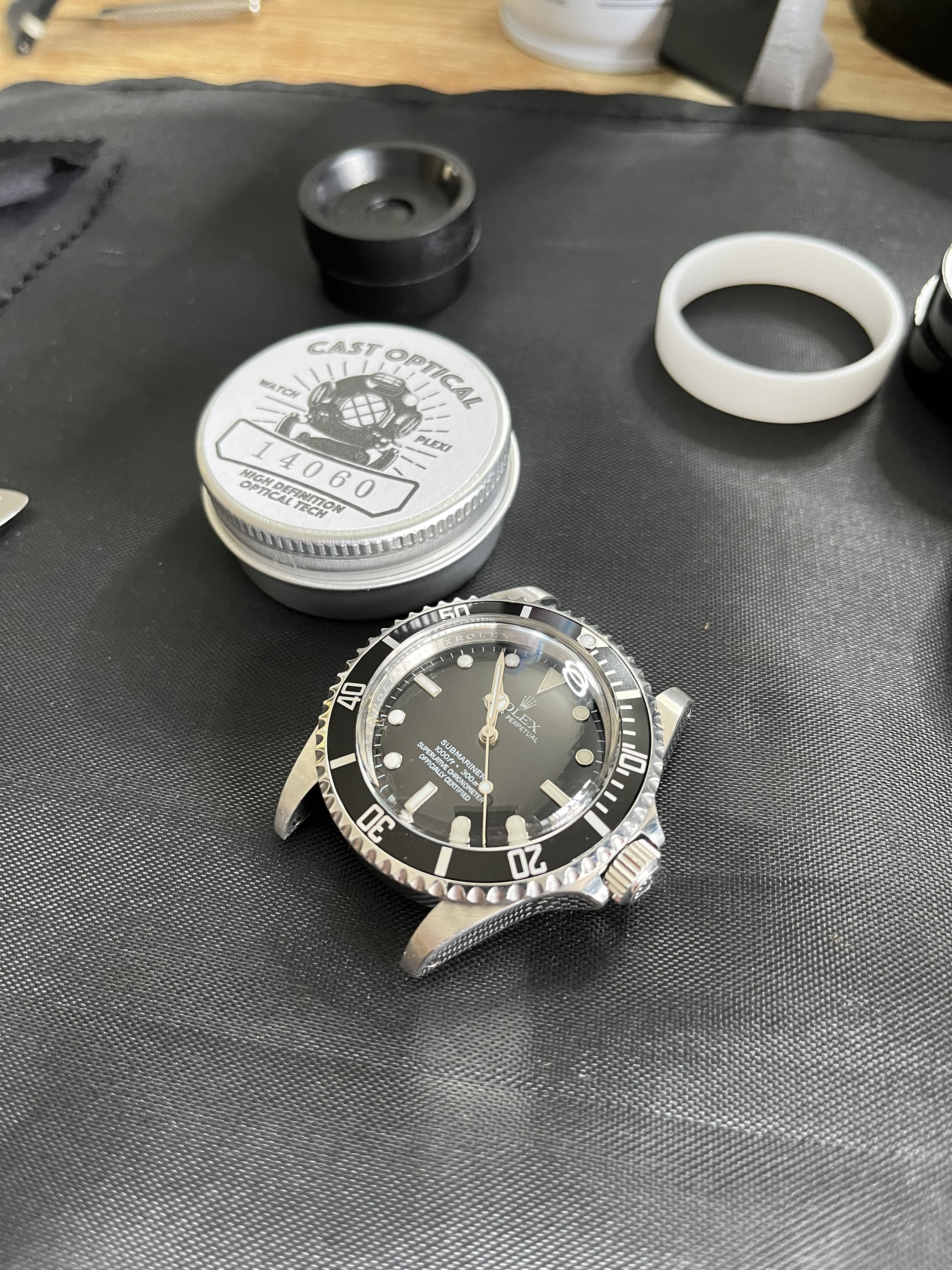

I recently have been itching for a vintage sub (acrylic) having sold my first rolex, a glossy 5513, years ago. I modded an existing crystal to get a feel for it and decided to order the crystal shown in this thread. First off, the $30 shipping stung but 2 days from HK to PA was pretty unexpected so i'll survive. The swap is easy w/ basic tools. I also have a proper pressure testing setup so was able to confirm. Full disclosure, it did not pass initially w/ a crystal leak. I didn't notice anything on the watch that would have caused this (previously w/ the sapphire it was fine) so I added crystal adhesive to the base and after that it passed a -.5/+5bar vac/pressure test w/o any issues. Confirmed in a water tester as well.
Most importantly, I love the look. It's tall (if i had a complaint it would be this) but it distorts the light so well. Really fun and also, as mentioned in this thread, I think it bring out the gloss of the dial way more than sapphire. Also love that acrylic doesn't fingerprint up as much... yes it scratches but it doesn't really smudge.
I bought an extra crystal in case I feel compelled to put it on the lathe and try to reduce the height a bit. it's a $60 crystal so a little roll of the dice but I kinda want to try and the intrusive thoughts to just do it will probably in. I'll report back if i do but for now enjoying the mod.
-Matt

So glad you did this and performed the pressure test, that was the thing missing from this thread was an actual test. Not sure if preparing (sanding/dressing etc) the surface on the bottom of the crystal would improve the seating as opposed to using an adhesive- would be an interesting test but clearly not for someone who doesn’t have the correct equipment.
12
31
it's hard to describe but a really well fit acrylic crystal has this *perfect* feel of resistance when fitting... not too loose but not too tight. When i installed this it was snug but just short of that perfect fit. I wasn't surprised it didn't pass and the water test confirmed it was the crystal and another opening/gasket. if i end up modifying my "extra" the seat of the crystal will be shaved and I can theoretically tighten up the internal fit every so slightly and see how that goes.

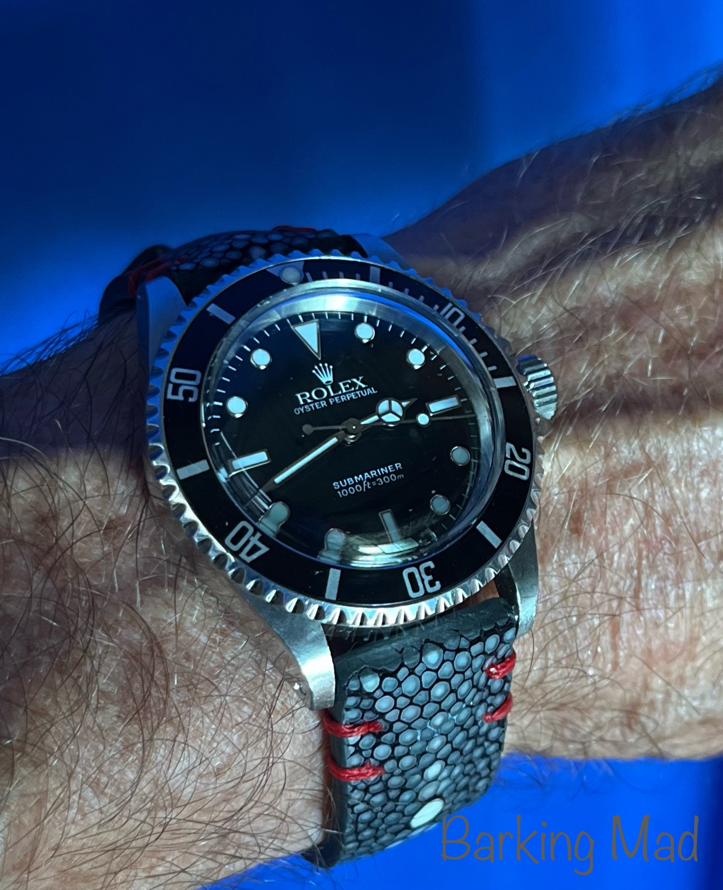

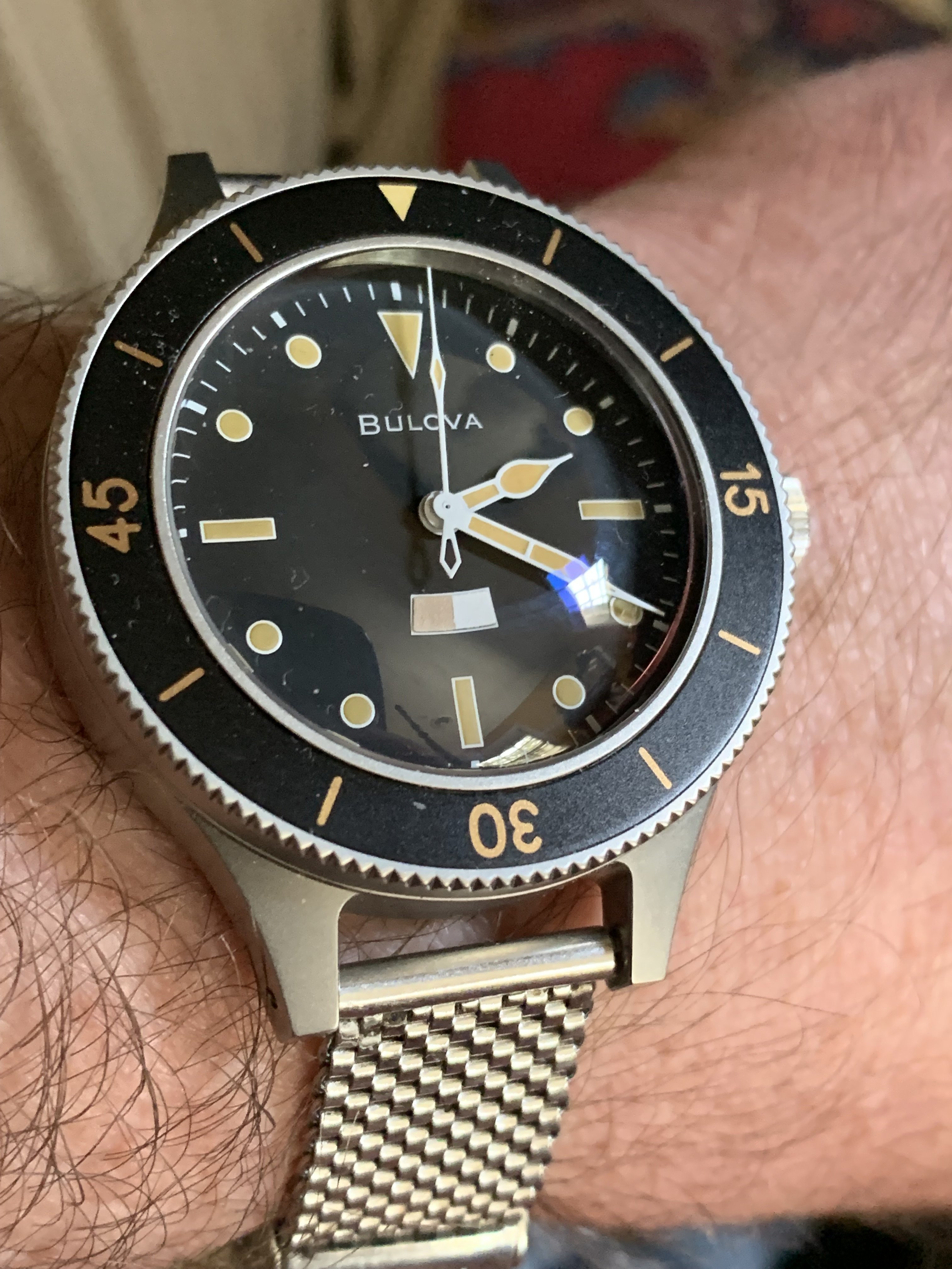

The height is startling at first and feels a bit over the top for the first few days (you may have a -my god, what have I done moment) much like the sky-high dome on the Bulova 1957 diver reissue
But once you get used to it, you don’t even think about it- it’s just very much part of the watch and seeing a flat sapphire again just looks sad and humorless.

I wear mine at least 2-3 days a week (my SM300 Watchco seems to get 2-3 other days with wild card for the remaining) and it’s taken some hard knocks on field work and construction shoots. The superdome has survived as well as any factory armored crystal and taken on the patina of a well worn classic acrylic crystal. Still have yet to polish it- I’ll wait until I can’t see through it anymore.
