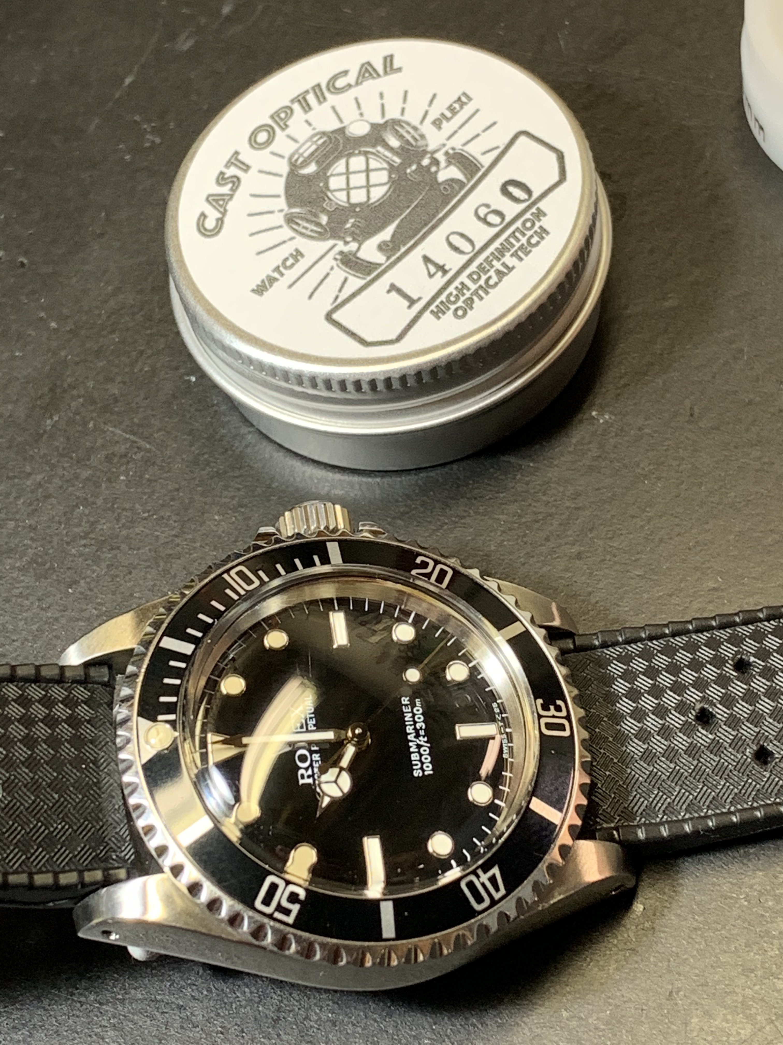

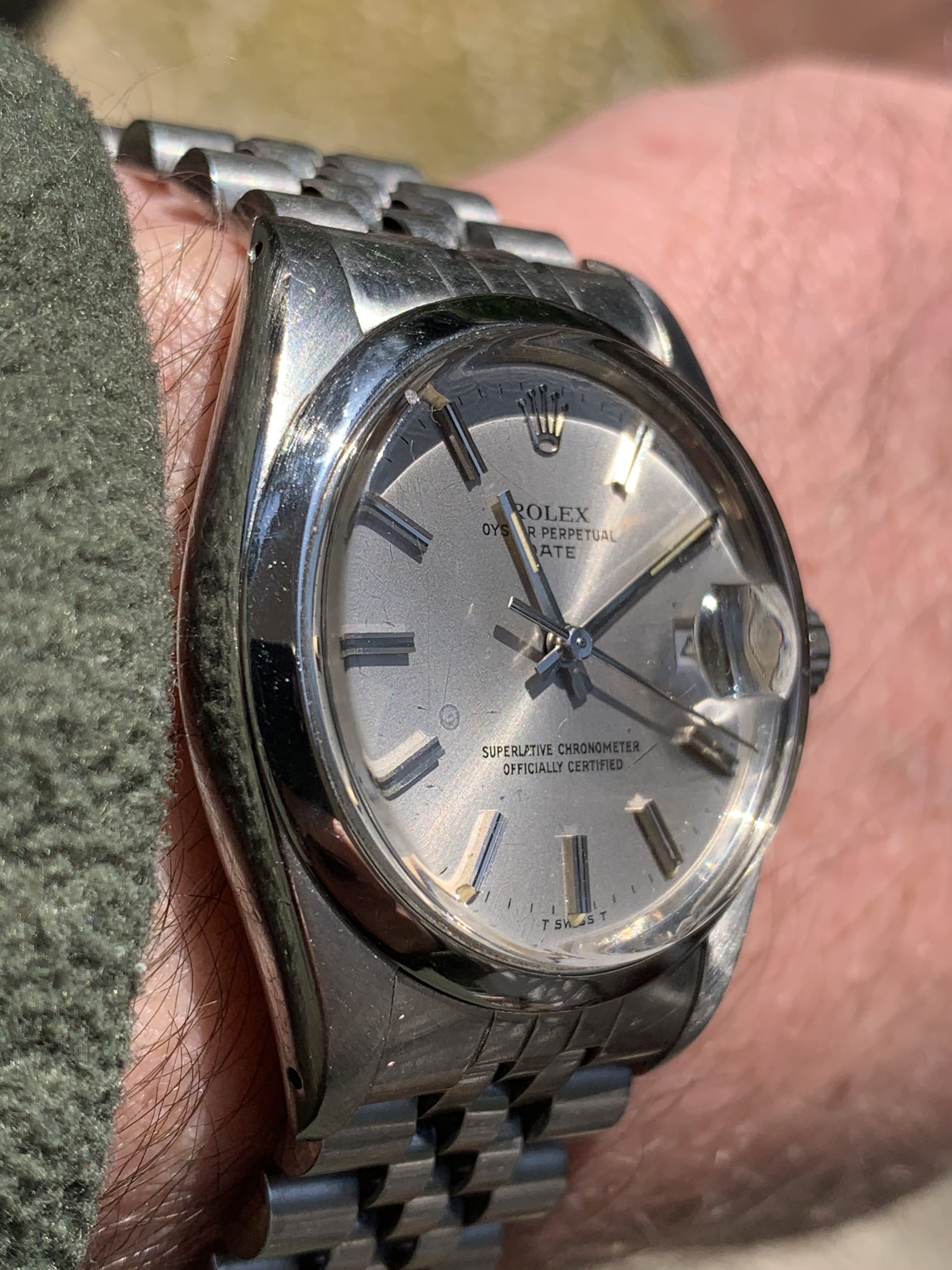

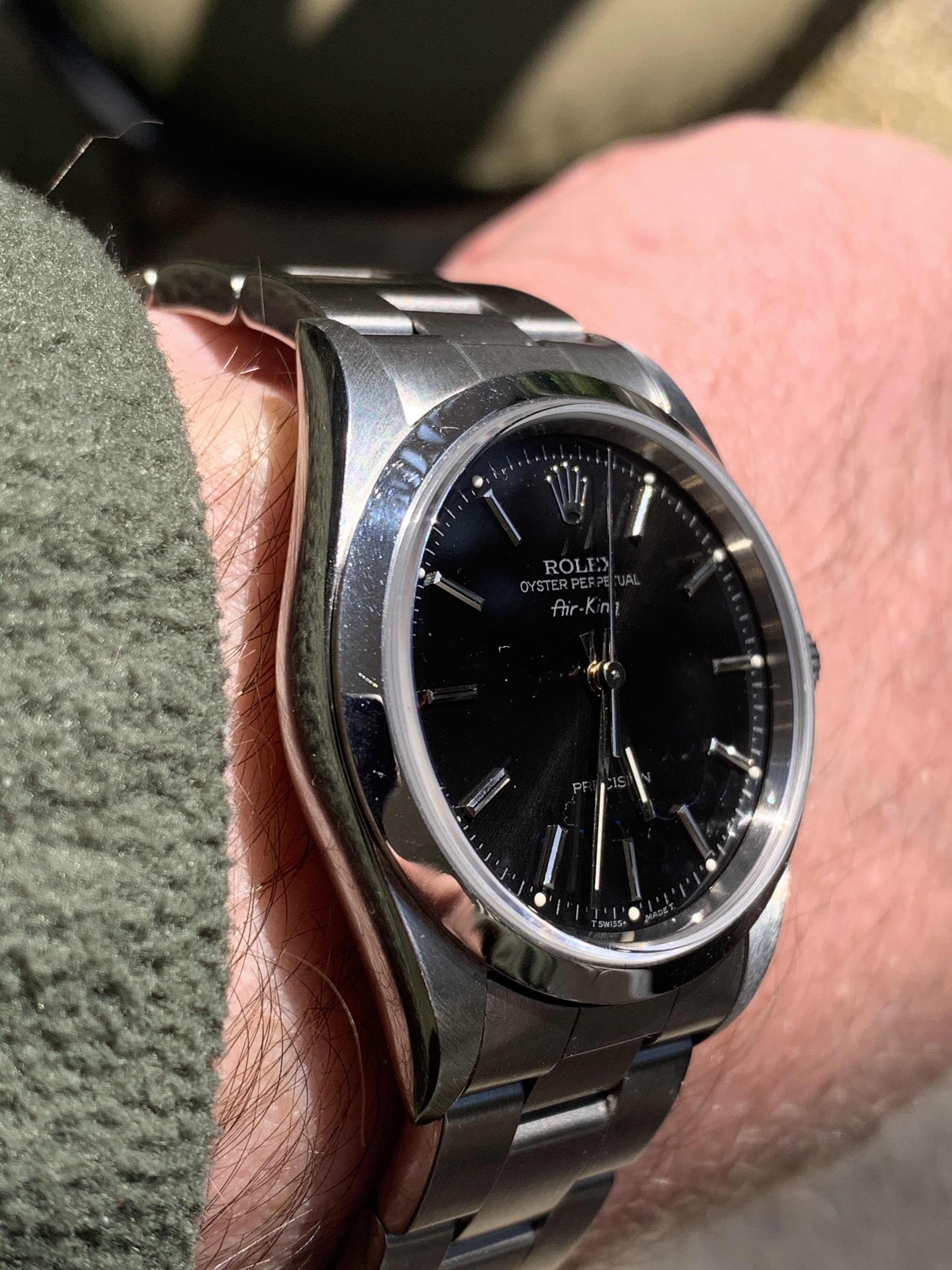

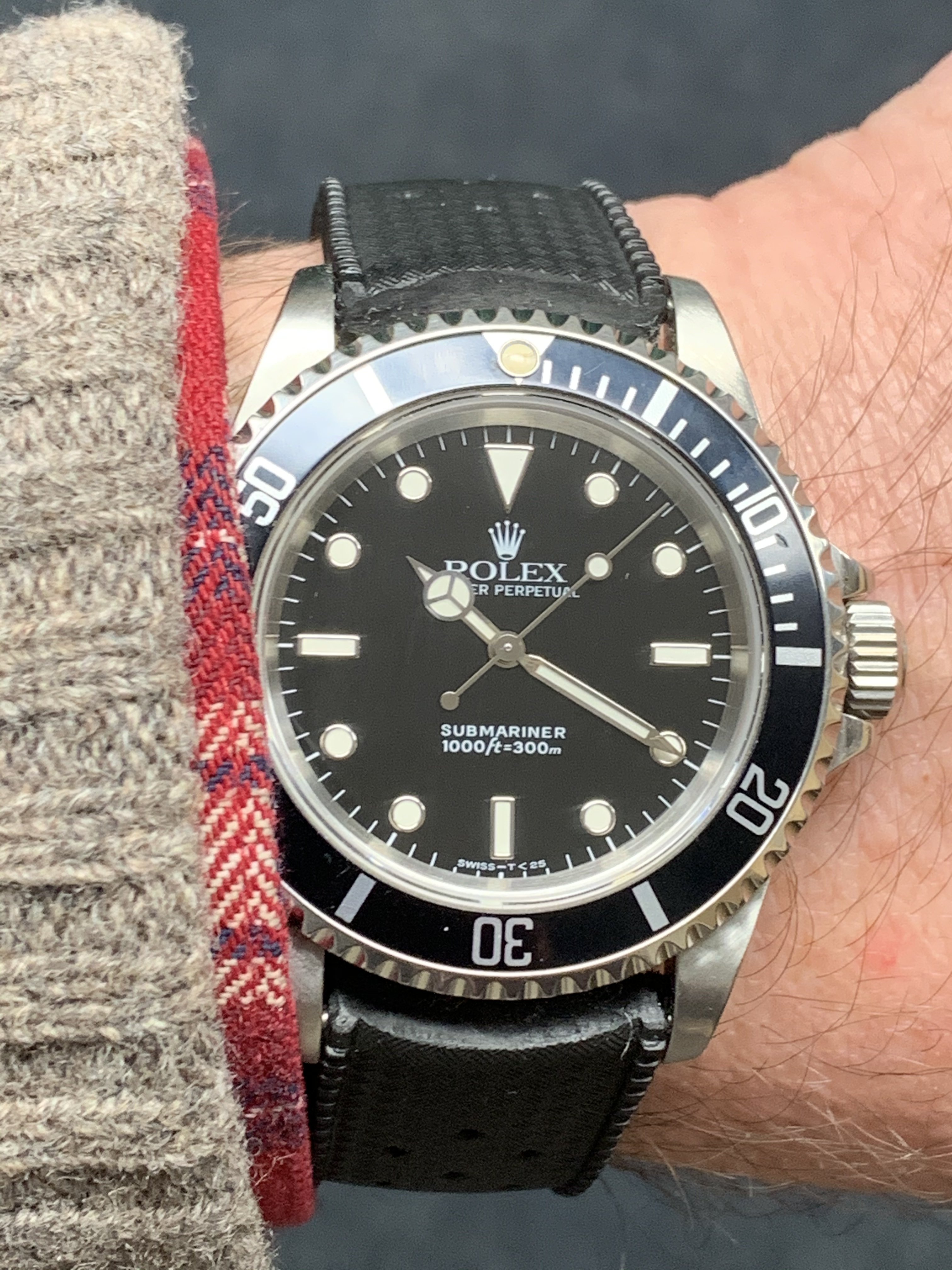

I have one other sapphire crystal Rolex and that’s my 14000 Airking- I love the watch, but looking at it side-by-side with my OPD wearing it’s thick acrylic, it lacks the shimmer, sparkle and 3-dimensional pop that the acrylic gives. I know the dial has the shimmer as I can see it in some light- but the crystal is just so flat, lifeless and sterile.

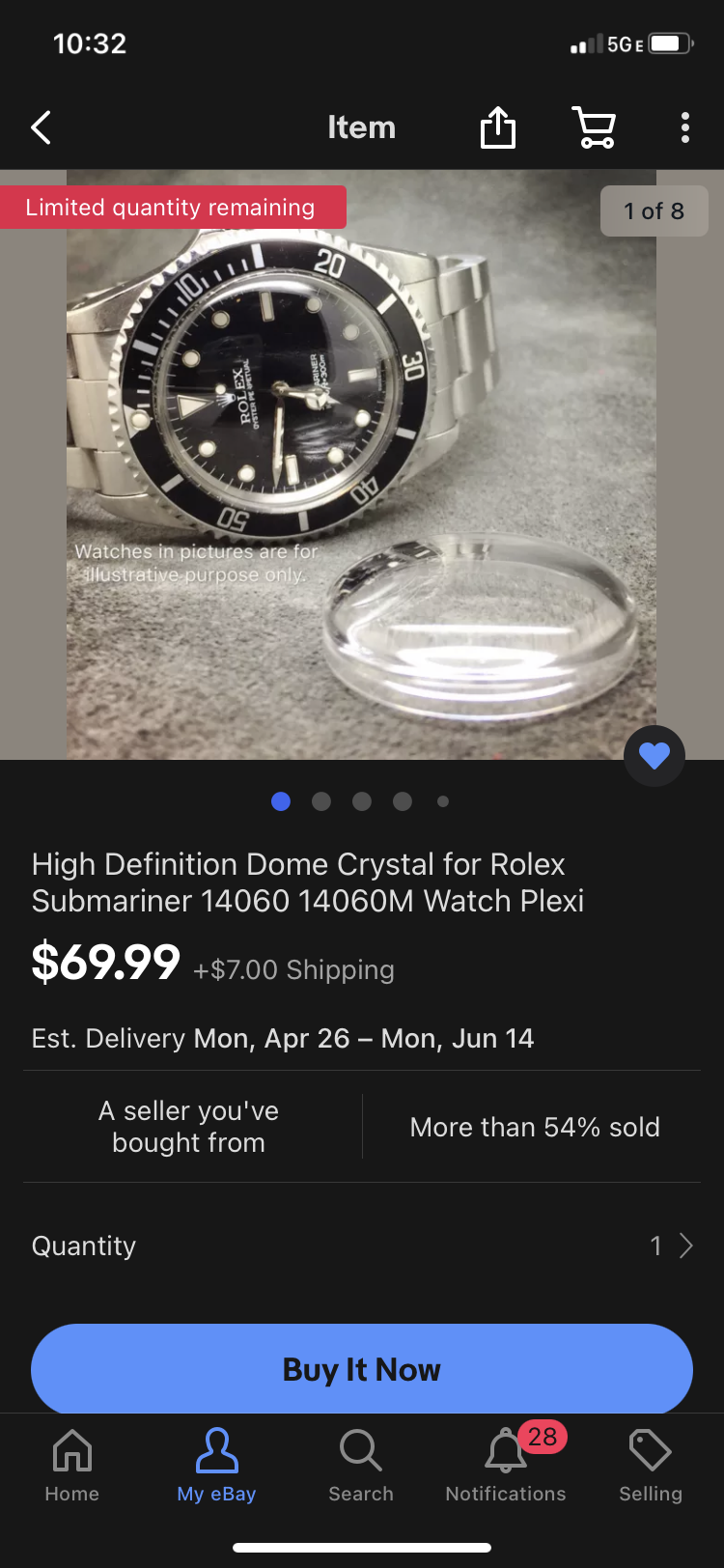

So I stumbled upon a vendor on eBay selling aftermarket crystals and parts for obscure dive watches- I’ve seen this seller’s parts before and rather than scoff at “fake parts” as some collectors may, I appreciate him filling the void where the maker is no longer extant (like bezels for Depthomatics) or the company never made the part (like an acrylic crystal for a 14060- which never existed from Rolex).
https://www.ebay.com/itm/401715054430
I did my research and surprisingly found nothing on these crystals in the wild. I found several people asking if an acrylic could be fitted to a 14060 and the resounding reply on the forums was “why would you want to- just buy a 5513”. I get that, but not all of us can afford a 5513 and I got lucky to even get my watch, so have to make the best of it.
I took the plunge and ordered one- I figure at worst I lost $80 and could put the factory crystal back in. I did more reading and watched tutorials on changing the crystal on a sub and all the forums seem to make it seem like some black art- don’t even think about it unless you have factory tools, only have Rolex change that crystal or it will implode! You will void any warranty....umm, warranty has been up for about 30 years.

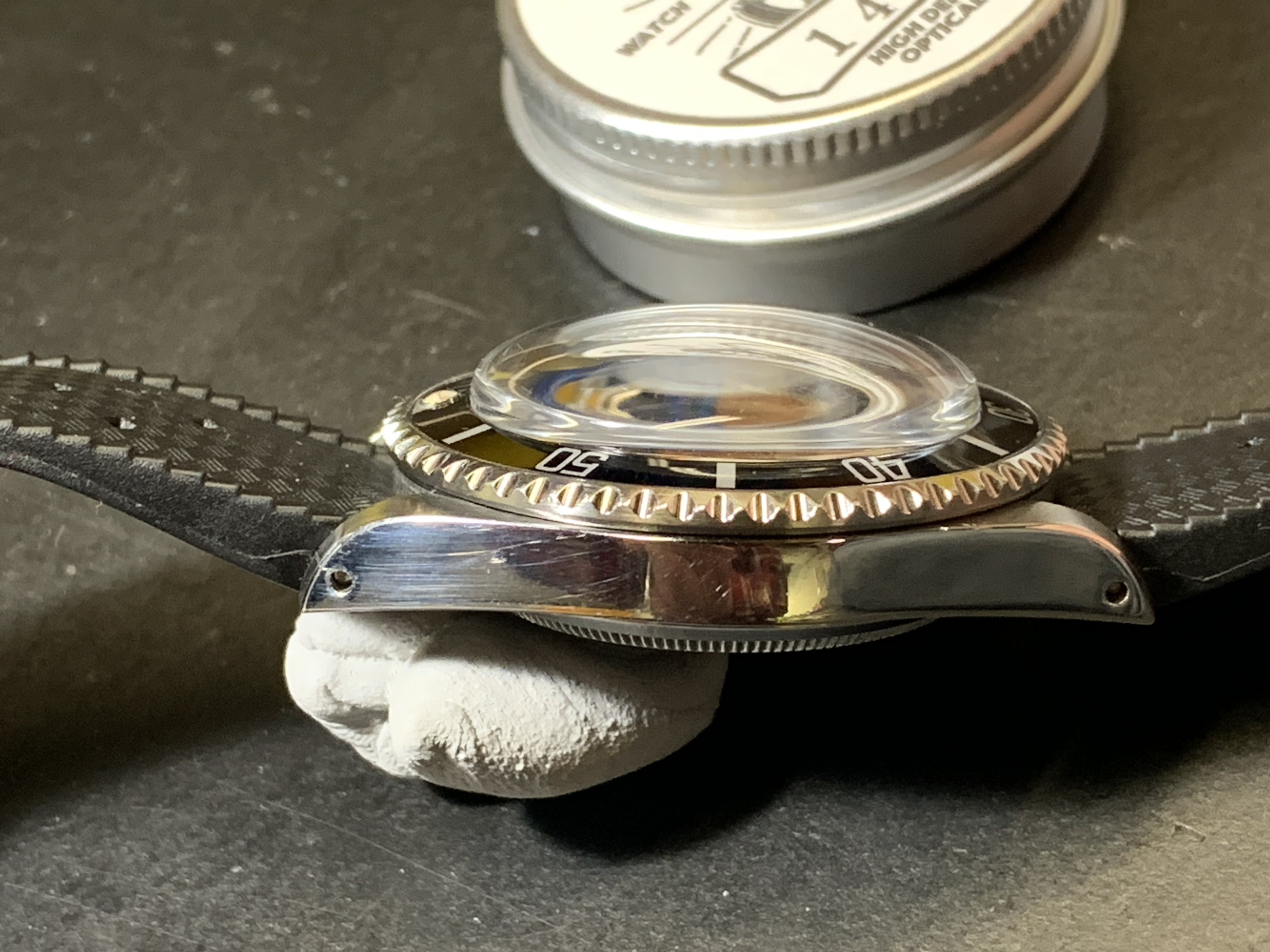

Well, I can report that there is no black art, it’s incredibly easy and like all things older Rolex, it was well engineered to be easily serviceable.

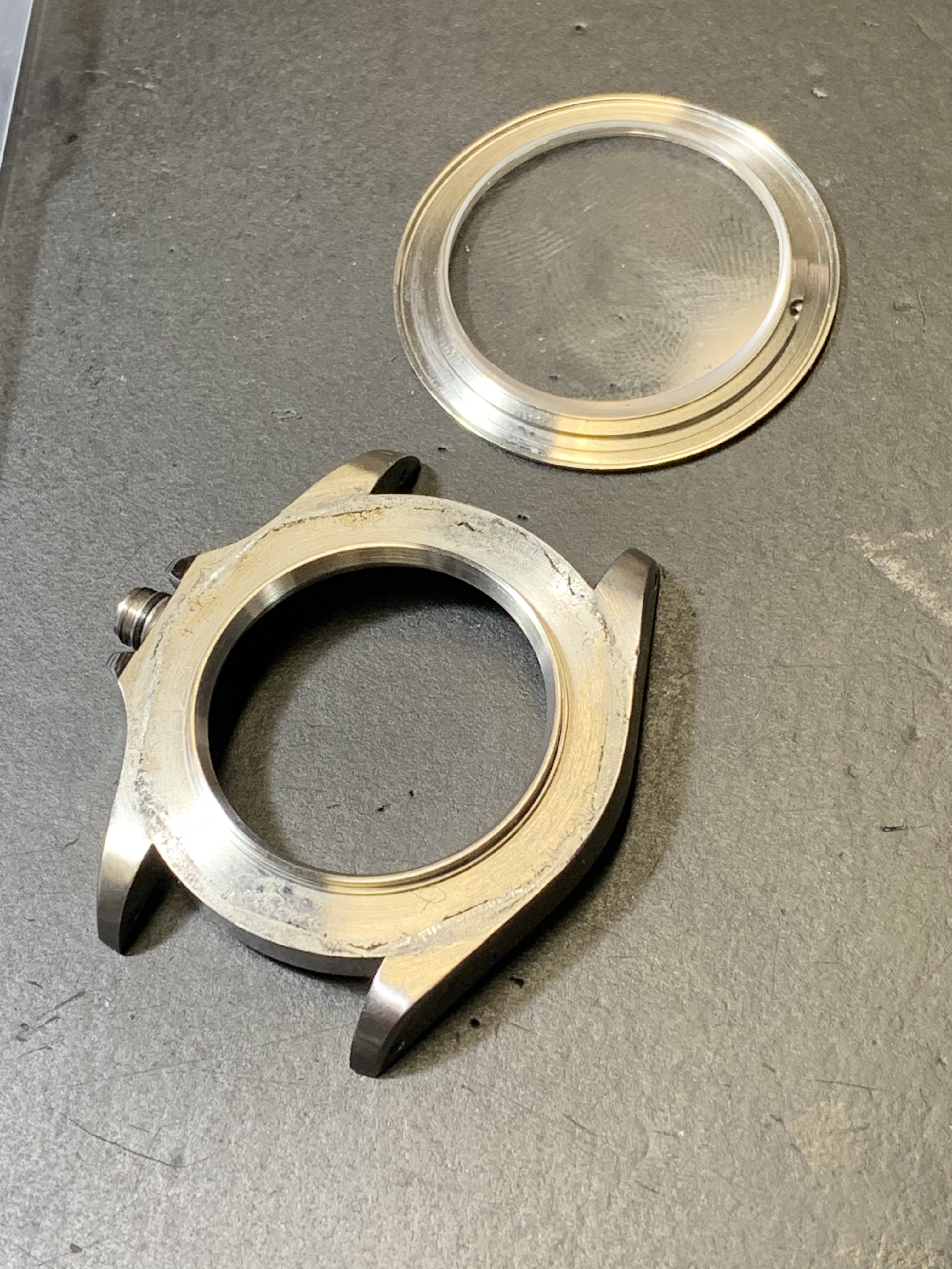

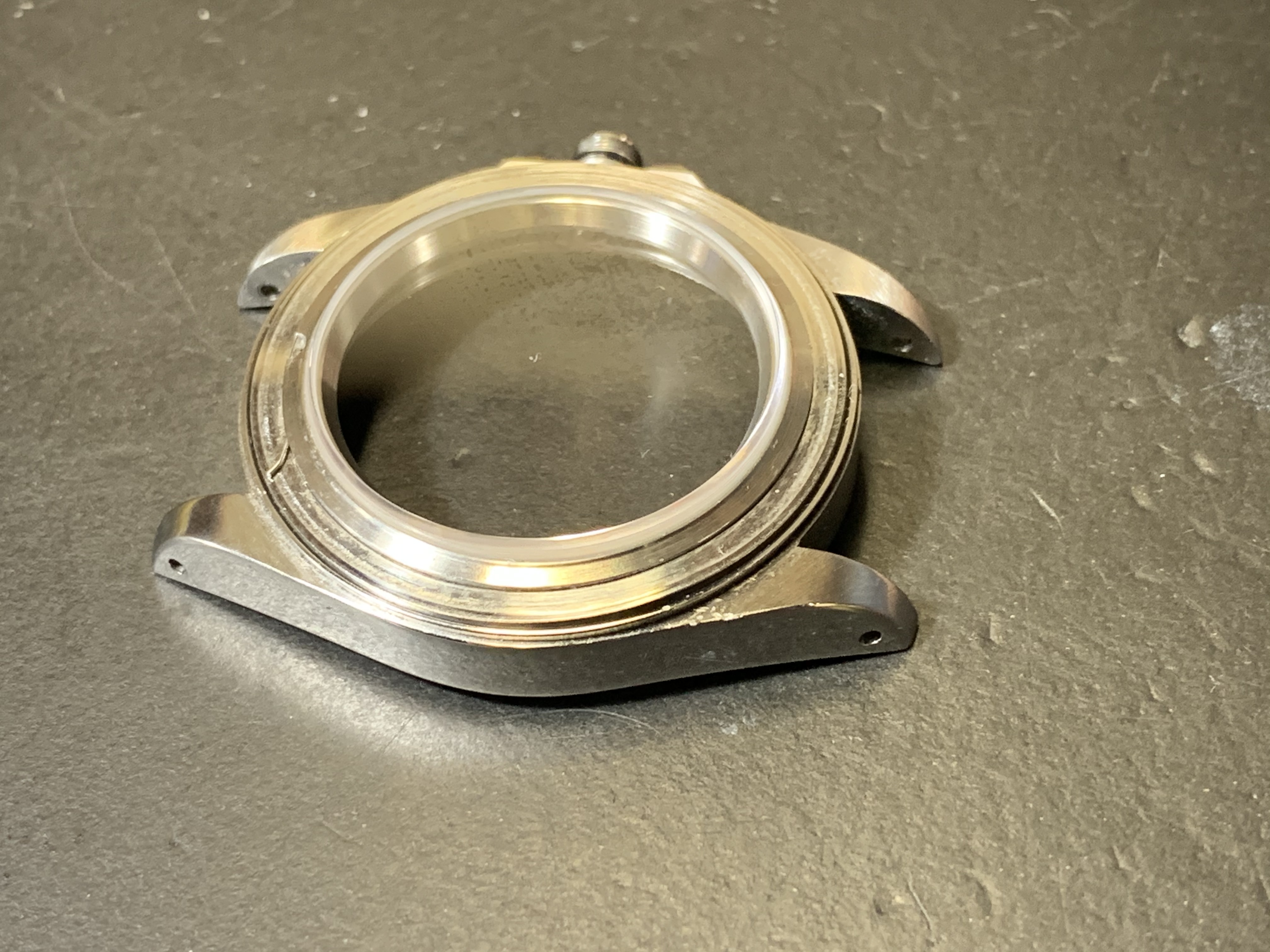

Bezel easily comes off with a case-back tool (be mindful of the click wire)
Carefully work a razor blade around the retainer to slowly pry it up evenly
Sapphire pops out with the casket, the acrylic presses right in snugly without need for a gasket- reassemble.

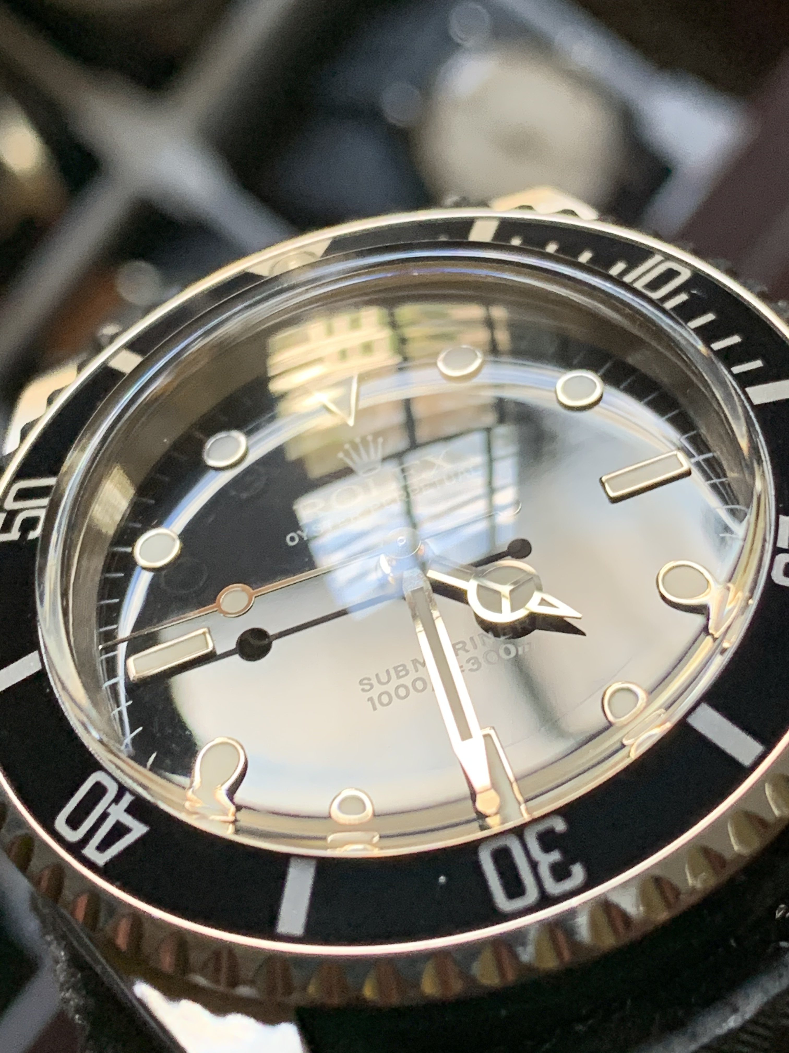

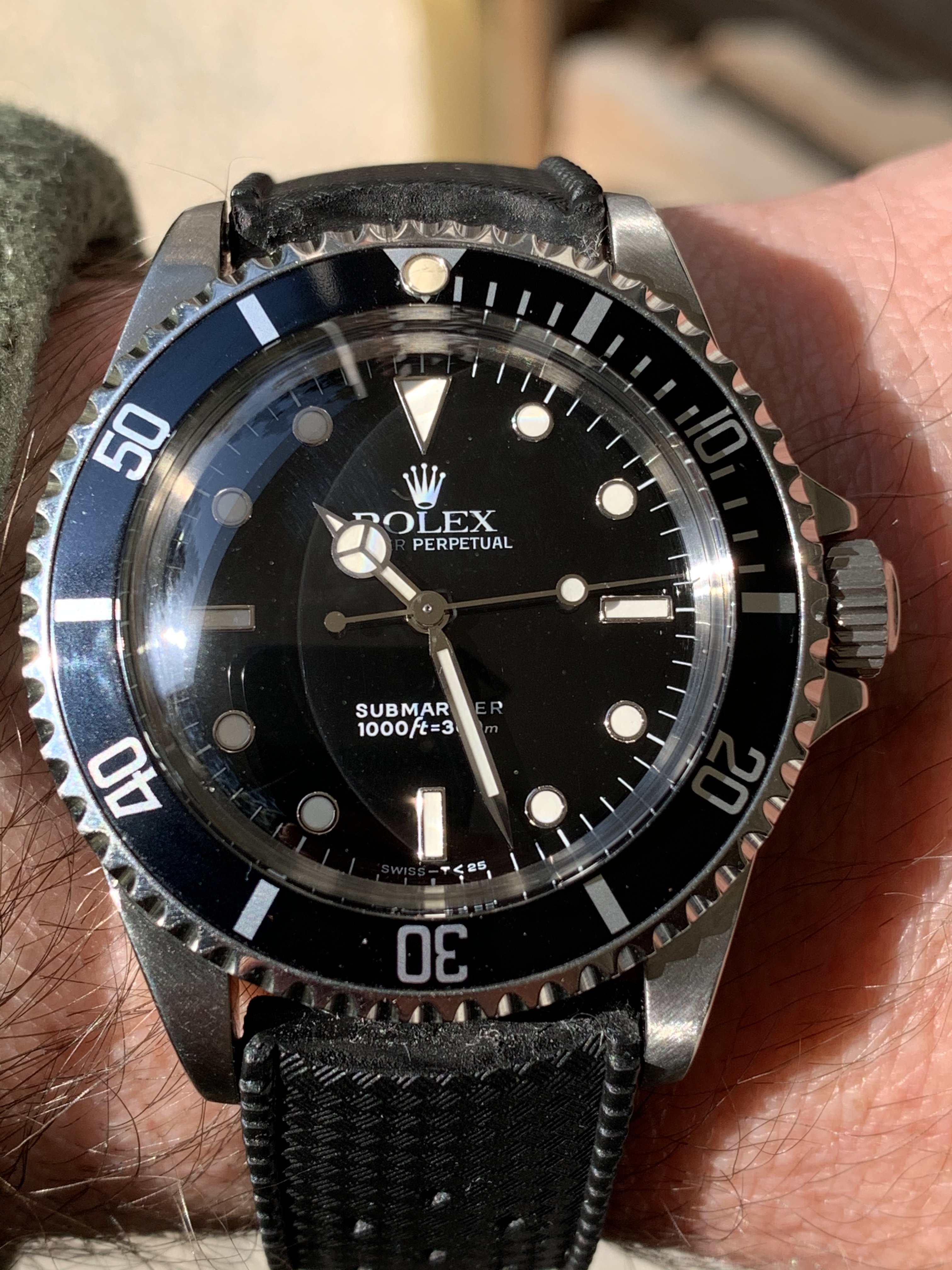

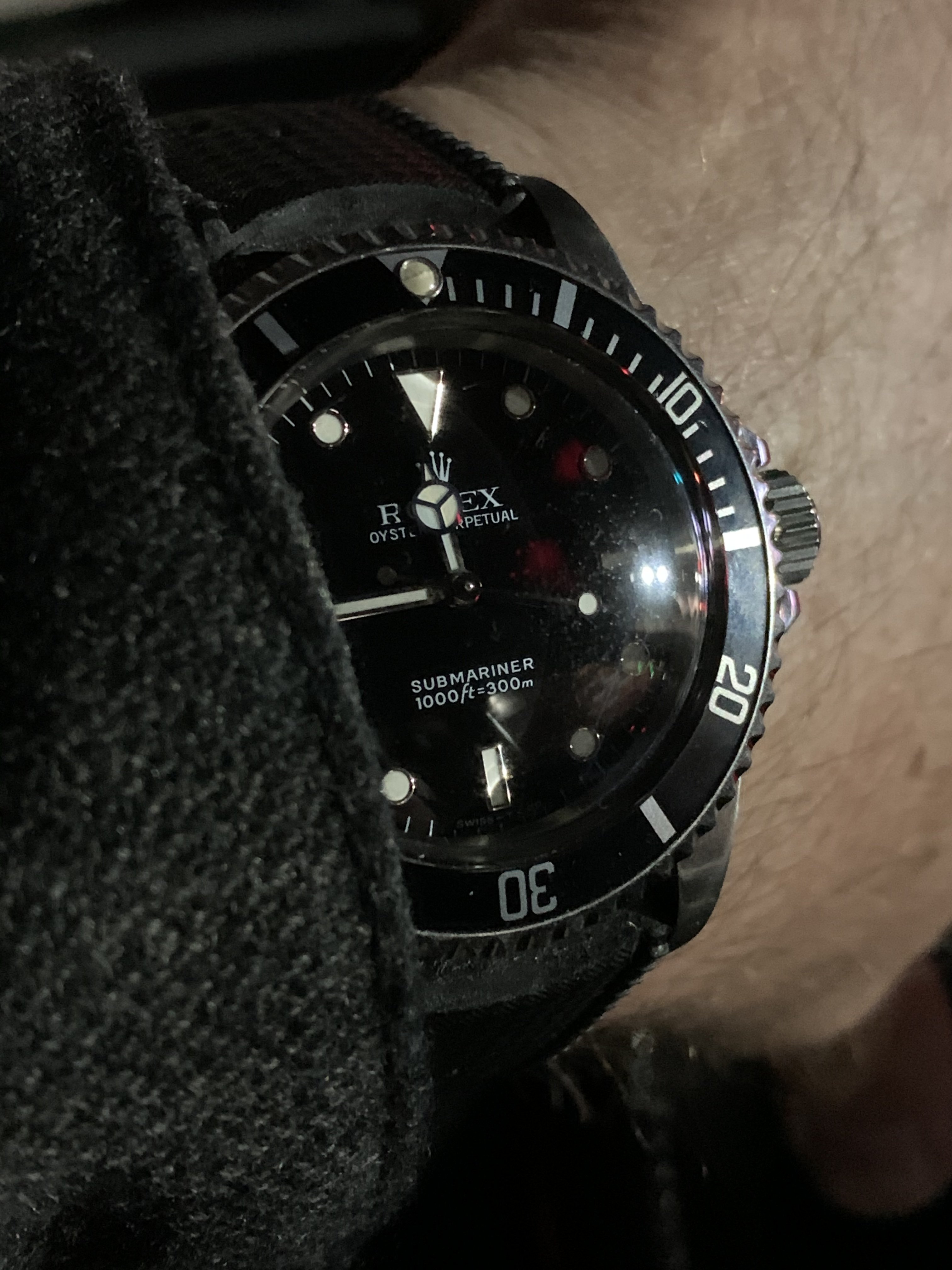

Now that’s a dome!
Night shot reflecting street lights in that giant orb

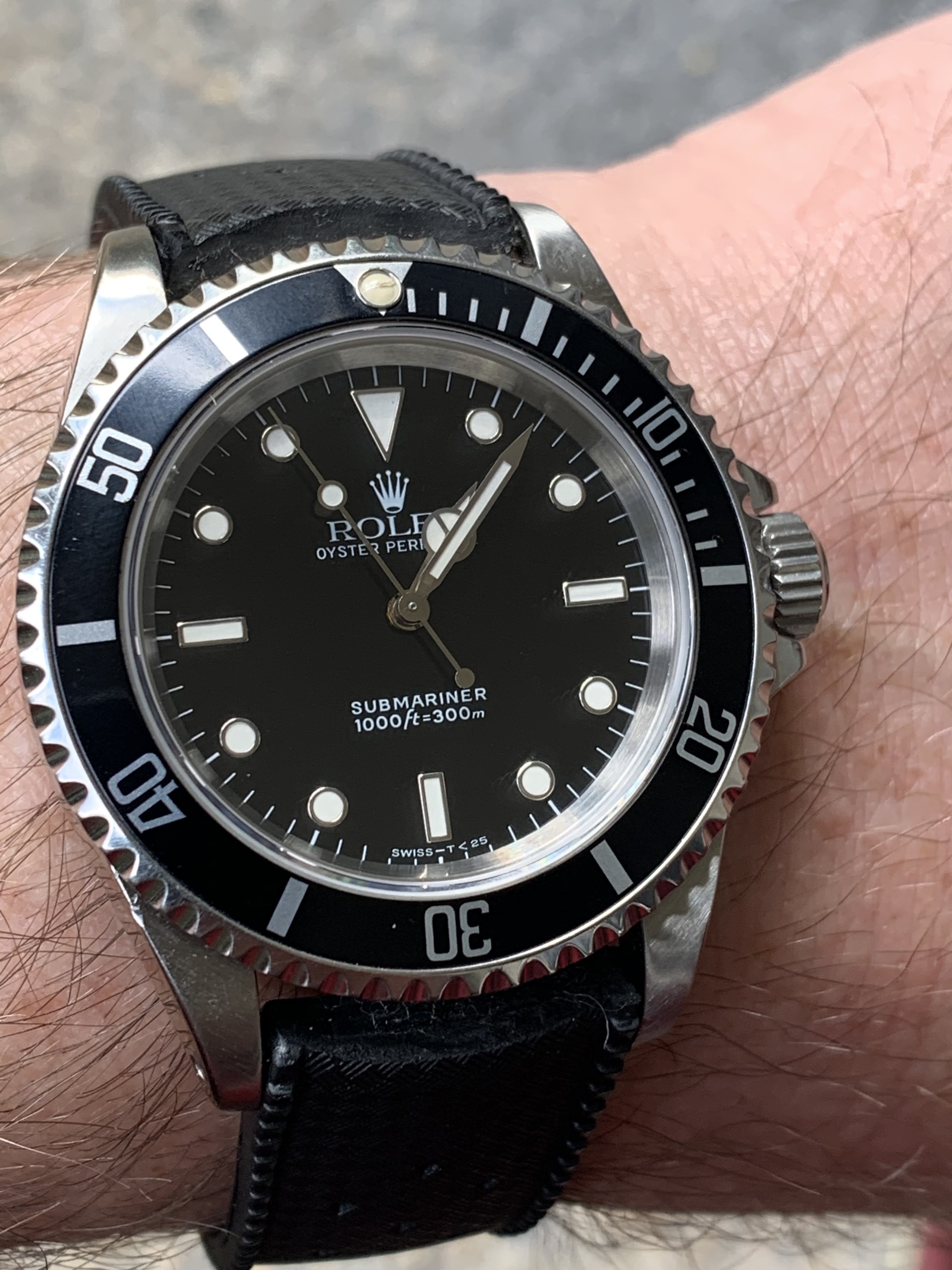

sunshine

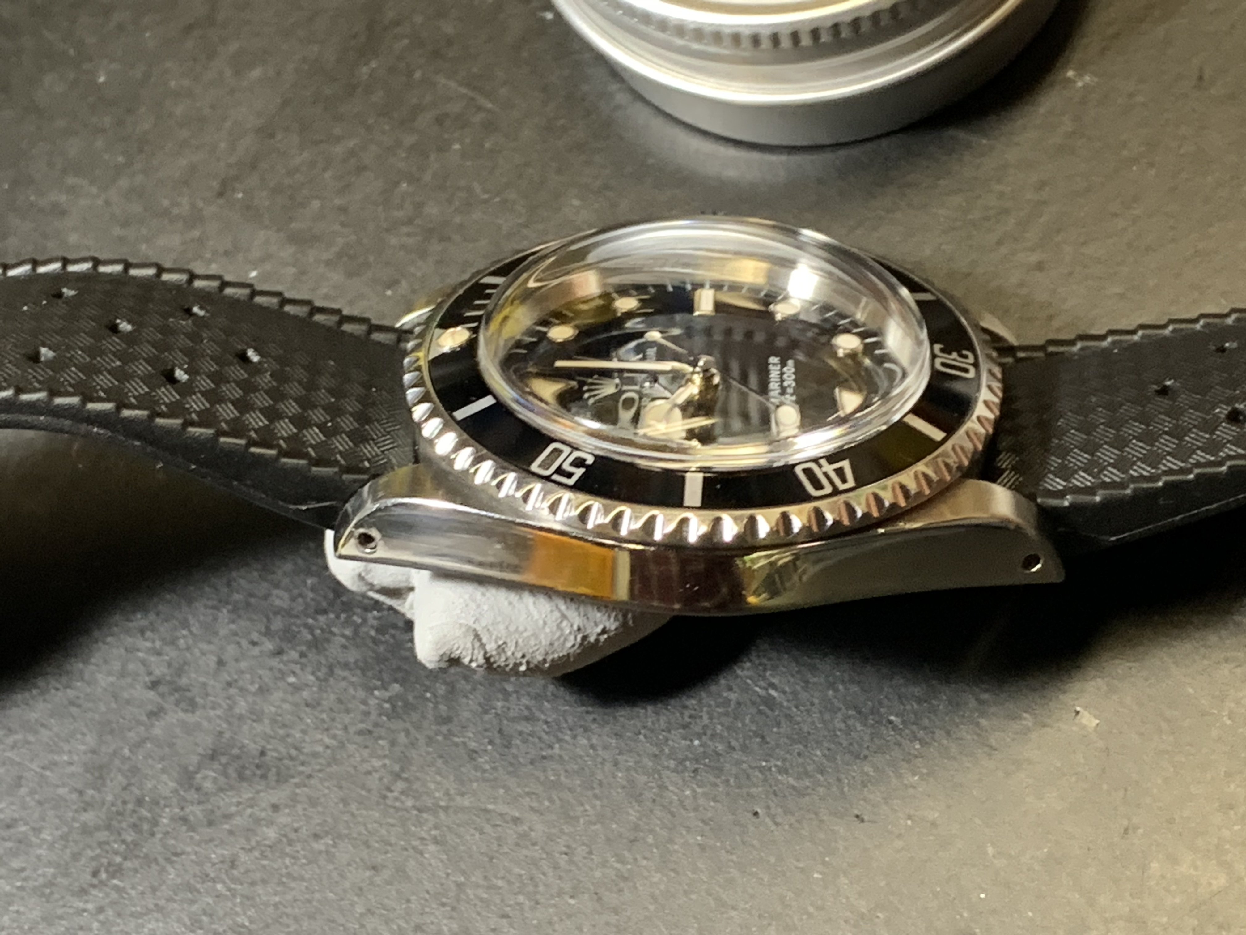

The only downside is the dome is like a fisheye and makes photos tough without seeing the whole world reflected in it

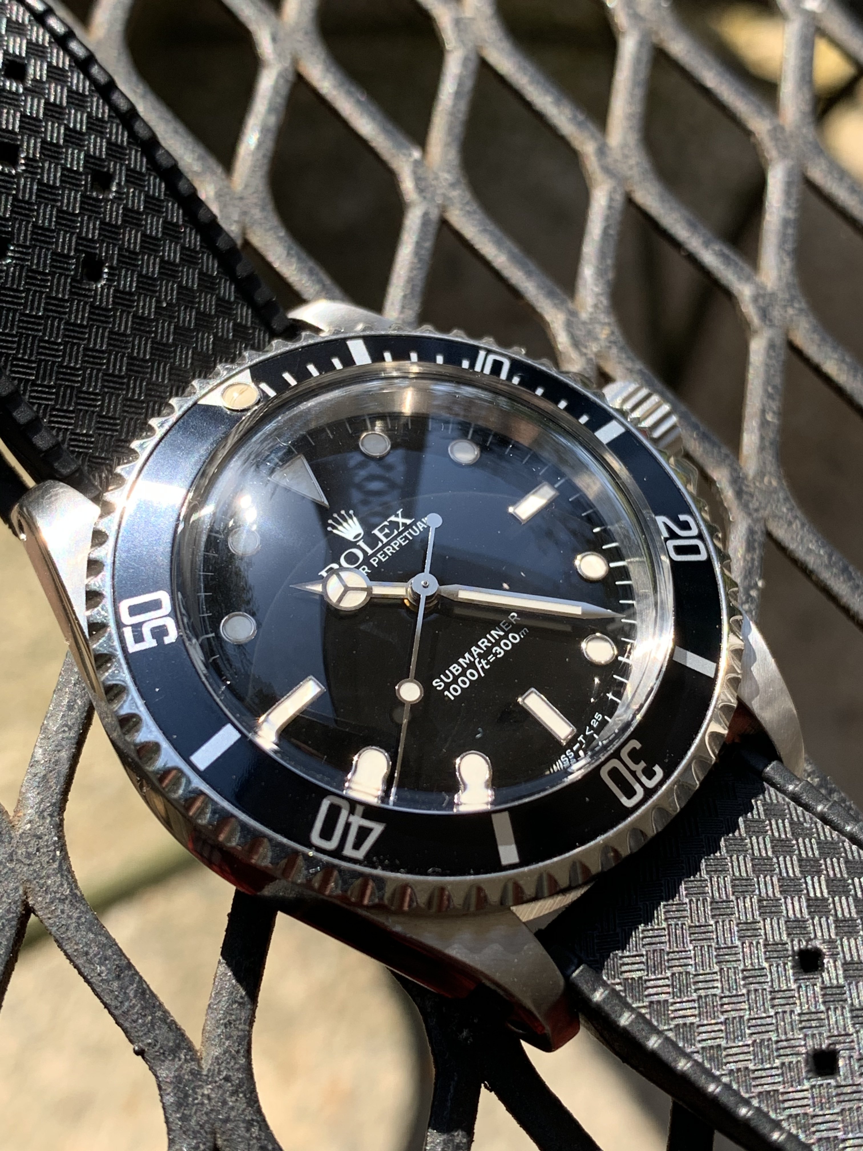

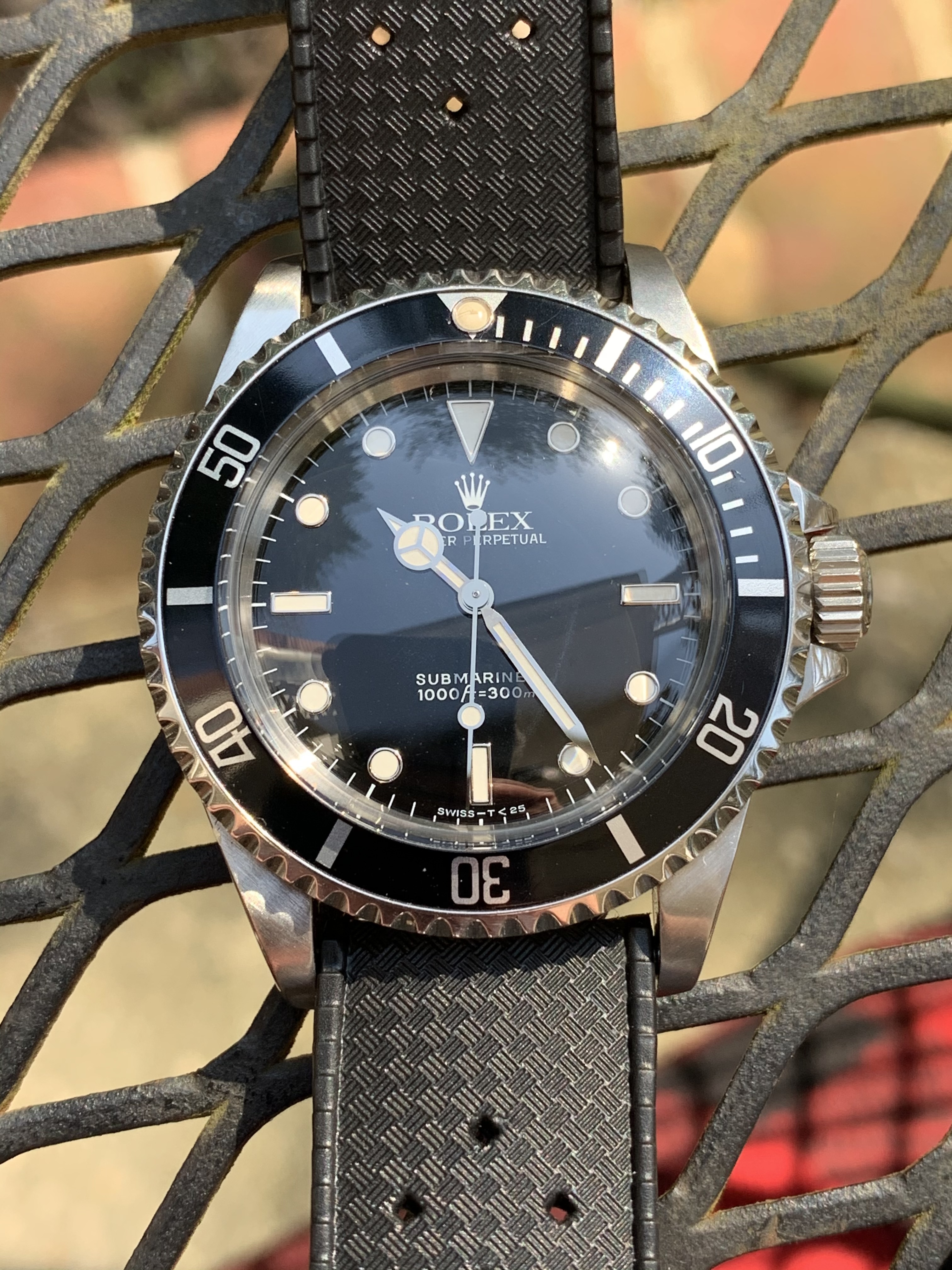

The acrylic is sensational. The indices pop unlike under the sapphire where they seemed almost flat- you see their applied depth and the black dial appears deeper black. The slight distortion of the dome makes the indices actually appear slightly larger which is something I felt was amiss before- they seemed a little small for the surface area of the dial.
The most significant visual difference is tough to convey but it’s one of focal point. Like in photography when we use a bit of vignetting or shading to bring the eye into the focal point of the image (yes, we steer you to see what we want you to see), the dome brings the eye into the center- then the eye moves around the dial. With the flat sapphire, the dial seemed like it was just a large expanse to the edges and the eye kind of wandered.
Unlike cheap domes, this one doesn’t give the fried egg appearance at the edges. Yes, there is edge distortion on axis which is part of the charm, but not looking strait on.
I went from liking this watch to loving it. Best part- it’s totally reversible.

The gasket on the sapphire allows the pressure fit of the crystal as sapphire has no flex (it would shatter if pressed into metal). The acrylic went in just like the vintage ones do as it has the ability to flex- hence no need for the gasket.
If you brought one of these to your independent watchmaker (do not even hint at it with an authorized Rolex service provider), it would be an easy swap -no special tools needed, just a press with the correct sized dies. Then just store your sapphire with gasket in the tin like I did.

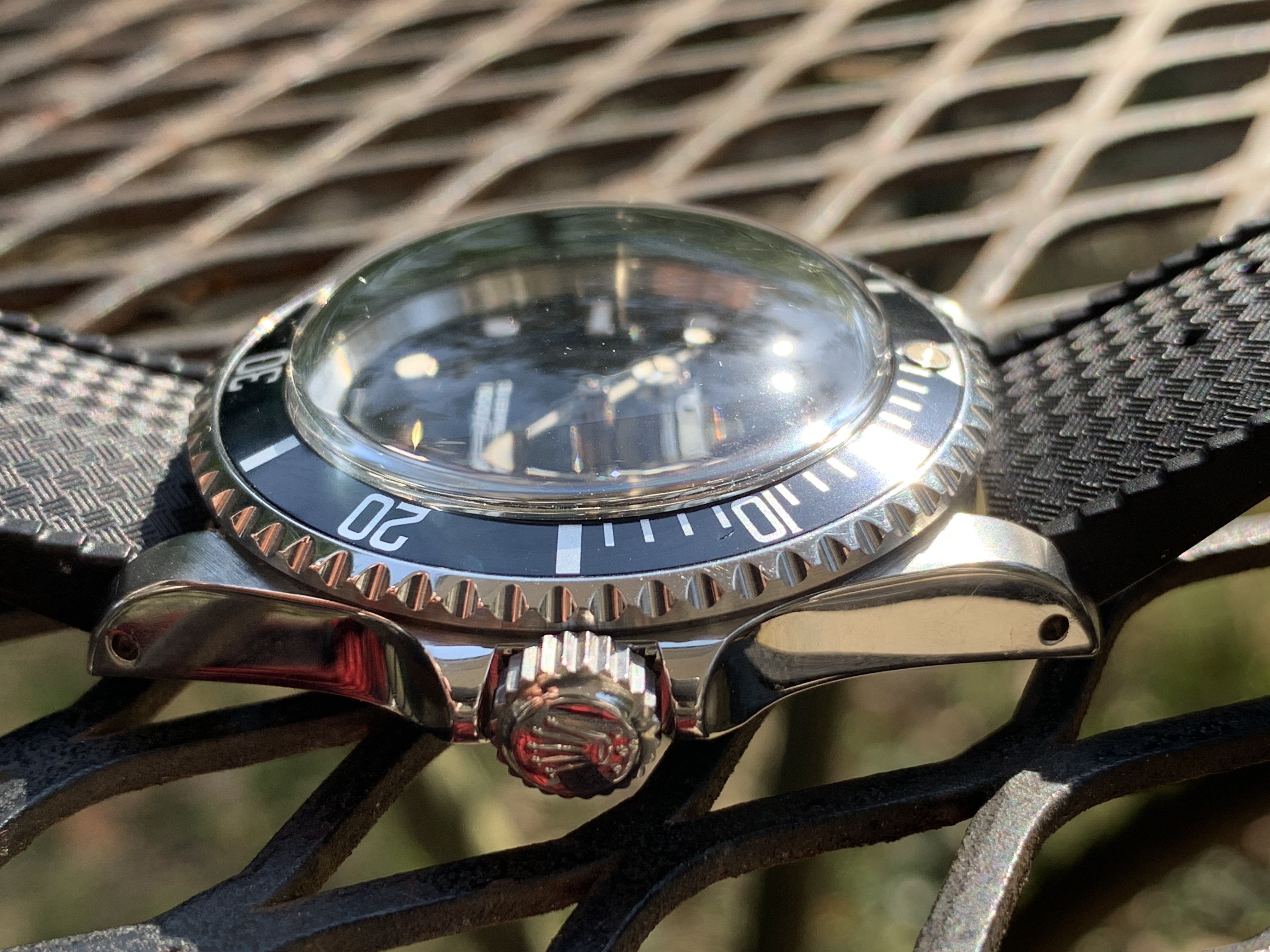

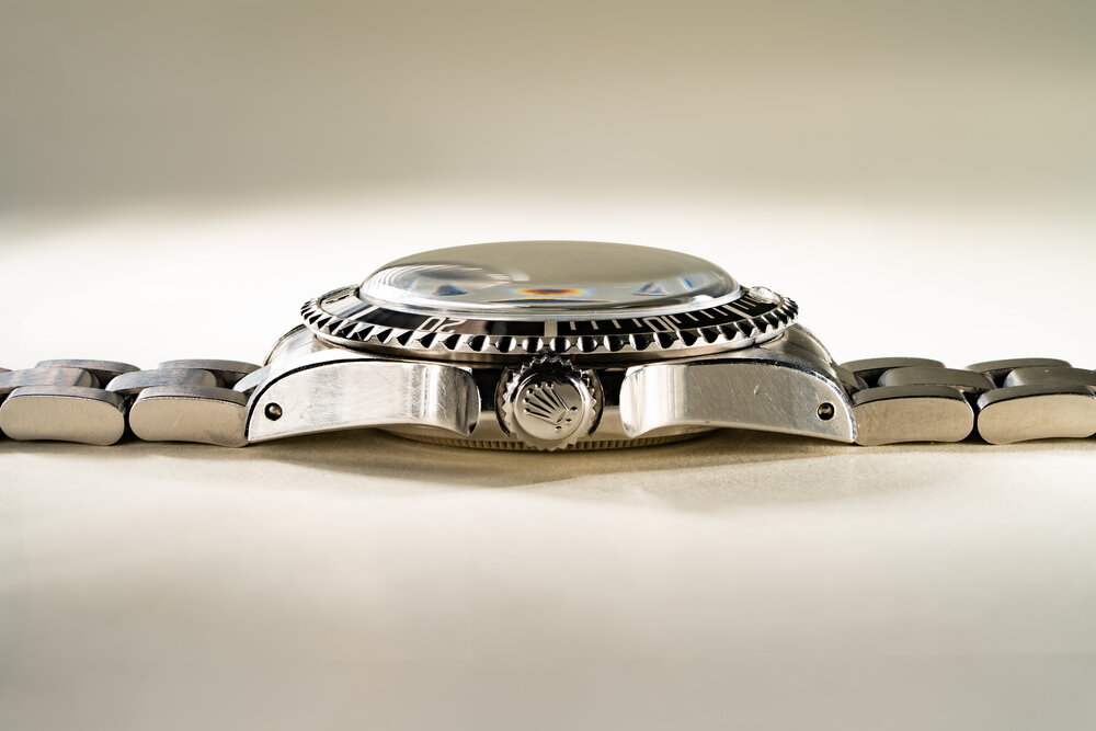

En face looks great much better than Rolex sapphire, side profile I am not so sure. Good job anyway👍
16,305
45,025
It is a higher dome than the truedome, and is rounder as opposed to the wider shoulder on the Truedome.
But considering there is no alternative for the 14060 that I could find, I think it’s a good start.

Well, you got me with that last photo! Nothing like a dome over a glossy black dial.
Now, if you can remove the white gold rings from around the markers, I’m interested.
(I’m not sure which I dislike more, sapphire crystals or white gold surrounds.)
16,305
45,025
I actually mind them less with this crystal. In fact I feel like it makes them pop more which is a good thing as it adds relief to the surface of the dial. If they’re there, might as well lean into it.
