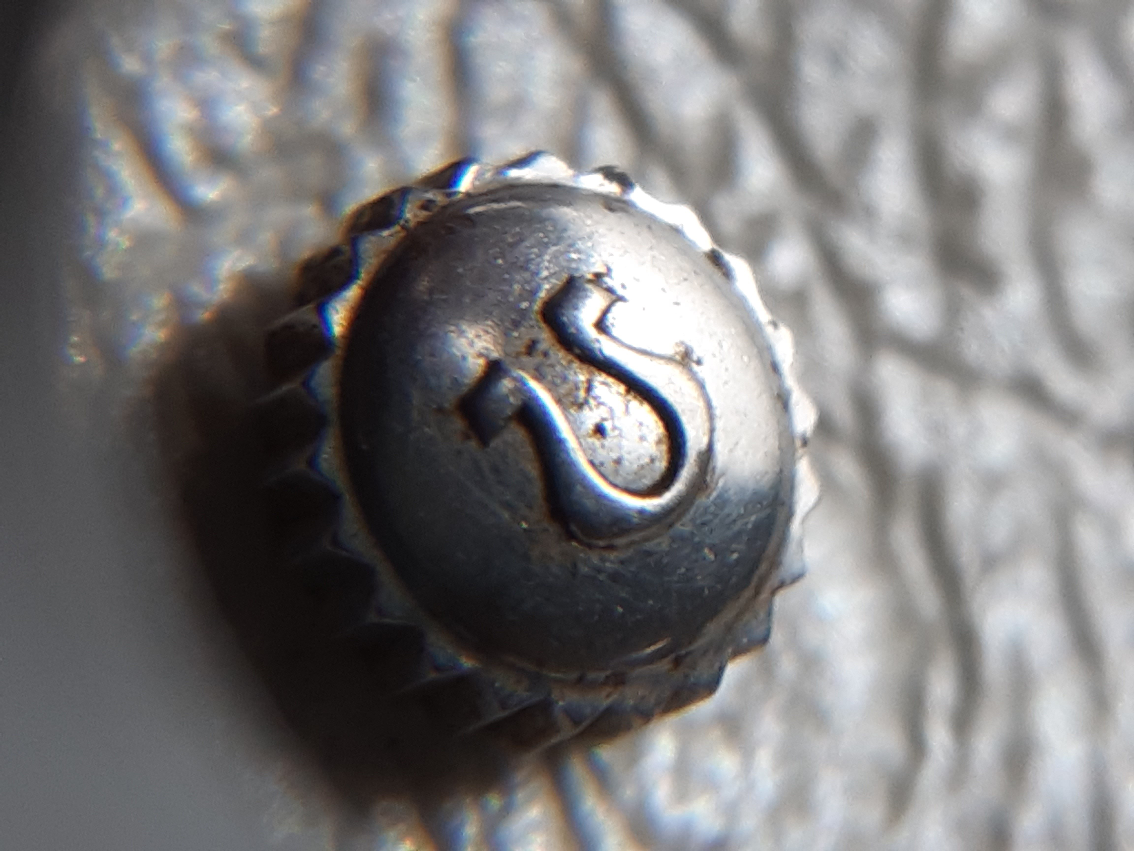

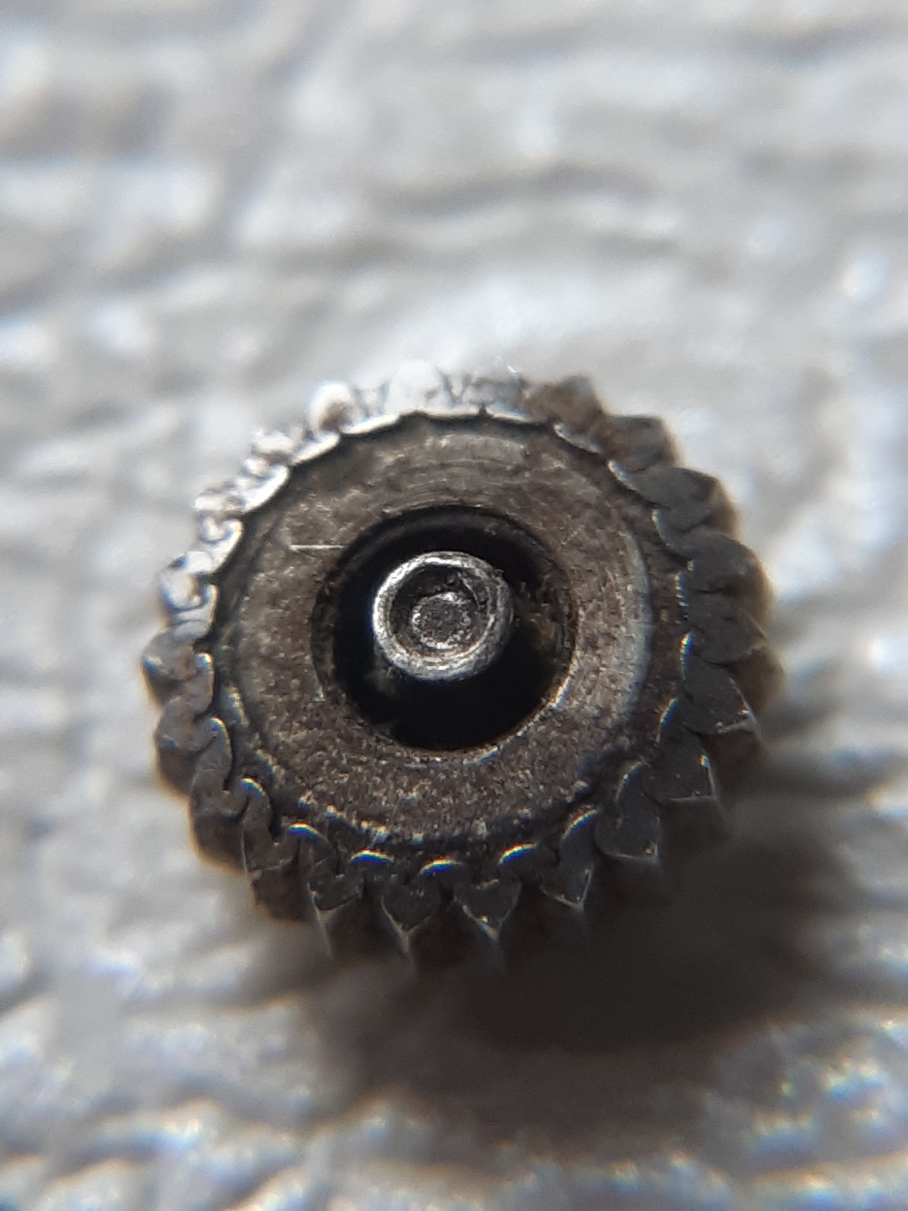

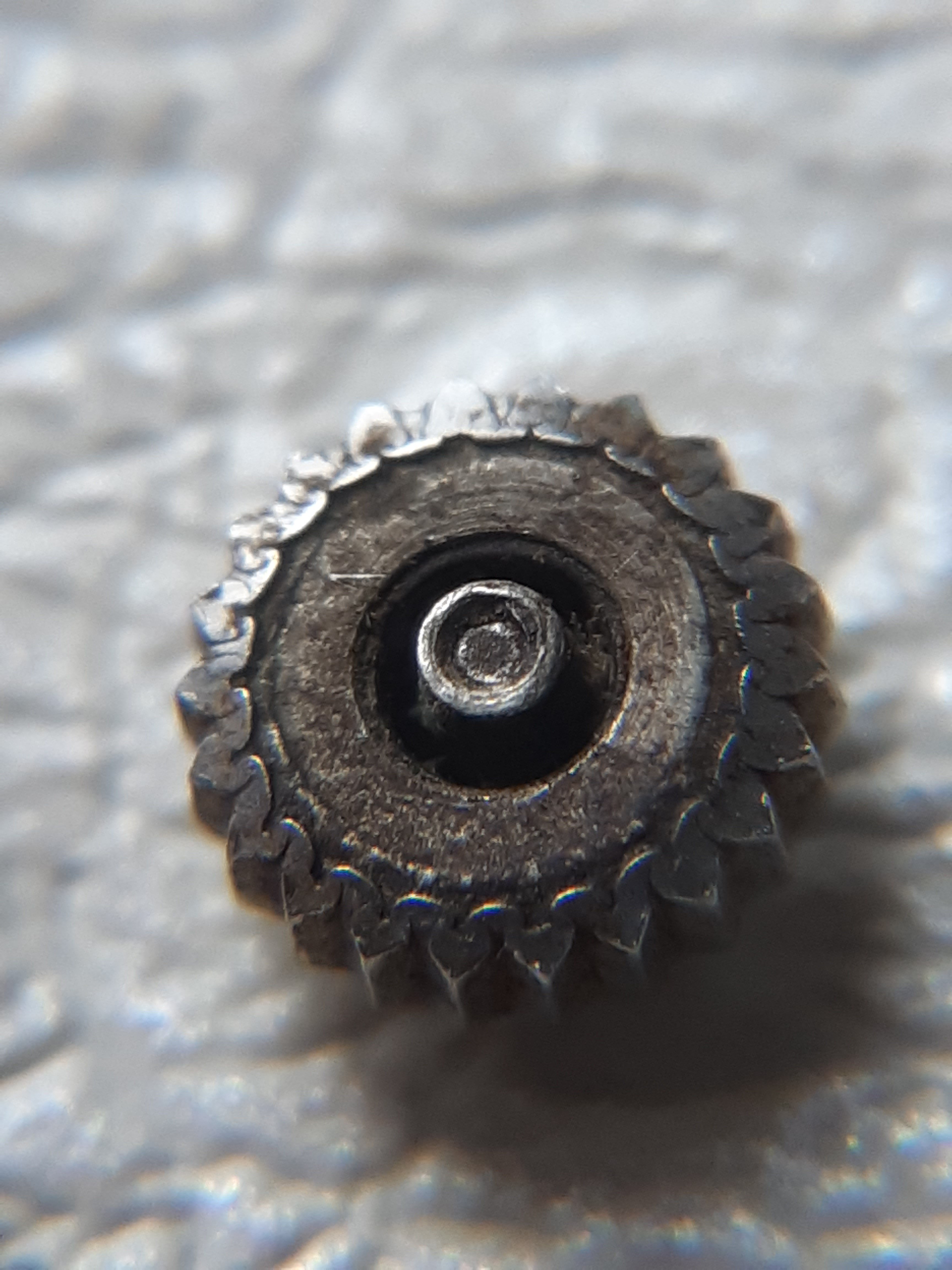

Hi everyone.
My stem is broken and the thread stuck inside the crown. How do i get it out?
Thank you guys
755
1,821
I tried the alum solution method and it does indeed work though it can be laborious. It also eroded the rubber gasket inside the crown. Ultimately it didn't quite do the job with my Omega for some reason ( thread worn?) and I ended up buying a new stem and crown.
30,285
78,161
Alum won’t erode a gasket, so likely it was already in bad shape.
87
71
At this point, the crown is unusable.. I guess there is nothing to lose, gonna give it a shoot.
I hope it works tho.
755
1,821
Yes, quite likely.
