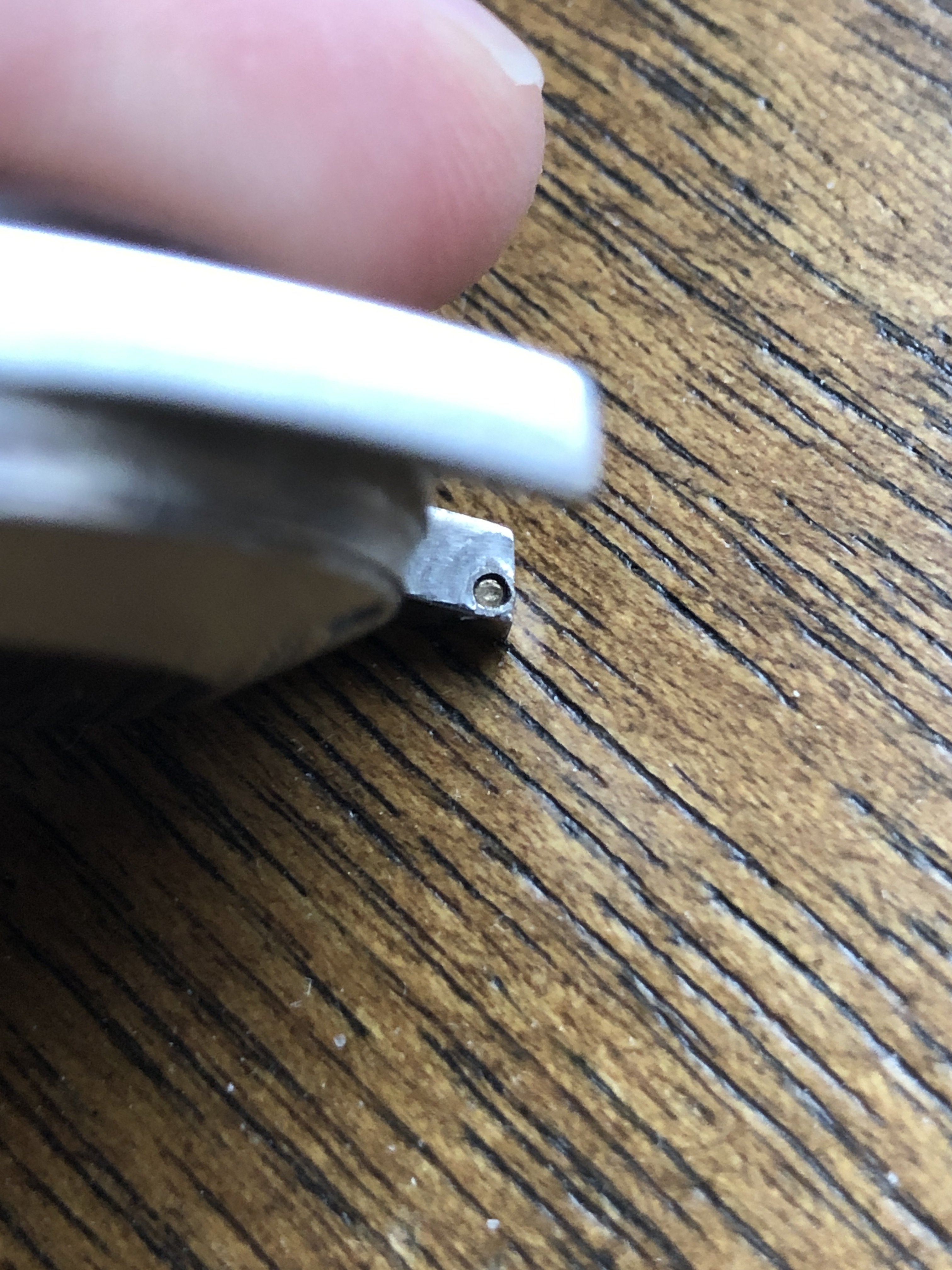

I got my order from CNS today and excitedly sat down for some strap changes. My excitement quickly turned to mild woe when I noticed this:
I assume that is a piece of a broken spring bar. I’ve tried cleaning the hole with a toothbrush, soap, and hot water. It didn’t seem to loosen whatever is stuck in there, so I’m trying to decide what to try next. The other suggestions I’ve seen for how to remove are:
1. Add a bit of solvent (rubbing alcohol?) to dissolve any gunk in there and try to remove it by manipulating it with tweezers or screwdriver after letting the solvent soak in there for a bit.
2. Same as above but with WD40 instead of a solvent.
3. Drill it out... (not too keen to try this one)
Any tips or advice OF has to share would be much appreciated. If I try some of the above fixes, should I start with the solvent? Is rubbing alcohol a good solvent to use for this?
Thanks in advance.

WD-40 should break down any rust that is causing it to stick, but you may have to leave it soaking for a while before that works. If it is sticking for a reason other than rust - the deformation of the lug in the picture indicates that this may be the case - you will just have to be patient and try to pry it out. A push pin is probably a good idea for this.

It’s really stuck in there. I’ve tried prodding it with a small cheap screwdriver, variety of pins, and pair of pointed tweezers, and it does not seem to be budging. For now, I have the lugs soaking in rubbing alcohol. I’ll give it a try again later tonight and see if it inclined to move before soaking in some WD-40.
I don’t have any push pins handy, so may run out and pick some up. I found a sewing kit in my travel bag that had a few sewing needles and safety pin, but I think a push pin would be a better option for this.
Will update on my next attempt, thanks for the responses!

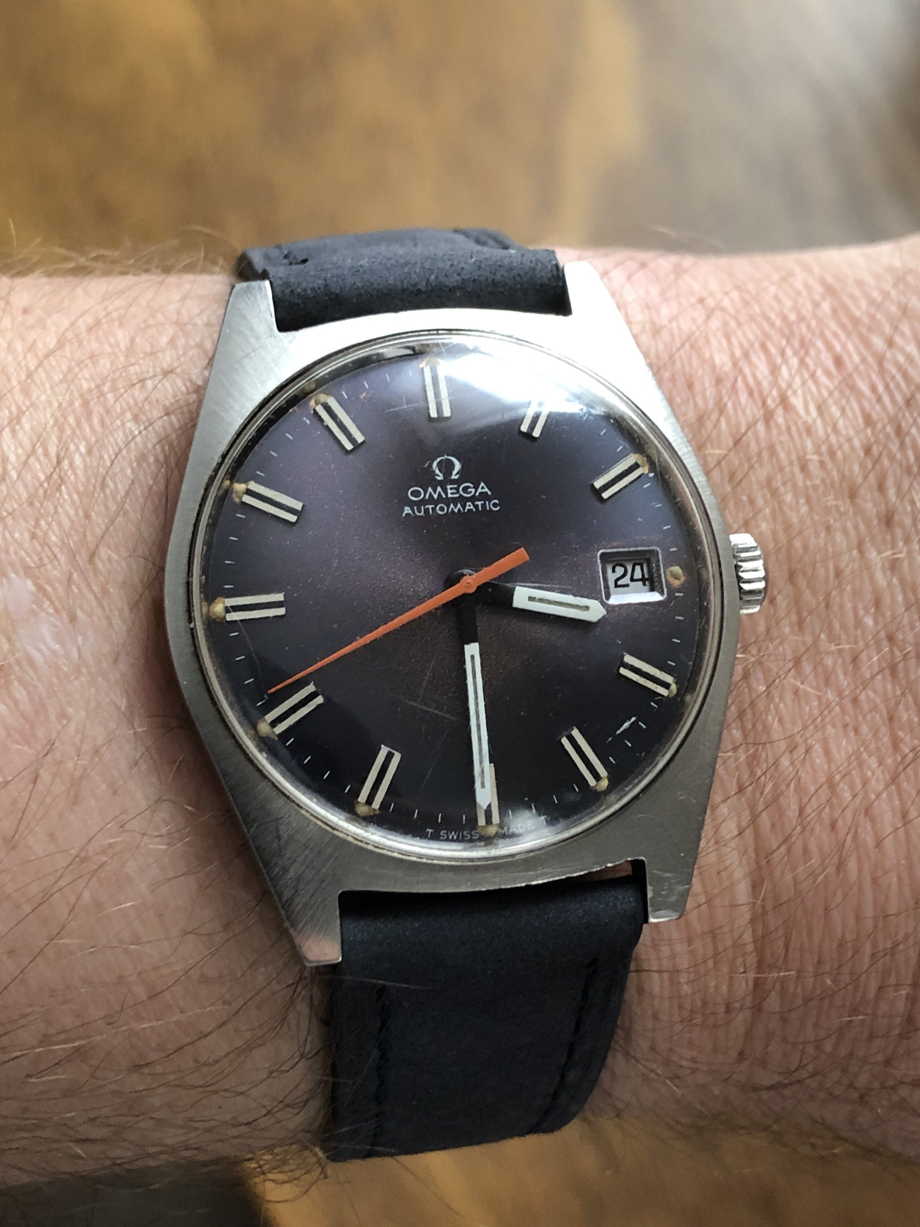

...and it’s out!!! Pulled it out of the alcohol and noticed it was moving a bit when I poked it. A bit more prodding and tapping, and it came out. The watch is reassembled, new strap installed, and ticking away on my wrist.
