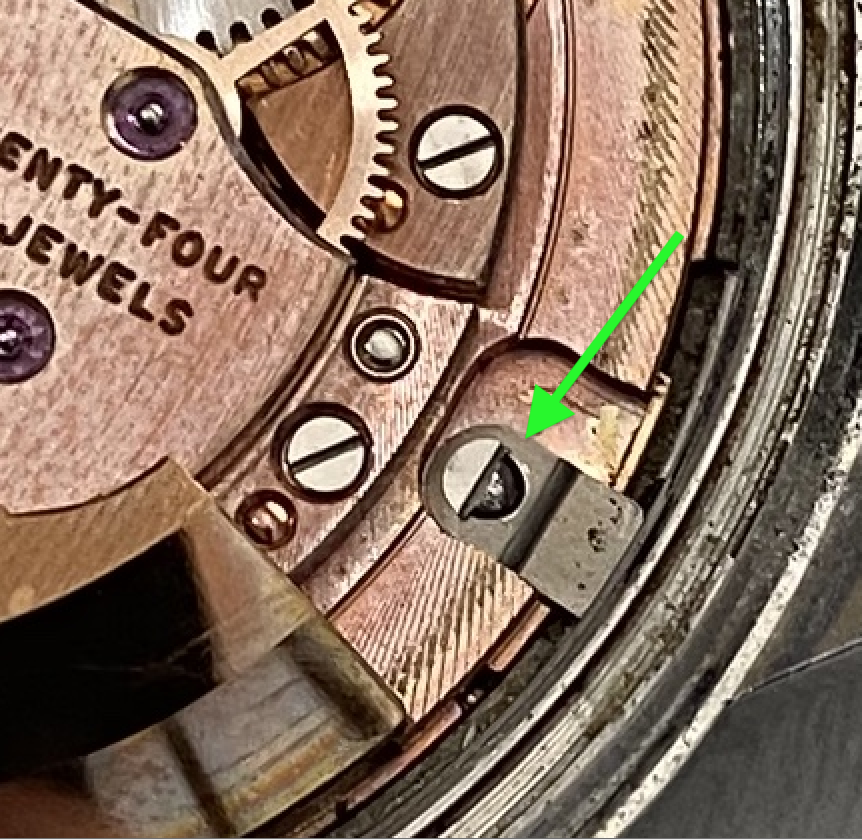

I just bought a 1965 Omega Seamaster, Case 165.002, Cal 552.
Got it for a good price, when I opened it up - I discovered why.
One of the case screws has a broken head, in your experience what would be a good approach to removing this screw whilst the movement is still in the case.
Many thanks

There is a trick that can be done with two screwdrivers. Where one is held vertical and the other horizontal to hold the screw against the remaining side. This only works if the screw is not locked in (cross threaded or rusted.) Bit tricky in this place to use Alum, which is something I am learning myself. This will attack any iron surface and turn it to rust.
Most watches have the screws drilled through. There is a tool, which in theory can lock into each side of the broken screw. Using such tools has mixed results. It is easy to bung the plate as the screw is harder than the brass alloy in the plate. One can also drill out the screw, which can also cause damage should the drill wander as it will dig in between the screw and the plate.

Thanks sheepdoll,
The screw is not locked as far as I can see no rust etc,
The tool you mention I can't use as the movement is still in the case and it can't be removed till this screw is extracted.
The first option I could try but will be difficult as the screw i so tiny.

You could try a tiny spot of oil under the screw head and under the tab.
Let it soak for a while and then use a fine screwdriver to push the tab in an anticlockwise direction (into the recess).
This should enable the movement to be freed from the case.

Thanks JimInOz and sheepdoll,
I tried pushing the tab back and forth a few times without oil to see if it would move the screw, which it did a little
I then tried sheepdoll's technique with the two screw drivers and it worked, the screw is now out.
Many thanks for your help, eternally grateful
