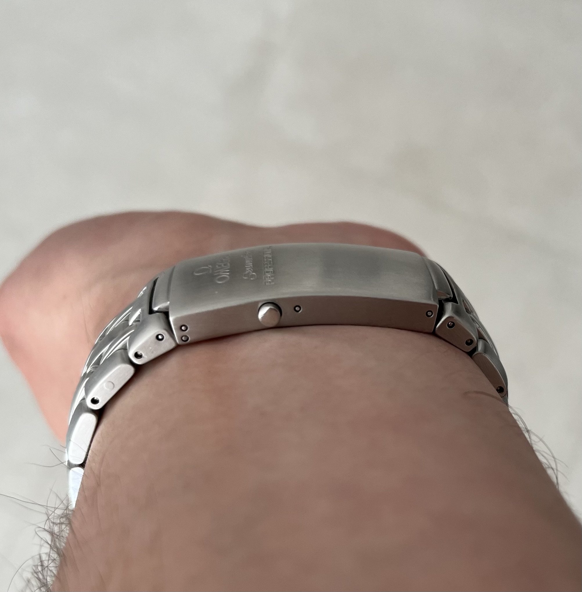

Each to his own. The old deployant mechanism is completely hidden in the clasp when closed, which means that it doesn't ever dig in your wrist. Also the lack of adjustment makes the whole clasp thinner, almost as thin as the bracelet itself so on the outer side the clasp doesn't even protrude.
I think it's a perfect design and personally I value it over the option of adjustment. Especially as I like a loose fit by default so during summer the bracelet still fits well
And I love the complete Seamaster Professional branding 😀
