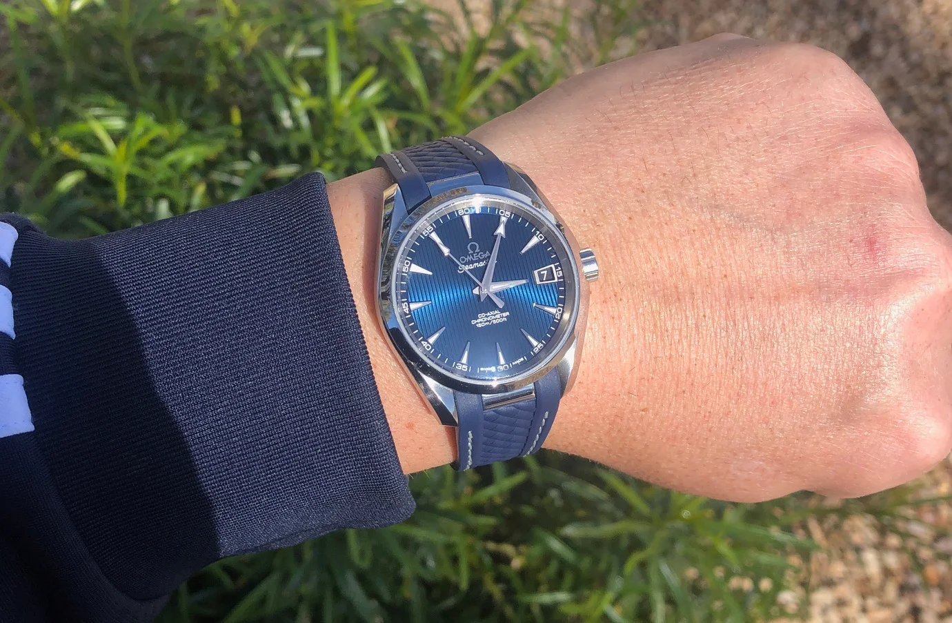

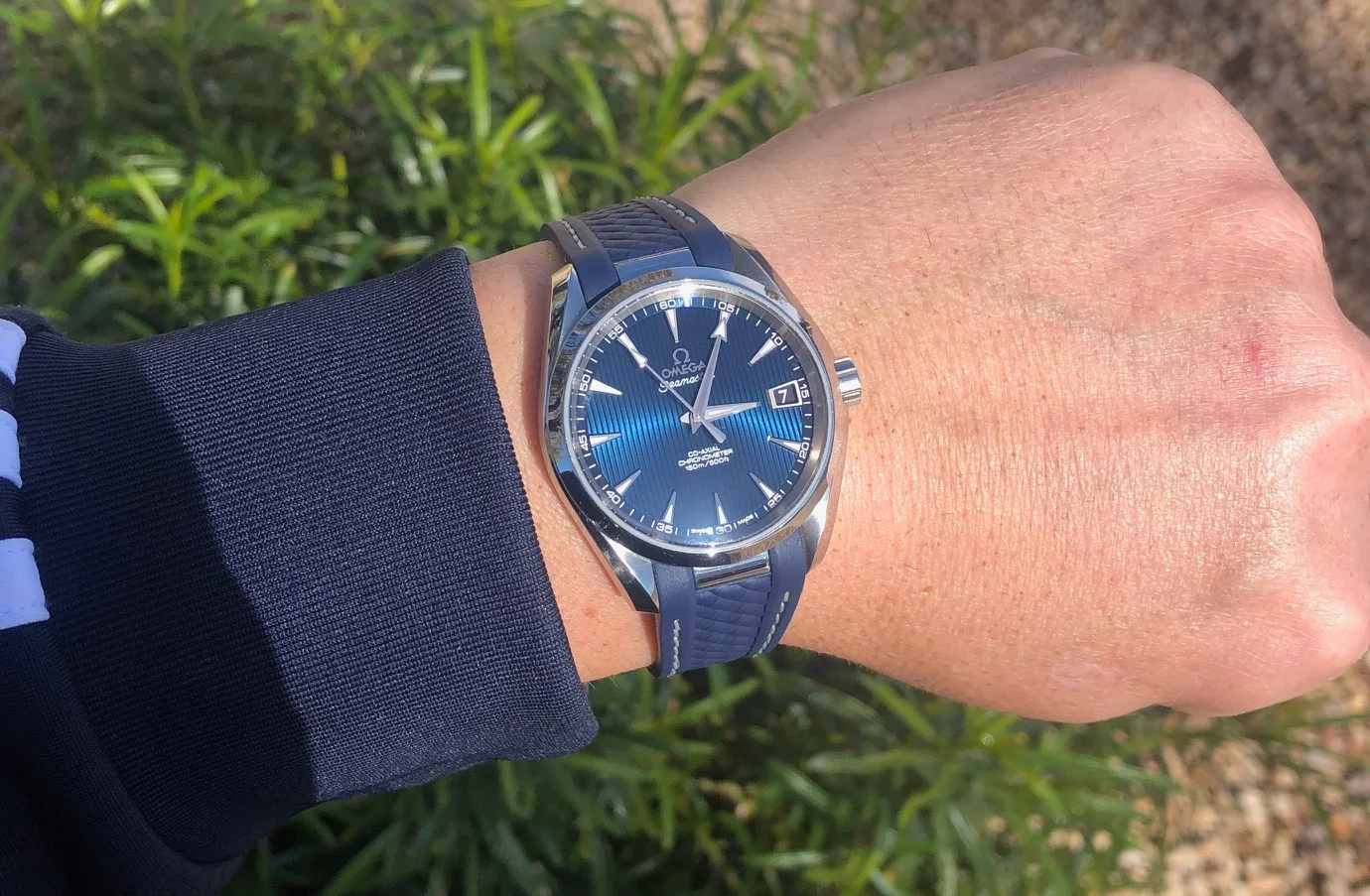

I use a small rectangle of double sided tape on the edge of the end link to make sure they do not rattle or rotate. It's not the ideal solution I will admit, but I had an extra 38mm bracelet. I had previously owned 38mm AT's but now the only one that remains is my 38.5mm Skyfall blue AT.
As a side note, the strap for the 38mm AT will fit the 38.5mm AT very nicely with no modification. The strap does not have any tabs on the side.
