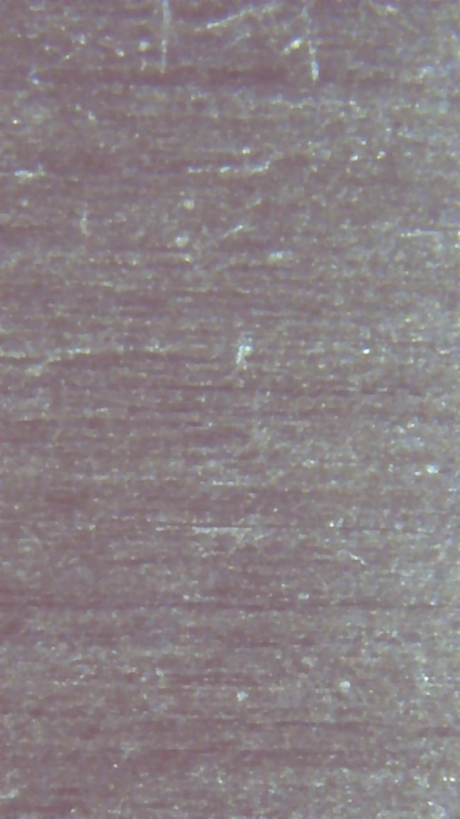

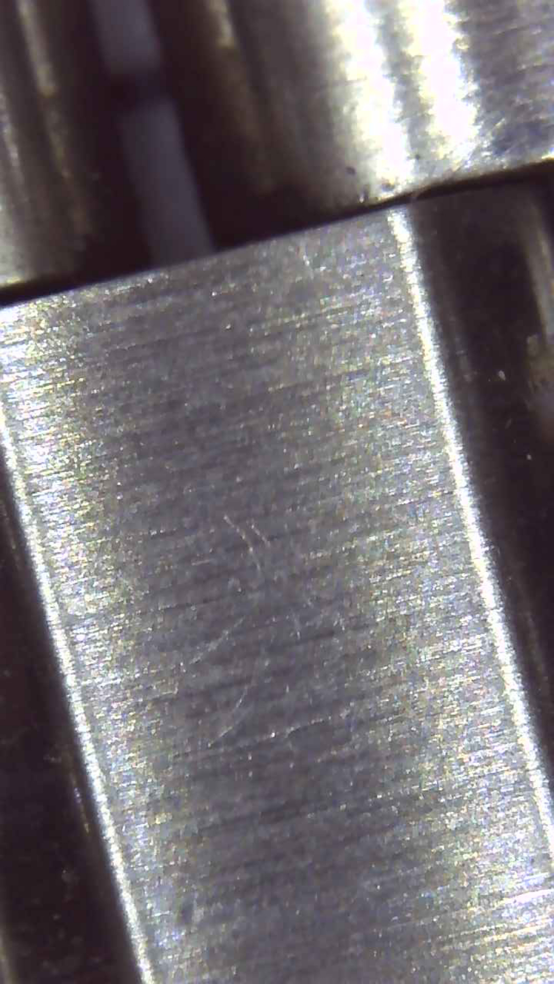

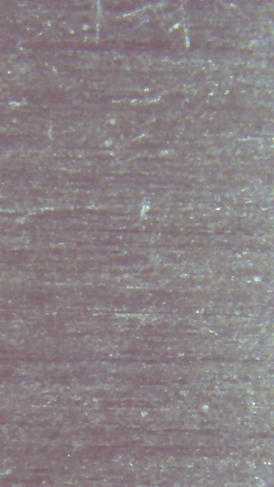

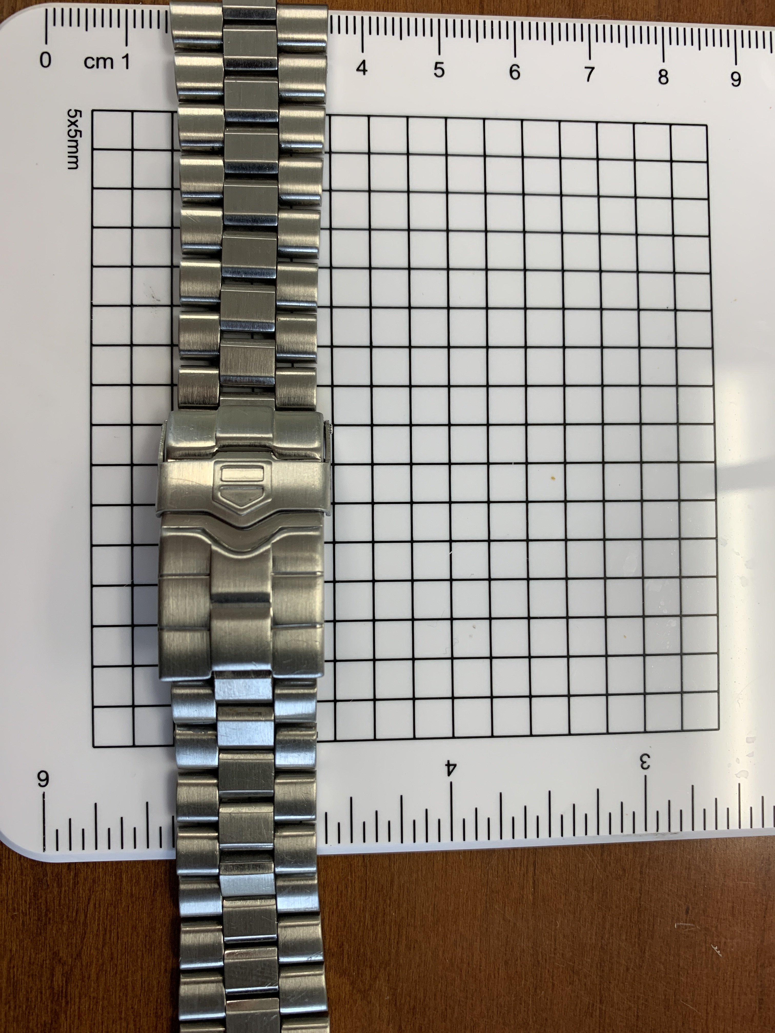

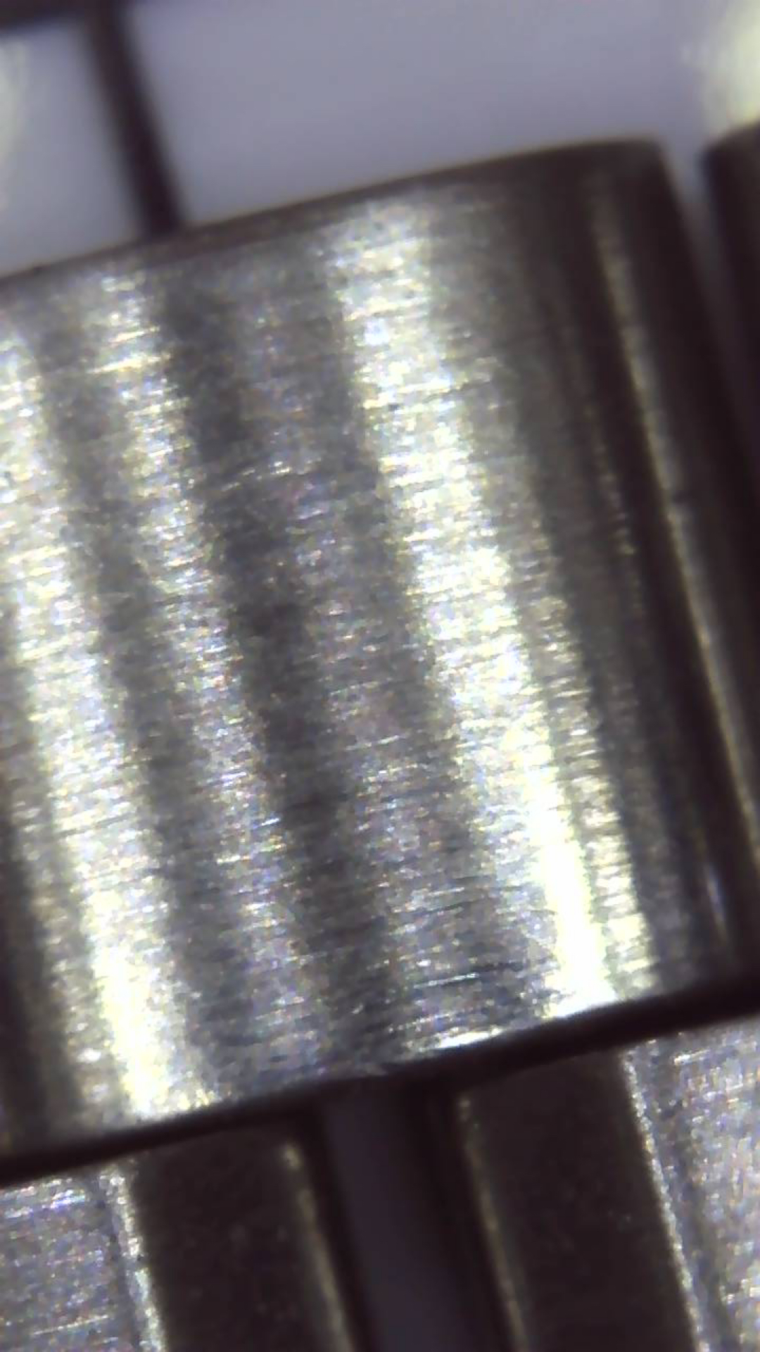

Here are some pics from the microscope. This was a TAG 2000 that I received in 1995 for college graduation. I beat the hell out of this strap over the years. Decided to make the middle links brushed too. I will post pictures of brand new PO strap too.
