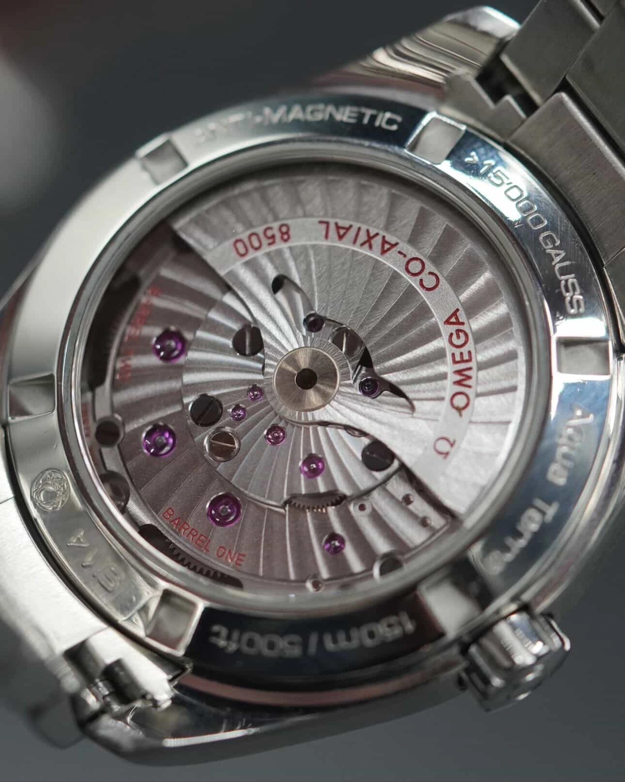

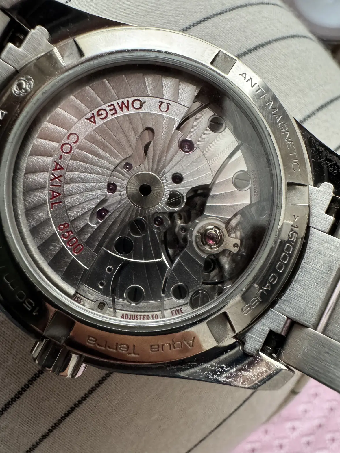

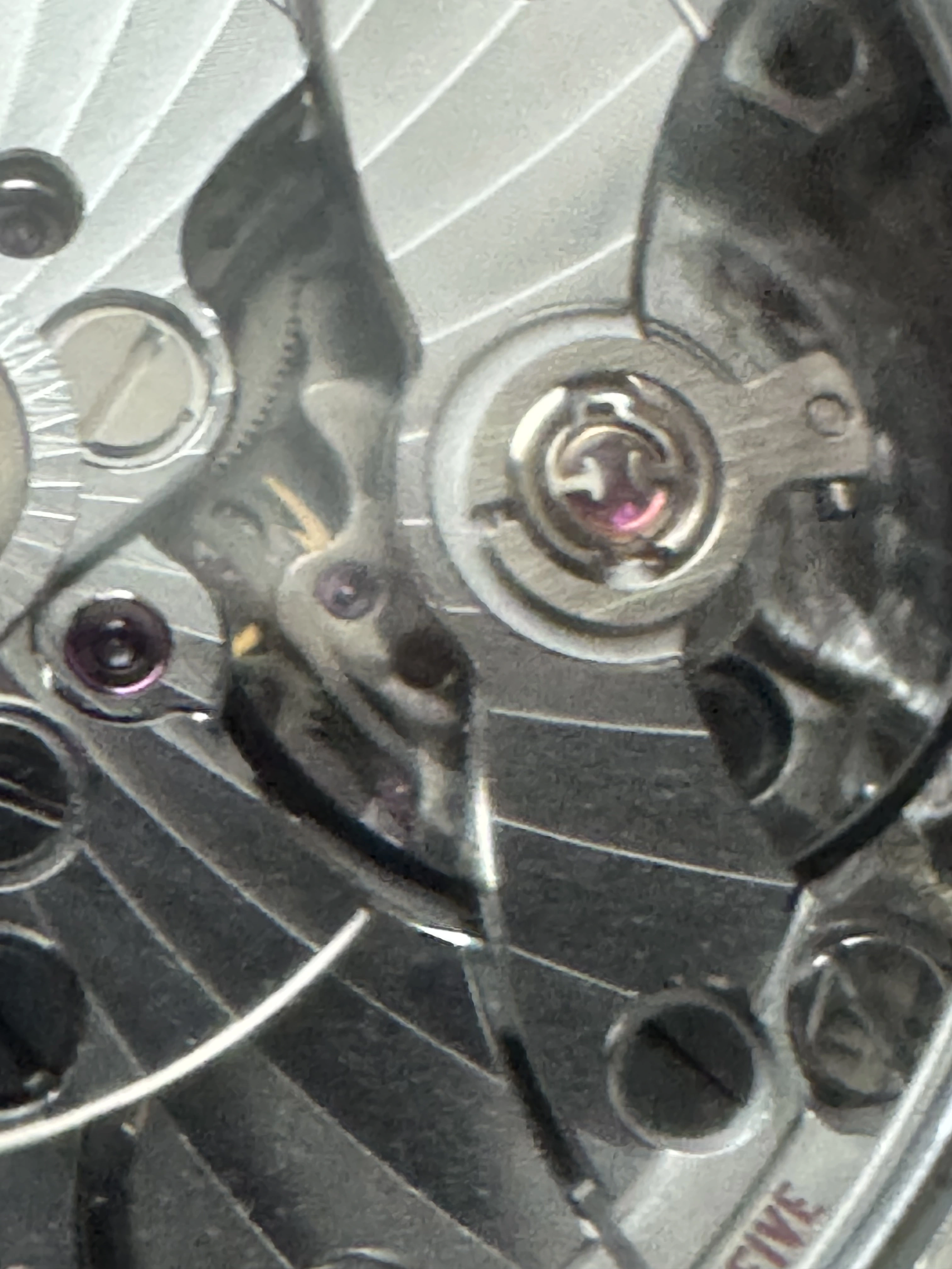

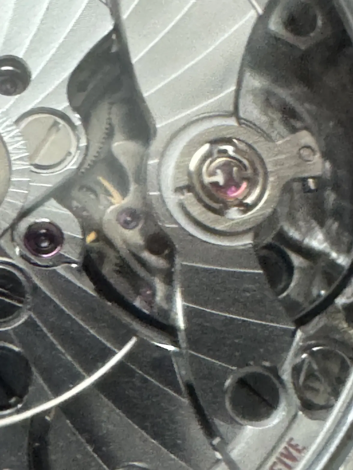

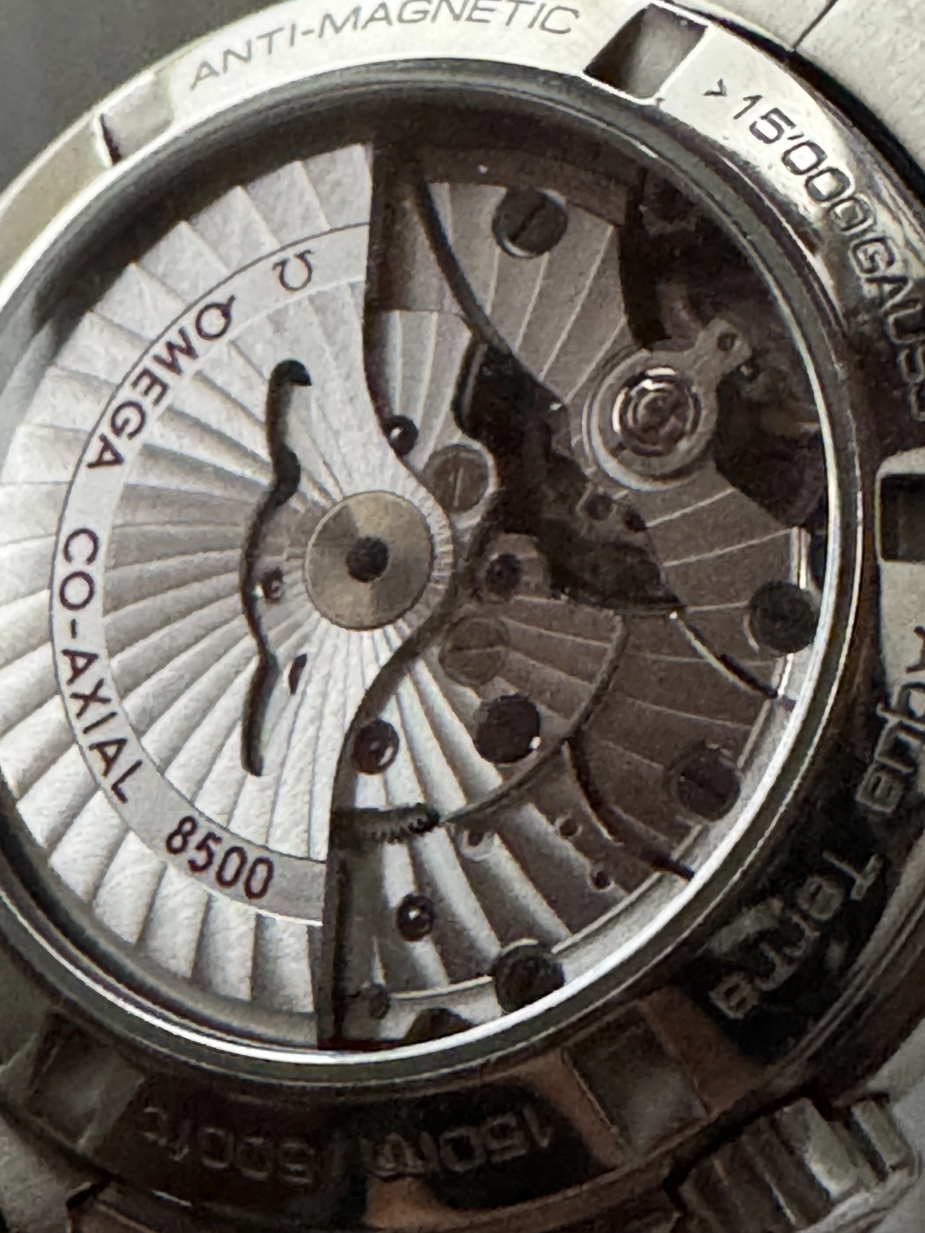

  1. There’s a noticeable mark/smudge on the rotor. The dealer described the watch as being in excellent condition and likely never serviced. If that’s the case, what could cause a mark like this?

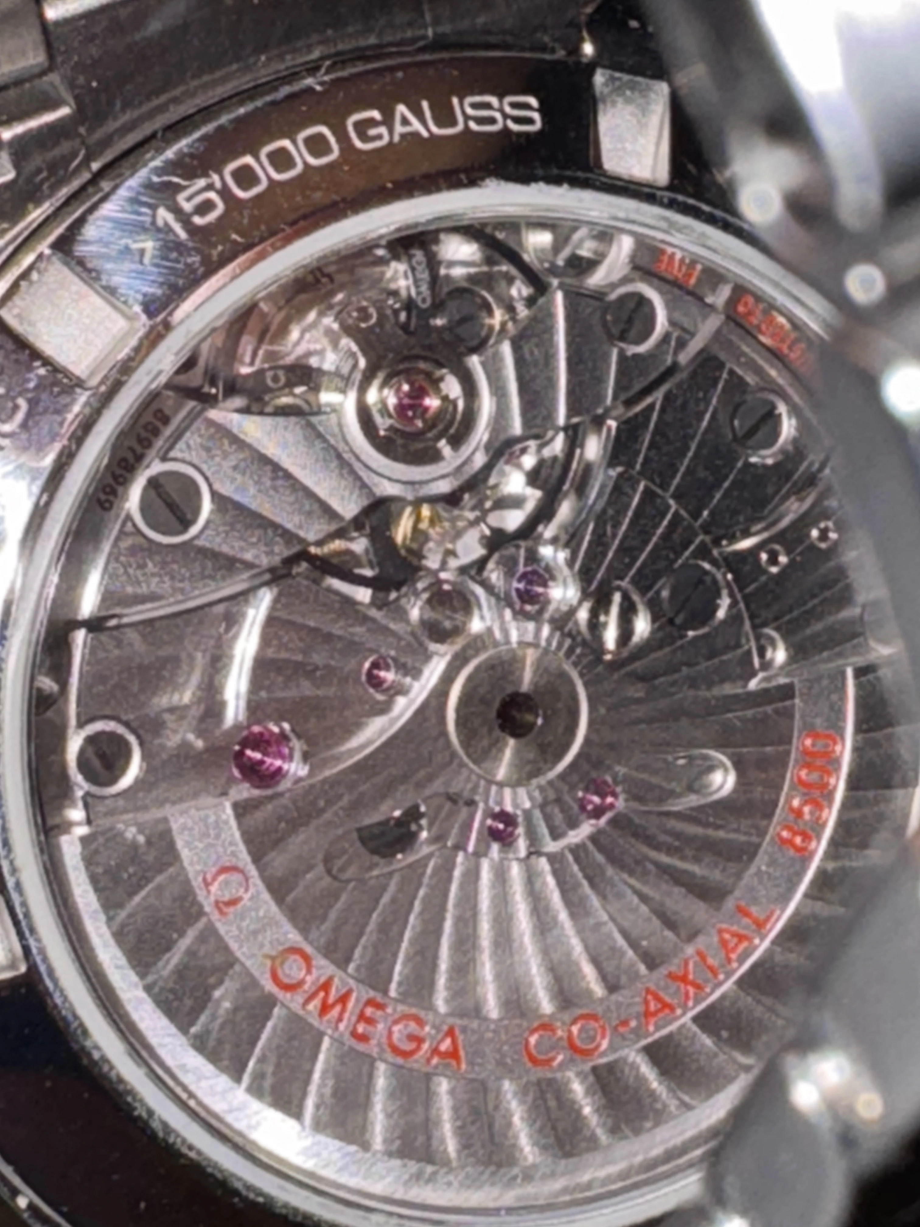

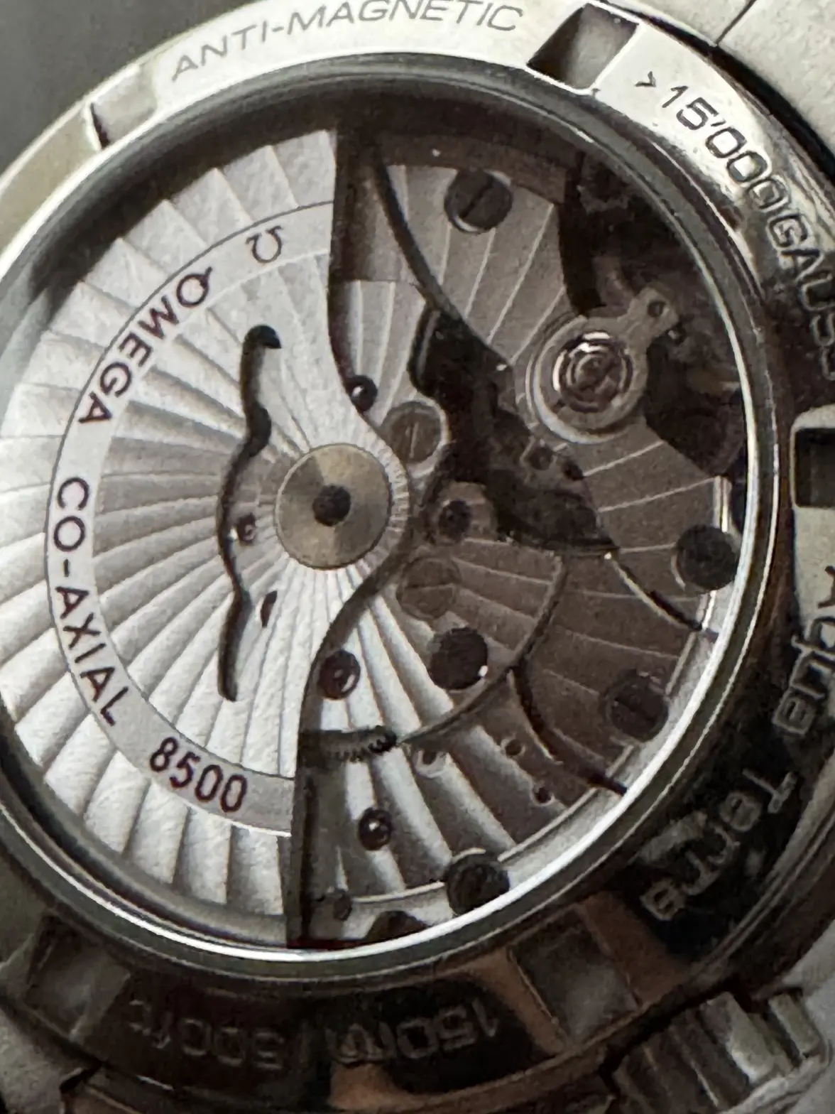

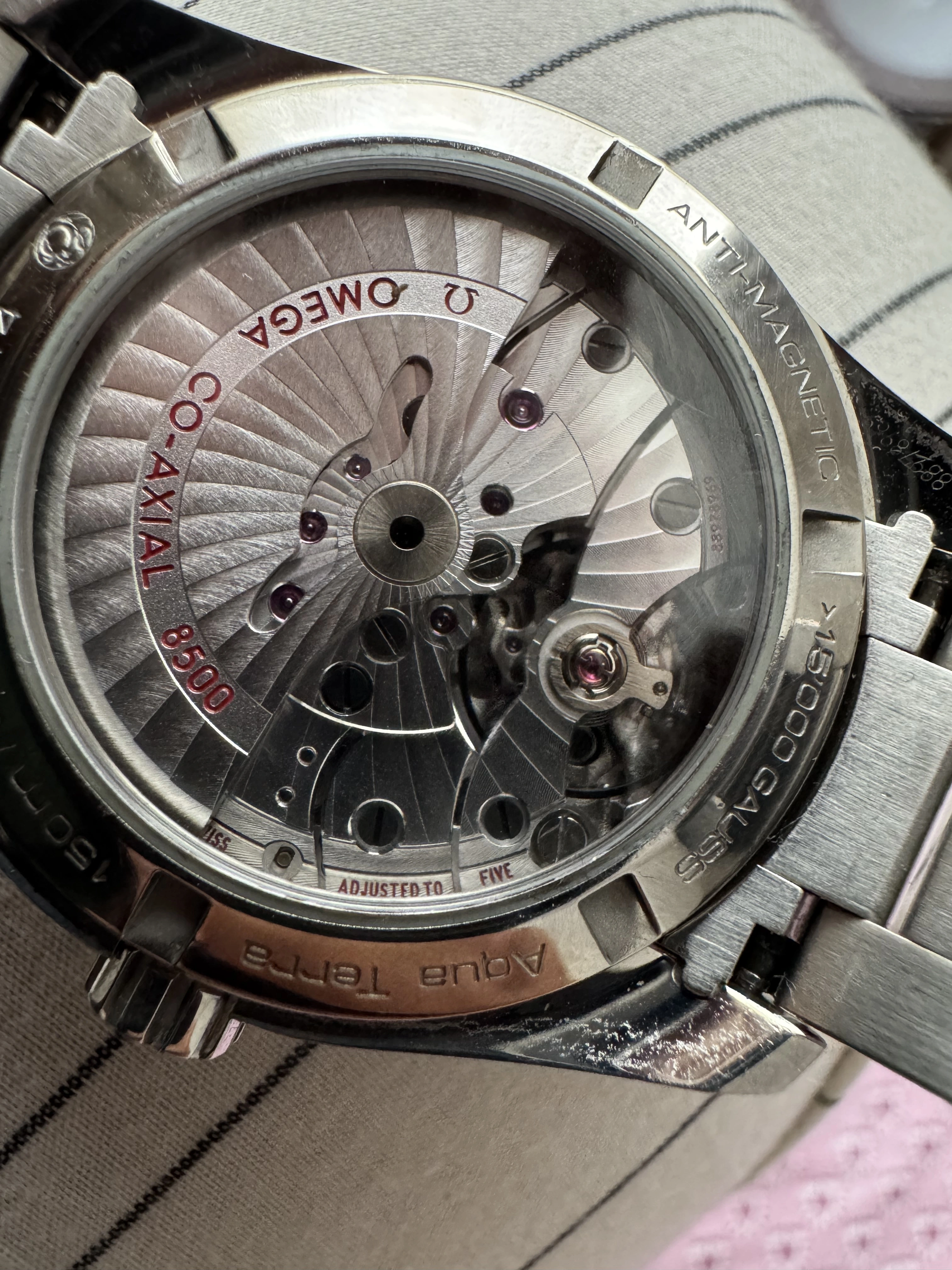

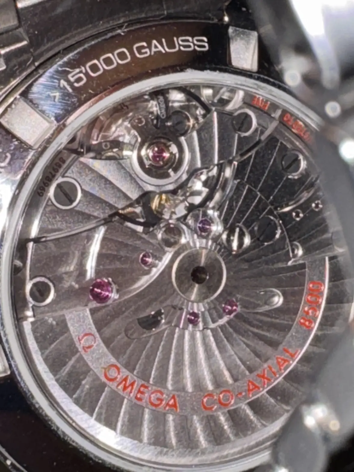

  2. I can’t see a visible Si14 engraving on the balance spring. When I stopped the movement and looked closely, I could only make out the Omega logo and text. Since this is a Master Co-Axial model, I was expecting to see Si14 somewhere on the balance assembly.

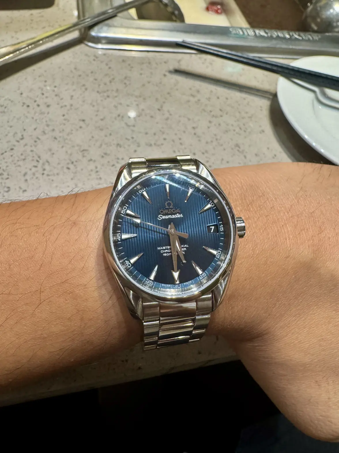

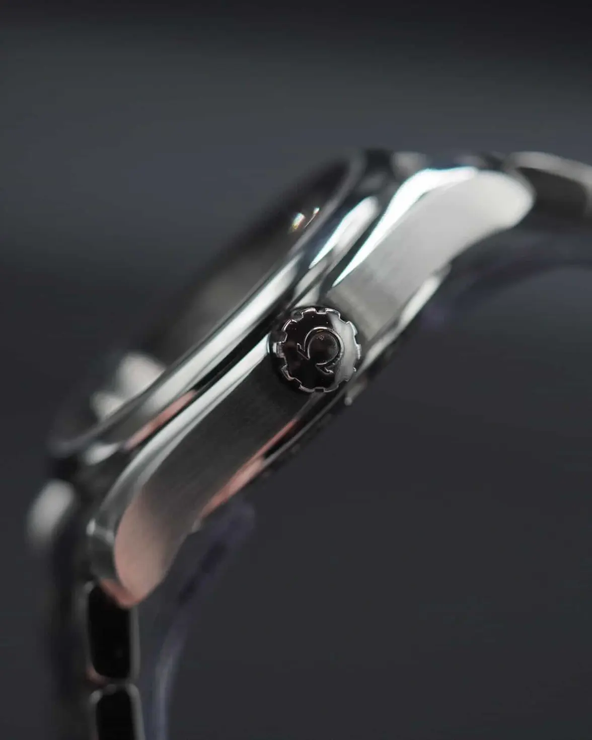

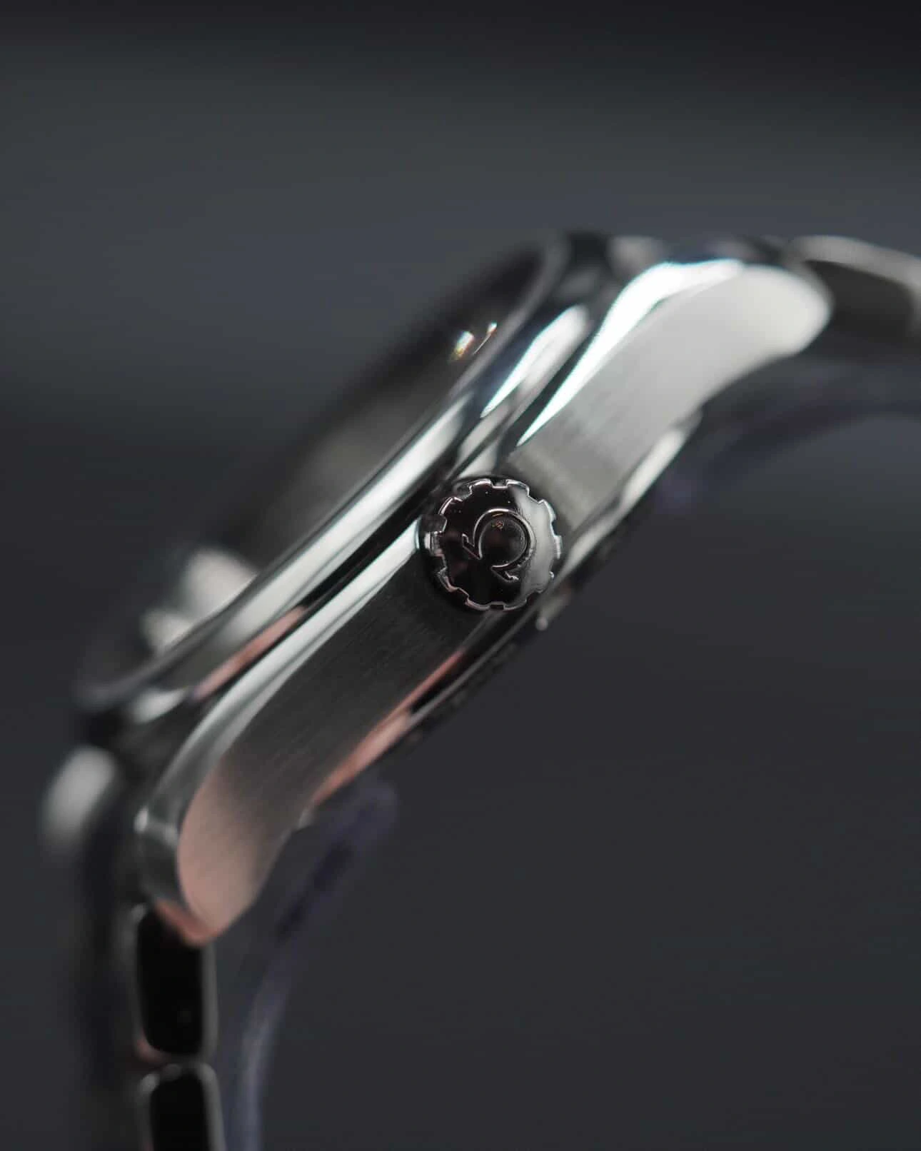

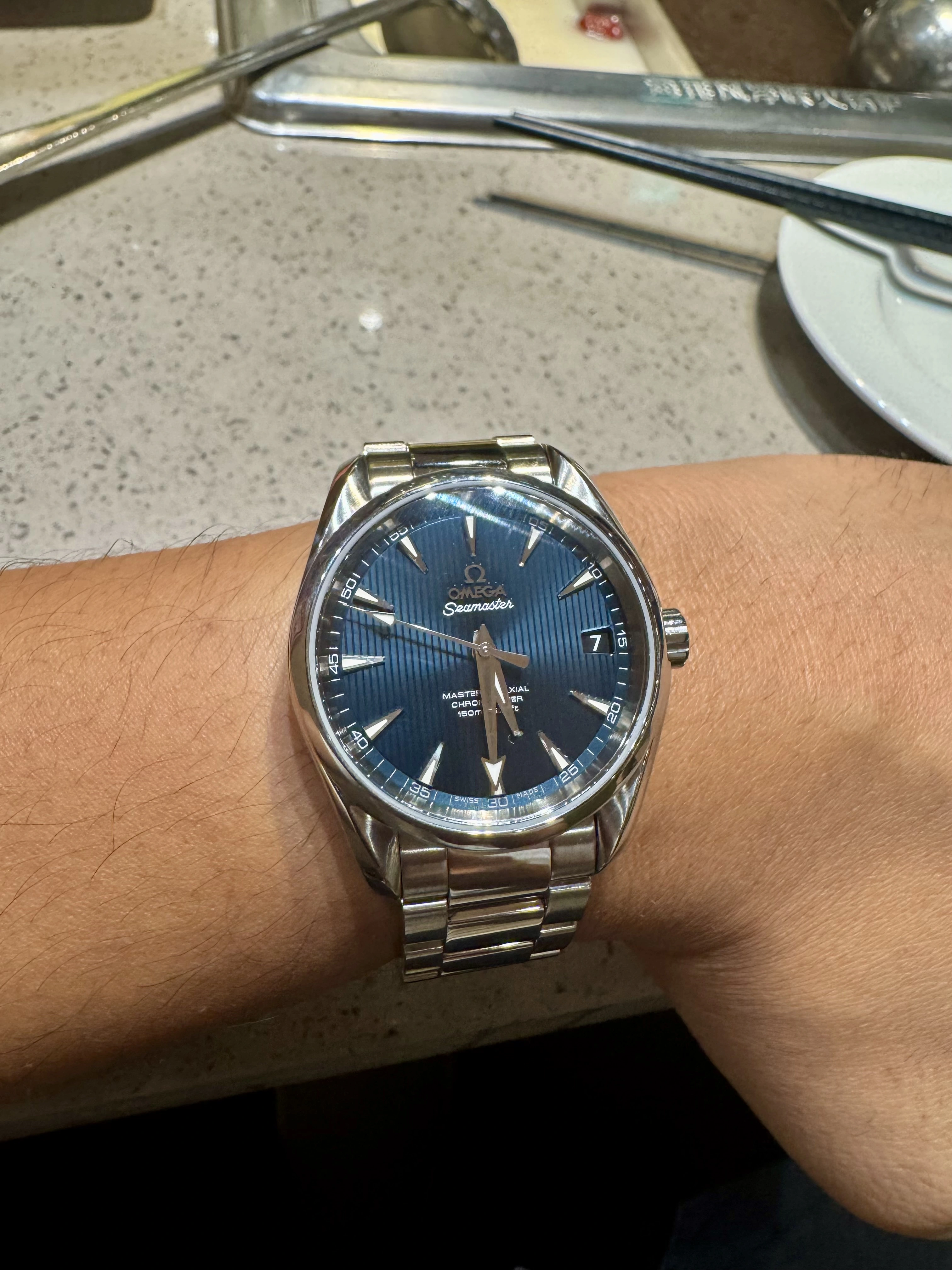

  3. The crown appears much shinier than every example of this reference I’ve been able to find online. Has anyone seen this before? Could it simply be polishing, a replacement crown, or something else?

Looks at least like a 'real' watch. I don't believe the 'never been serviced', as it looks like it at least has been opened. Unfortunately many watch sellers will re-regulate watches when they get them and not disclose it.
The crown being shinier could be just photos/perception, or it hit a buffing wheel, not something I'd be concerned about.
I think based on online photos that the markings on the balance are at least somewhat inconsistent as to which is on which arm. So I don't think I'd worry about that either.
SO I'm going to guess:
  • Everything here is completely normal
With the caveat of "but someone has taken the case back off and wasn't particularly clean".

Thank you. My concern is the balance wheel doesn't have an Si14 engraving on it.

Thank you for the information. I just can't get past some minor details such as missing Si14 engraving on the balance wheel despite the watch a master co axial
So this is a 'real' watch/movement. There aren't really non-Omega replacements to the balance wheel as far as I know (no one is doing clones that result in compatible parts), so I'd have to assume it is an Omega produced part. Whether it is on a different spoke that you just can't see, or printed differently because Omega has changed the engraving, who knows. But I don't really see any reason to be conerned by that.

The ref Archer provided, 23110392103002, is antimagnetic—you could hold a magnet to it and see if it affects the timekeeping. As far as I know, no counterfeit Omegas are antimagnetic…
