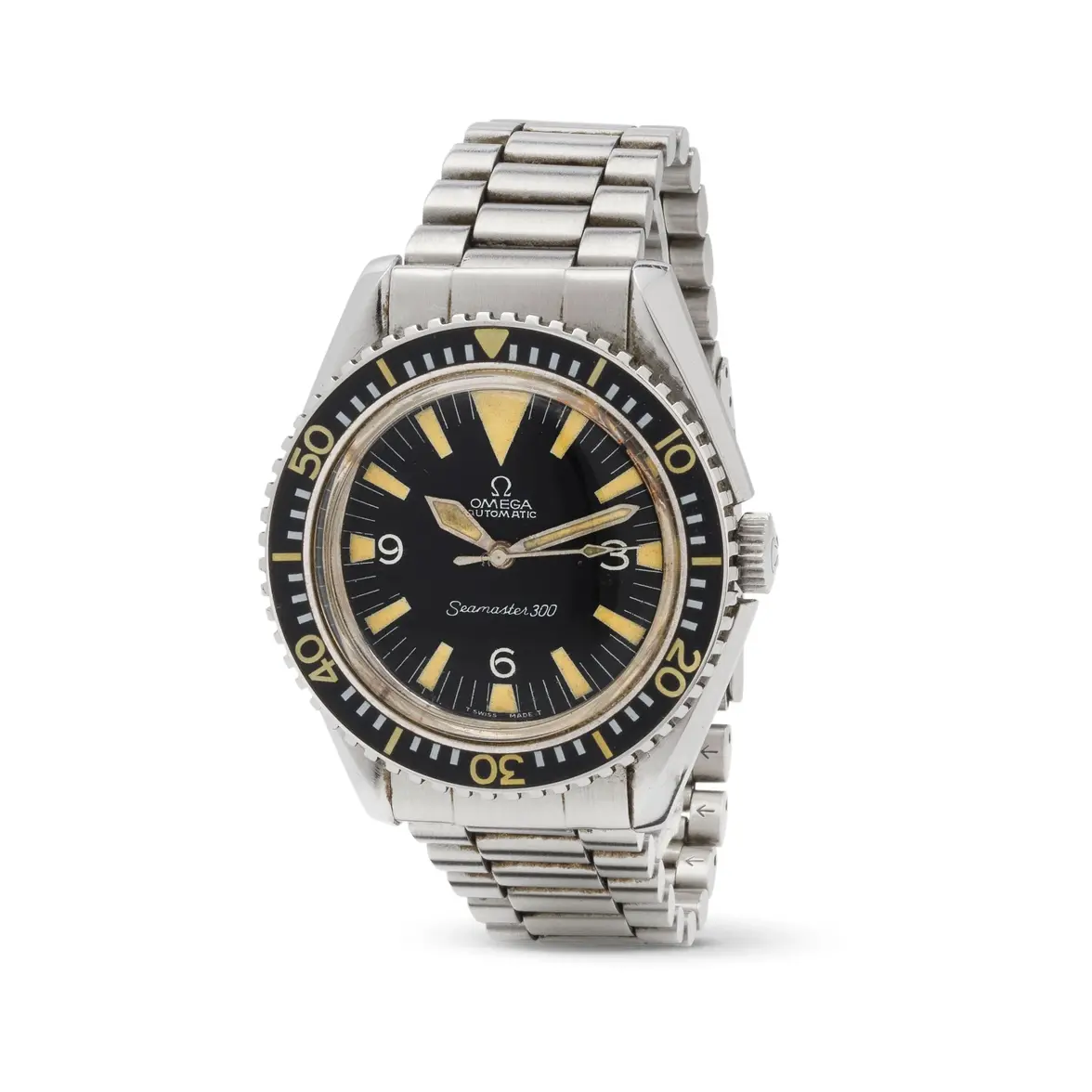

Bonham’s Fake Seamaster 300

What makes you think its fake? It looks like a later service bezel, lume looks like tritium - maybe the dial has been reprinted but hard to see as it could be some weird AI shit they use on the photos.
It doesn't look like one of the chinese/vietnamese fantasy cases that popped up after the whole WatchCo thing.

1) Bezel is not even close. They never made a bezel of that font and with the fat knurling. Bezel is totally consistent with the Vietnamese fake cases.
2) Anyone can mix together tritium looking lume. Dial is totally fake. Has the well known "stubbies" tell and incorrect font from the Vietnamese fakes.
3) 14744-61 is a straight lug reference, but the midcase is a later generation twisted lug case (Ref. 165.024). The midcase may or may not be real. However, the crown is way too small for that case.
So fake bezel, fake dial, wrong or fake caseback, wrong crown, and maybe a real midcase?

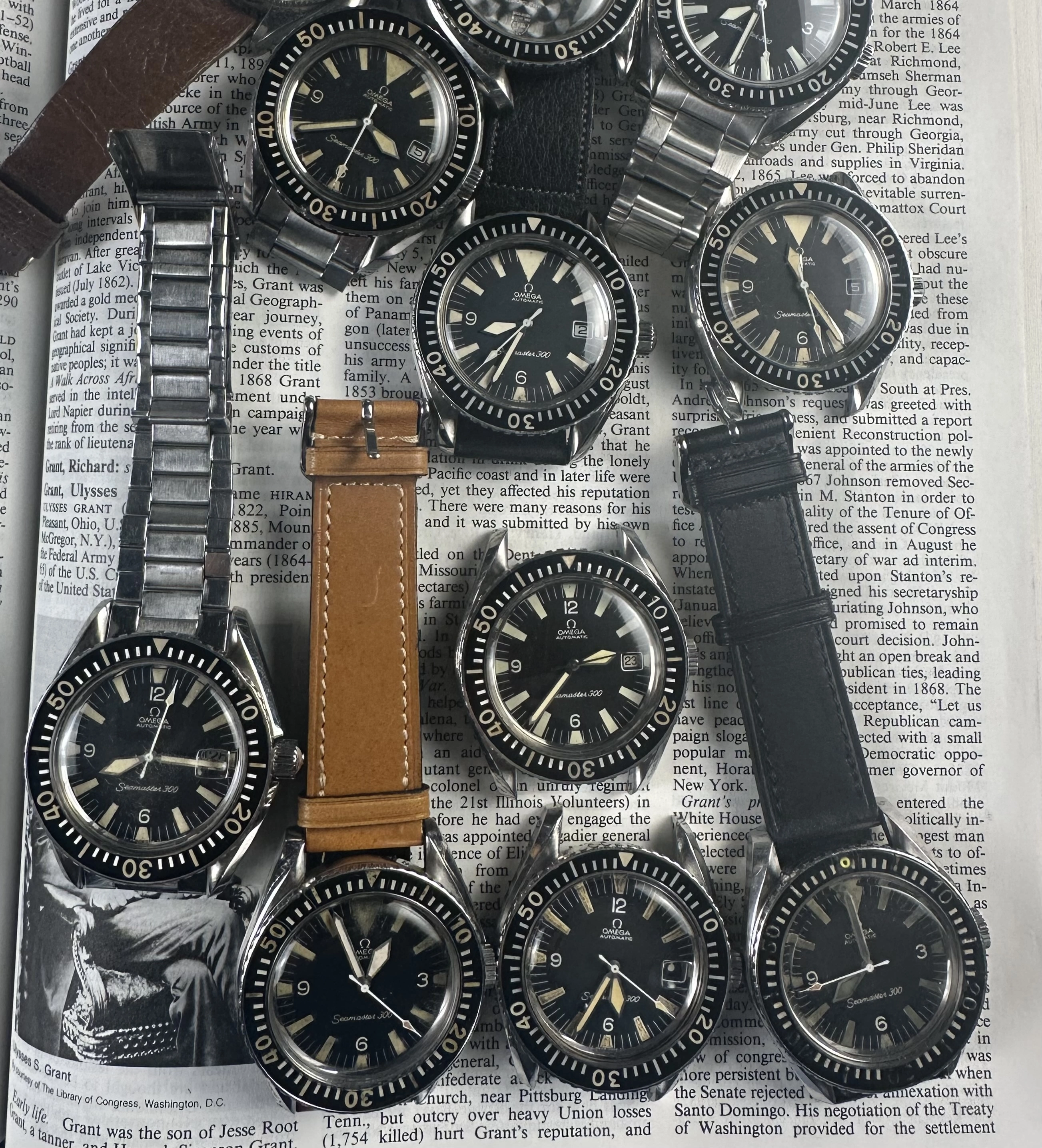

Here are some examples for reference:
316
766
