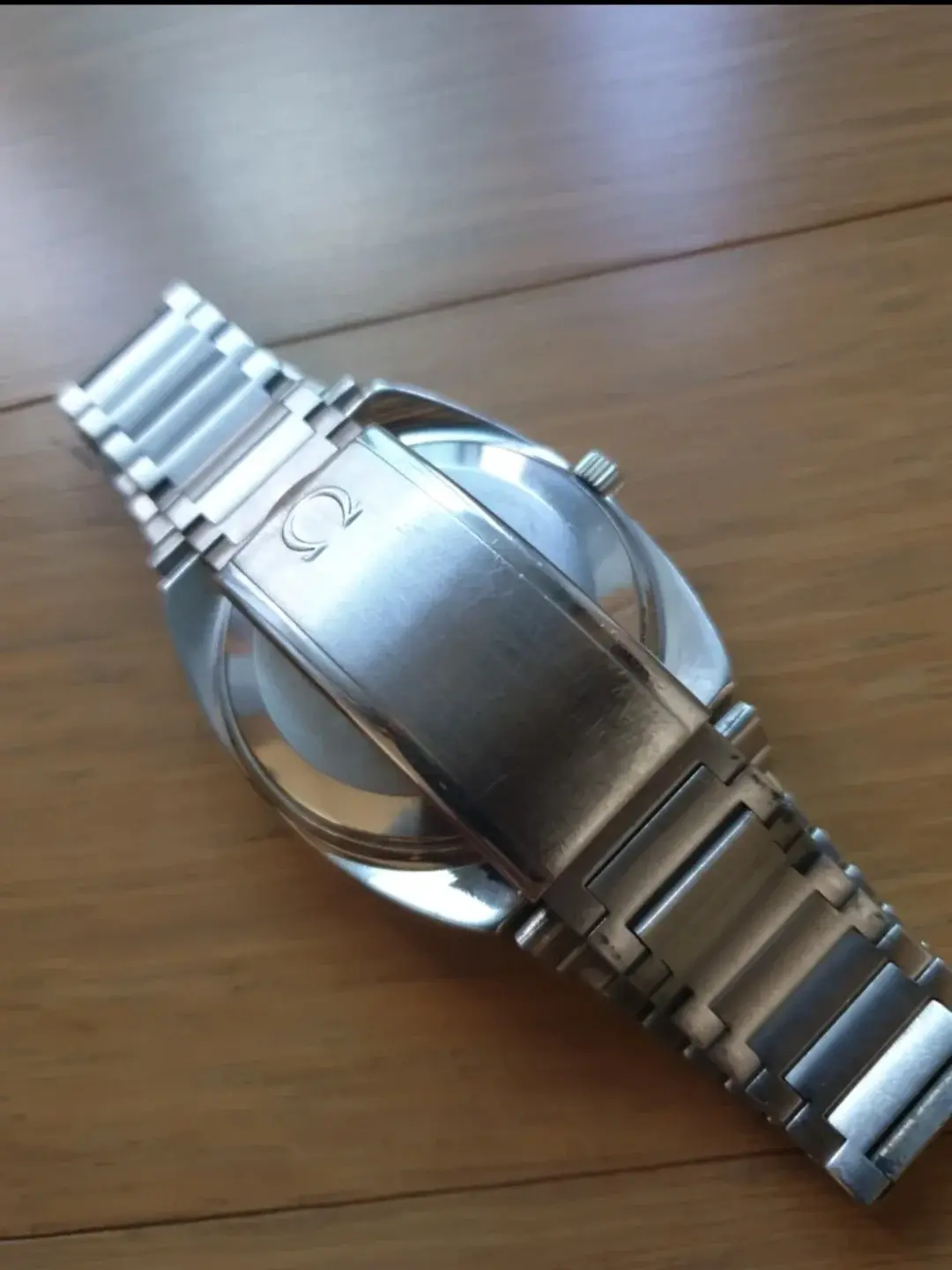

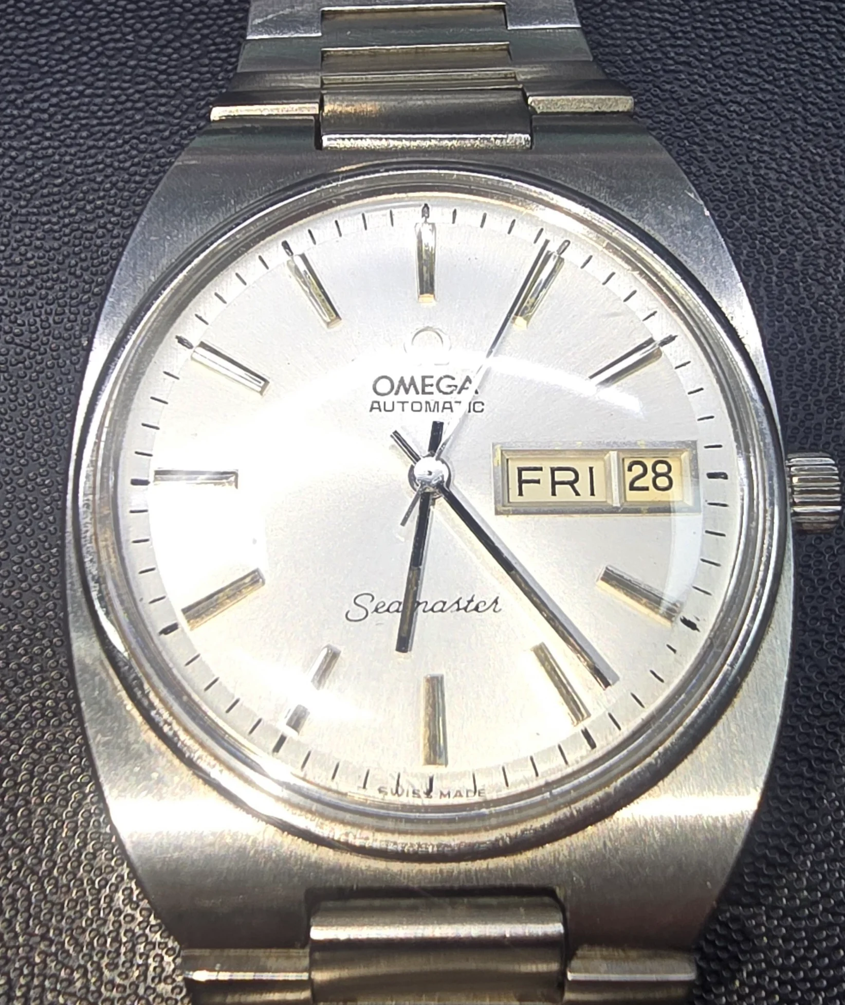

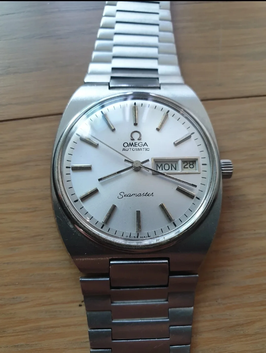

Hello! I'm a newbie to the world of watches, and I recently just purchased a vintage seamaster. Everything else looks and feels legit (movement, band, etc.) but the placement of the word "automatic" on the face is what worries me. I've seen it go under the omega logo above the dial on some versions of the seamaster, but all images of this particular day/date model online are showing that the word goes under the seamaster under the dial.
Please let me know your thoughts! Thank you!

If you google ‘Seamaster 166.0216’ and click on images you’ll see a variety of dials with ‘automatic’ in different positions but, reassuringly, many like yours.
Nice watch and bracelet.

Phew what a relief. Thanks for the reassuring response!

Eh what?

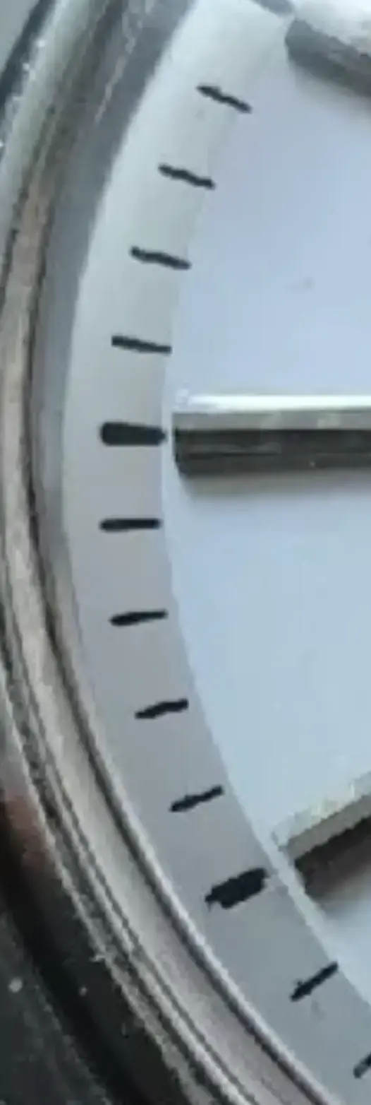

This watch is a lot.. but not nice. Sorry for OP but the dial is badly repainted if not completely fake (look at the minute markers.. you think omega would do it like that?)

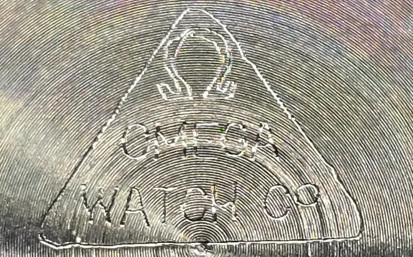

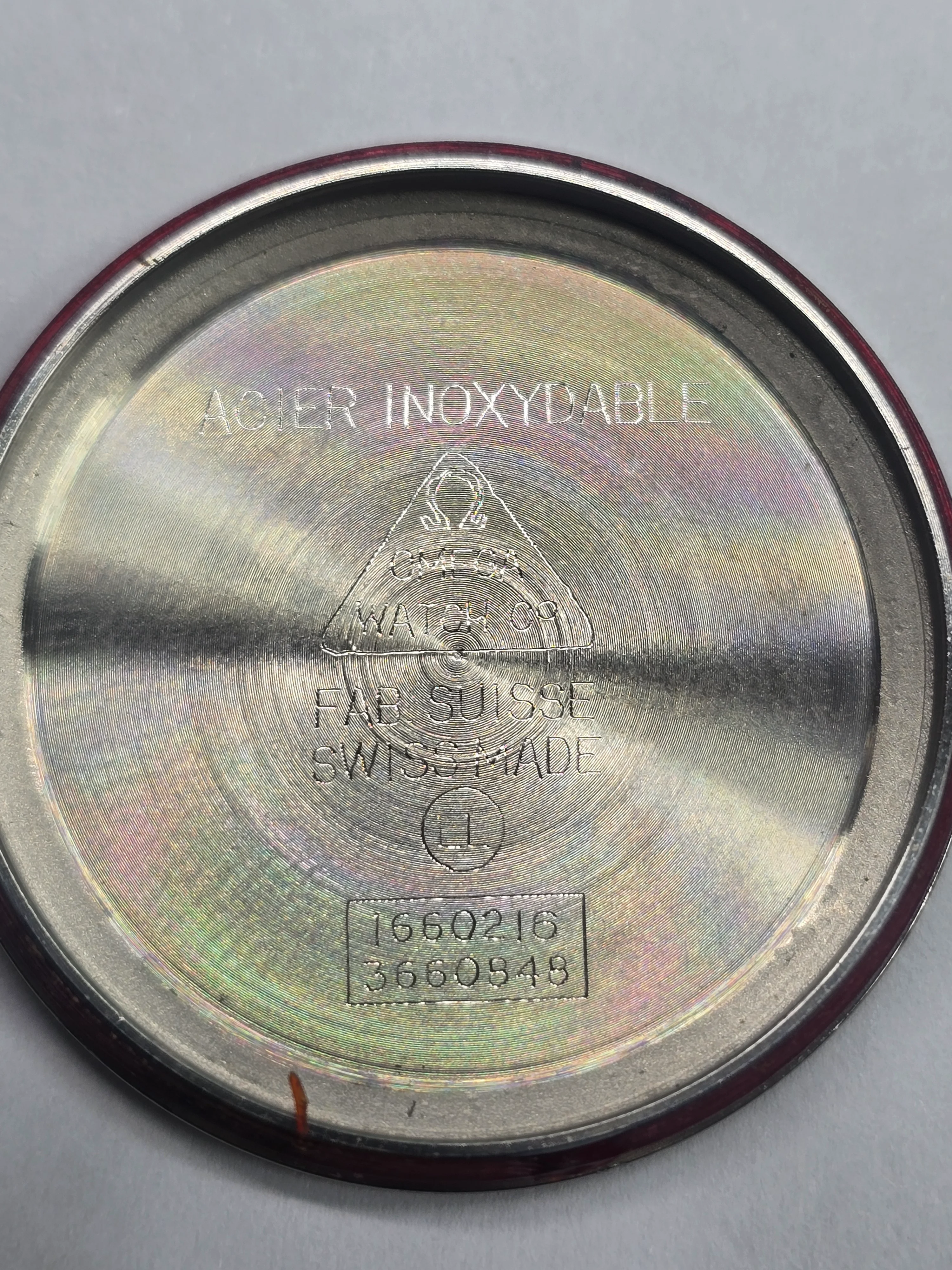

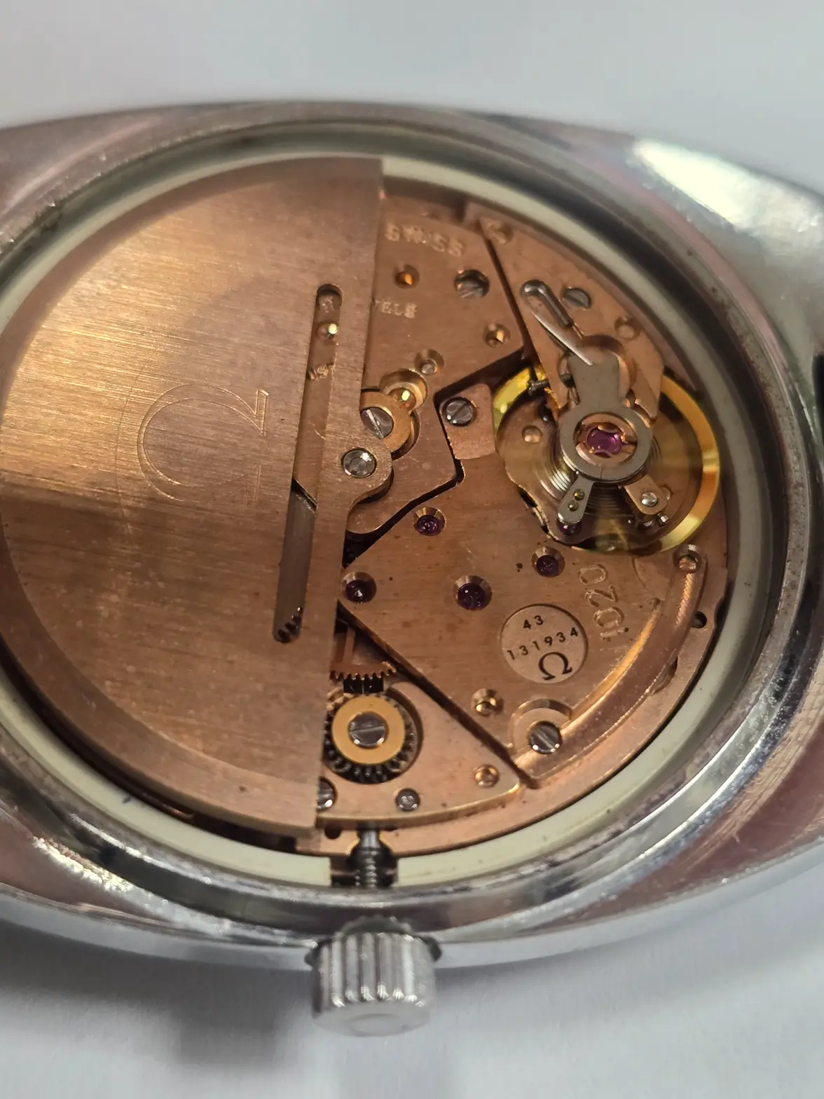

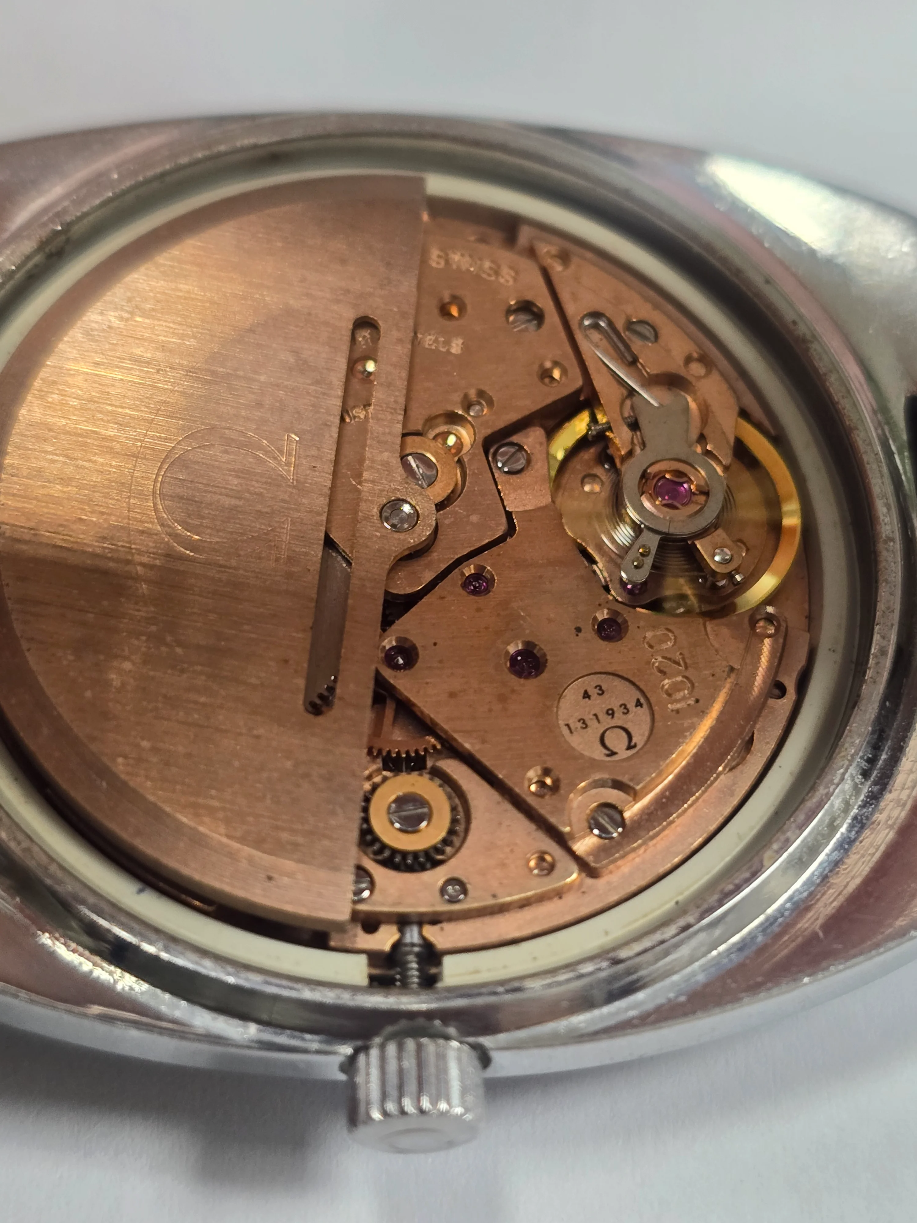

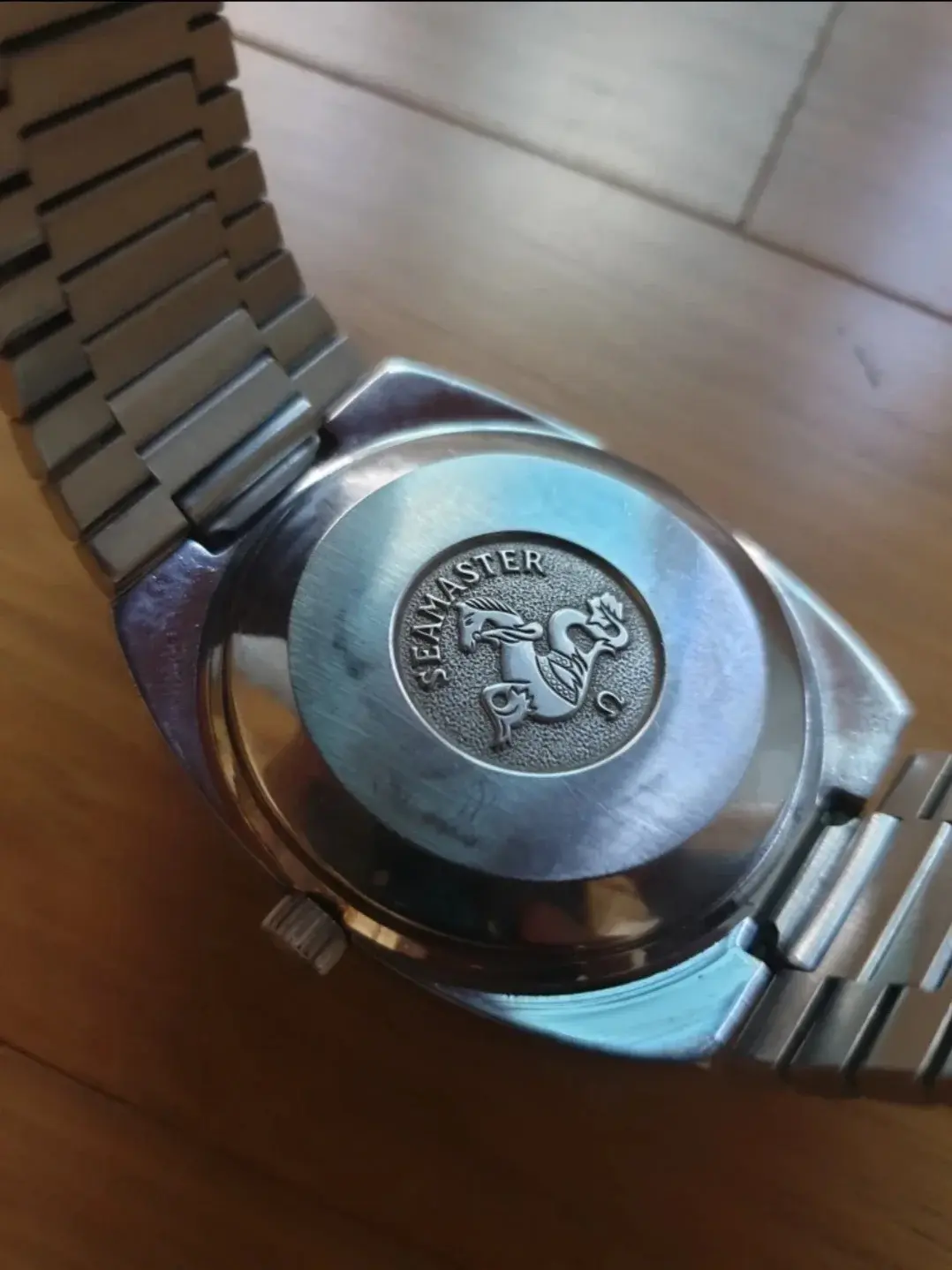

The engraving inside the caseback?? horrific.

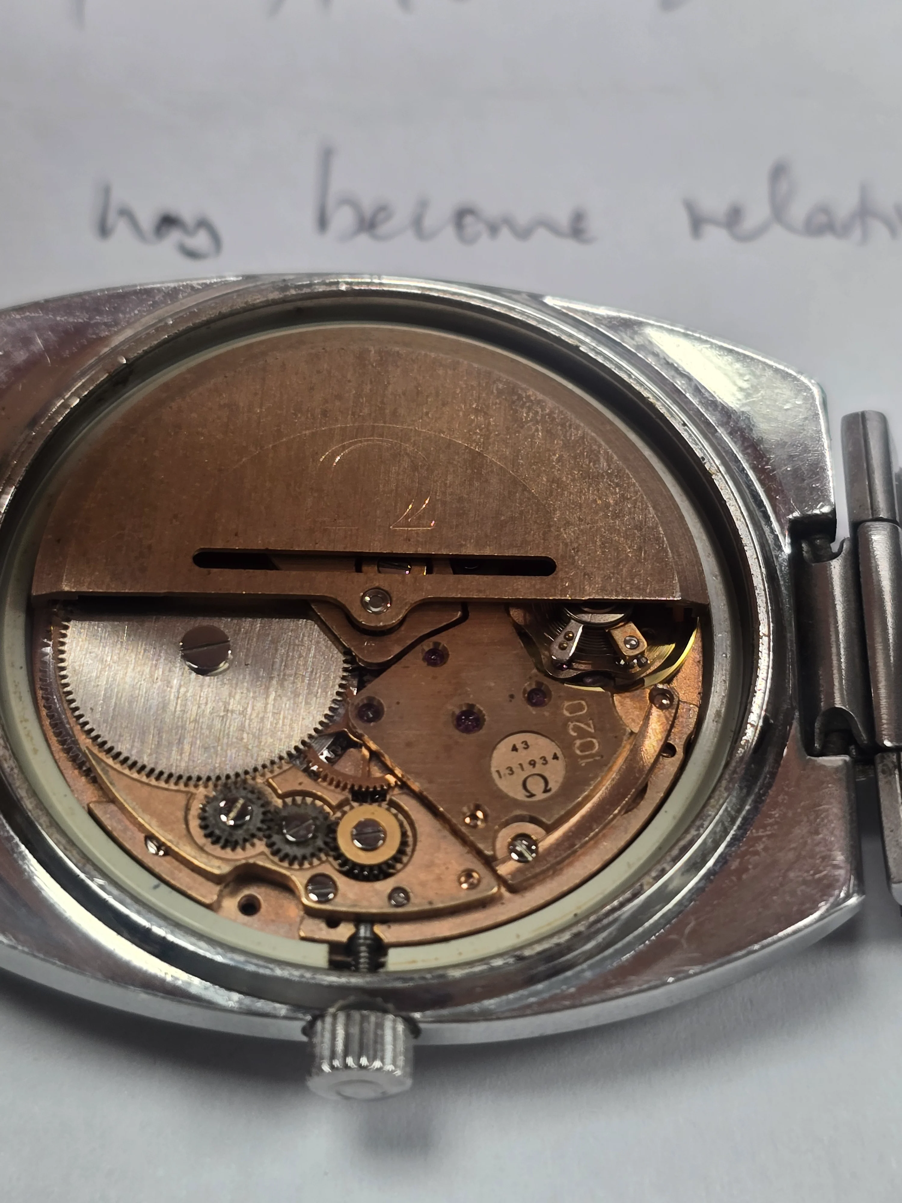

Movement is ok but very dirty.
Case and bracelet could be legit, but the pictures are not good enough to tell for sure..

It all looks genuine to me.
The dial has very obviously been re-painted.
The case was made for Omega by Louis Lang SA, Porrentruy, Switzerland.

Yep definitely real but refinished dial, Cal 1020 is a solid movement when correctly serviced too

That made my alarm bells ring. Looks selfmade.. Can you explain how and why that is genuine Omega?
18,001
37,615
The stylus or bearings on the pantograph engraver were obviously due for repair/replacement.
Couple that with the stylus having to engrave over a badly turned caseback finish and the result is what I'd expect to see.
1970s mass manufacturing was much the same as it had been for a hundred years and these issues you see aren't unusual.

At first glance, the dial does look refinished. But looking closer, I see that particular closeup is heavily pixelated - look at the hands. I wonder if this is just a compression artifact of the image. To the OP, can you upload a better image of the dial for evaluation?

I agree with Don, that dial photo has so much compression artifacts, I'm not sure it is even a watch 😁
First thing I notice though is that the date isn't centered in the window, likely means it is in need of a service pretty desperately (along with the filth that is in the movement).
I'll disagree with Jim on the case back... THAT looks like there was something wrong inside the case back, so they put it on a lathe and turned a little off, then re-traced the 'faint' imprint that they left off. There is more to that than worn out pantograph failure.
Biggest tell to me is the transition between the flat and the sides, but I'd also expect a much large nose radius on the lathe tool than that, so it should result in 'smaller' ridges.

The quick and dirty answer is that Omega made junk between around 1972 and 1982. Things like the dodgy inner caseback logo and crappy movement finishing are to be expected. I suspect the artefacts on the picture are making the dial look worse but IF it is just artefacts, that could well be all original. Seriously, these were the dark days, the company barely survived.
Post a better higher res pic of the dial and I suspect one or two here might be eating their redial words...

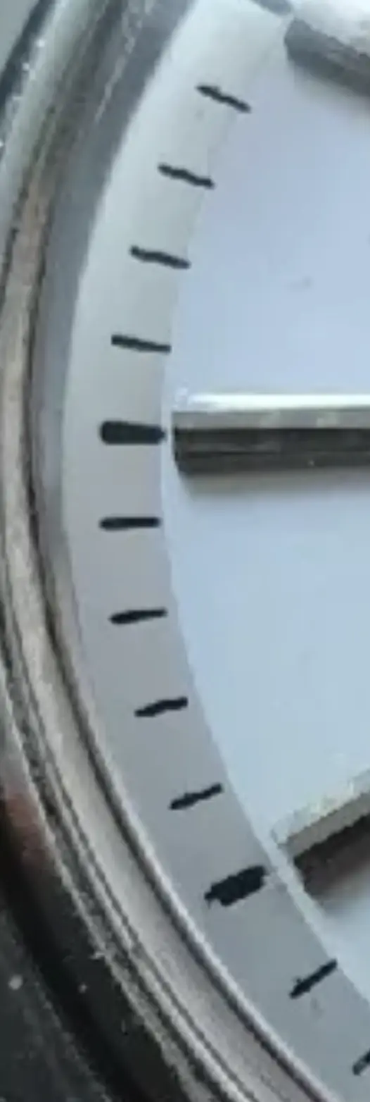

Atrifacts ok, but how are there sometimes spaces in between the minute markers and the inner circle and sometimes not? Or even sometimes reaching over. That is clearly not the compression. And I just do not want to believe that that is Omegas work. I have seen a lot of dials of the 70s and nothing factory of that sort.

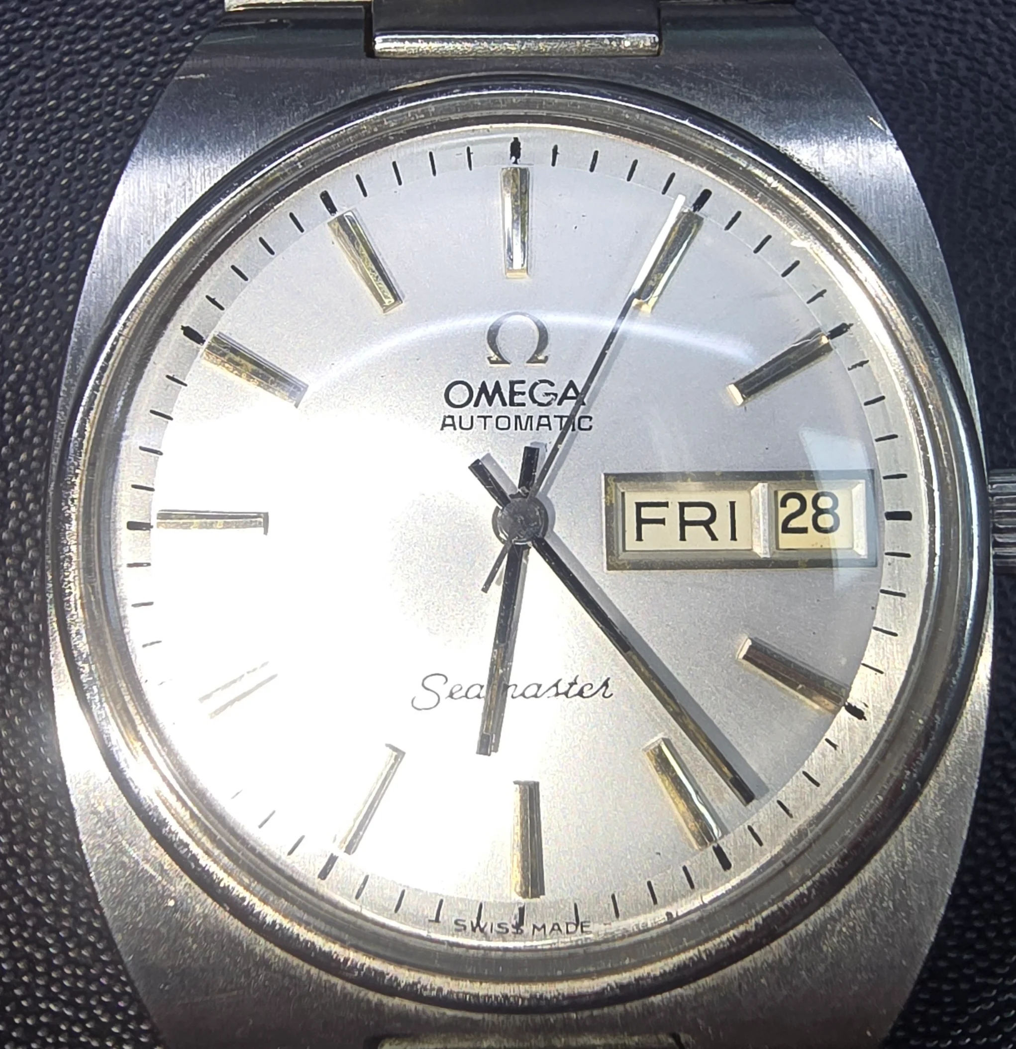

Yessir. Here you go!
24,430
54,346
OK, officially a redial.

Dang. I just looked up what redials are. Looks like this devalues it pretty heavily 🙁 Thanks so much everyone! I learned so many new words today hahaa

I think @lenndon was right, that outer ring is very inconsistent. I was hopeful it was explainable by jpeg artifacts, but this one very much has been redialed for the minute markers.
Interestingly, the center dial looks good to me.

The Automatic writing does not qualify 😁
What?
Isn't the square blocky text a well known Omega font?

The seam
i was just about to say the same.

"Junk" is relative TBH. The 1020/etc series movements are definitely made down to a budget/have reduced finishing/etc, but are still nicer than most movements by other manufacturers. ASchild movements went from lovely to a step above pin-pallet,
What?
Eh? I could swear I've seen that font on good ones before....
