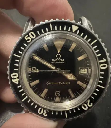

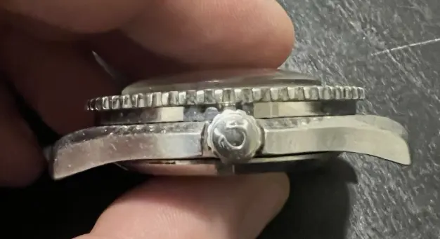

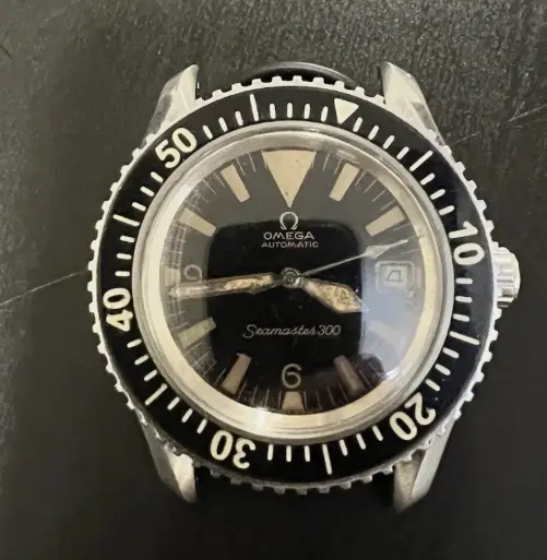

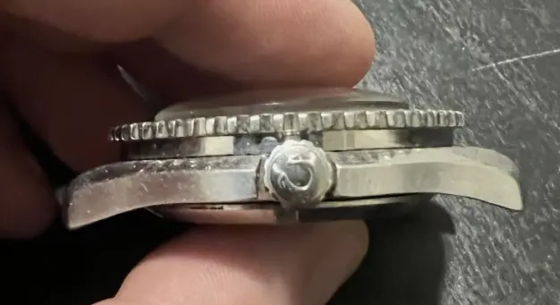

I am pretty sure this is a fake Seamaster 300, at the very least the bezel is completely off. It just sold for $3100 (i am not the buyer and i was not interested in buying it considering the doubts I had). The problems i see are as follows:
  • Case shape looks off
  • Bezel insert seems to be a mix of different years
  • bezel ring teeth are way too pronounced
  • dial does not have the telltale dots at the 12 o'clock and 6 o'clock markers
-Crown is completely wrong
It looks like there is the authentication from Ebay on this watch, I wonder if they will flag it

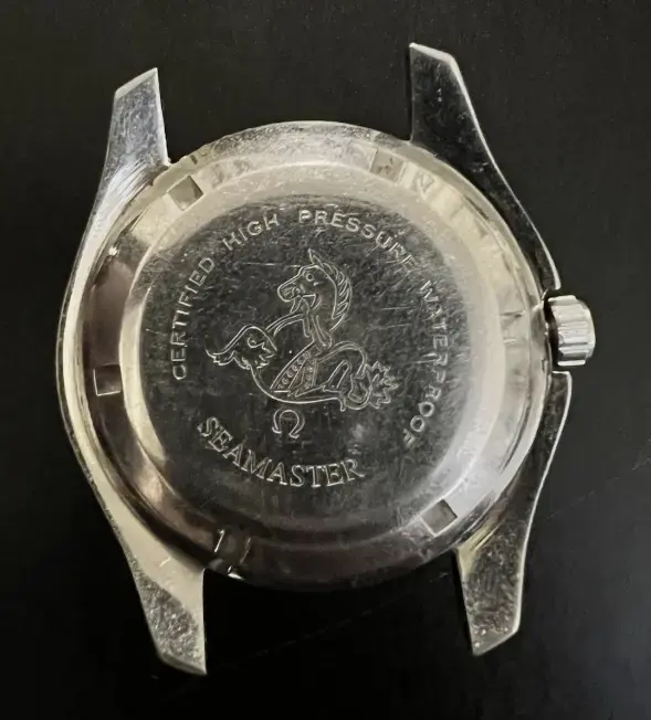

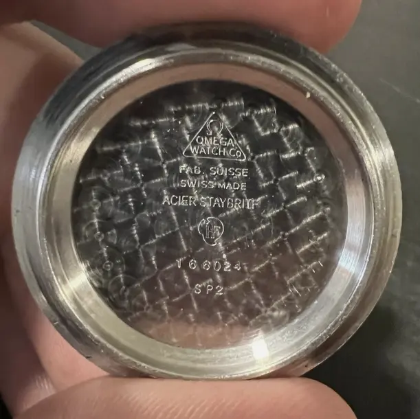

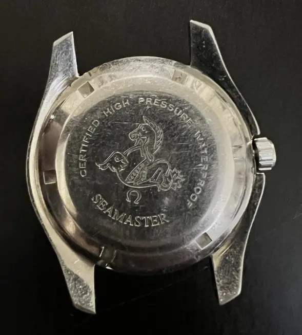

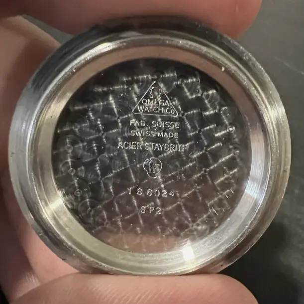

The first thing I always look at the dial of a seamaster 300 is the 6 and 9. This one, has a typical over-serif'd font. I remember the printing on my seamaster 300 is super flat, looks like the ink infiltrates into the dial. But this one, the printing looks too raised. Looked at other parts, all suspicious. Bezel is fake, case back should also be fake, the font inside the caseback does not look good to me. Let alone the incorrect crown and hands...

It is fake, but absence of the dots in the luminous are not a sign.

The Original seconds hand should be white. The 6 and 9 should be closed i think. Its really sad to see that such fakes sell for that money.
The 6 and 9 should be open. It’s the older fakes that had closed 6’s and 9’s.
I agree based on my experience in buying/selling several 300's.

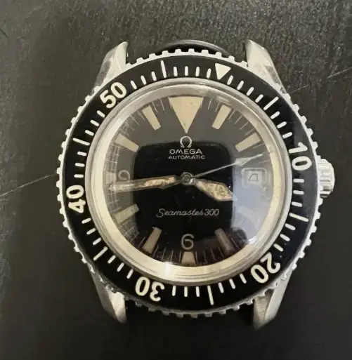

I have a 165.024 sm300 coming with what I suspect is a refinished dial and poorly relumed hands. Curious to see what they do.
