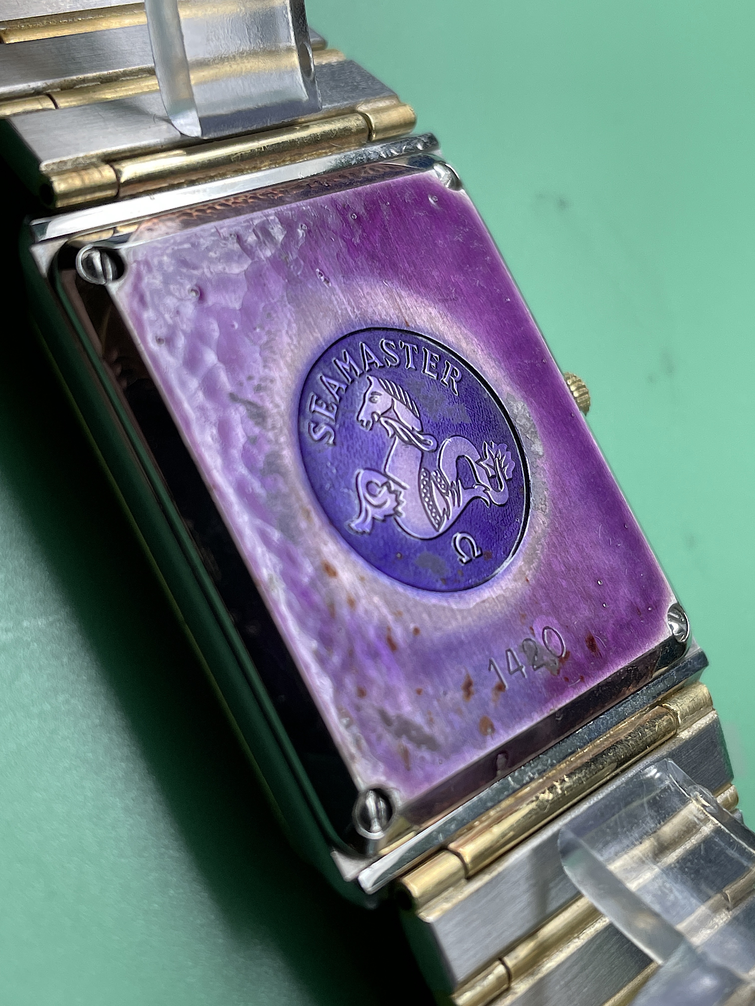

I have been eyeing a cal. 1020 for a while now and have stumbled across one that I might be intersted in.
However, there has been one thing holding me back from pulling the trigger and that is this weird coloration on the caseback.
Is this something Omega did back in the day or did the previous owner do this for some odd reason or is the caseback just a weird fake?
Also, is there a waterproofness rating on this guy? I know in general you shouldn't really take your vintage watches to their original depth rating but knowing that with some new seals I can take it safely in the pool or at least wash my hands without having to take it off every time will make me feel more at ease.
Thanks for the help in advance

The blue could be a residue of the protective coating that was used on new watches in that era.
It's easily removed with a soft cloth an alcohol, but sometimes just stays there until worn away by the wrist.
As to water resistance, a quick "dry test" will let you know if the seals are working correctly.
Unless the watch has been properly serviced in the last few years, it's a good chance water resistance is less than optimal.

That protective layer comes in different colours and can be bought at Machining supply stores.

It's not advisable to swim with an old watch, hand washing ok trying to not put it under the stream of water. If you need a watch while swimming get a Seiko diver or some such less than 5 years old.

I think that usualy new watches came with that blue coating..
