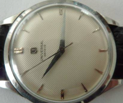

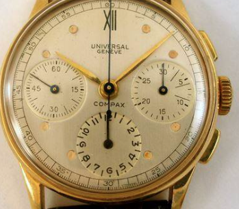

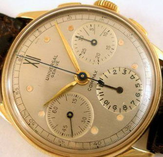

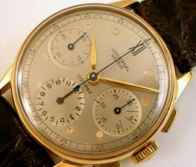

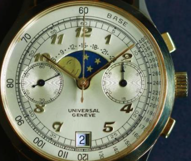

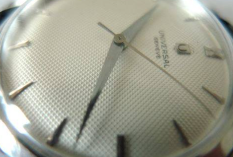

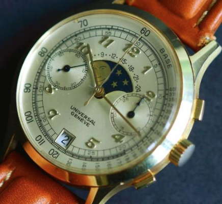

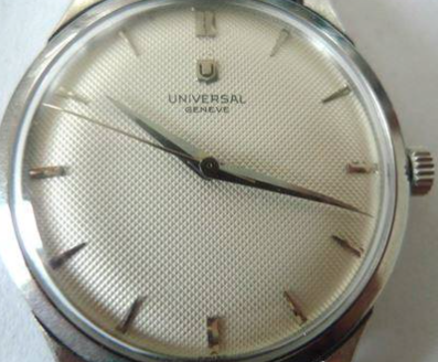

Found three other ones that I would love your time and opinion on. One moon phase, a compax and a waffle dial.
I would really appreciate it if you could point out the problems in the case of redials and not just state it. This way I learn and gradually will become independent.
Thanks for all the help.
Not my pictures and all I have to work with.
Cheers,
J
2,671
24,908
The moon phase is more modern UG, but several other brands were also using the exact same layout and movement. The compax looks like a redial (sub hour clearly too thick, sub minute also thick, wrong minute track and some unalignment) to me and the waffle looks clean nice.
