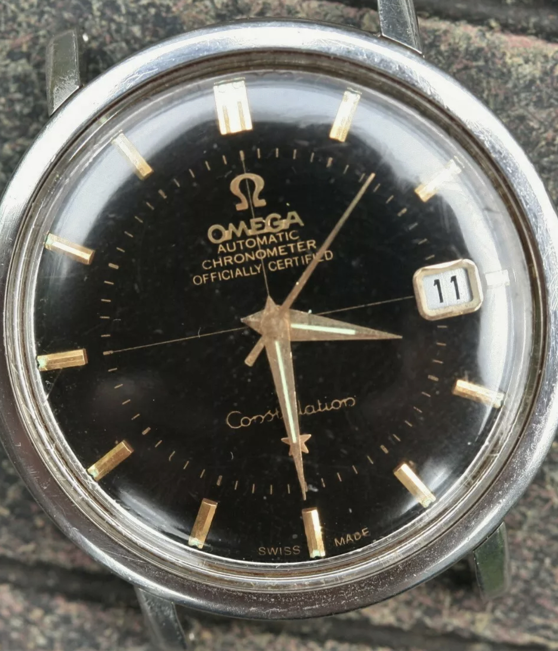

Could I get your thoughts on the dial? Does it look redone to you?
2,346
1,475
In my opinion. Yes
Minute marks to far away from the indexes, so sweep and minute hand look like they're running a shade long
DON
3,595
13,551
Cross lines shouldn’t end at the minute markers, MOY is completely off, font is wrong...
10,123
57,923
All of the above. The vast majority of black dial Constellations out there are redials, so you should approach any possible acquisitions with caution. If you're not experienced, stick with the private sales forum on OF. They do come up from time to time.
9,588
27,706
It’s also a dome dial masquerading as a “pie pan”.
Weirdly, if it's a .004 I guess it could be a real pie pan, only redialed poorly. The straight edges on those are really faint and the minute marks are the best way of quickly determining the shape - on this one the minute marks are placed in a circular shape, but in the wrong place.

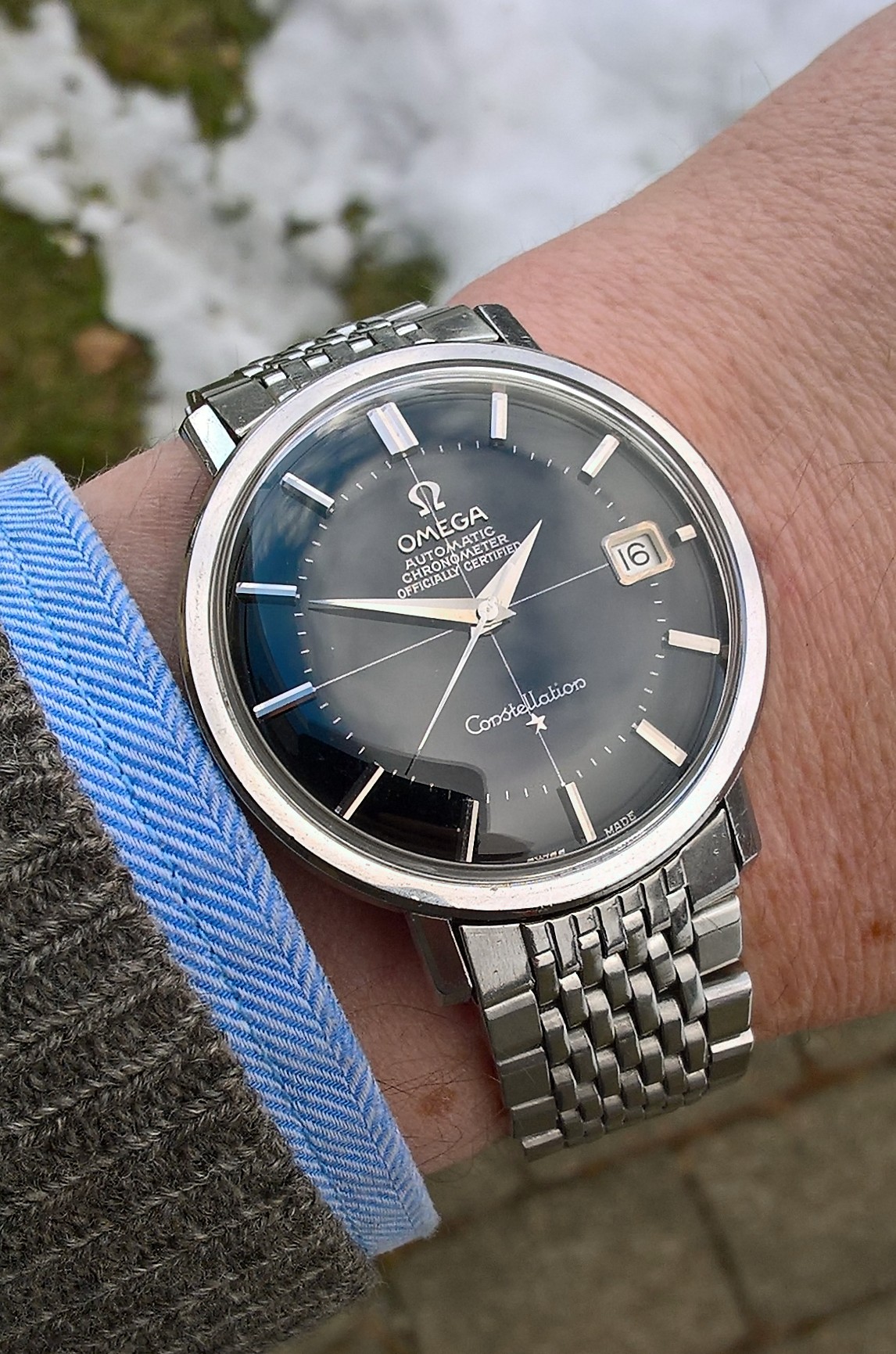

Here's one in the style it mimics:
wp_20180316_16_11_01_pro-jpg.558200

Now THAT is gorgeous.
