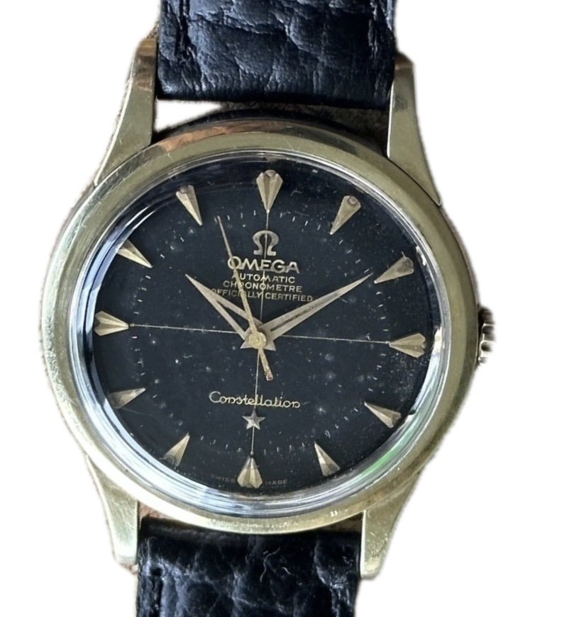

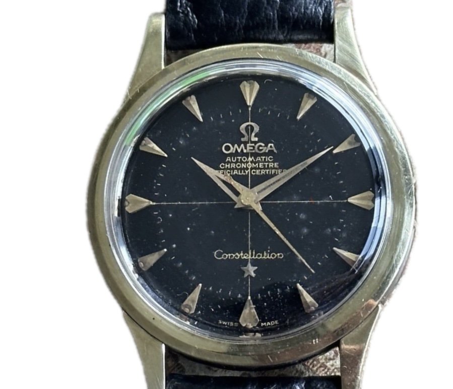

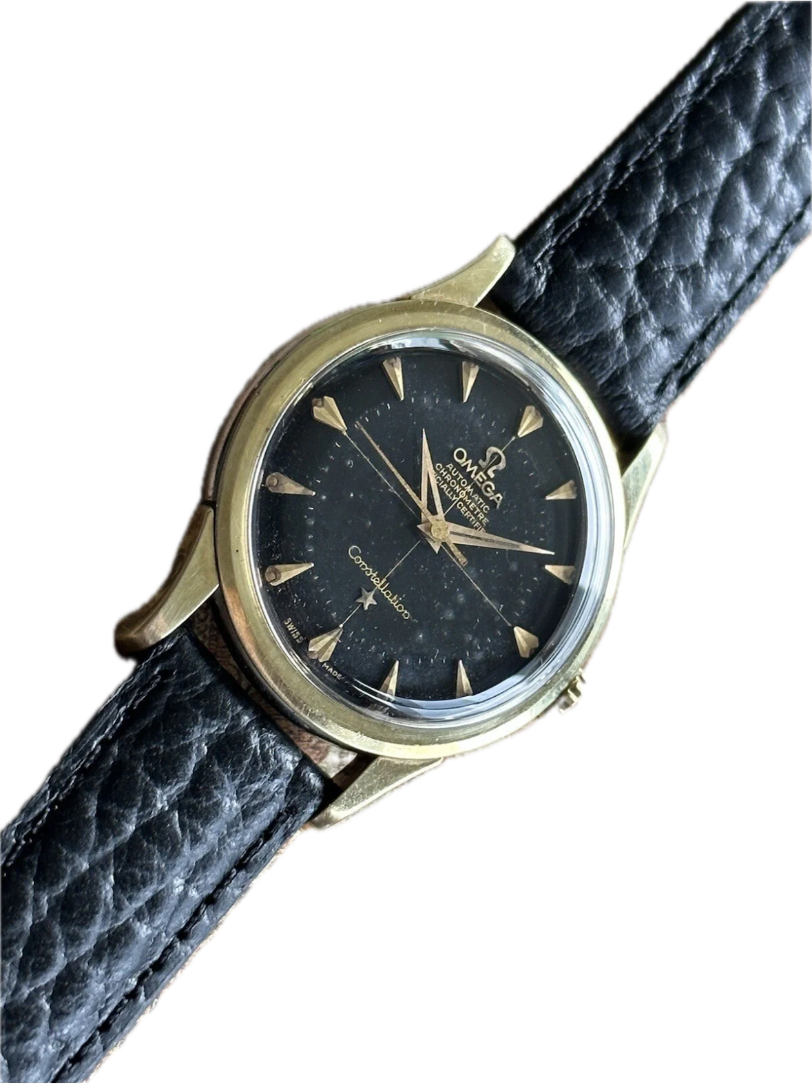

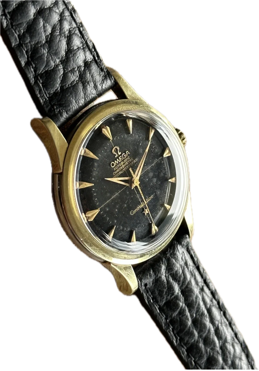

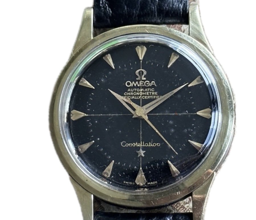

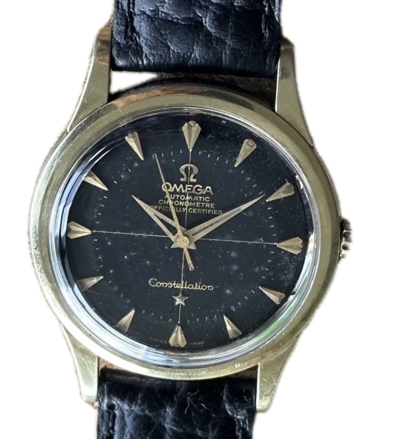

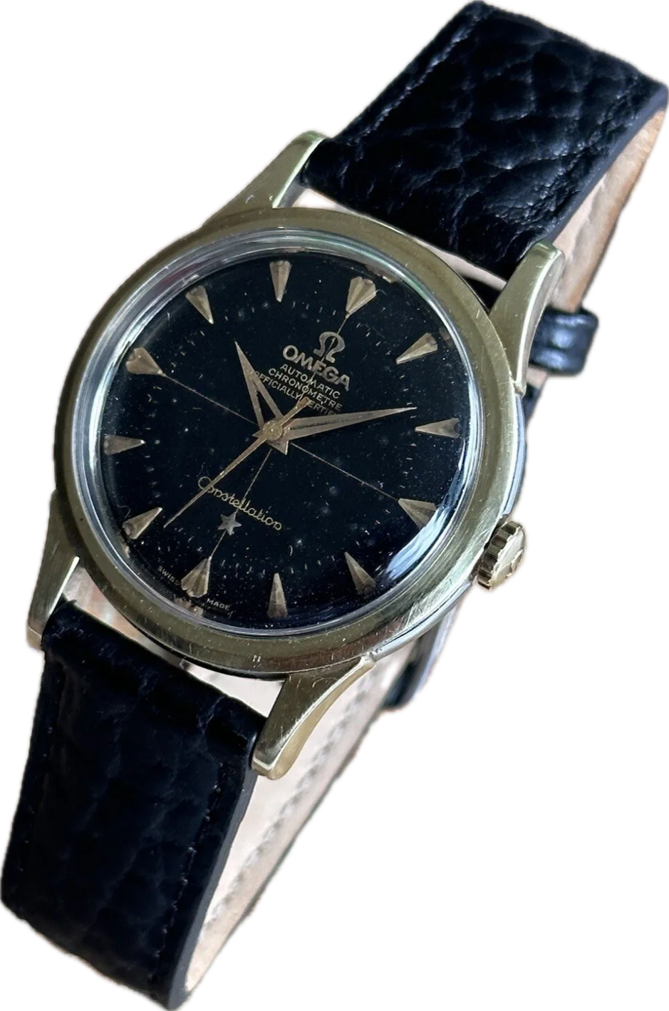

Hi everyone.
I am currently searching for a black dial constellation. I have come across this 2852 reference that seller claims to be all original. It seems the minute and second hands extend slightly past the minute markers. The cutout on the hour hand is triangular. Is this correct? I have seen others with just a straight bar lume. What would be a decent price for this? I appreciate it!
3,620
7,857
Is there a straight on dial photo? Minute markers looks quite irregular to me.
3,620
7,857
Concerned about the hands, and the irregular minute track suggesting redial
See what the experts think
63
30
I appreciate it!
3,578
13,520
It looks like there might be lume missing in the hour hand. Wouldnt put me off necessarily, though.
5,535
9,470
To the experts above, is it normal for the minute ticks to be in a line between the furniture, vs following a curve/ arc?
8,826
62,496
Original to my eyes, and that hour hand is correct for a Factory Lume Pkg
63
30
Thanks everyone! I bought the watch! I’ll post some pictures once I receive it

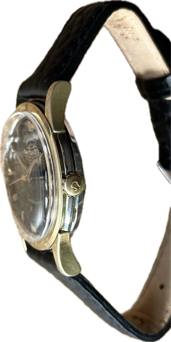

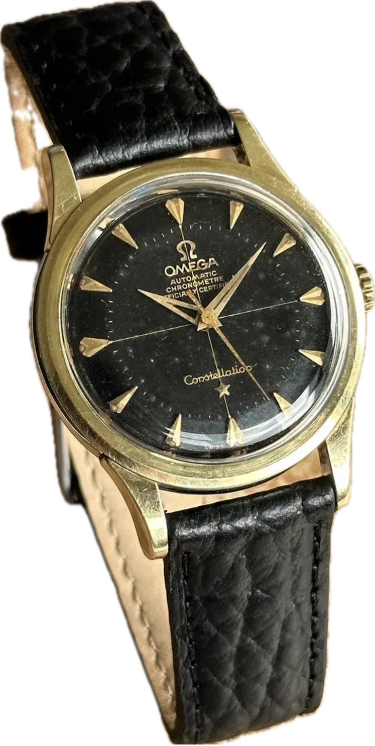

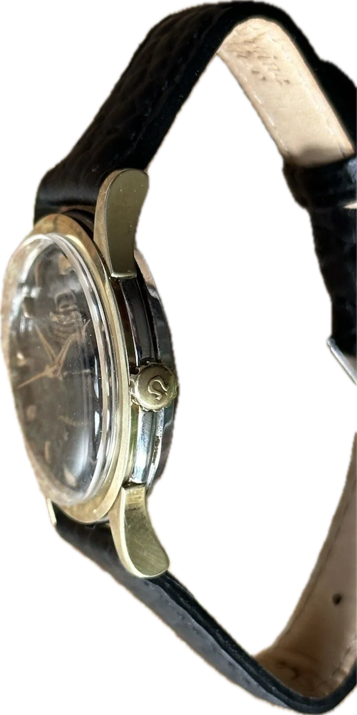

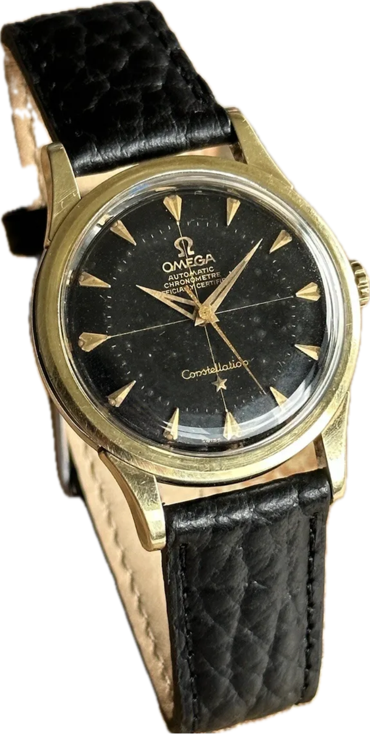

is this a correct crown for this reference? Most I’m seeing having the wide decagonal crown
10,071
57,381
In my experience, the scalloped crown is much harder to find and, in my opinion, the nicer of the two.
6,782
10,439
In my experience, the scalloped crown is in my opinion, the nicer of the two.
