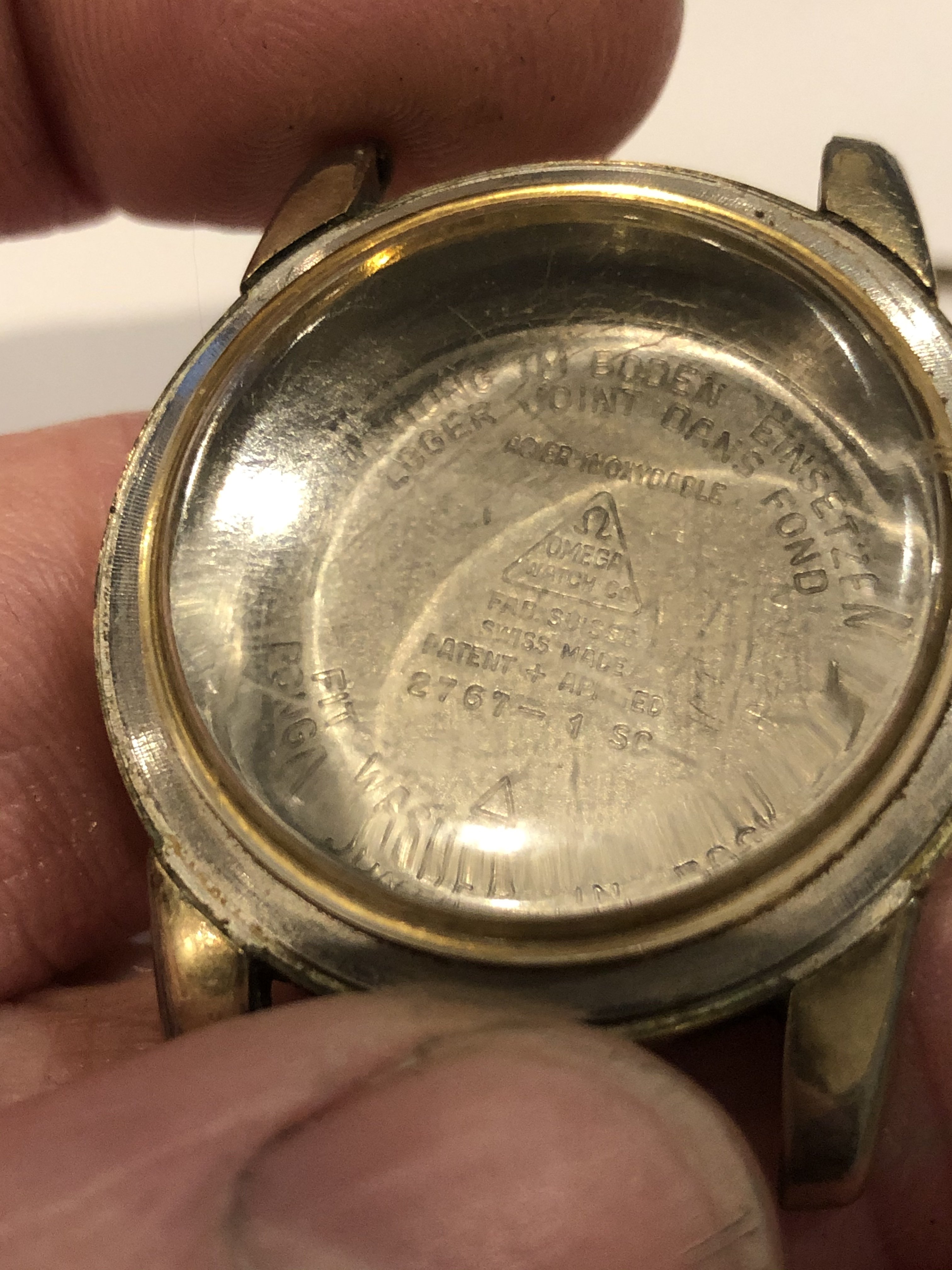

Definitely don't want to use a case knife. The mating surfaces are perfectly tight. I am not sure this will work on an Omega bezel though. I see this used on Rolex bezels or the type of bezel that is placed on top of a case. The omega case almost looks like one piece the joint line is so finely machined. Does anyone know if this tool will work on the case I am talking about? (photo in response to X350 XJR)

Great question. A friend purchased a watch without the top piece of the case - its a 2577 case. He is looking for spare cases to scavenge the top piece off. I am calling it a bezel - not sure if that is the correct term. This photo (of someone else's watch) shows what the case should look like with the upper portion in place. You can see the thin tight joint line. Would this tool mentioned above work to separate the two pieces?

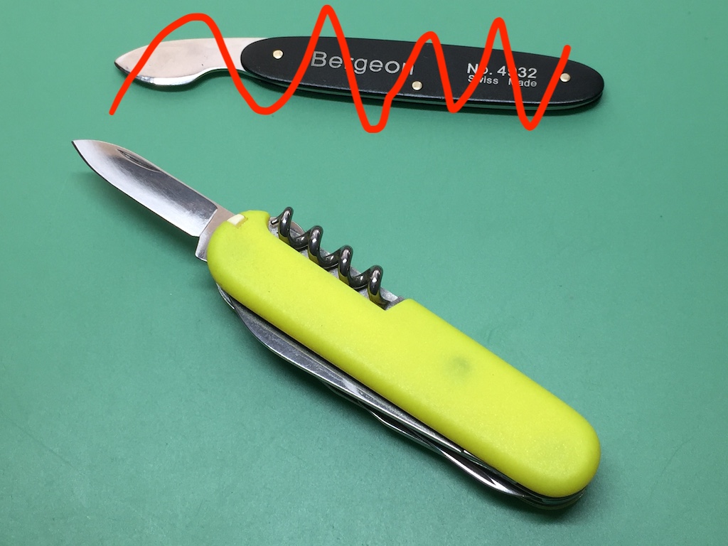

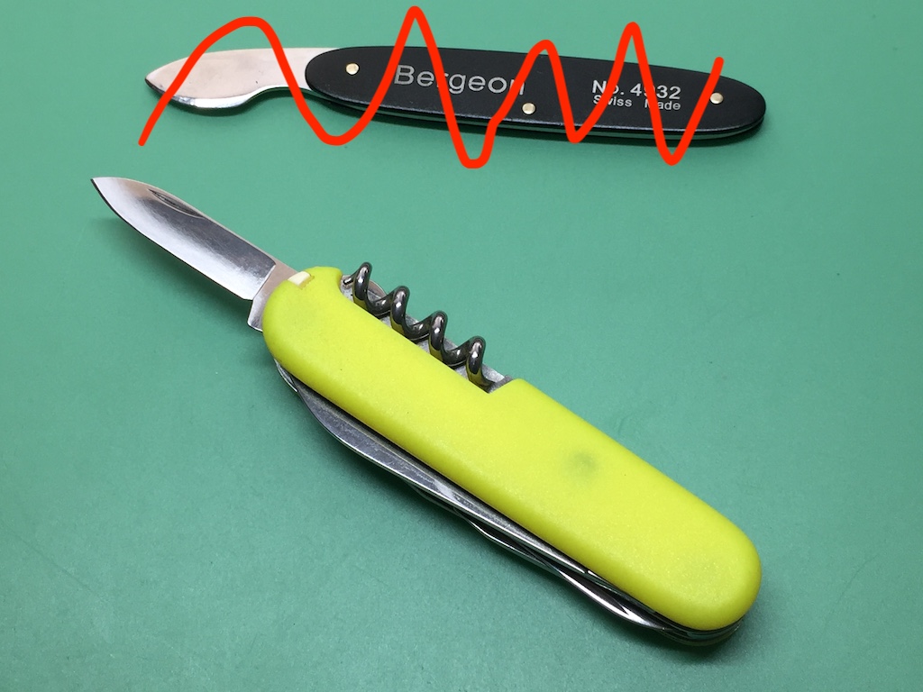

Eggzakly.
Just use it to get the edge of the blade into the seam and then slowly go around the seam with a light rocking motion.
Remember, use it like a wedge, not a lever.
When the seam is opened a bit, follow it up with something like this.
Do the same thing, let the blade do the work by wedging the seam open as you go around the periphery, you shouldn’t need a fat blade case knife.

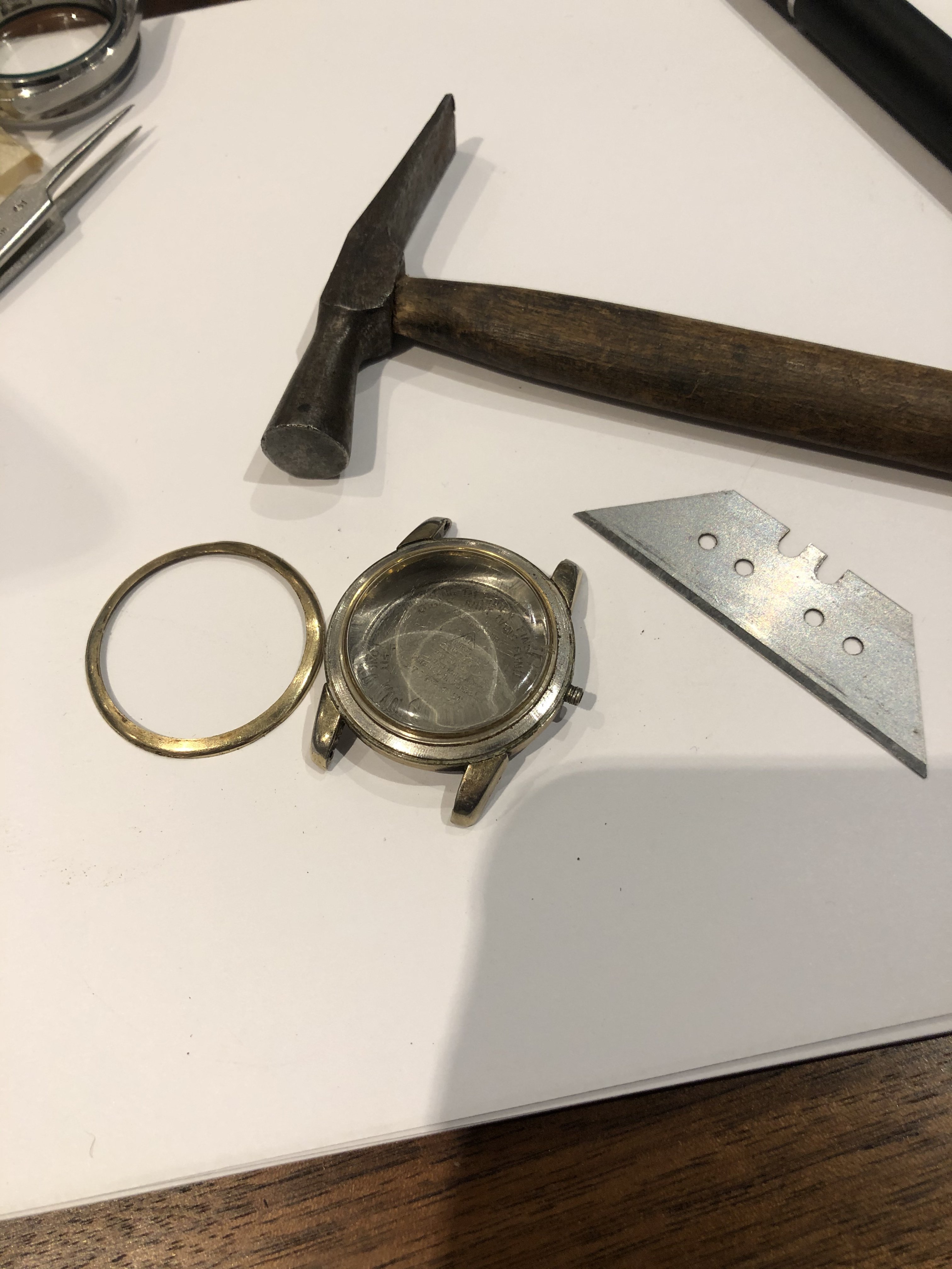

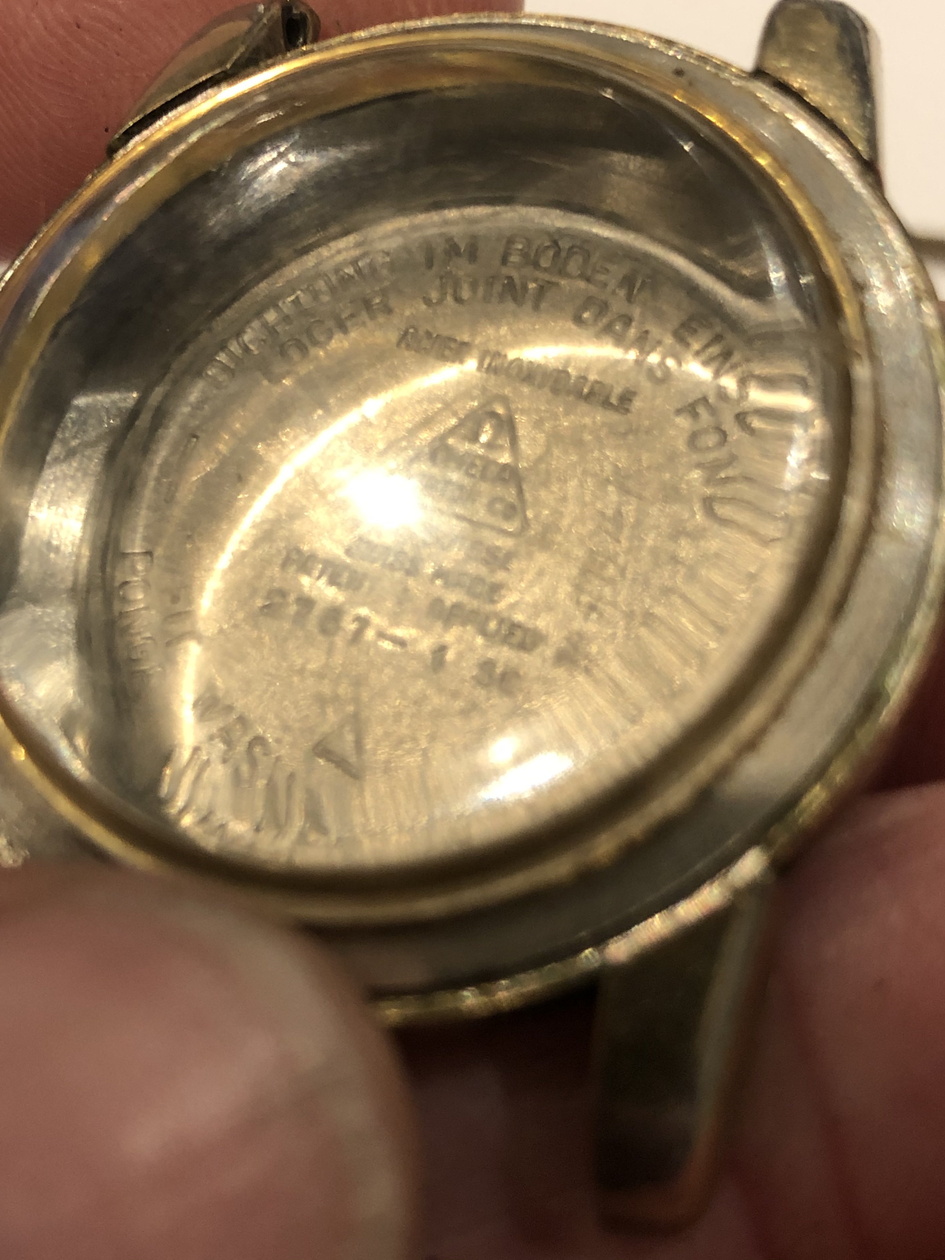

Just looked at an old 2767 case I have.
The gap is tiny on the gold plated version too.
The bezel came off easily once a tiny gap had been created with a Stanley blade. The bezel is very light and flimsy.

If you aren't going to use a tool that opens on all sides at once, then there are some simple rules to follow. This is similar to removing a snap on case back, although bezels can often be on much tighter (which is why a dedicated tool offers advantages).
Any tool you use should act as a wedge, rather than a pry bar, so absolutely no prying. Find whatever blade will fit into the groove, push it straight in, and then work it all around the perimeter. Since the lugs on this are obscuring parts of the bezel gap, you will have to do this on 4 sides. Then find a slightly thicker blade and repeat. Do this over and over until the bezel basically falls off.

Al,
Thanks for the tips. I used the razor blade method and surprisingly, what I expected to be on very tightly just popped off easily. I was able to then compare/measure the bezel on my 2846 against that of the 2577 which is what is needed. As I suspected, the larger width of the 2577 requires a larger bezel. But the 2846 bezel went right back on with a reassuring thud thanks to my crystal press. Thanks again all for the lesson today.
