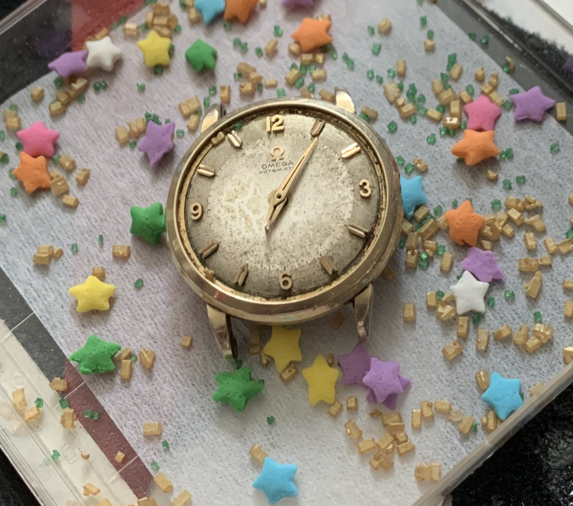

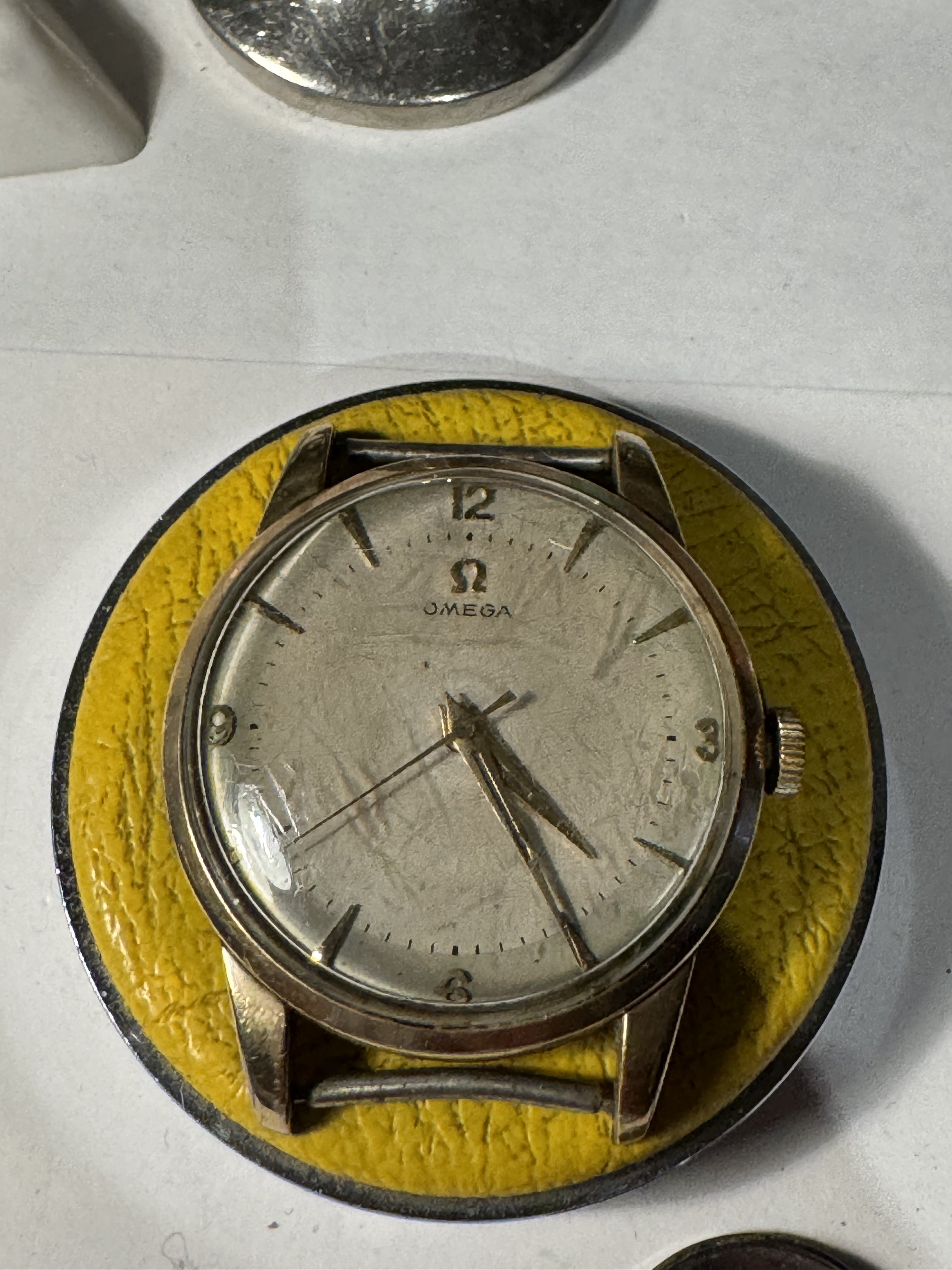

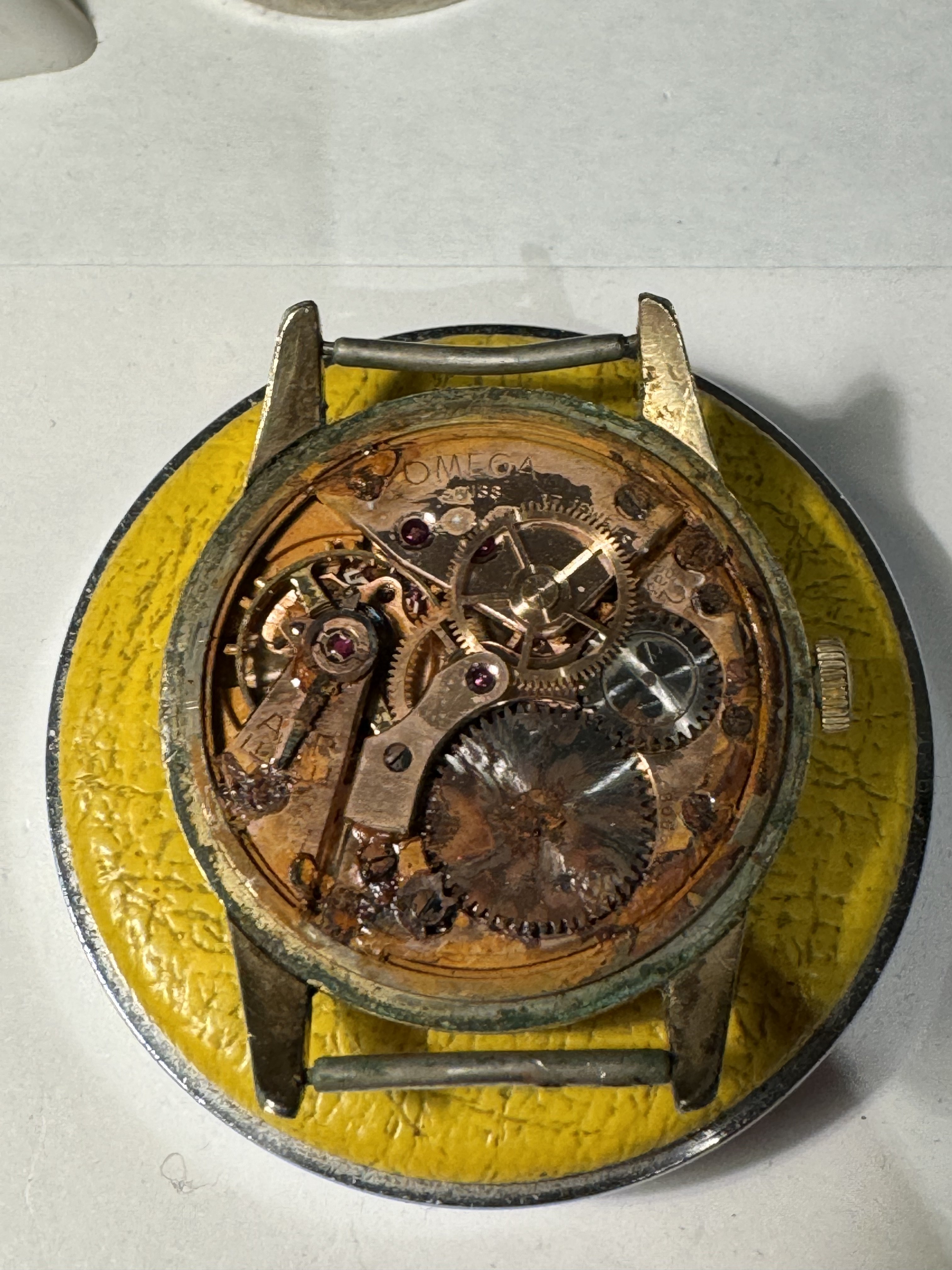

My late father-in-law was a retired watchmaker and left us with numerous old tools and spare parts. Among these, an old Omega caliber 283 housed in a 2498-8 case caught my eye. While I am not a watchmaker, my interest in this field is growing as I delve deeper into it. Unfortunately, the movement is rusty, and I am unable to loosen the screws. My plan is to remove the movement and replace it with a new (used) one from eBay. Both the dial and the case are in good condition. Any help would be greatly appreciated. Best regards from Norway.

I would not use any penetrant or liquid that could wick its way to the dial.
If I was in your position I'd use a dental burr to grind away the case tabs so that the movement could be extracted and replaced with a donor.
Once the movement is out and dial/hands removed it could be harvested for parts if any are still useable.

I’m wondering if the dial is the original paint?
