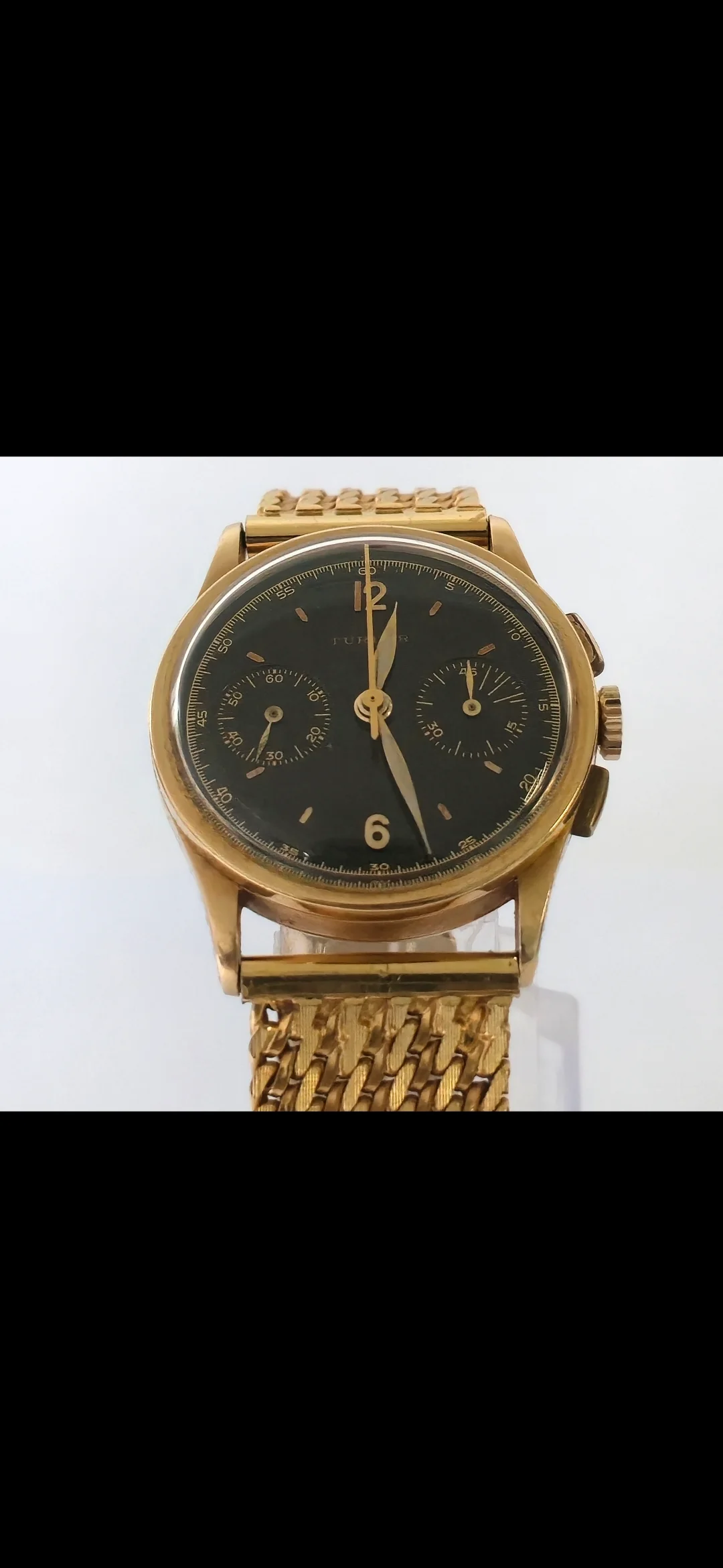

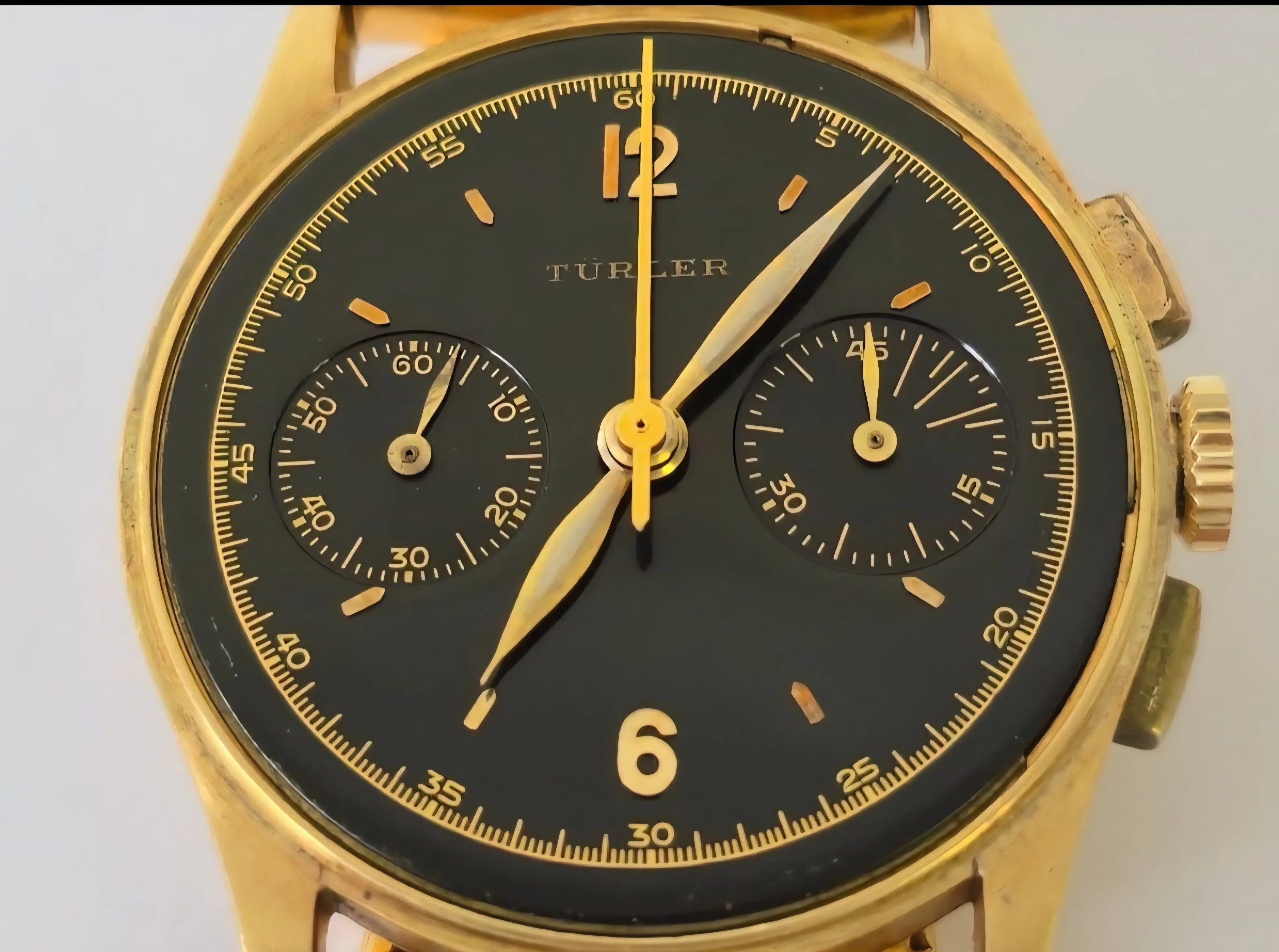

Hi everyone
I wanted to share a recent vintage Universal Genève find with the community and hopefully get some deeper insights from the UG experts here. The case back shows the Universal Genève stamping, perlage, 0.750 gold hallmark, Swiss hallmarks and the Poinçon de Maître key no. 5, which I understand is associated with Georges Croisier, Genève.
The most striking feature is the black gilt dial signed TÜRLER. The case back shows the Universal Genève stamping, perlage, 0.750 gold hallmark, Swiss hallmarks and the Poinçon de Maître key no. 5, which I understand is associated with Georges Croisier, Genève.
I would be very grateful for any expert thoughts on this configuration, especially regarding:
  • the reference 5656
  • the caliber 283 configuration
  • the black gilt TÜRLER dial
  • the Croisier case / key no. 5 hallmark
  • rarity and collector relevance within early Universal Genève chronographs
I am still learning about vintage UG chronographs, so any corrections, observations or additional information would be highly appreciated.
Thank you all in advance.

Dial looks ok from the sole angled pic; the chrono sweep hand probably a replacement..
The reason the chrono sweep hand looks so clean is that it is made of 18k gold.

The ricardo one. Not that rare (without Turler) because made in probably 144 pieces of which 7 known (by me that is). Posted it already here: click

Cool watch, 144 examples made (who knows how many survive) is still pretty rare IMO. But for me the Turler only sign is not a plus, as I would rather have it say UG if I had to pick only one. (The Turler would be fine as a double sig, although double sig is not a big thing for me, so I would not pay a big premium for it). Agreed the chrono sweep is not original. The minute totalizer hand also looks newer than the running seconds. Pushers quite worn, especially lower, or perhaps that one is replaced? Crown replaced. What's the case size?

33mm I think. It is one of these - kind of hybrid - UG's; everything but no UG on the dial. Some '3rd party' UG's have a movement marked with the 3rd party name.
