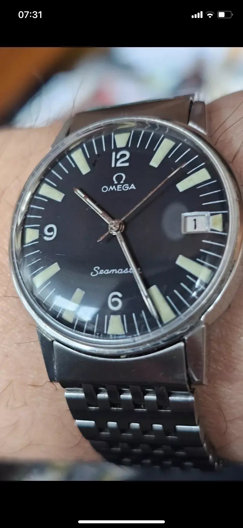

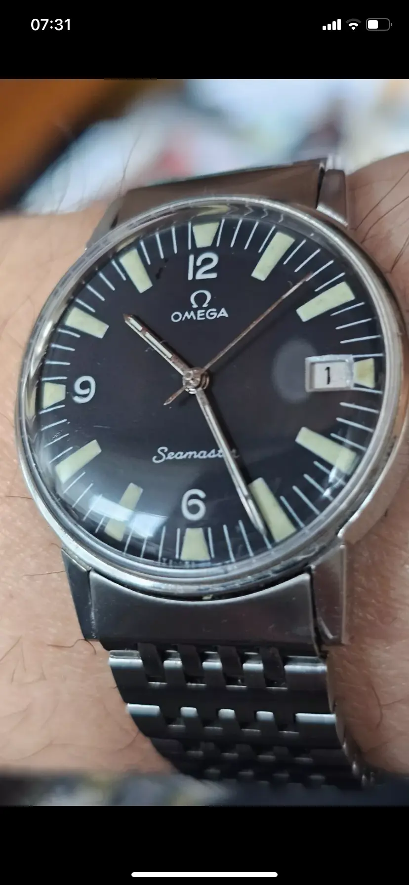

Redialed Seamaster 300 Companion. Dial is redialed/wrong, hands are wrong, case ref is wrong (these only came in no date 165.002).

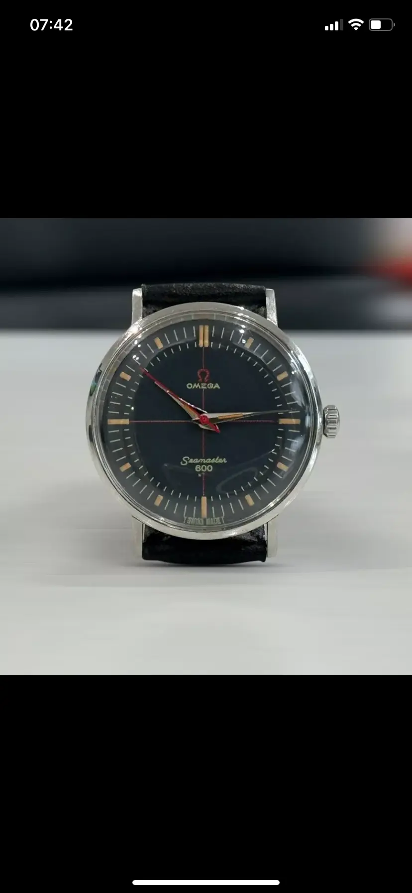

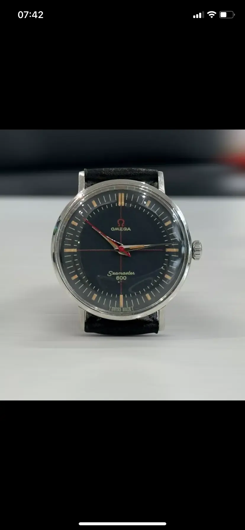

Redialed Seamaster 600 Technic. Dial is wrong/redialed, hands are wrong, case is wrong (should be 135.011).
