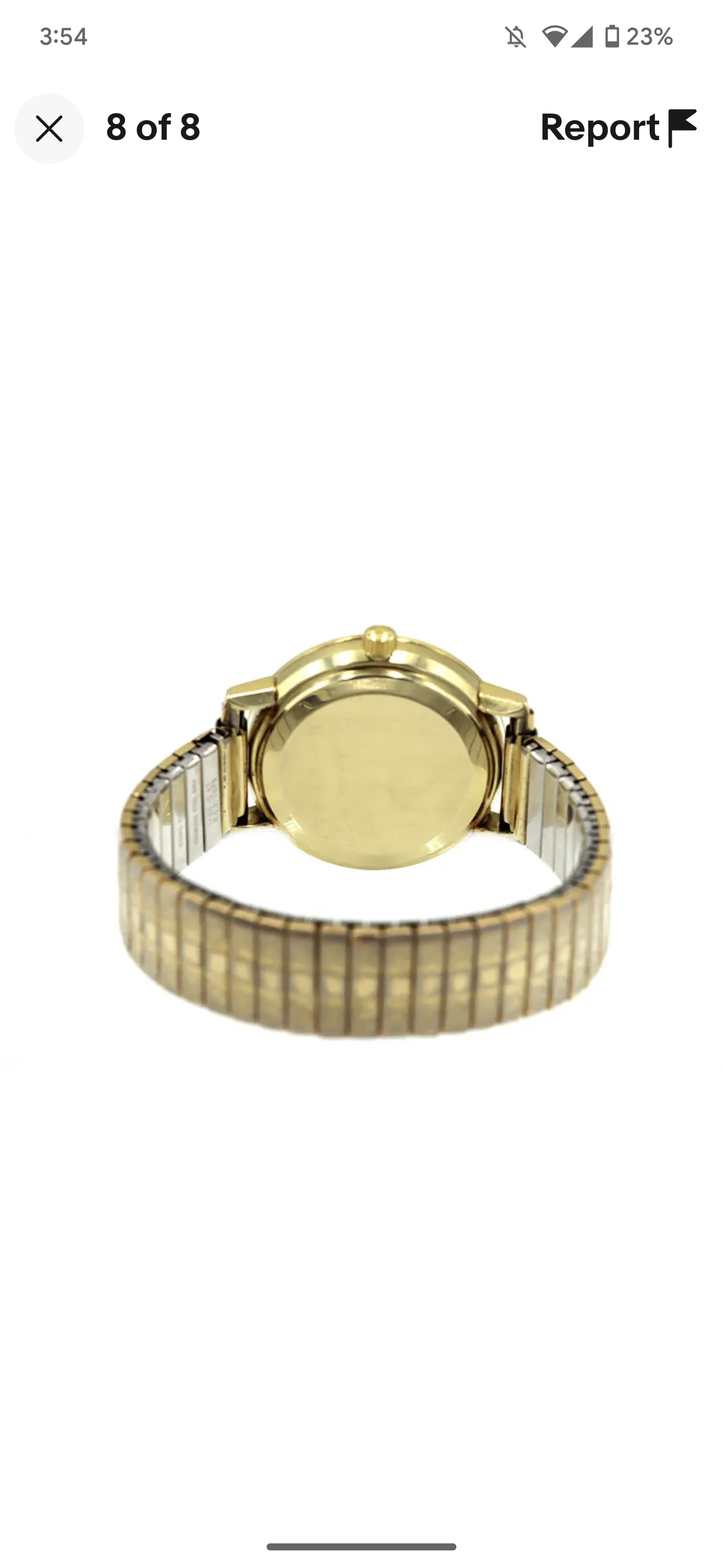

I recently purchased this Omega Seamaster Deville Tiffany n Co. Dial, ref. C6865 ; https://www.ebay.com/itm/1663084566...p5vfbx-qeu&var=&widget_ver=artemis&media=COPY;
I know that the strap is aftermarket, I intend to get a leather strap and a period appropriate buckle. But was wondering if anyone could spot any other issues with it? It's currently undergoing ebay authentication and the seller has provided me with 30 days of free returns if I have any issues upon receiving it. It comes with original box and was recently serviced by an Omega authorized watchmaker in August 2023.
Any guidance would be appreciated!
24,823
55,207
Appears to be a gold filled case with damaged lugs. Worth less than 10% of the silly $3k asking price.
13,491
31,809
Even if perfect these are perhaps $1200-1500 watches. Should be and likely is a 14K case, all of the ones which have passed through my hands over the years were, at least a half-dozen.
That box isn't even from the correct decade (1970s). Basically just crap added to up the perceived value.
If you paid anywhere near the asking priced you got f***ed without lube.
Seller is clueless based on their description anyway.

Yeah i was aware that the watch is from 1974 than anywhere close to 1950.I admit I was not aware of the box not being period appropriate.
What concerns me is that the crown doesn't look super right to me. I also asked about the case being polished to which he assured me that everything apart from the strap was original but do you guys think it's over polished?

That crown is the least of concerns.

So are you saying the crown isn't correct at all?

If you are able to return it and get a refund, run, don't walk.
Please post better photos.

Yes the case has been polished and lost its crispness. That band is worthless junk too.

That was my guess too, was not super sure from the image, especially since the seller kept insisting all parts are original except the band.
I'm waiting on ebay authentication to get back to me but from everyone's advice, I'll most likely be returning this.

@arunavab713 , you would do best to avoid sellers that massively overexposure their photos in order to minimize visibility of the wear.
