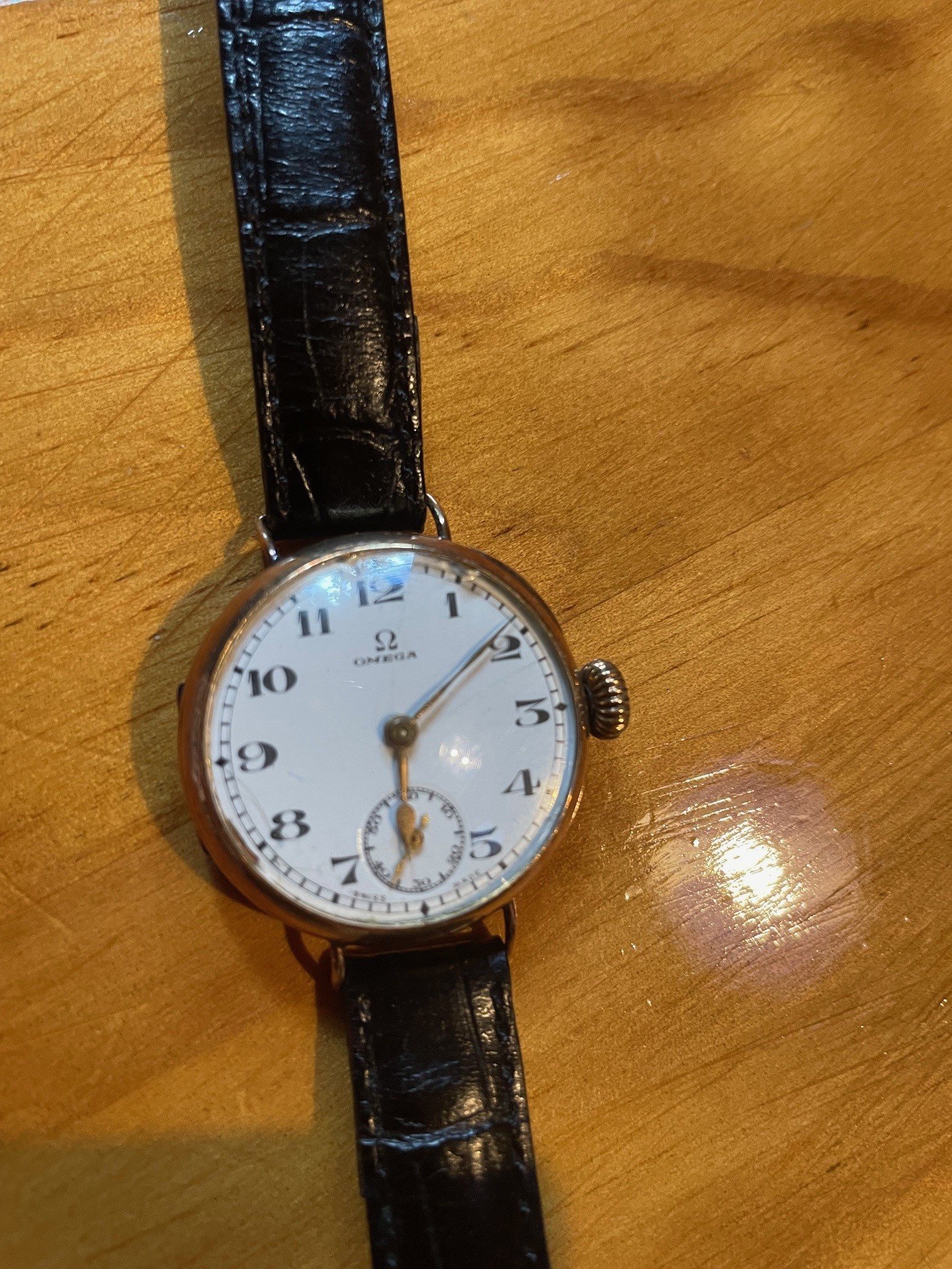

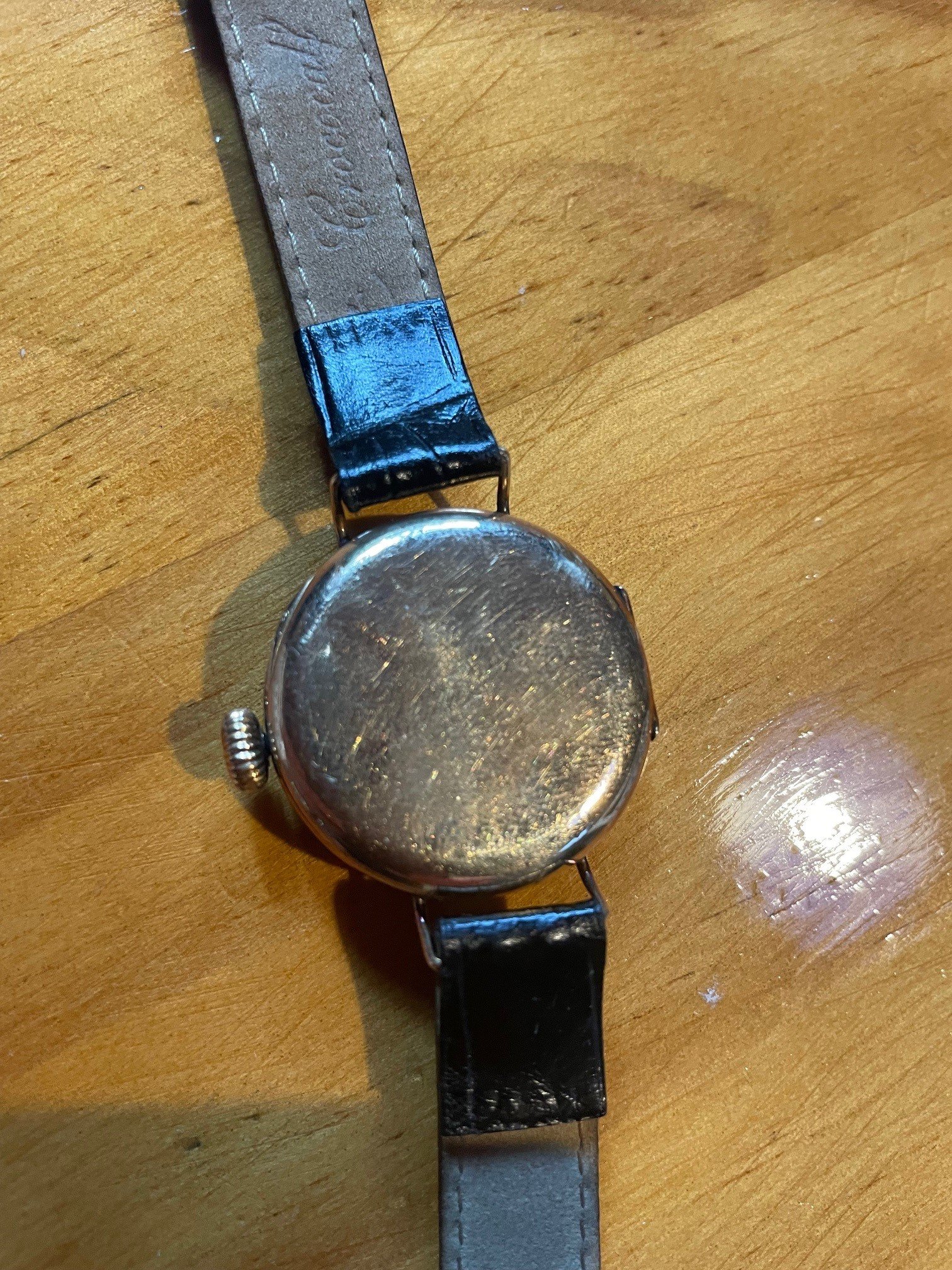

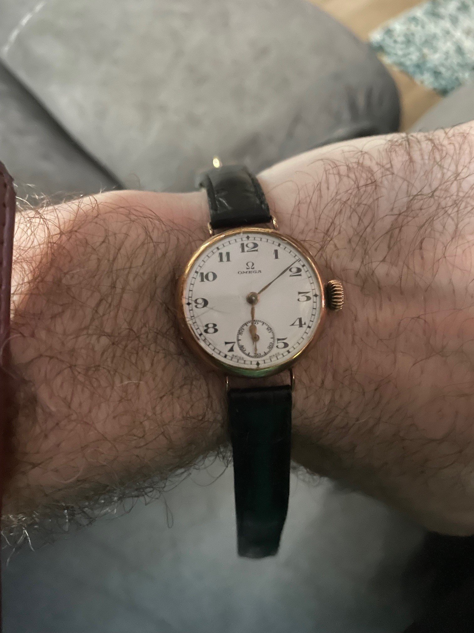

Hi all,

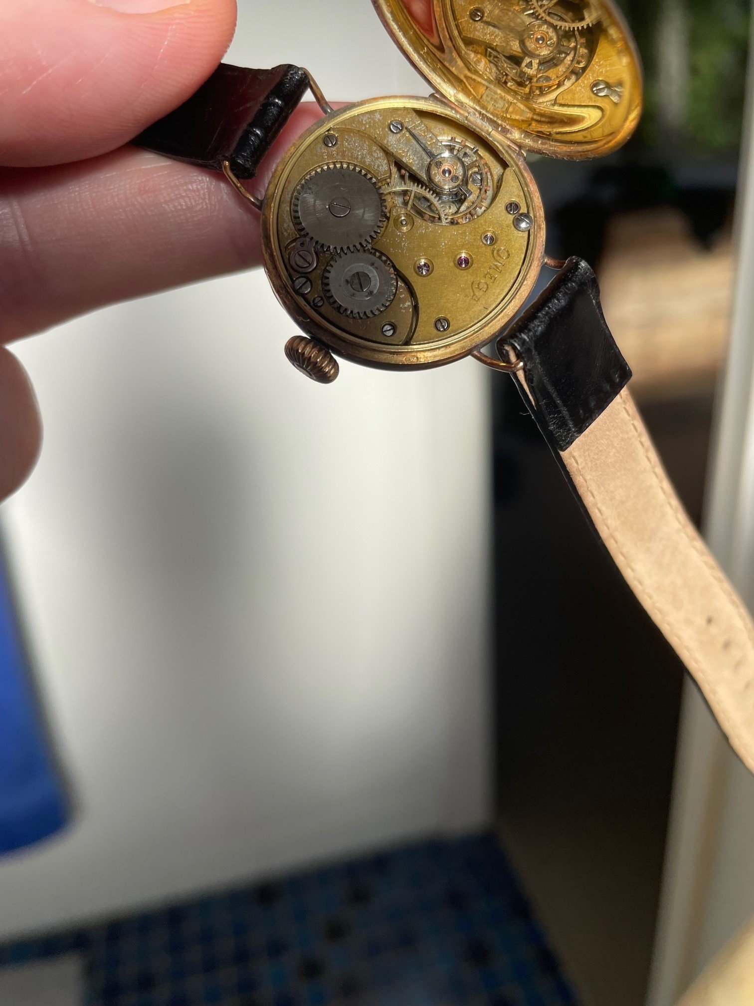

I bought this Omega about 20 years ago and I have lost the documentation that came with it. Seems to have different numbers on the case and movement.
I just wanted to ask if anyone knows the best way to go about finding further details on the watch.
Many thanks in advance!
Cheers,
Ruairi

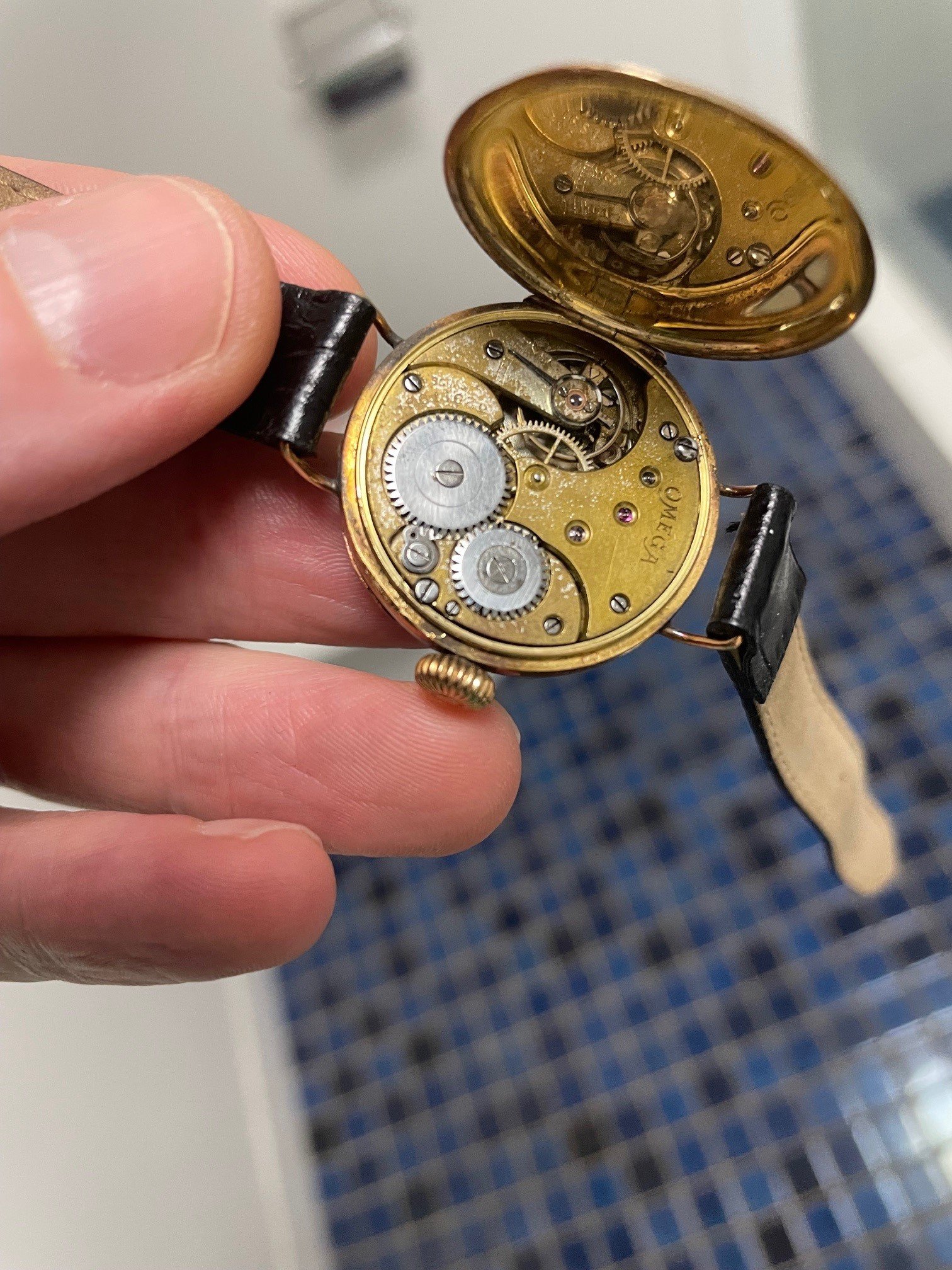

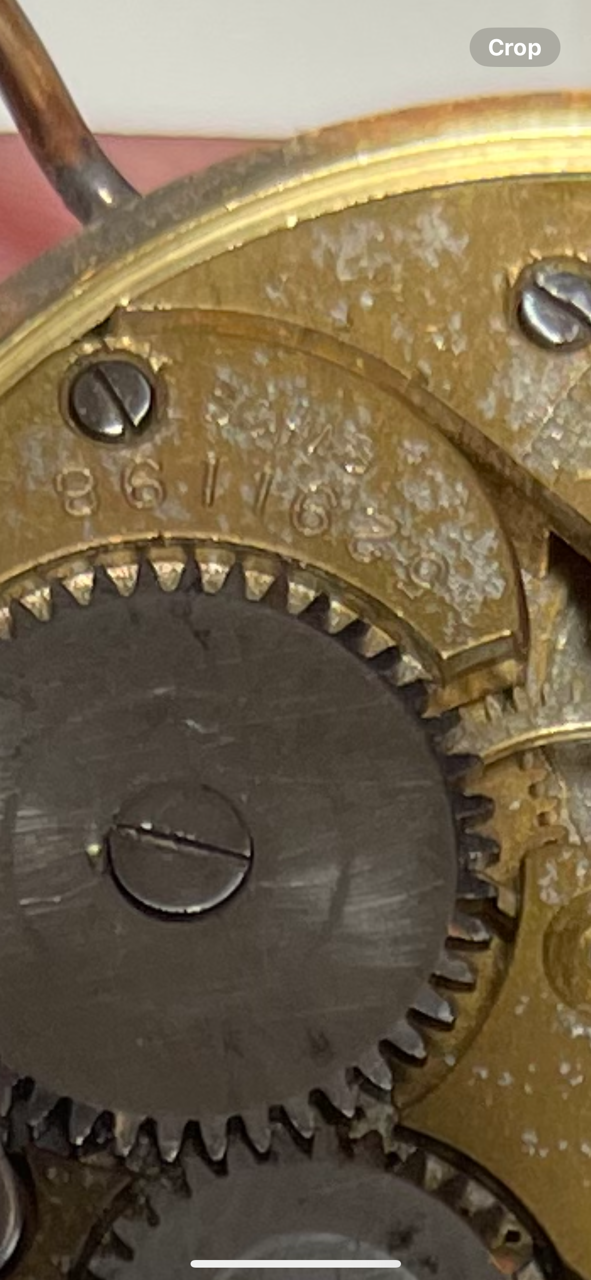

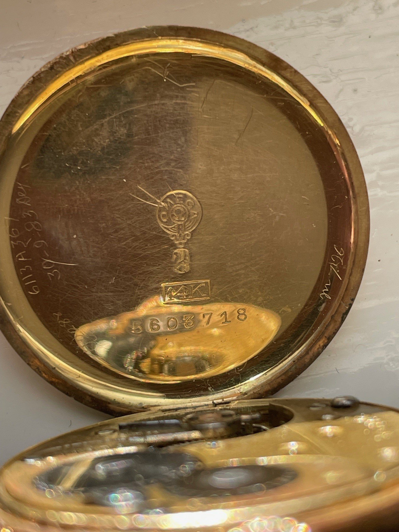

the movement number is 6291198 which looks like 1923 on the chart and the case number is 5603718 which looks like 1913 on the chart.
Or am I missing something obvious ?
2,588
3,883
I believe the movement number begins with a 5, which puts the movement # and case# very close as far as time period.
1,087
1,850
Thanks Pvt, My eyes are definitely failing now !! 5291198 puts it 1915/16.
3,678
8,008
I thought the same, until I realized i was trying to read the number upside down.....
1,325
1,872
You are reading the movement number upside down - its 529xxxxx
