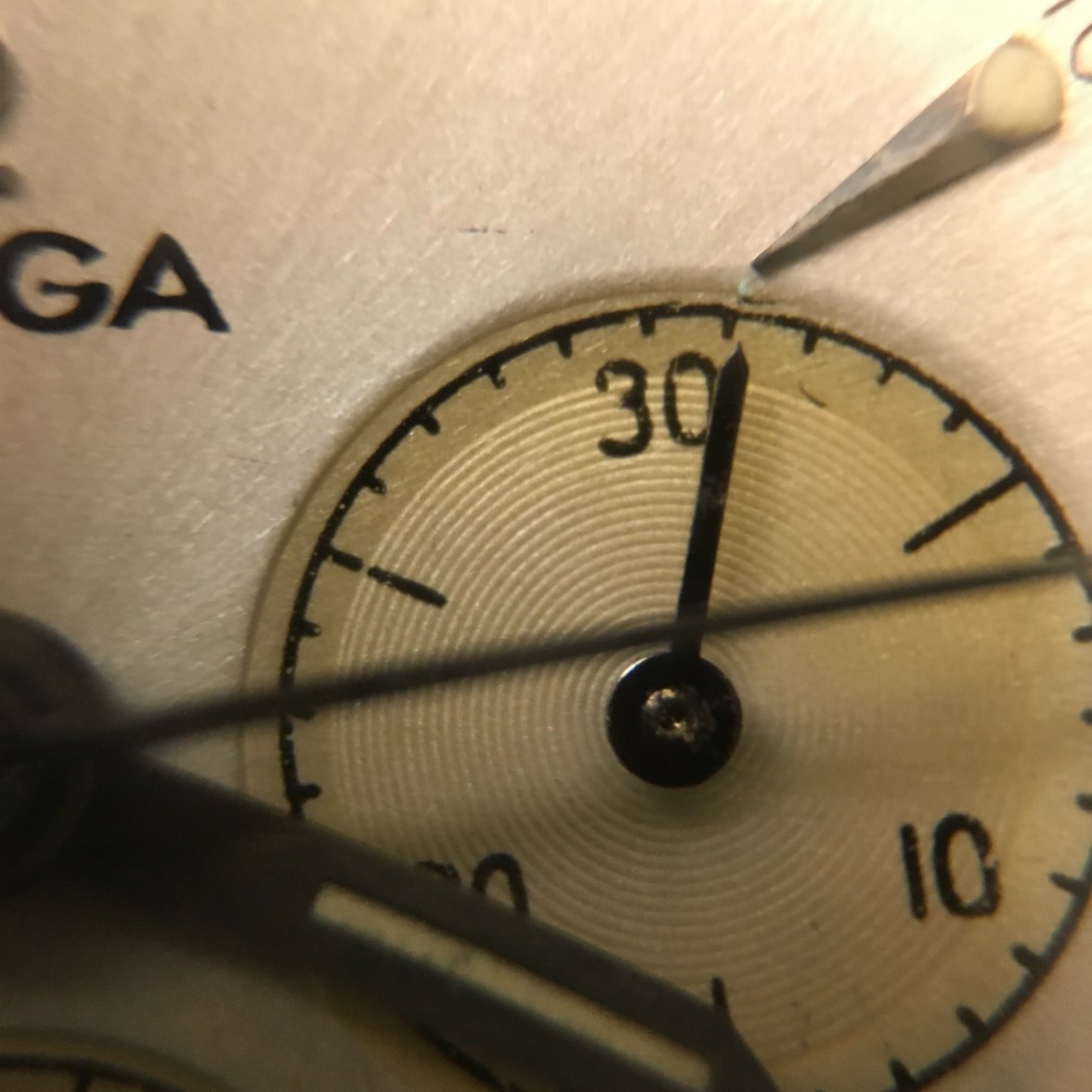

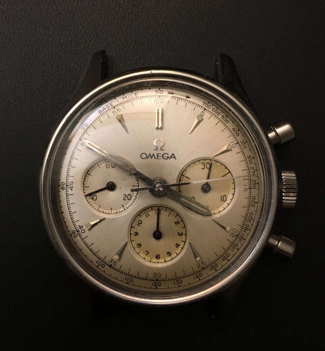

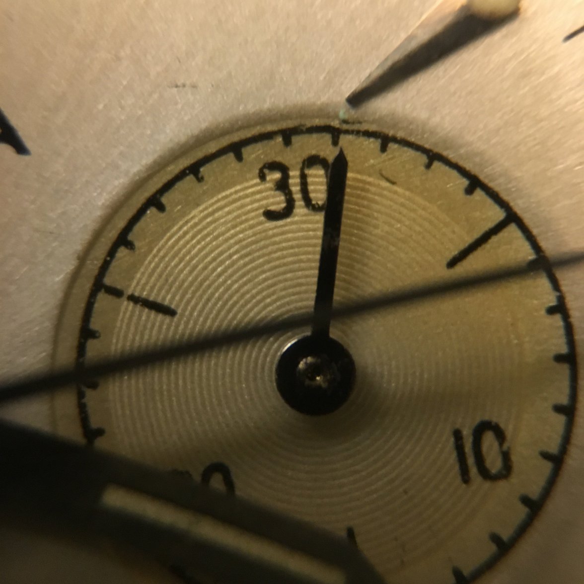

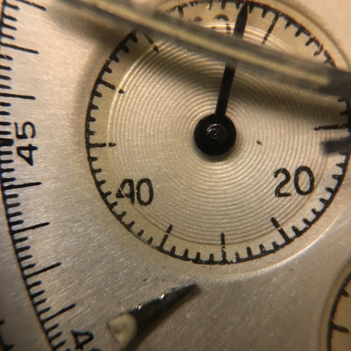

Before I send this back... It's a redial right?
2,070
14,602
I recently received this watch ... When I inspected the dial I immediately thought - "bad redial"... I contacted the seller with my concerns, and was told :
" We are an authorized dealer and service center for Omega. The watch was fully inspected by our watchmakers and all the parts are original "
They will accept the return, but I just wanted to double check, as sometimes I don't know if I'm just getting too jaded or cynical about such things...
Am I crazy? It's a redial isn't it? Thanks in advance for your thoughts...
8,742
69,437
The dial itself may be original...
but the finish is not. 馃憥
9,217
24,054

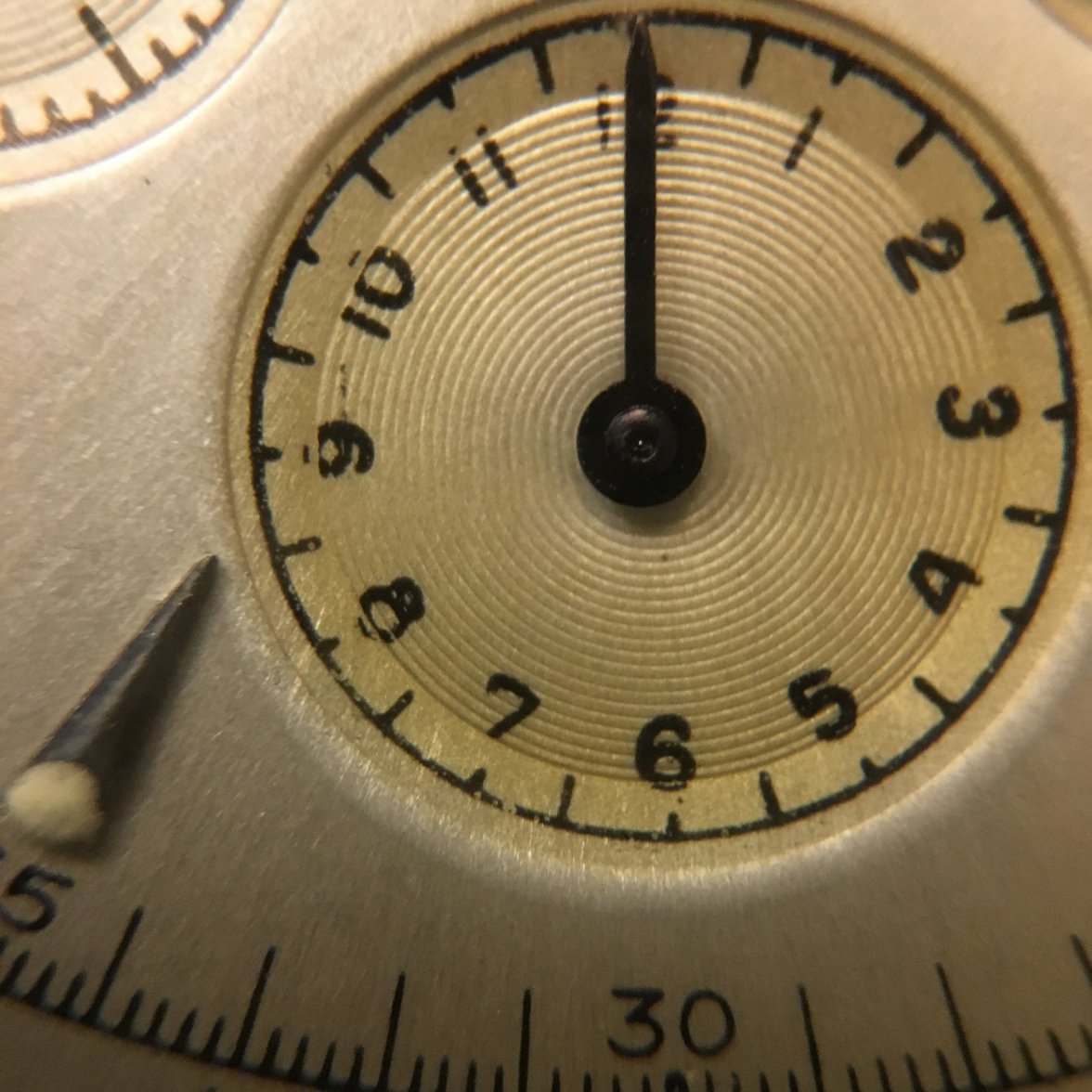

I have to agree.. especially those subdials.. I'm sure the piece of metal is original, but the paint job on it doesn't not appear to be to me.
2,070
14,602
I think it's unanimous! Back it goes.... Thanks guys 馃ぎ
572
419

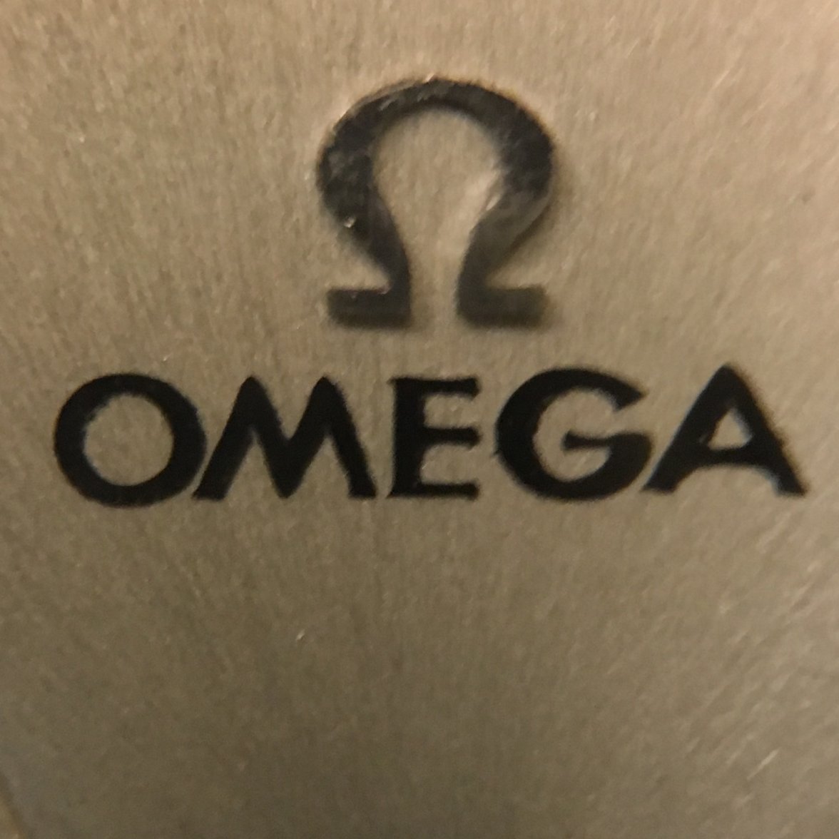

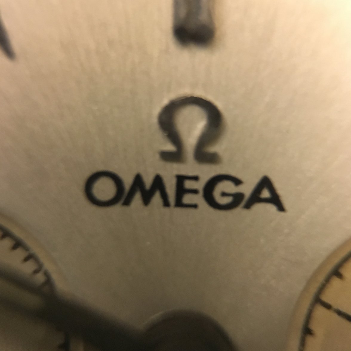

The fonts on that OMEGA look way suspicious.
Nice macro pics btw.
4,043
13,944
Quasimodo was a little heavy handed on the OMEGA font as properly noted.

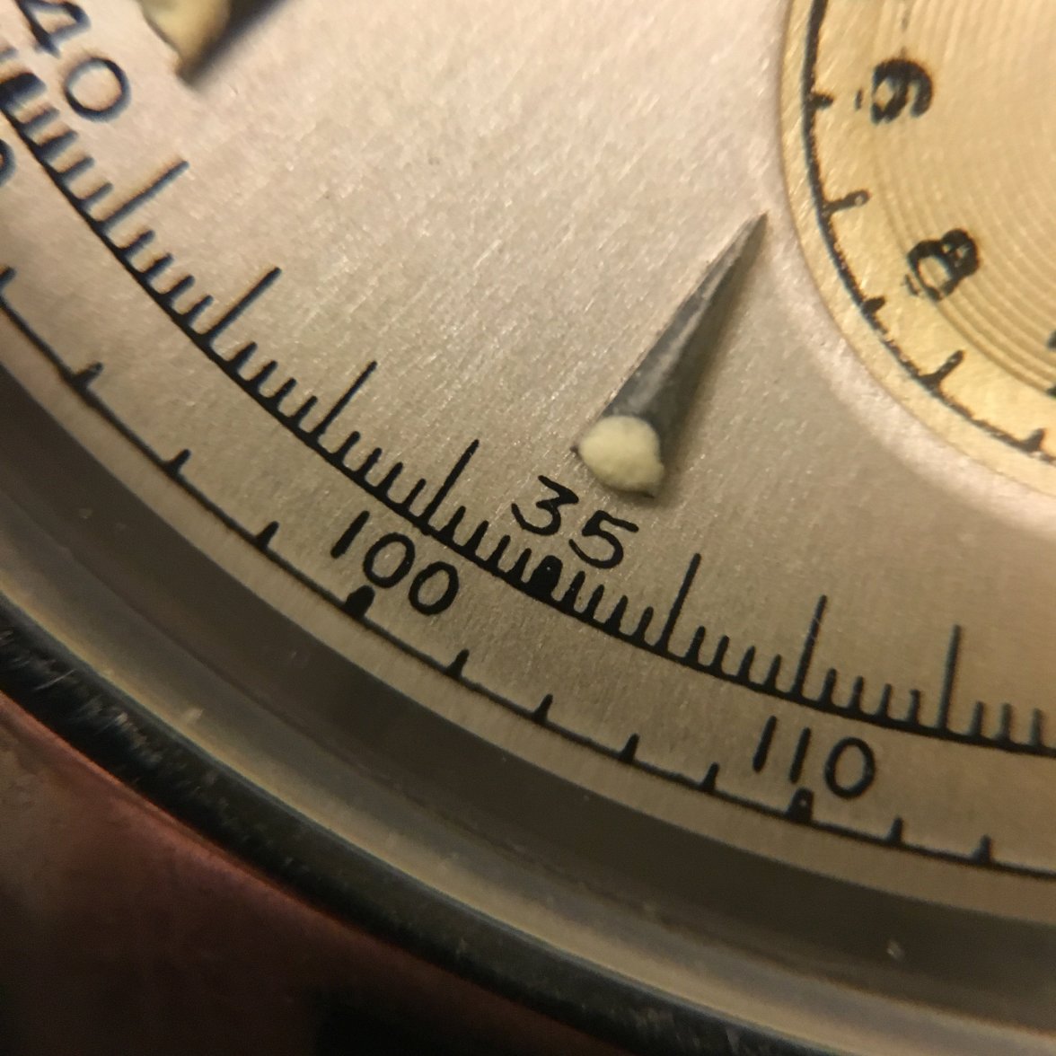

Redials are tough, tough, and unfortunately, many sellers don't have the macro skills to properly show the dial. +1 on nice photos.
913
8,049
Very helpful thread for a newbie! Thanks!
2,266
4,262
OM(E)G(A)....not 馃ぎ
Lousy redial.
At the very least minute and hour hands are not original to this model. Probably not Omega hands either
