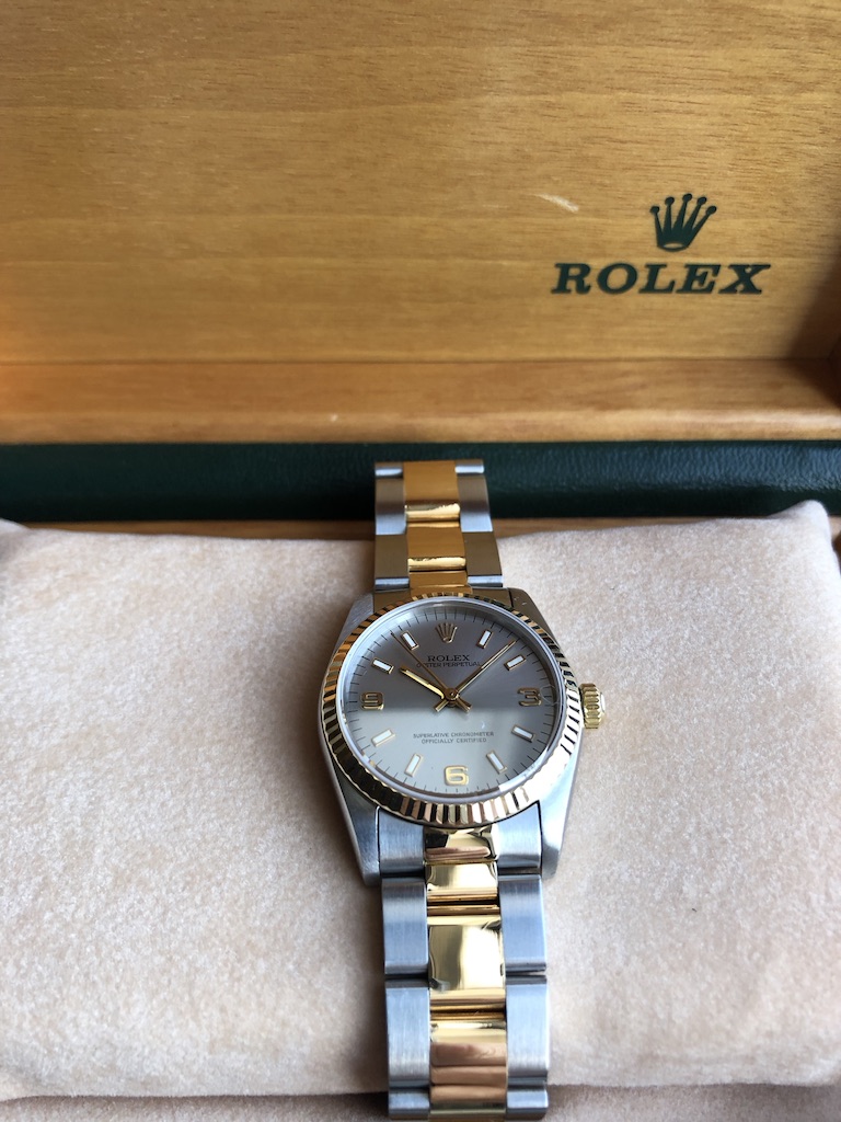

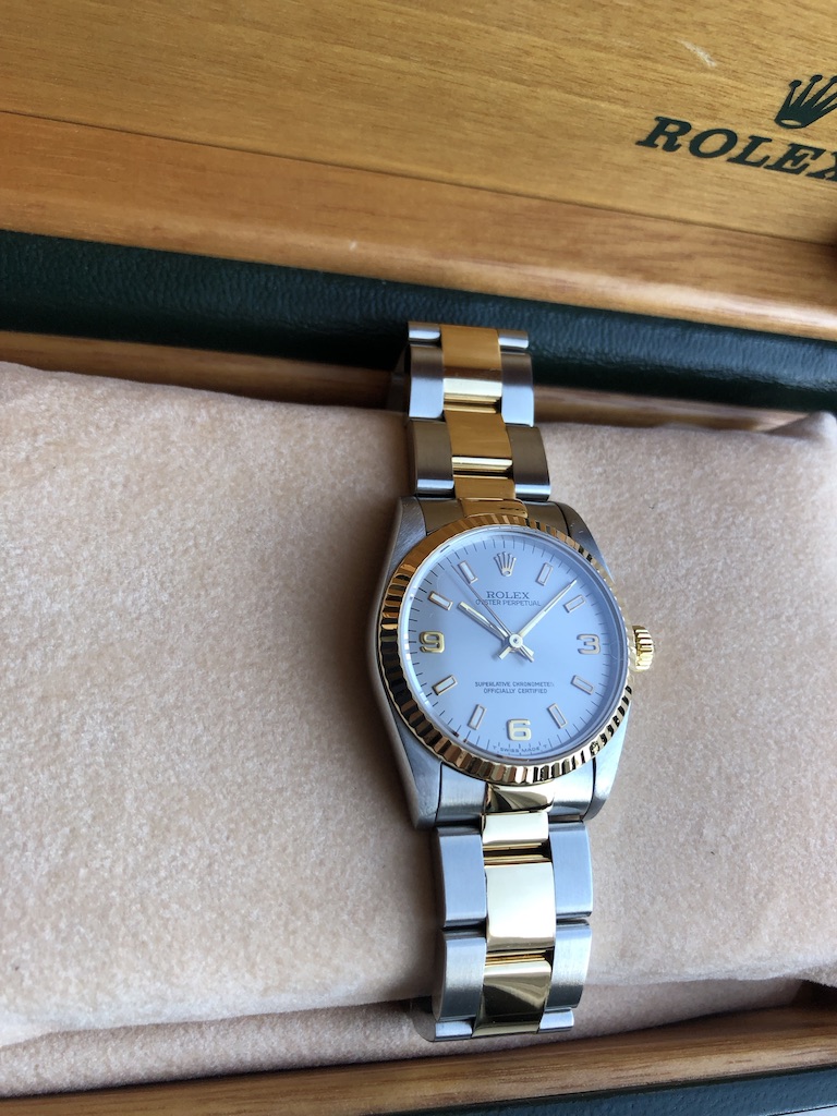

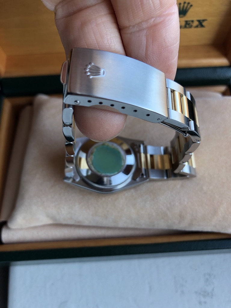

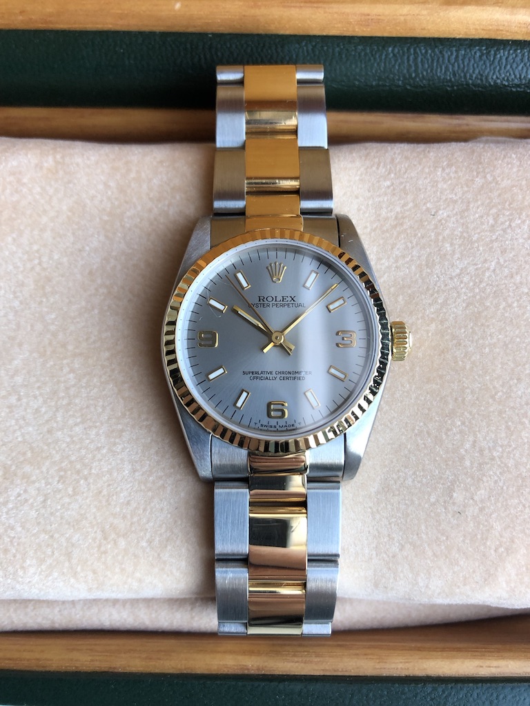

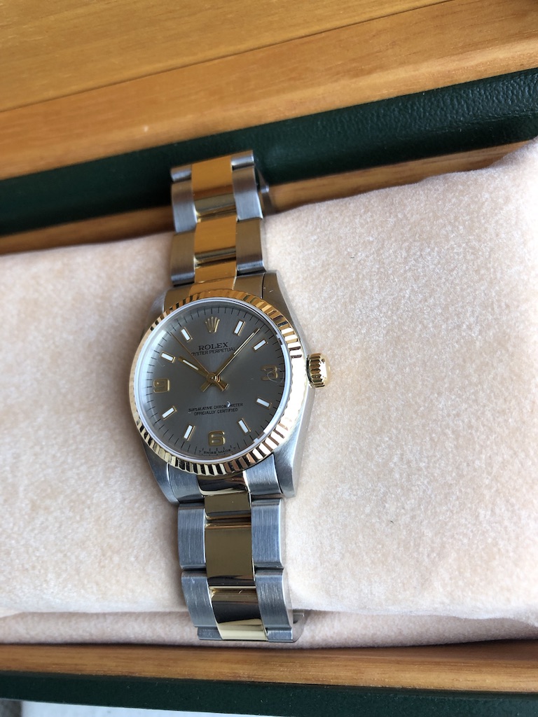

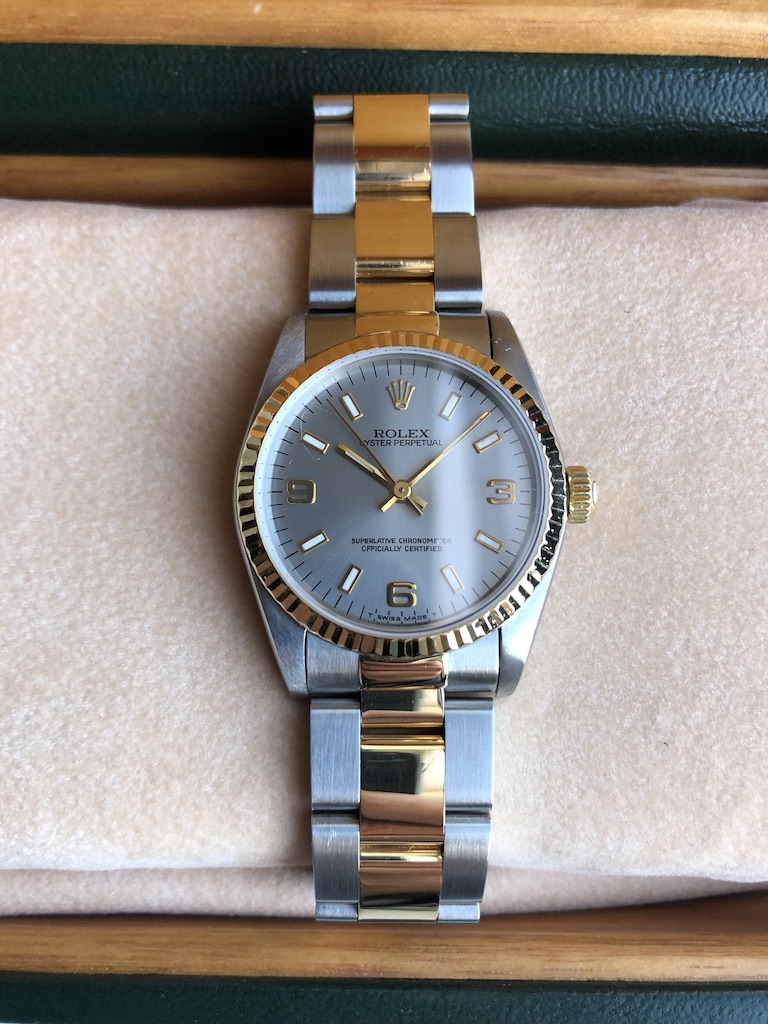

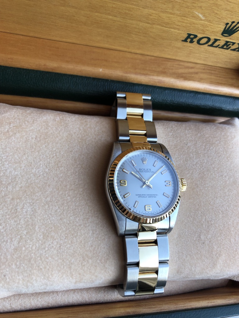

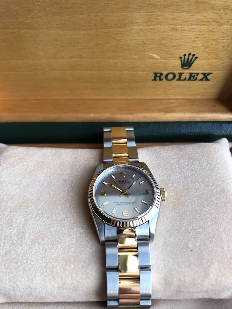

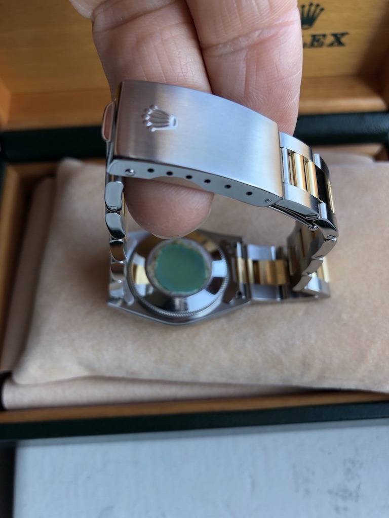

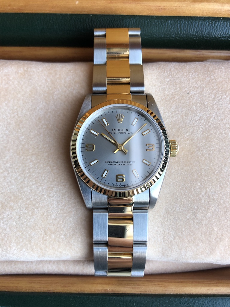

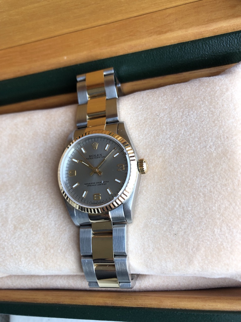

Hi, all-- I am well aware of the Do's and Don't's of sending watches into Omega for service, but I have never sent one to Rolex for service. I recently picked up a watch as a gift for my step-mother, and would like to give it to her in "top condition," so to speak. I dropped it at a Rolex Service Center and they gave me the evaluation below and I'm wondering how much to give them the green light on and how much to ask them not to do. It's not a vintage piece (it's from 1996), so perhaps just let them go all the way?
Here's the analysis:
Slow, Bezel Nicked, Bracelet Scratched, Bracelet Worn, Dial Spotted, Hands Spotted, Hands Scratched, Luminous
Worn, Case Scratched, Bezel Scratched, Crown Worn, Case Back With Sticker.
Here are a few pics of the watch:
I would be inclined to ask them to do the movement service and the bracelet work, and leave the rest alone. However, if they could do the other items mentioned without "compromising" the originality or sharpness of the existing parts, then perhaps having them do it all is not a bad idea?
Advice appreciated!
16,015
48,235
I suggest that you do NOT send it to Rolex! Their inclination is to return the watch to new, cosmetically and mechanically. This will be a very expensive repair! All you need is a thorough movement service, and leave the cosmetics alone. A competent independent watchmaker should be able to do that for you.
318
290
FWIW, I agree with Canuck’s suggestion. The watch is already in very good cosmetic condition. Absolutely wearable and by the way a nice gift.
From the pictures, it looks as if the centre part of the end link at 6 is bent. If it were mine, I’d see whether a local watchmaker or jeweller could fix that. That could be a challenge (not easy?), but there is always Rolliworks and/or perhaps it can be replaced at a Rolex AD.
