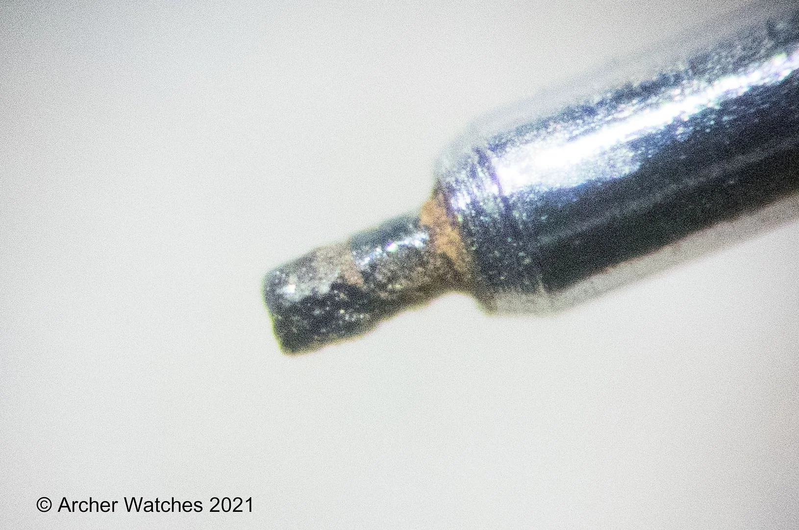

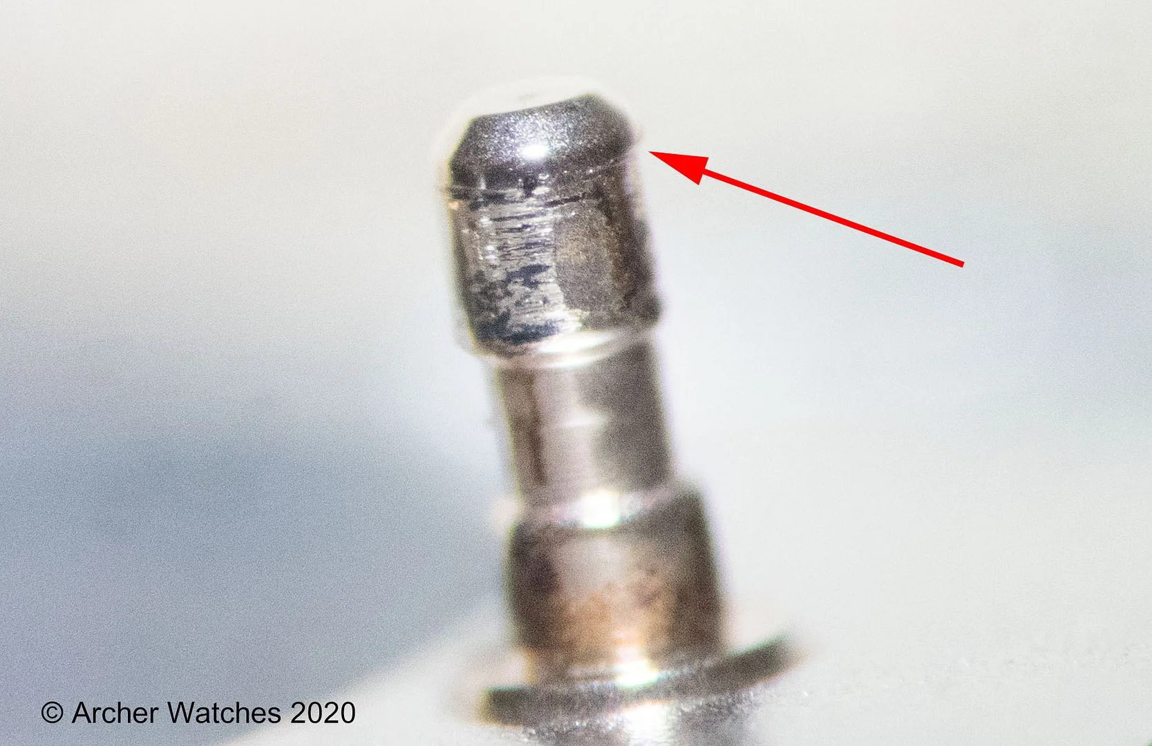

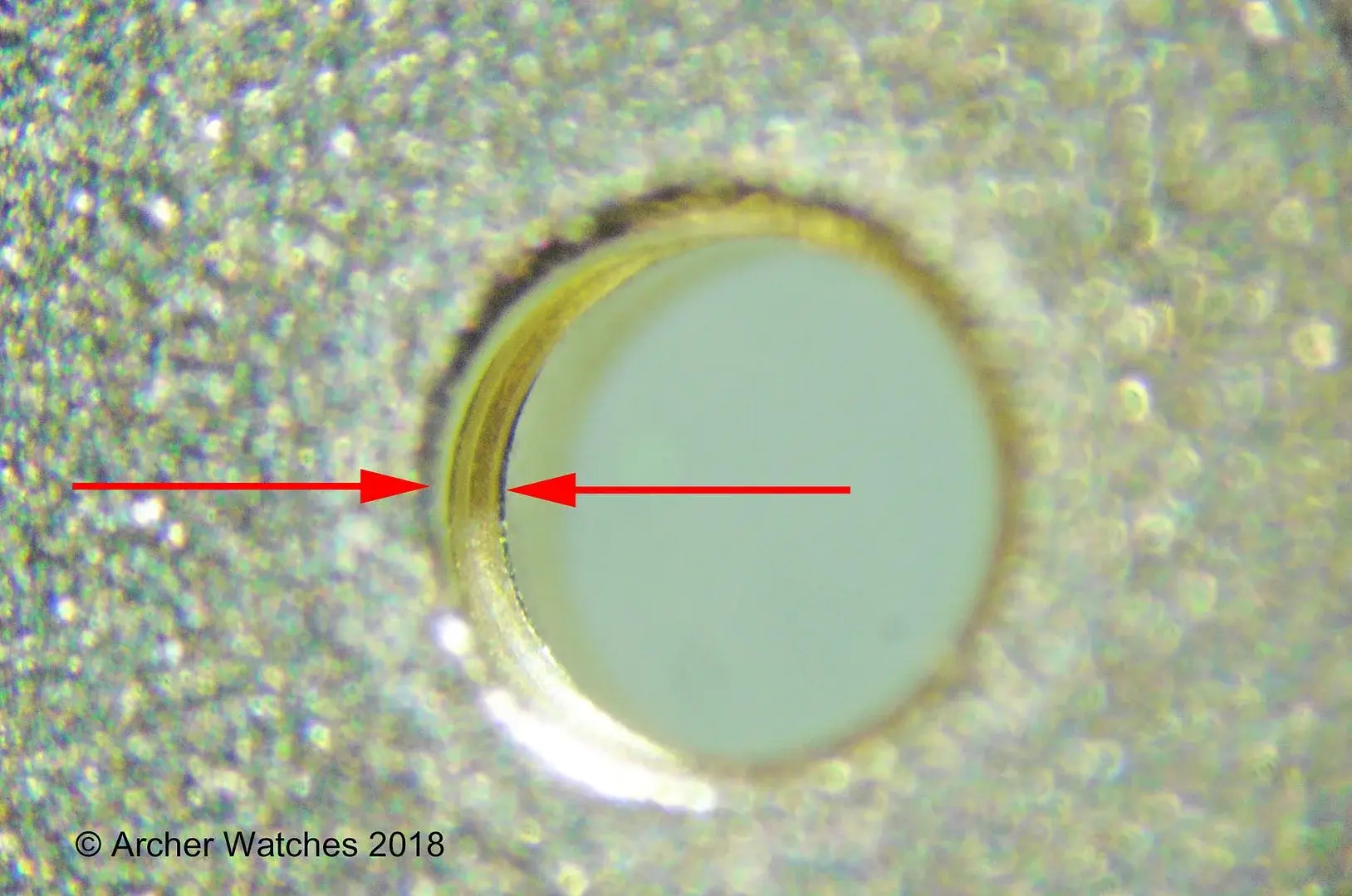

So I wanted to post this since it's a little more unusual than the wear I've shown in most of the photos so far. Servicing a micro-brand diver with a Standard grade ETA 2824-2 inside. The watch was barely ticking when it came in, and my inspection showed that some oils had broken down so pretty normal stuff, but the thing that caught my eye was a large amount of brownish debris on the pallet stones:
So as I disassembled the movement I kept a close eye on that area, and found this:
This is not something that I see a lot, but I have seen it a few times. Wear happening at this extent between the fork horns of the pallet fork is unusual certainly. This is where the roller jewel (impulse pin) swings into and unlocks the escapement, and the fork pushes the balance - here is what the roller jewel area looked like:
Tried to get a good shot of the wear in the fork:
Decided that my usual microscope was not powerful enough, so pulled out the bigger one - you can see the wear in the area between the two arrows, and there is the same wear on the opposite side of the inner fork horn:
Over the years I have seen a number of watchmakers debate the cause of this wear, as it's very specific to this area. The sheer amount of debris seems to be more than the actual material that has been worn away from the pallet fork. The material looks quite rusty in colour, and for me the best explanation I can come up with is that there was possibly improper application of epilame to the pallet fork. Epilame is a treatment done to specific parts in the movement to prevent oils from creeping away from where they are placed, and typically only the actual jewels of the pallet fork are treated, so you keep the treatment away from this area of the fork. The application is done using a solvent carrier, and when it dries quickly the temperature of the parts drop rapidly, and condensation can form - my best guess is that happened here and it lead to a slight amount of rust forming in this spot, that in turn lead to this wear.
The roller jewel is fine, so a thorough cleaning of the movement and a replaced pallet fork will get this movement running again. But this is another illustration that when you see debris, it has to come from somewhere, so you must track down the source and check those parts carefully.

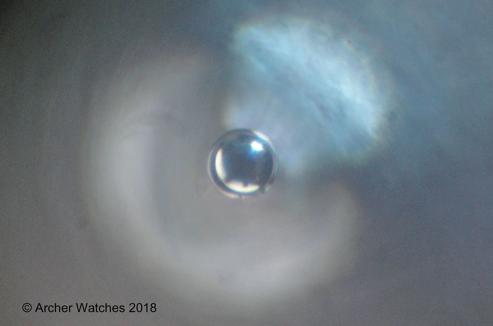

Many modern technical guides will just tell you what not to apply epilame to, so yes most of the movement is treated at the factory. Epilame is only used to create a surface that repels oil or at least makes it ball up. You can see this effect in one of my oiling threads for the escapement.
So the only reason is to keep oil from spreading.

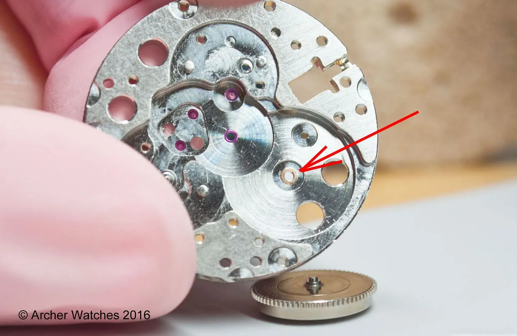

It's the same thing with parts, and thankfully for most common parts like worn train wheels, replacement are available. In some instances very minor wear can be addressed with burnishing pivots on a wheel that is difficult to find, but I generally prefer replacement if I can find the part. One exception is that when the end of balance staffs are worn - I burnish those often...
I have also repaired worn holes with bushings...

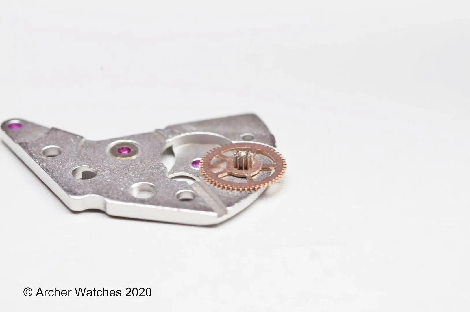

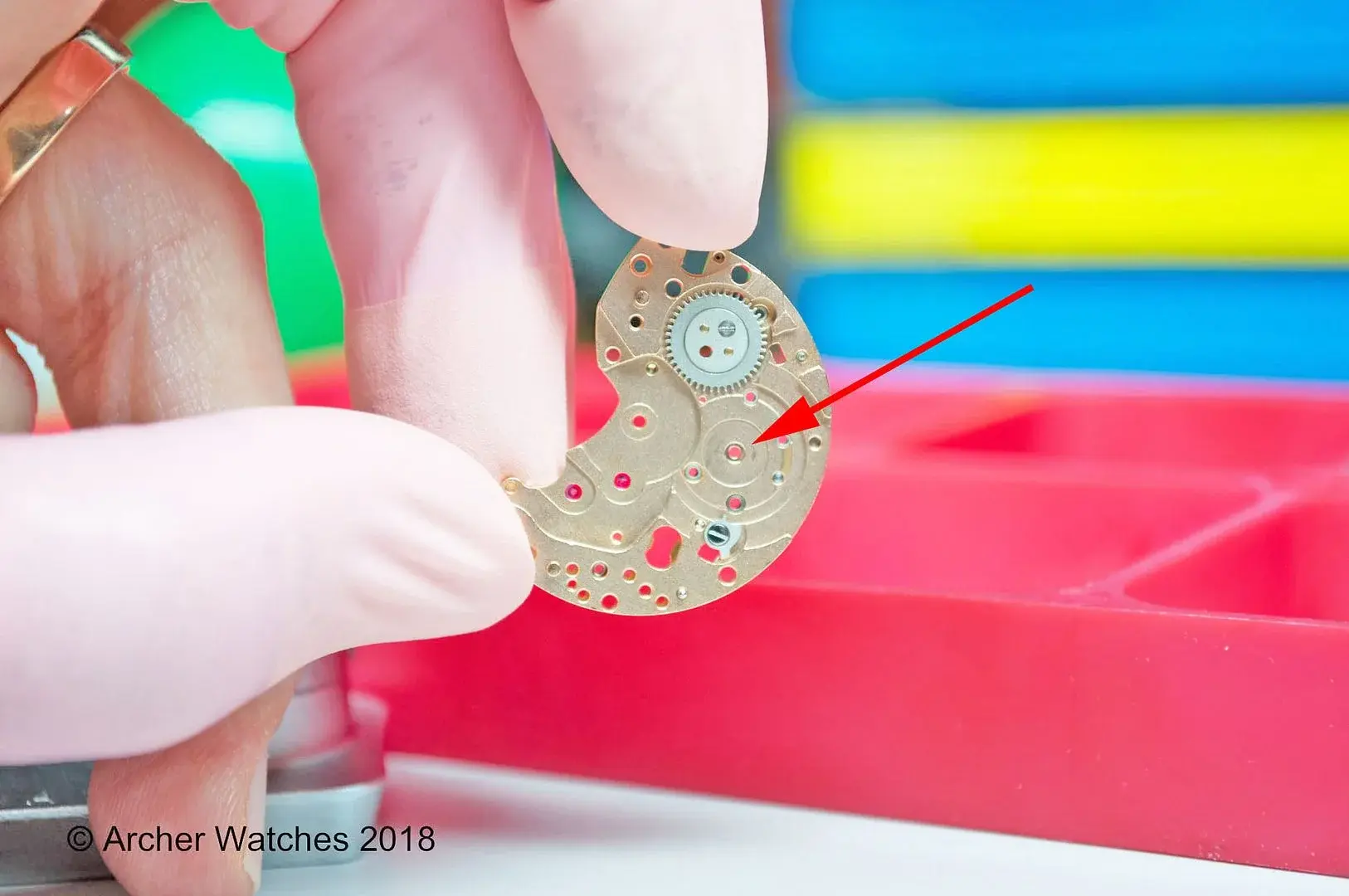

Even if a part is readily available, I will sometime repair it if it makes economic sense. This is a worn post on a 7750 based Omega movement:
I made a new one for it, as to get a new part would require replacing the entire bridge, since the post is not sold separately:
Done:

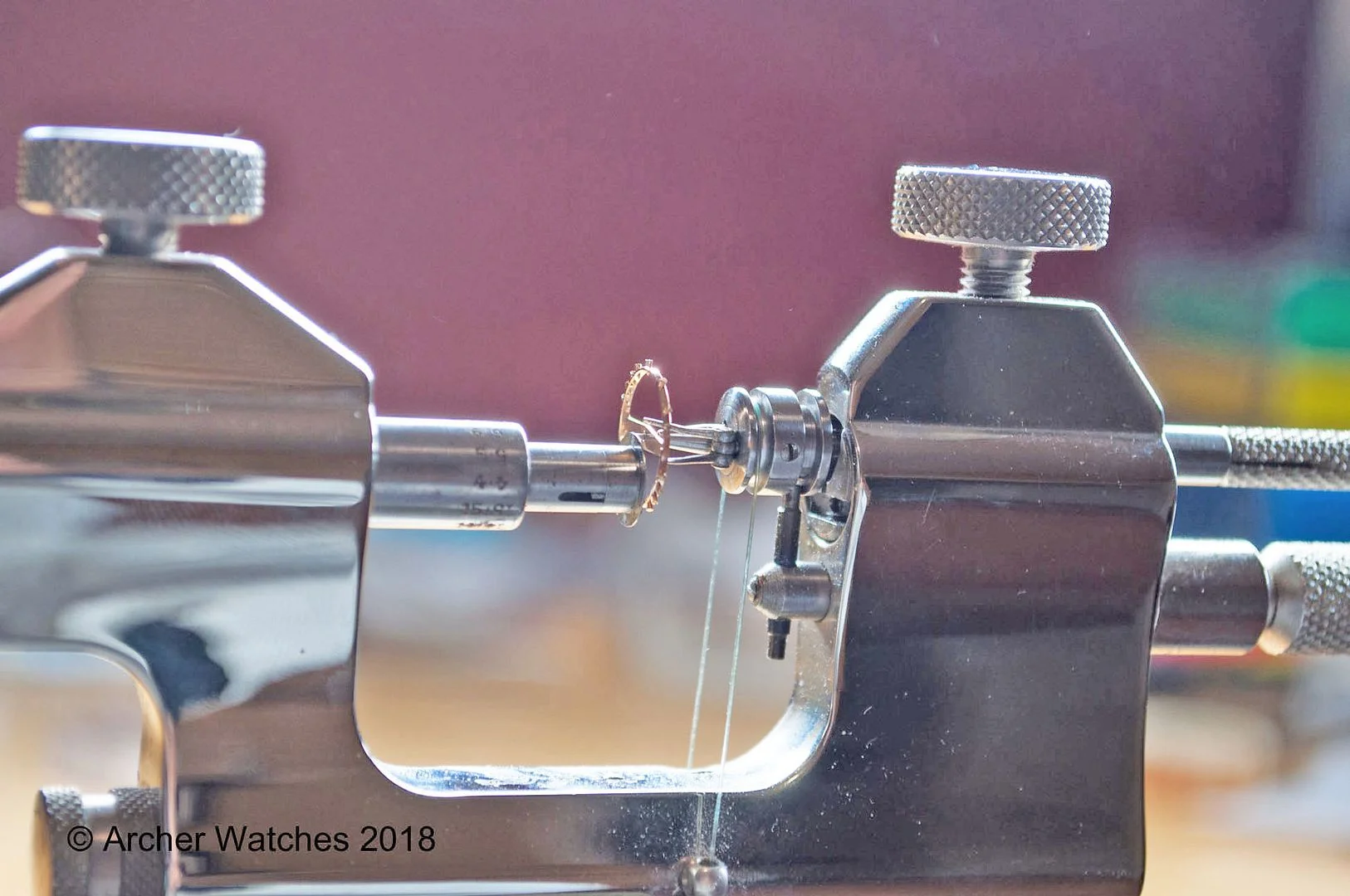

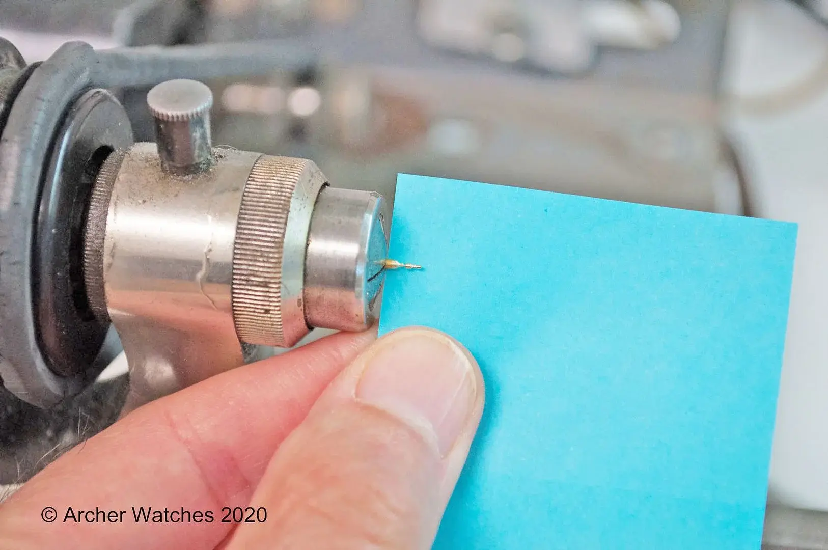

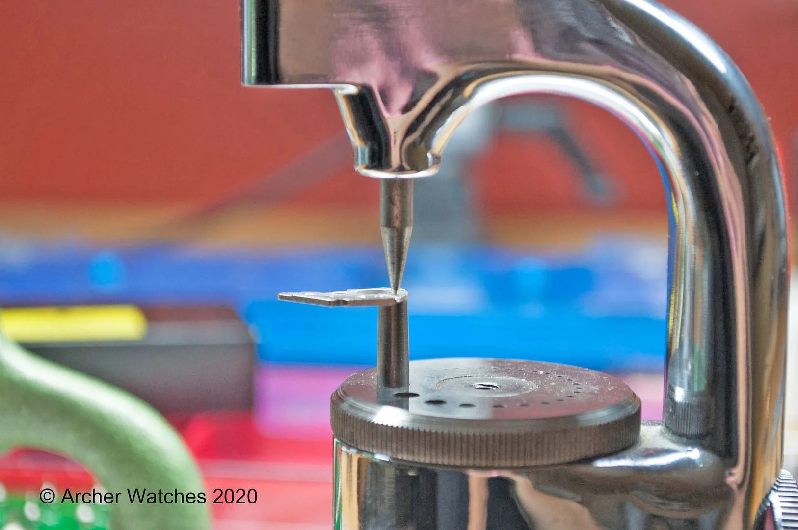

Repivoting is certainly an option, but really only in very extreme circumstances would I do it. For example this vintage PP wheel:

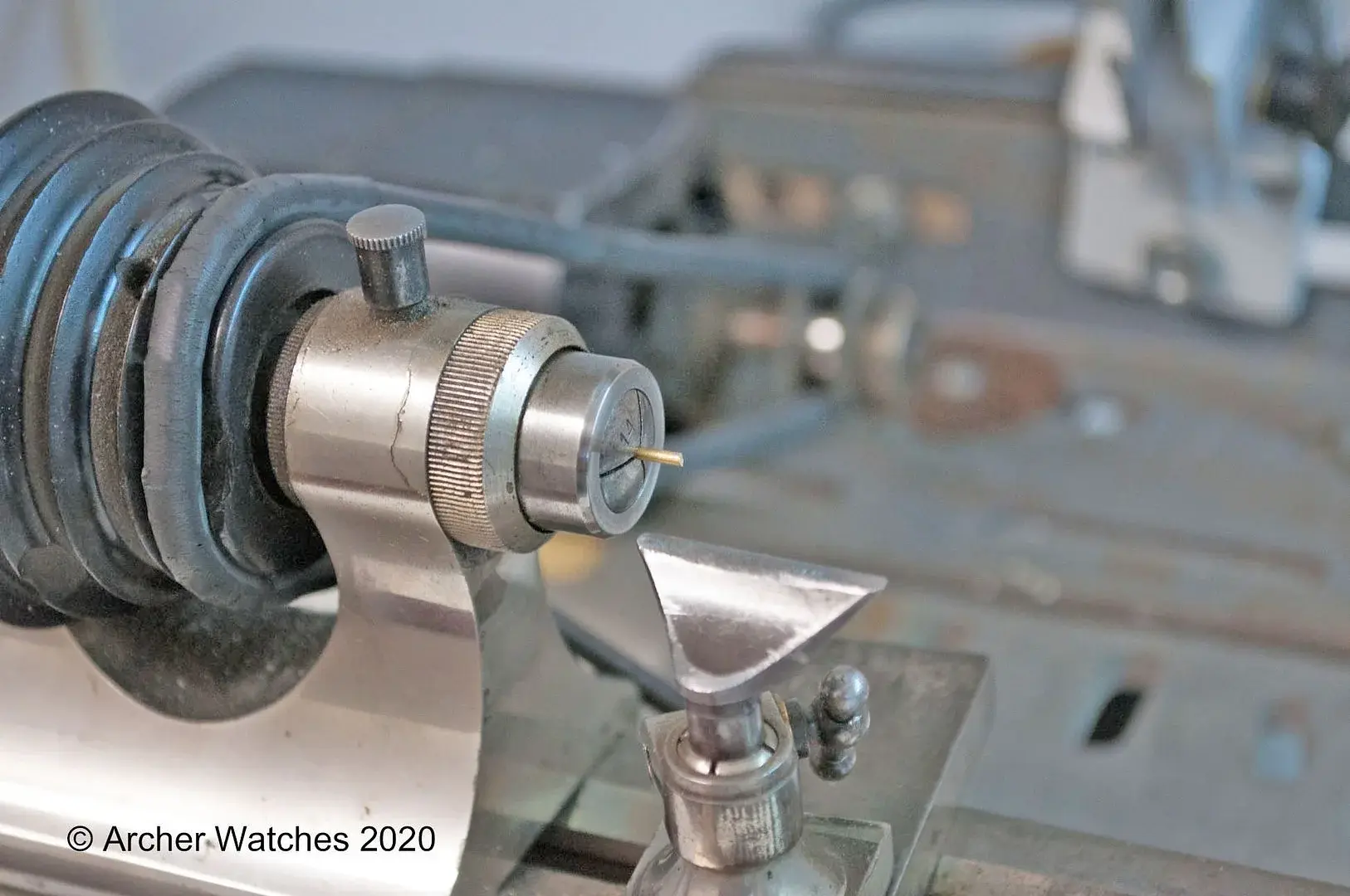

One other wheel was worn that I was able to find a replacement for, but not this one. The only replacement I could find was a used wheel for a lot of $$ that came with no guarantees, so it might be just as bads as this. My lathe headstock and tailstock don;t line up 100% (I think they might be from different lathes originally) so repivoting on it would be quite difficult. I "have a guy" though, so off it went to him:
You can see the plug on this end view:
Done:
The worn post on the 7750 bridge is sold seperately. Partnumber 1599 ETA. Send me a PM if you want to know where.

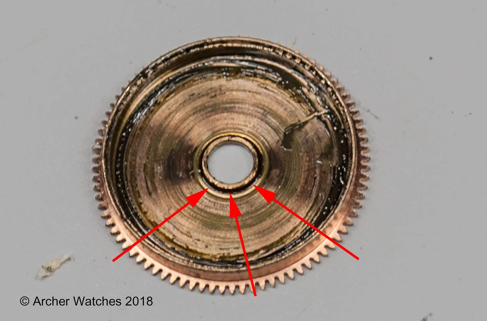

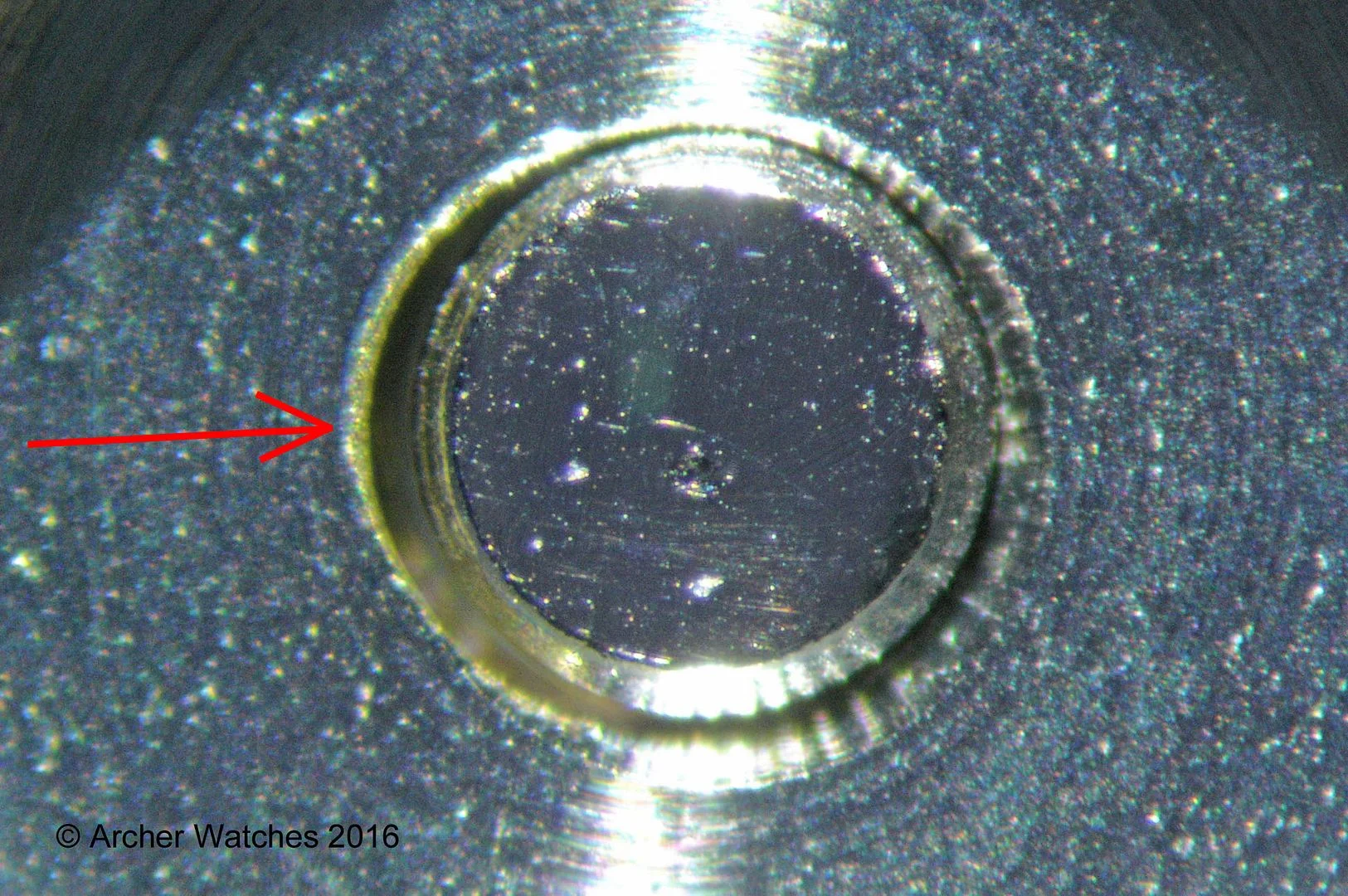

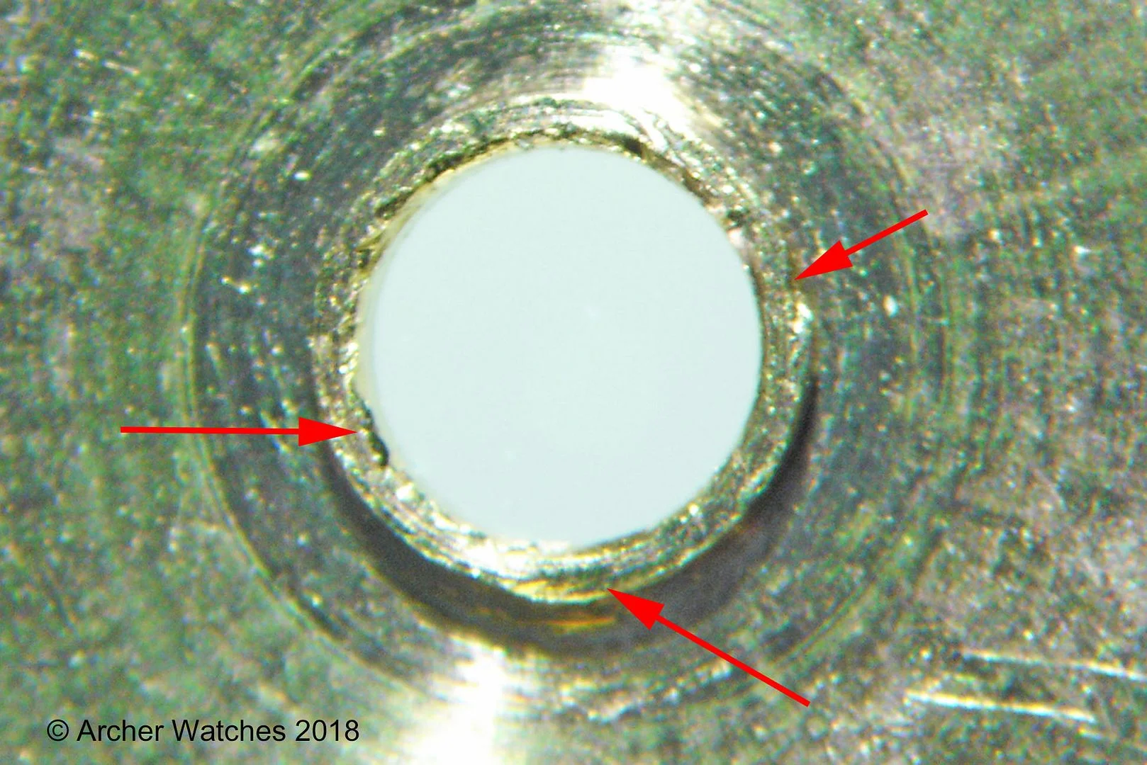

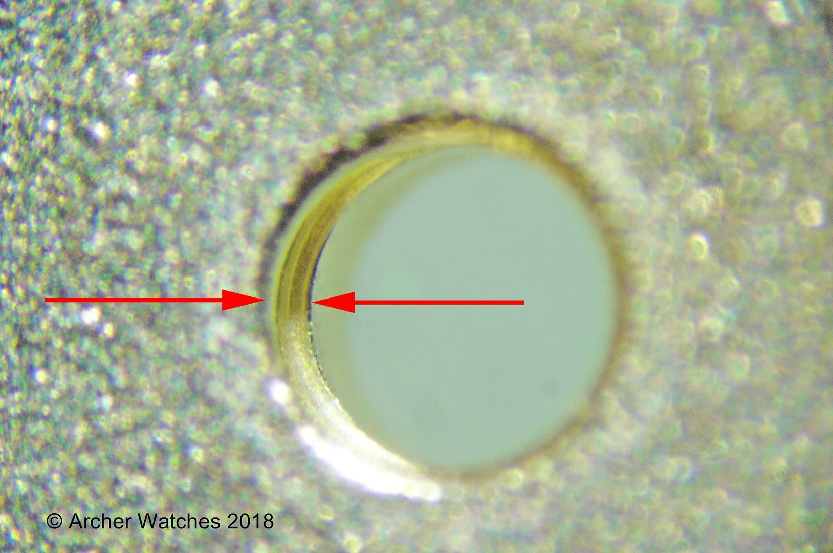

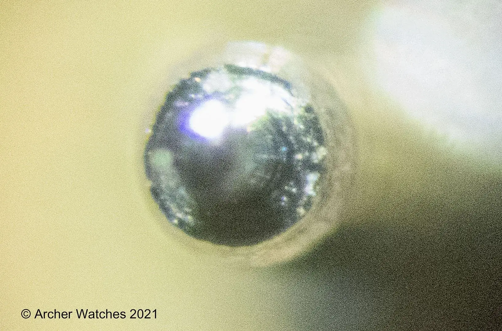

I wanted to add a couple of other things to watch out for specifically - there are many but seeing a damaged barrel this week reminded me to add this one. So even when dirty, you can see there are some shiny spots around the hole in the barrel drum here:
This is a different barrel, but after cleaning you can see all kinds of damage around the hole:
You rarely see this damage on corresponding hole in the barrel lid, because this is damage caused by a watchmaker, rather than wear. This is some watchmaker making a very ham fisted attempt at installing the barrel arbor, and in the process the hardened steel arbor has caused damage to the soft brass of the mainspring barrel. The damage here can cause a lot of problems with lost balance amplitude and erratic running, because when the mainspring unwinds, the barrel spins around that arbor. If there are burrs here it's going to cause added drag. This damage can be repaired (cleaned up) to a certain extent, but if it's really bad, a new barrel drum is needed.
The damage to these barrels looks to be very extensive - at least by looking at the magnified photos. That it can be repaired is amazing. My first reaction was that this looked completely irreparable.
These are probably too far gone, but I’ve cleaned up others…
