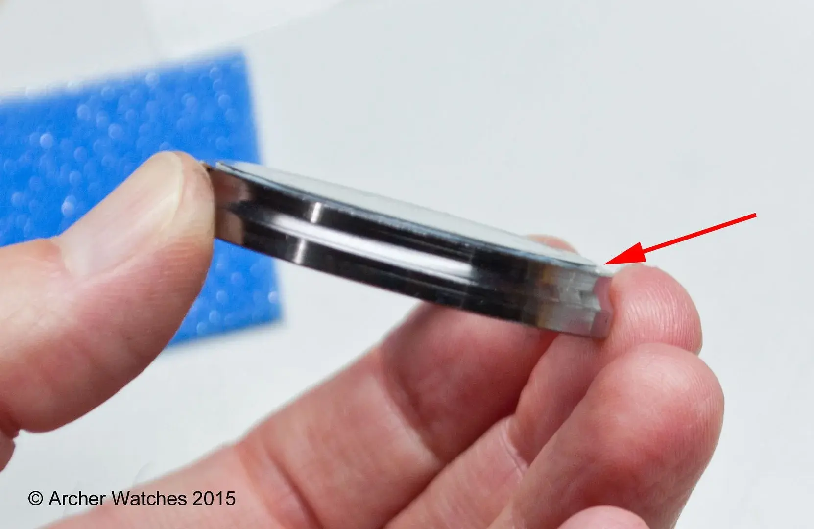

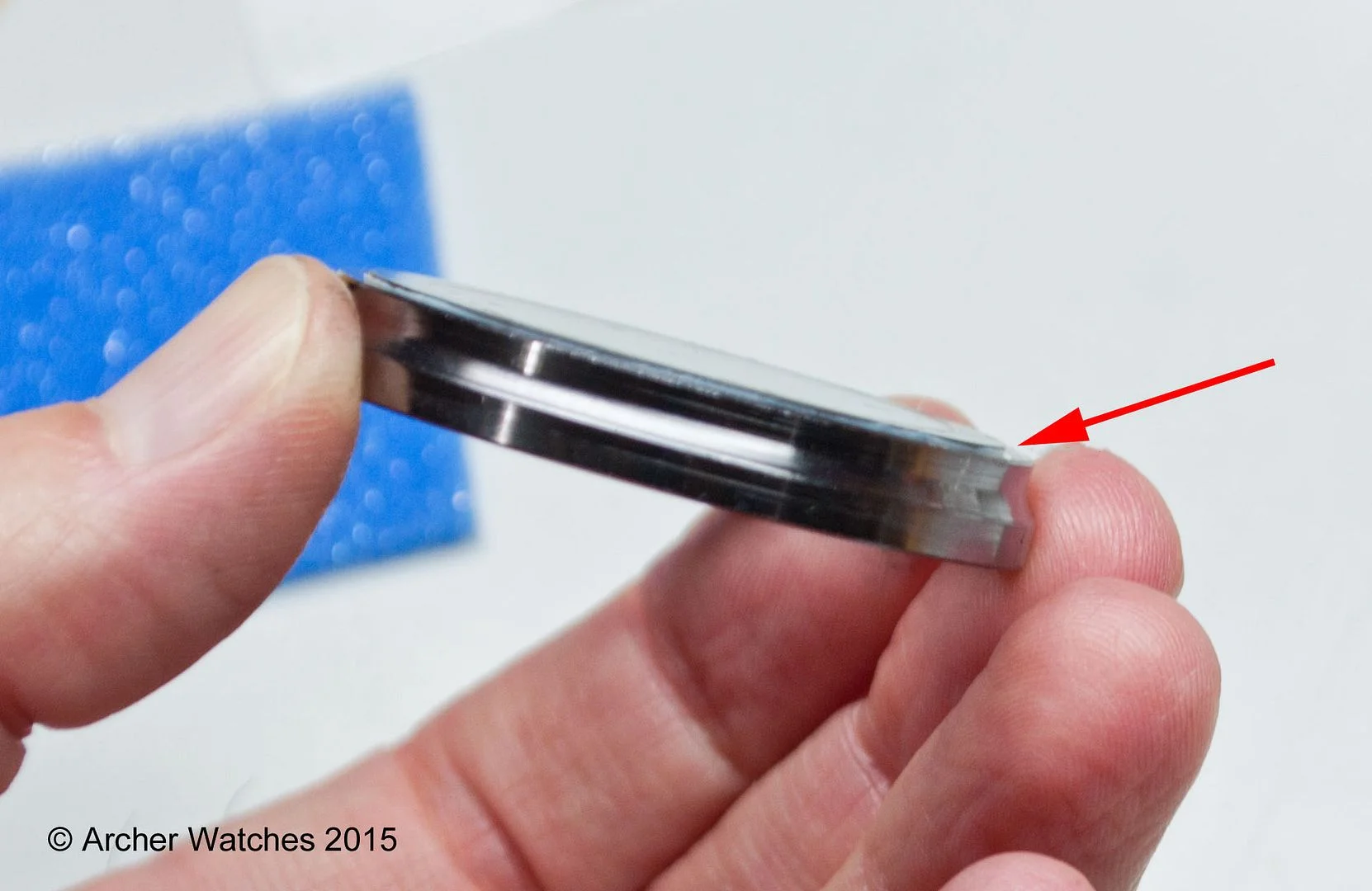

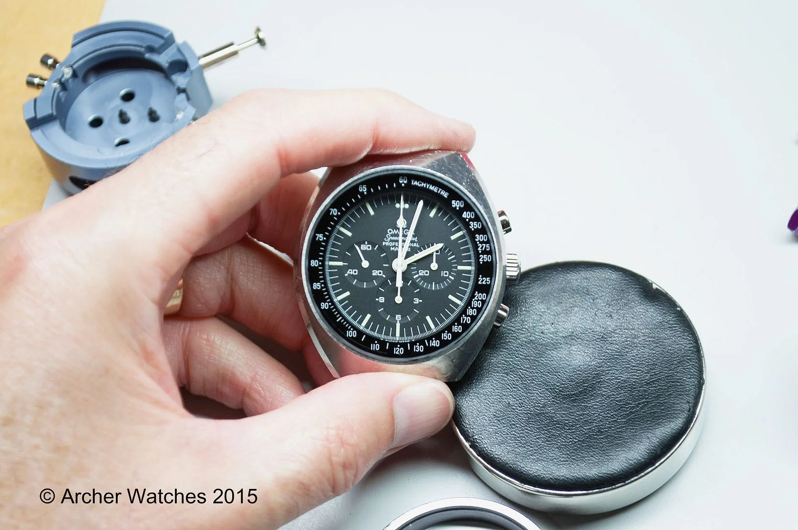

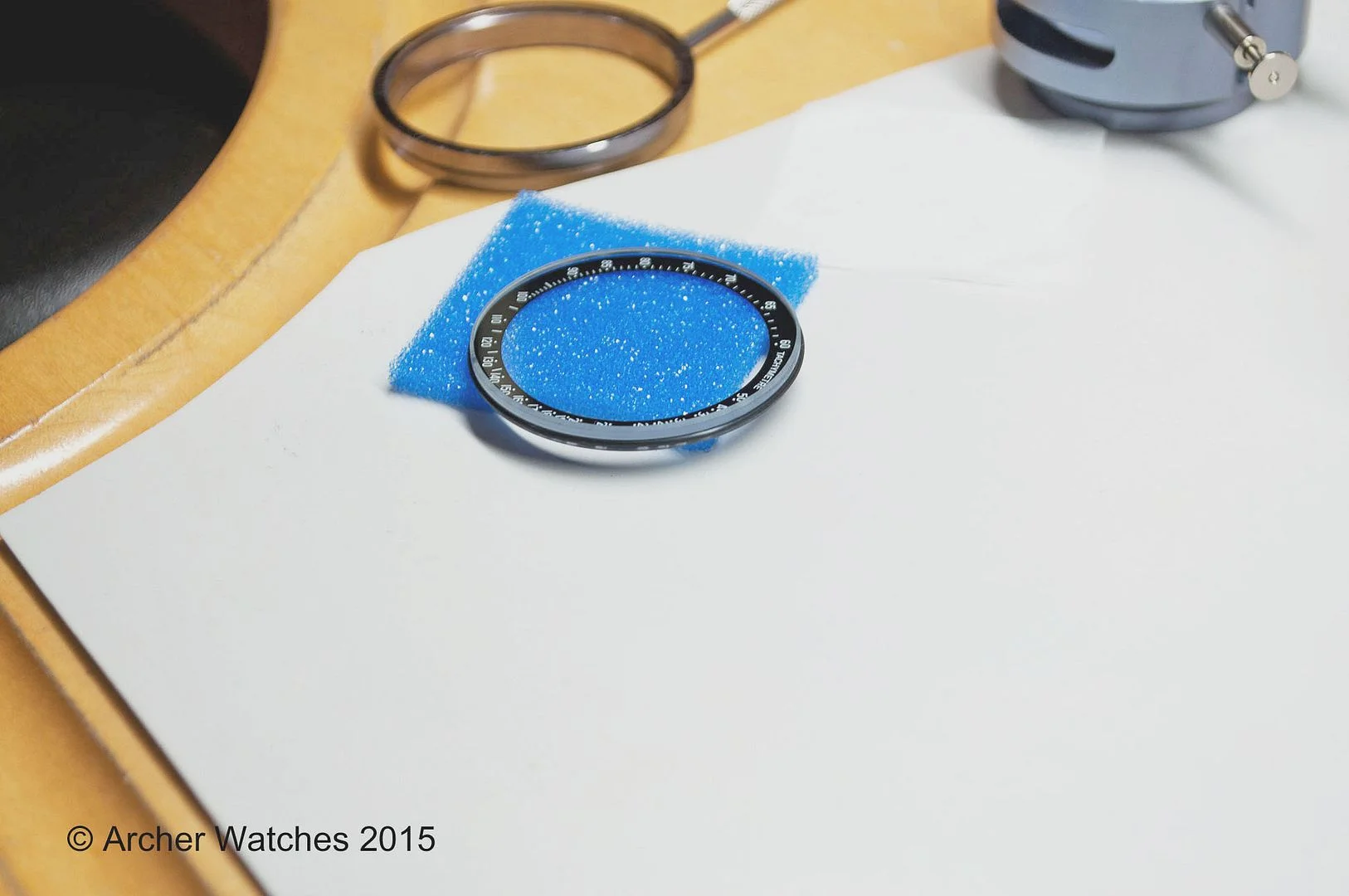

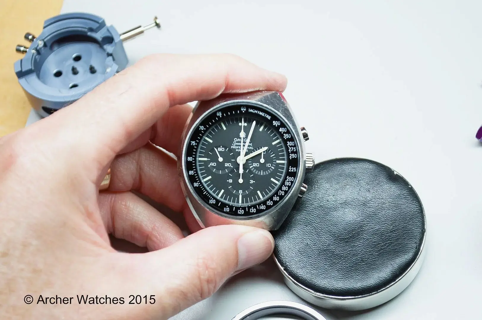

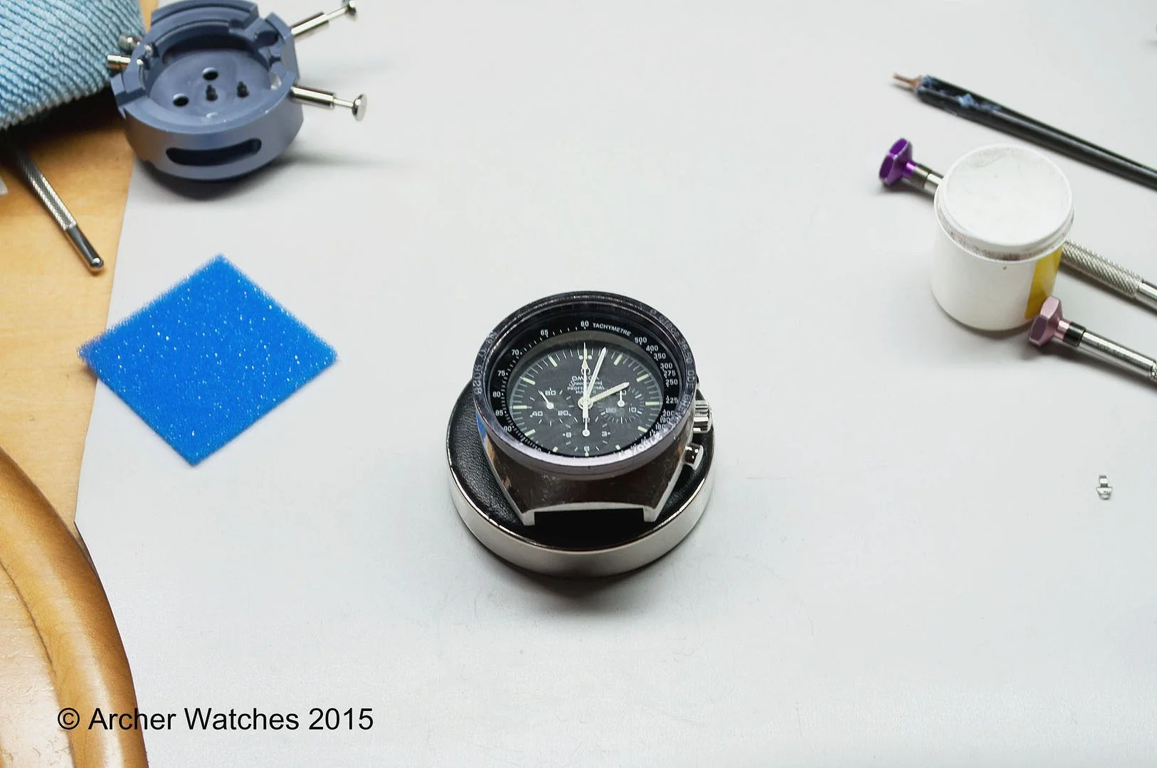

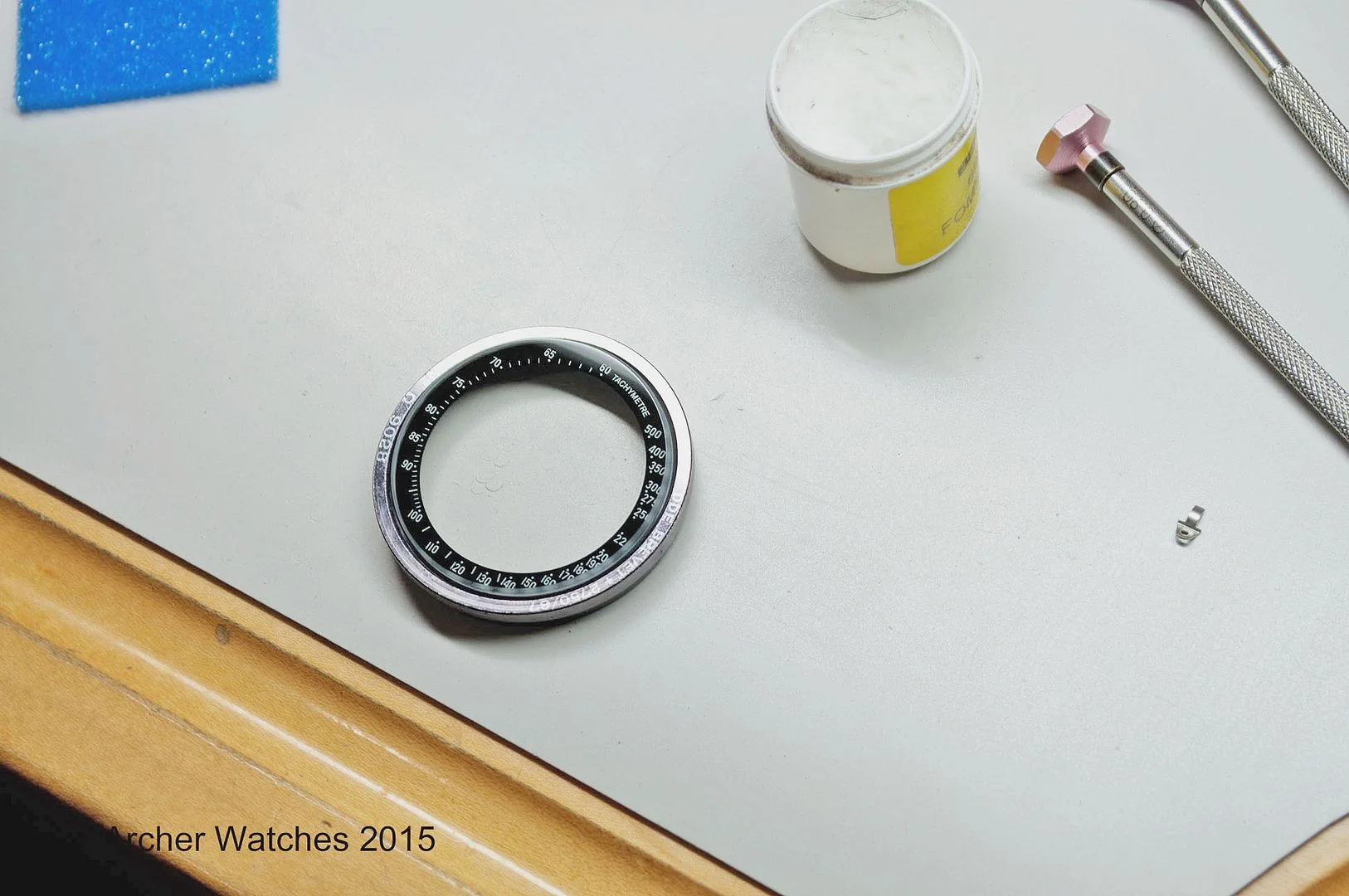

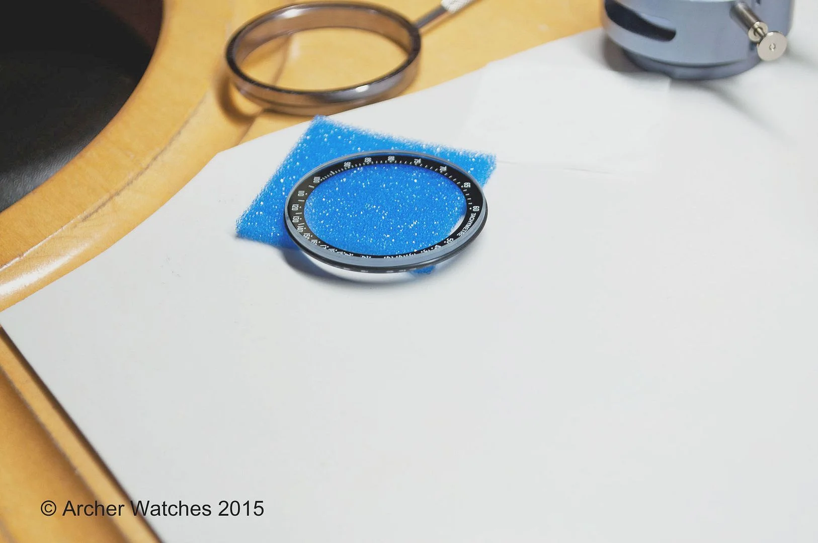

Moving on, here is one that's been covered before, and is a bit unusual - a mineral crystal held in with an O-ring. These are found in the Mark II Speedmasters, Flightmaster designs and others like this also. The crystals have a groove cut around the circumference of them, and this is where the O-ring seats as you can see on this Flightmaster crystal:

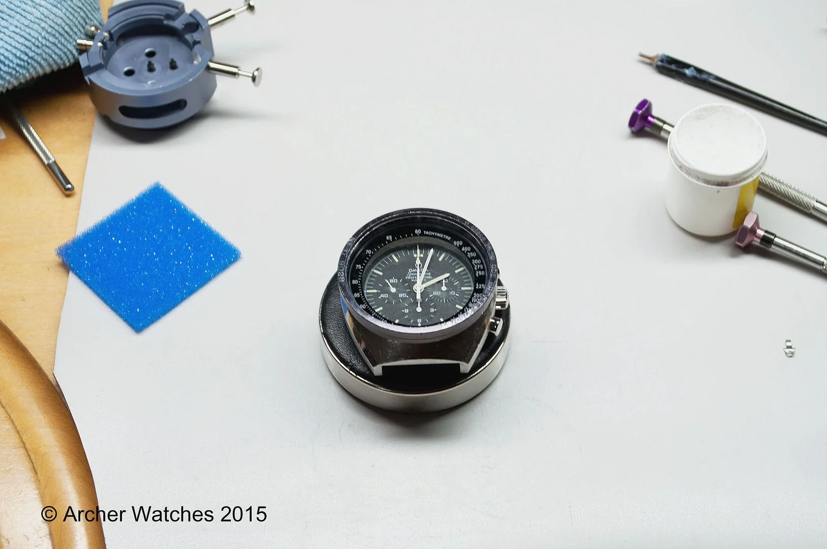

Omega makes a tool for inserting these crystals, and here the tool is just past the crystal. The crystal has had the O-ring installed on it:

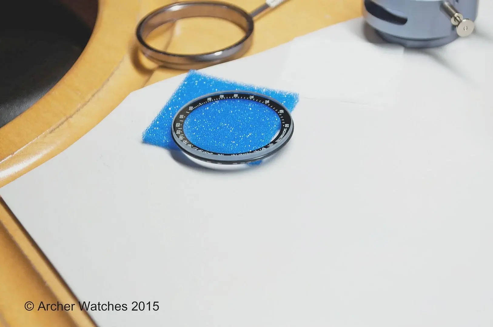

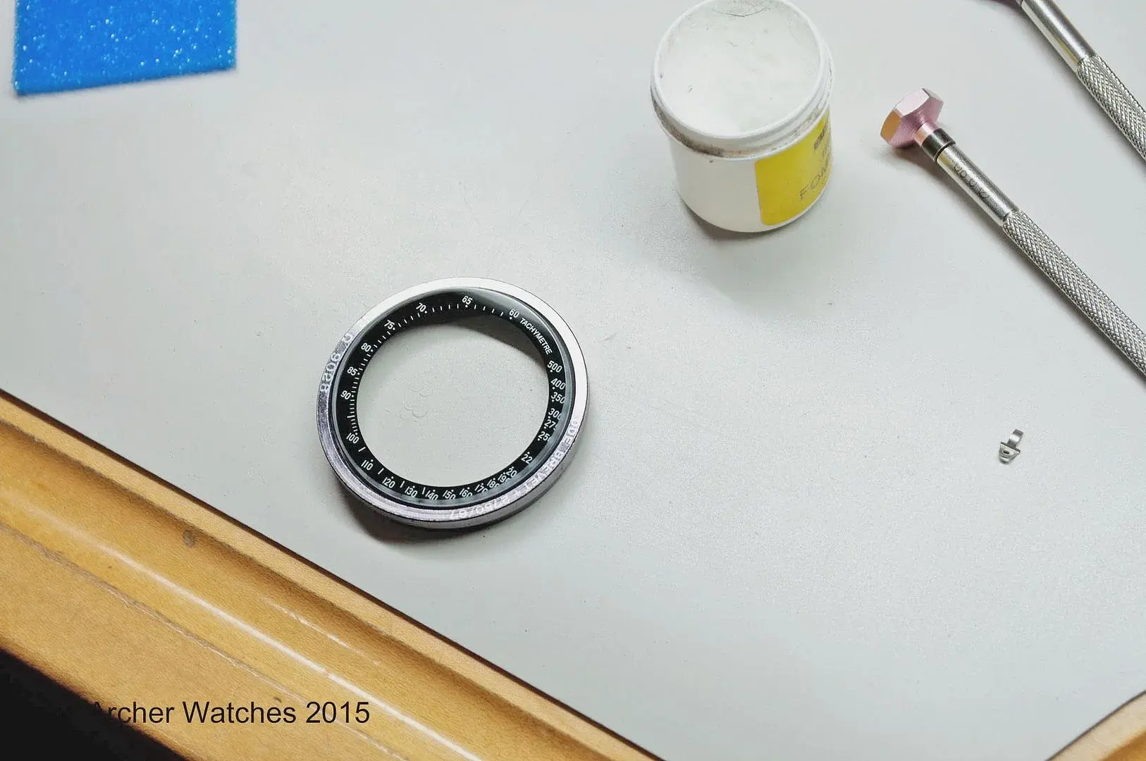

The inside of the tool is lubricated with Fomblin grease, and the crystal is inserted into the tool:

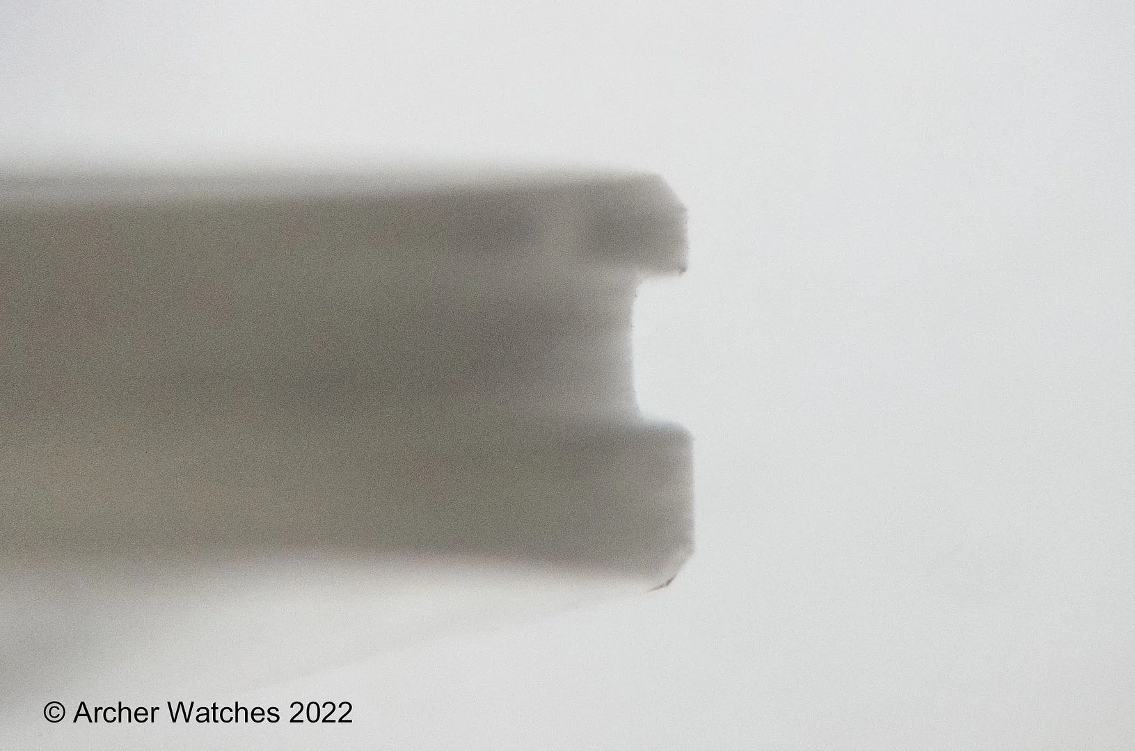

The tool is tapered on the inside, and as you press the crystal into it, the O-ring is compressed. There is a small groove on the inner diameter of the tool that acts as a stop - this leaves part of the crustal sticking out of the tool, to help locate the crystal in the case:

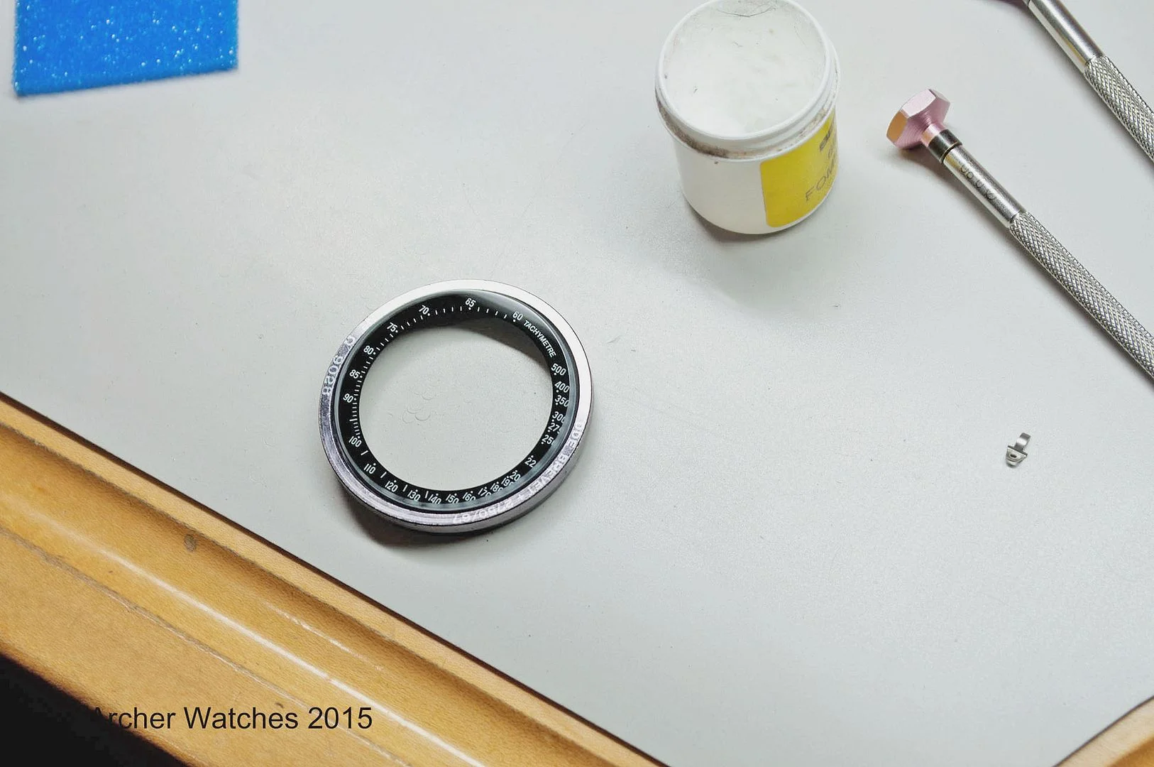

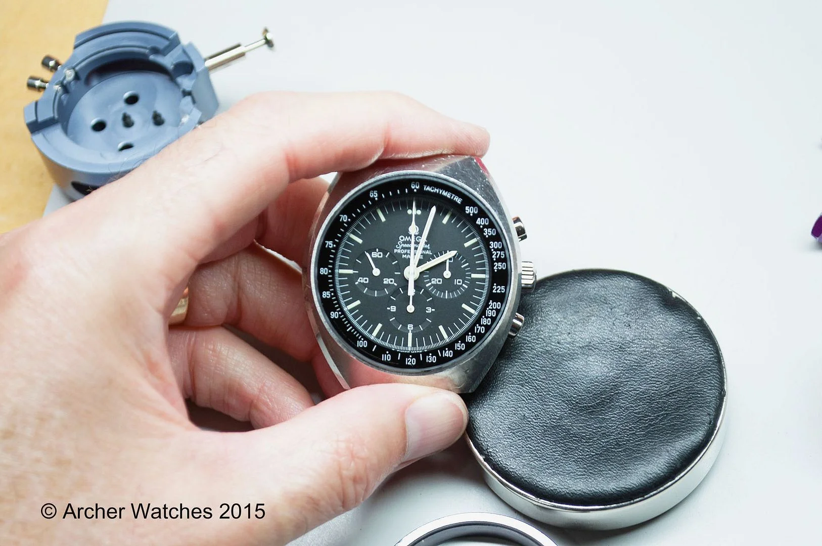

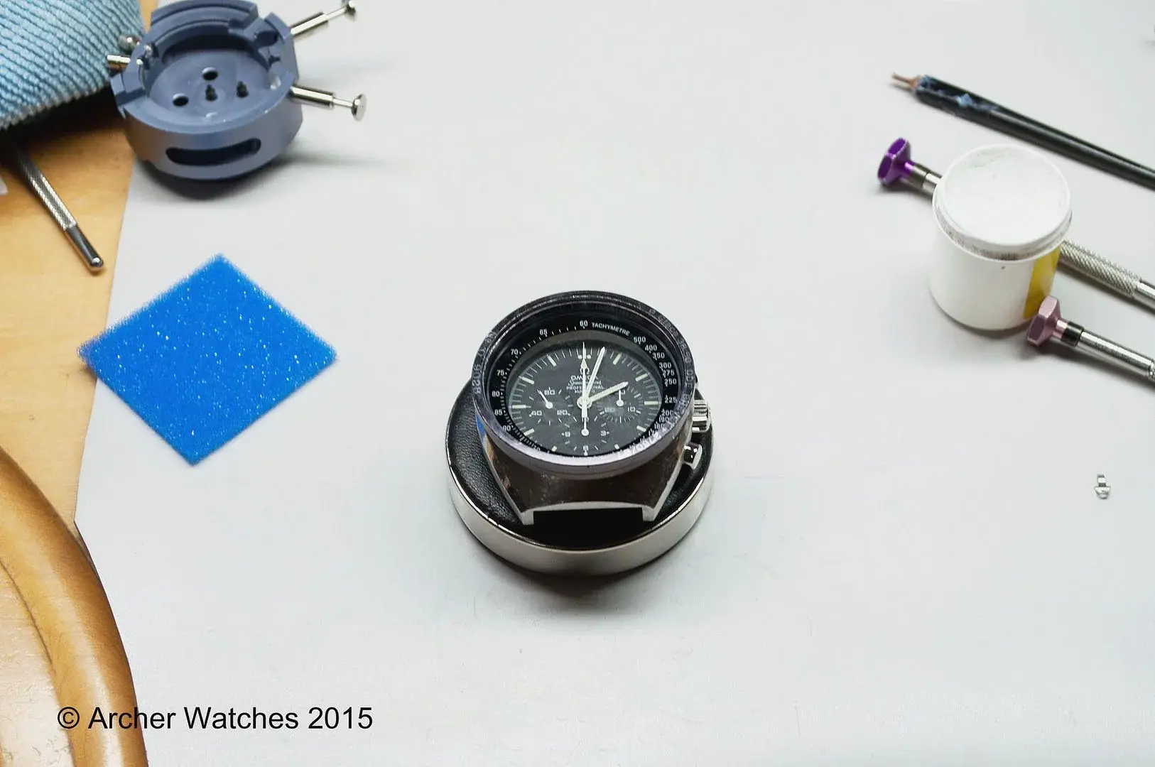

The tool and crystal are positioned on the case, making sure to align the tachymeter scale on this one:

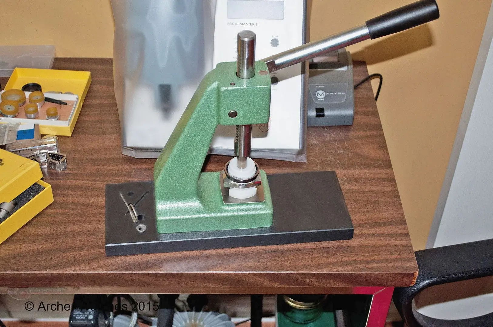

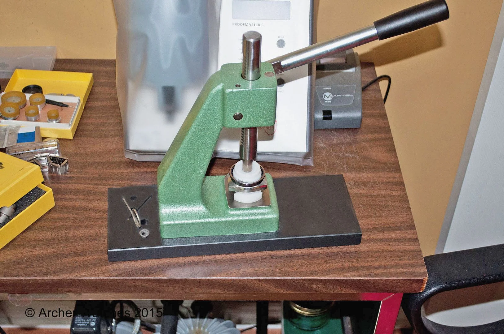

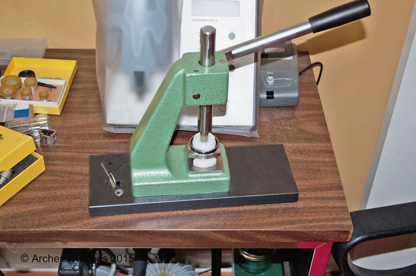

You can start the insertion by pressing the crystal with your fingers, but I find using the press to finish it is best:
This is honestly a terrible system, and you have all likely seen a watch where this O-ring has turned to black goop, and has caused damage to parts under it.

You will likely break the crystal without using the installation tool…

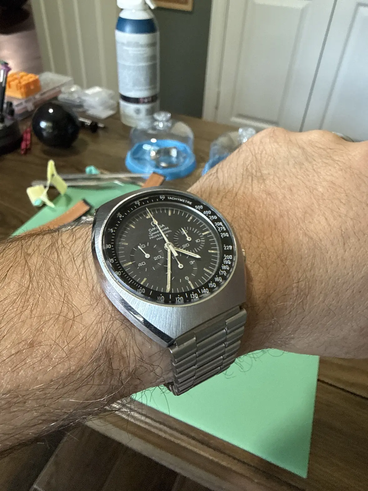

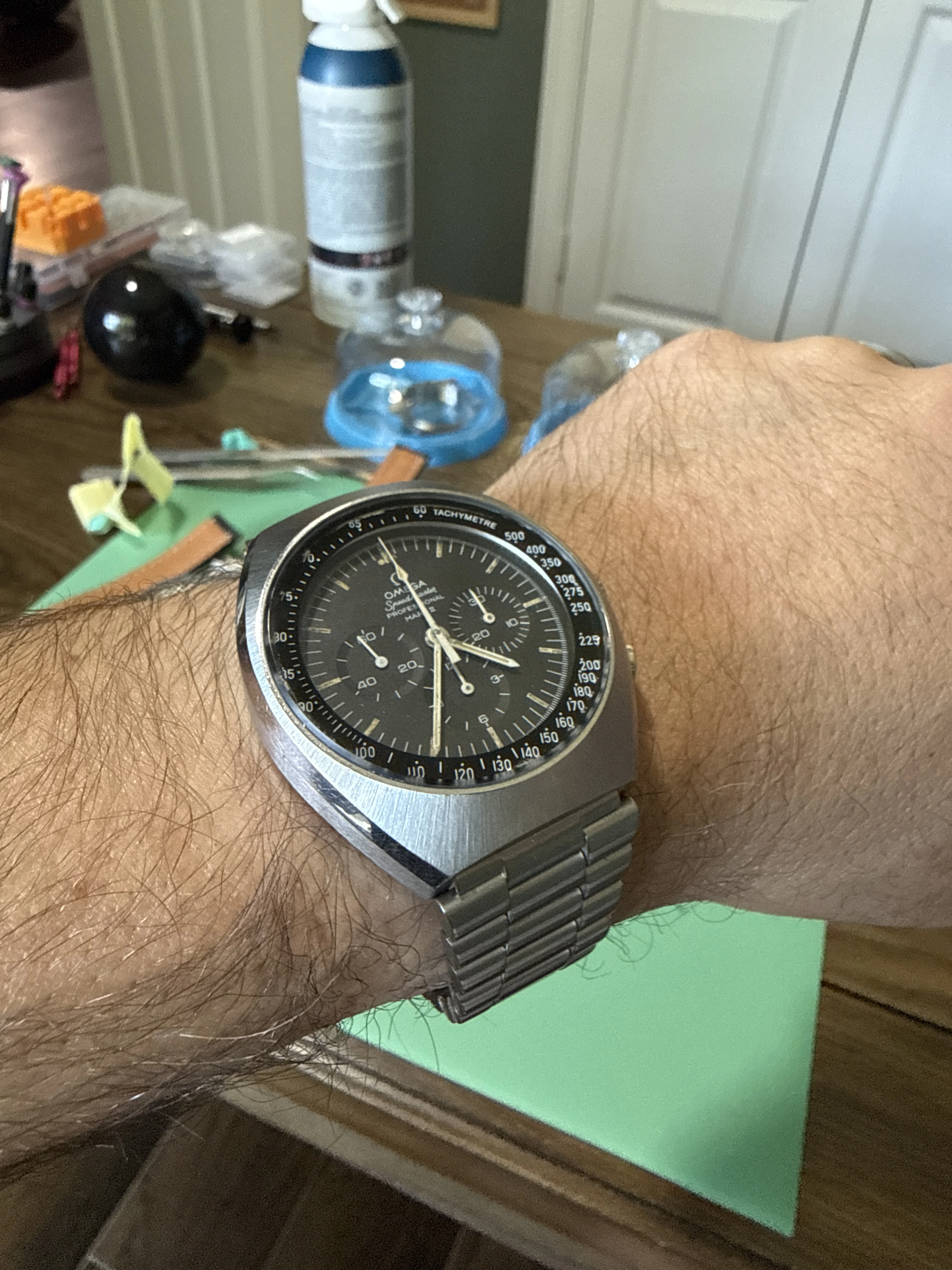

I noticed the crystal on my Speedmaster MKII is loose. Is there a way to reseated or is that too risky?
30,325
78,262
How long since the last service?

No idea. I just got it. It’s running at -1 sec/day with an amplitude of 270, and a Beat error of 0.2. I think that’s good for an old unserviced movement.
I do think it needs service due to the crystal being loose. And the chronograph reset pusher can be engaged while the chronograph is running. The chronograph seconds and minuets don’t reset but the hours do.
I don’t normally try to reset the chronograph while it’s running, but it did feel funny to me when I was testing the functions and it takes very little pressure to reset the chronograph.
But other than that, it seems like a solid watch. The case is in excellent condition.
I hope that my explanation makes sense.
Thanks!
444
878
that problem can be solved by an adjustment thats fairly trivial during a an overhaul, but I am surprised that its there as there is an eccentric pin to quite easily adjust where the stop lever sits to control the reset pusher feeling as well as stopping the resetting during running. Of course it could be something deeper, but by your description thats where I would be looking first.
For me I would be getting that movement overhauled to see if there are any other issues that perhaps don't show obvious symptoms like this one.

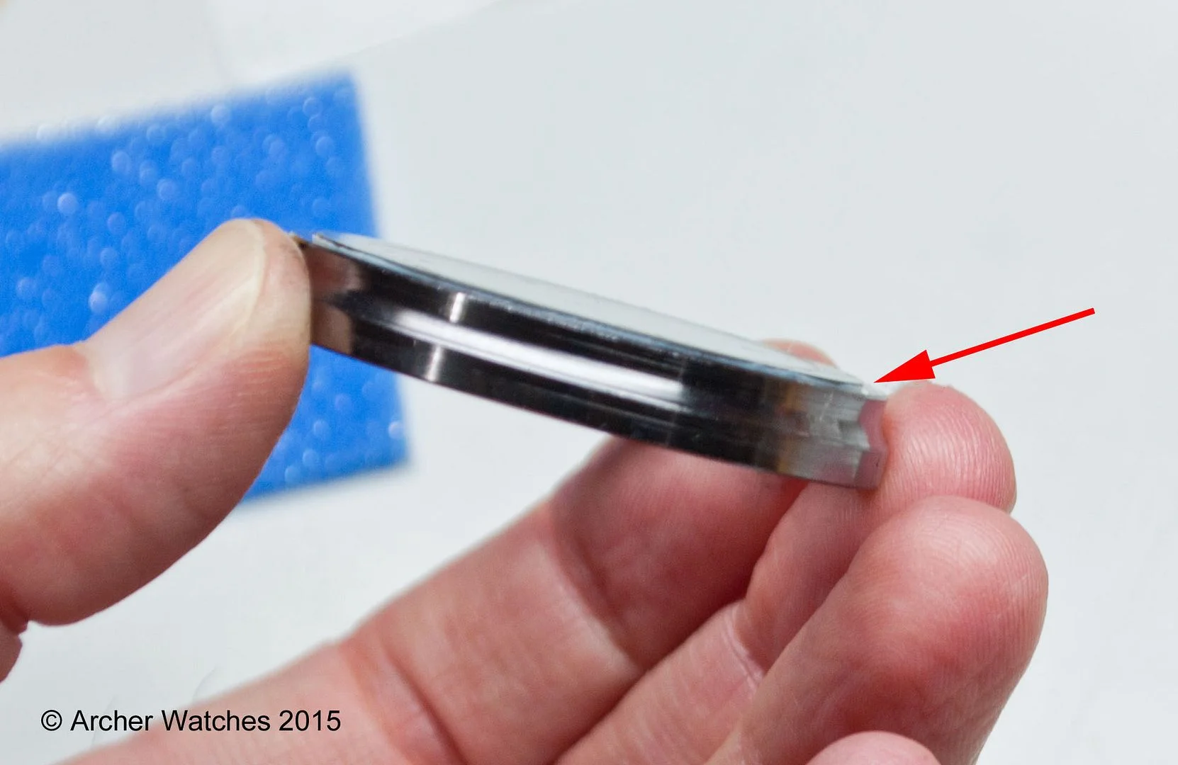

Archer,
I obtained the Omega tool and a crystal and gasket. When you replace the crystal do you do it with the movement inside the case or is it best to remove it? I can see it would be very difficult to alight the tachymeter scale without the dial.
