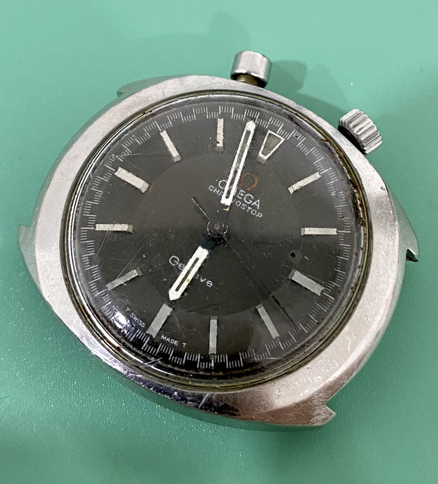

I’ll try and illustrate my point a little better so that my position can be understood.
Here we have a Chronostop driver that I am currently servicing. You can see it’s in bad shape.

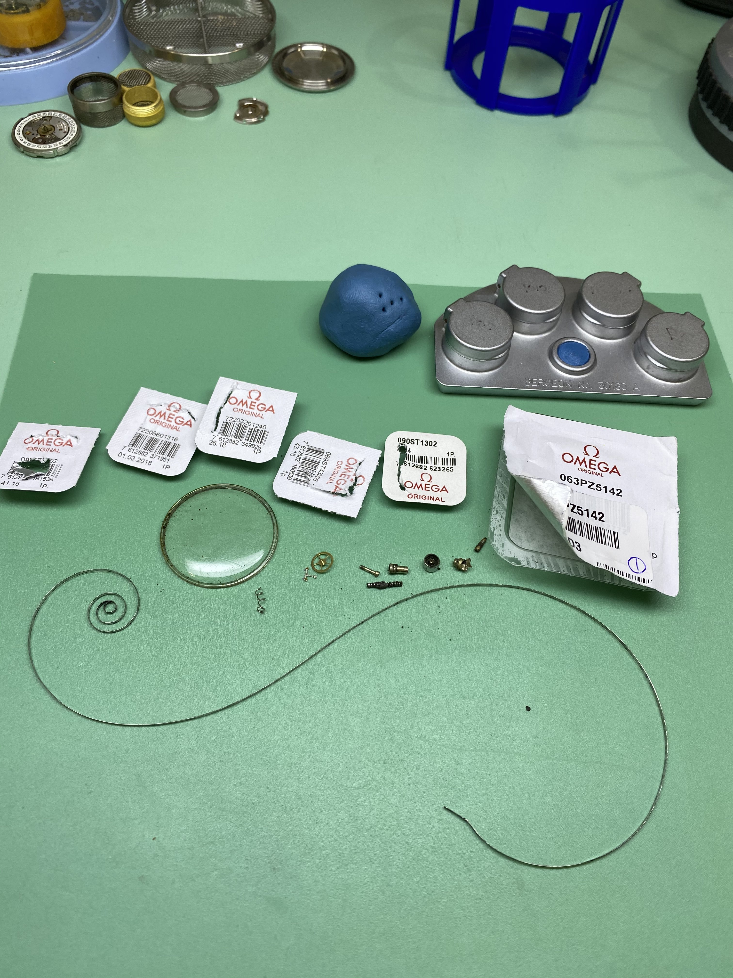

Here are all the parts that I replaced.
A new mainspring was installed, crystal, crown, stem, case tube, complete pusher assembly, springbars, and back gasket. I also changed the pallet fork and third wheel.

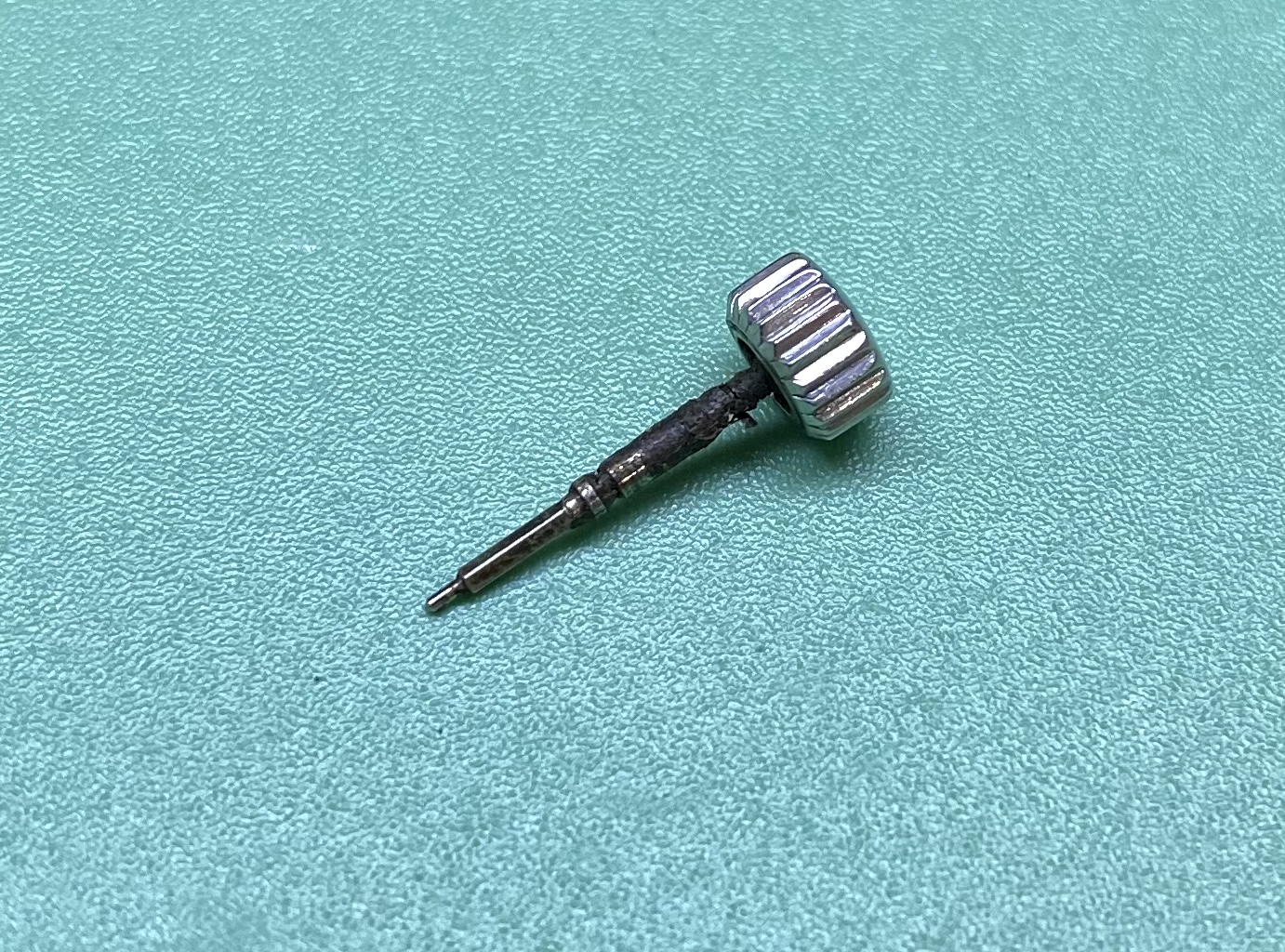

Now, could I have reused this winding stem and received the same timing results?
The answer is yes. Would anyone in this forum think it’s right to reuse this winding stem as is? I highly doubt it.
Let’s take the crystal, crown and pusher out of it. They could have been reused and the customer would have saved some money there. What about the mainspring, third wheel and pallet fork? They needed replacing and that wasn’t an option.
Why not? The watch would have run at a sub par performance level - one that I, and (insert generic brand here) would not have deemed appropriate.
The watch would have run and in fact it would have kept time fine. The customer may have never known and thought I was a fantastic watchmaker if I hadn’t have changed any parts. But what did you pay me for? You paid me to service your watch. I bet you never thought you were paying me to do my job at a 50% level. You thought I would put 100% into my work. And rightly so. That’s what we all expect.
Now from a selfish point of view. What if that watch stopped? Started to perform at a sub optimal level. You bring it back and I say it needs new parts to work properly. You now wonder why this wasn’t done in the first place. I have to charge you for this as it wasn’t part of the original work order. You want it done under warranty. I refuse. Now you tell all your friends what a bad watchmaker I am and I don’t stand behind my work.
So, I’ll state it again. All watches need parts. I can’t remember the last time I serviced a watch that didn’t. And I service a lot of watches.
