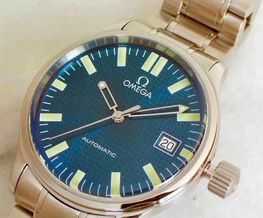

Hi Archer, the Omega Dynamic is an Electric Blue Waffle which I'd never seen before but once I did I had to have it. As it has sat for almost 20 years I think it wise to have it serviced. Runs just a few seconds fast per day. I'm thinking of switching the hands for something a little beefier than the dainty hollow seamaster style it comes with.
I was thinking I may even request Omega offer new hands while it is serviced. Some of these watches have a metal disk inside the caseback as some kind of extra protection? I'm curious about the whole process because I've heard exactly that they aren't too precious about keeping things stock, neither am I really. If they swapped out the electric blue dial I'd probably cry though.
Please post a photo of the watch. Omega won't fit hands on a watch that it didn't come with originally, unless the original hands are no longer available.

I know the watch, it is a little seen Japanse market version of the Gen III dynamic, it has a lot of the subsequent 2255 SMP about it. Pic below, I know what you mean about the hands. I think you should probably leave them be but the Gen III hands would be preferable to me. The metal disk you refer to is presumably an iron anti mag shield. I can't recall if the Gen III has one, the SMP certainly does.

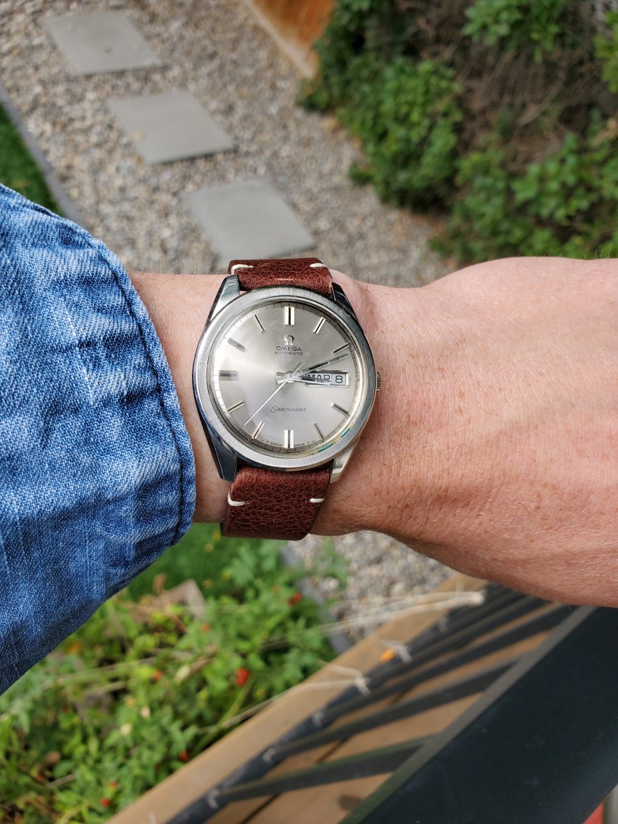

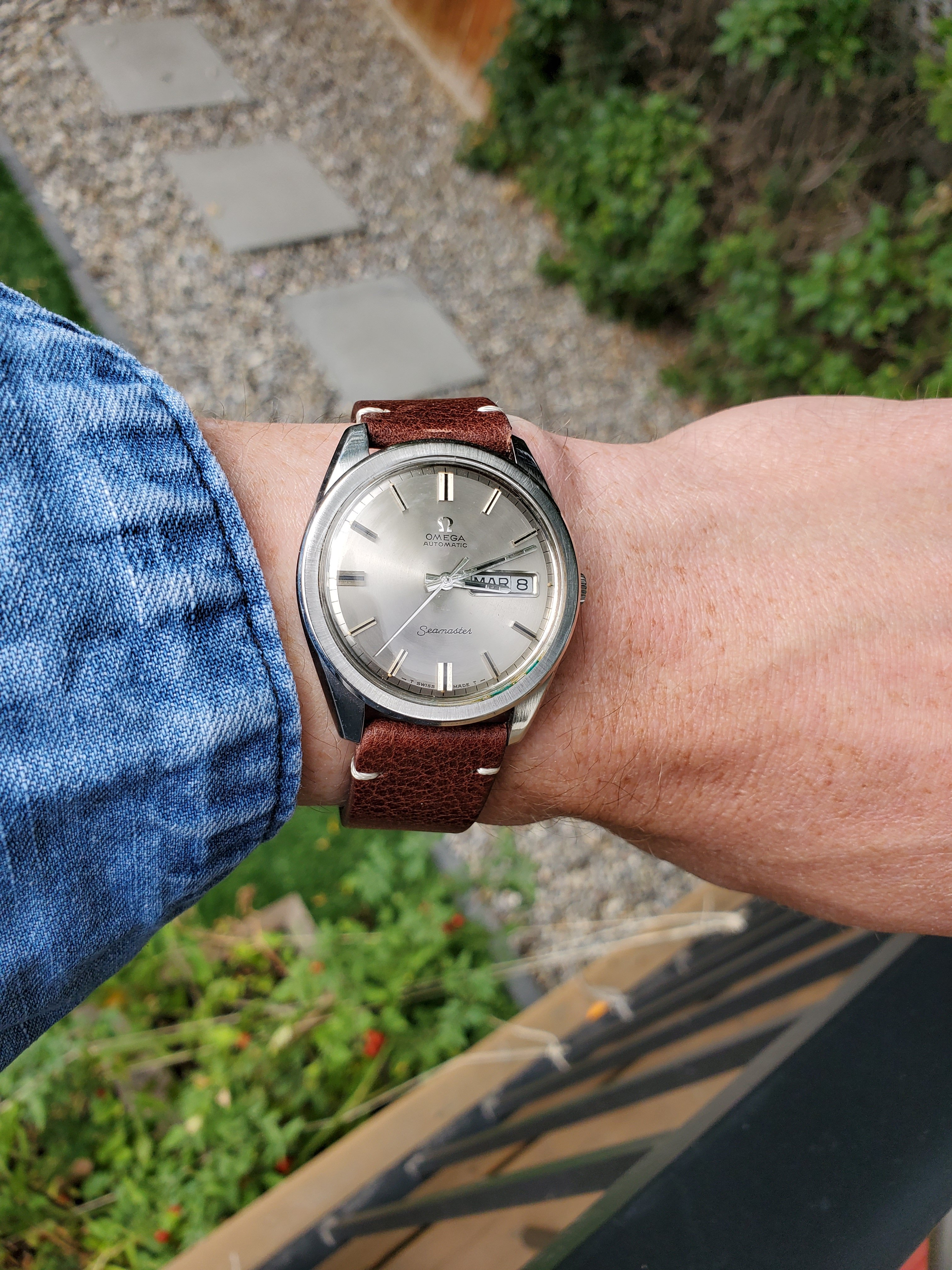

Here's a shot of the watch from when it was received back from service a few months ago. Still humming along nicely!
