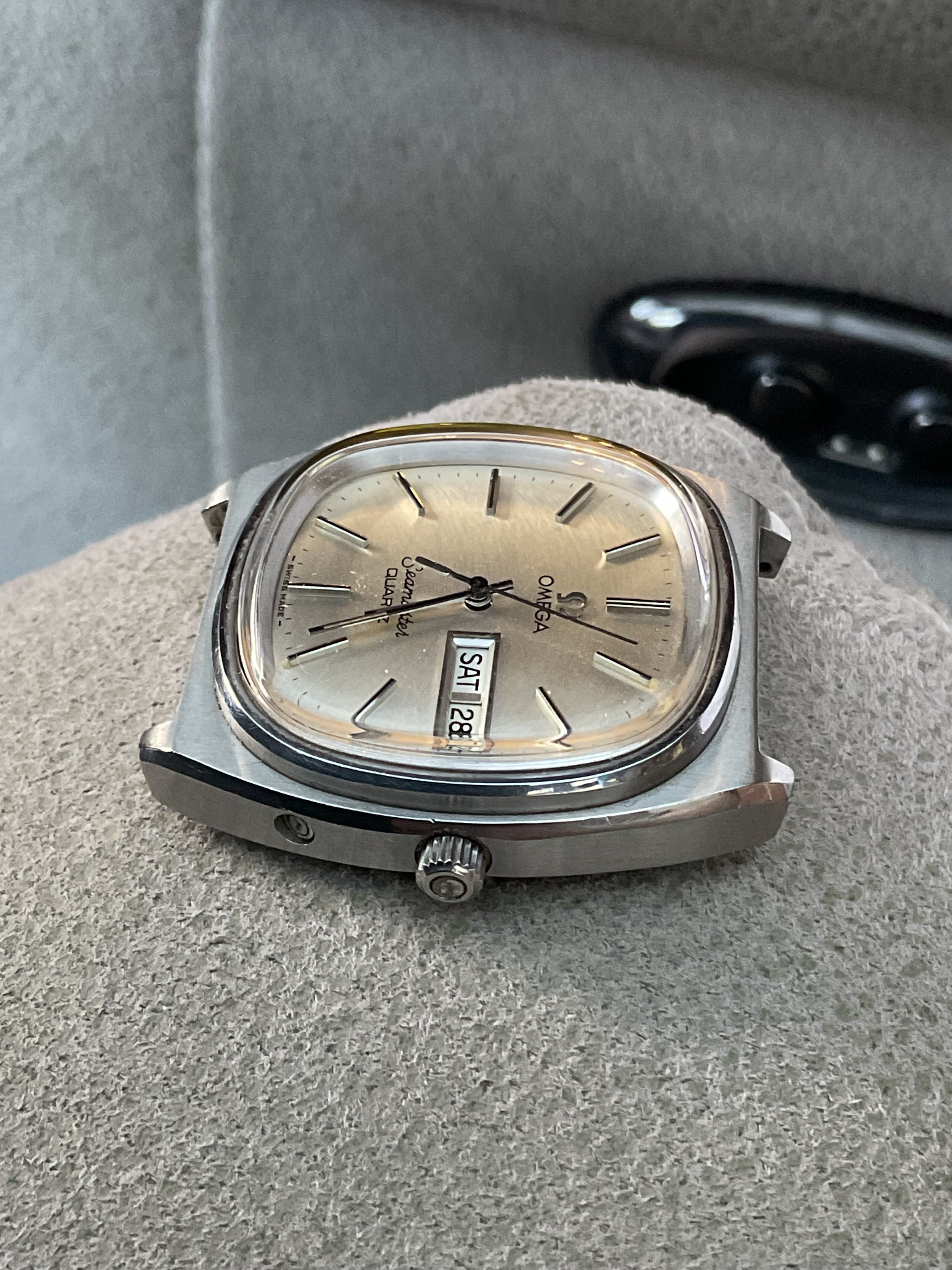

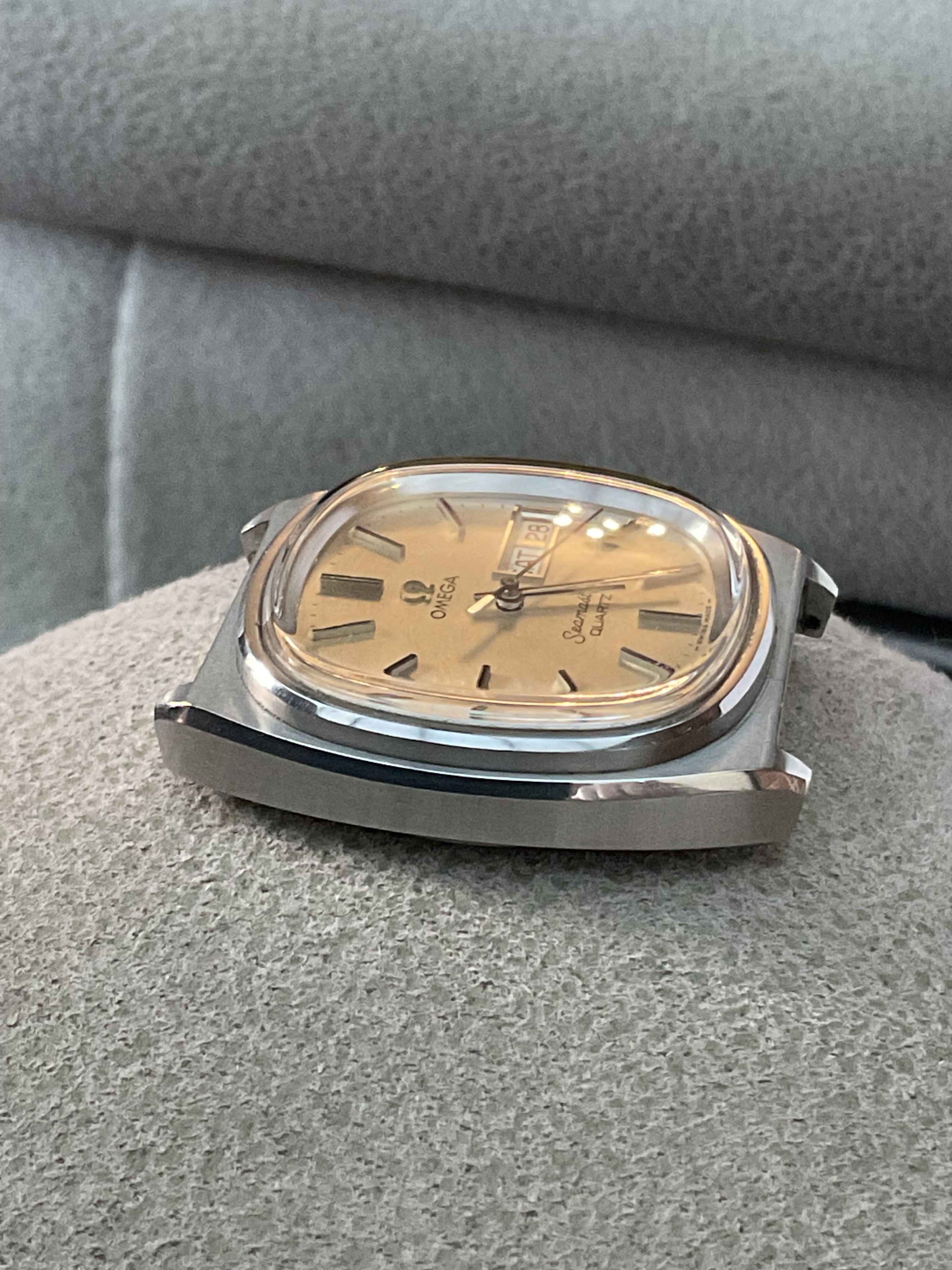

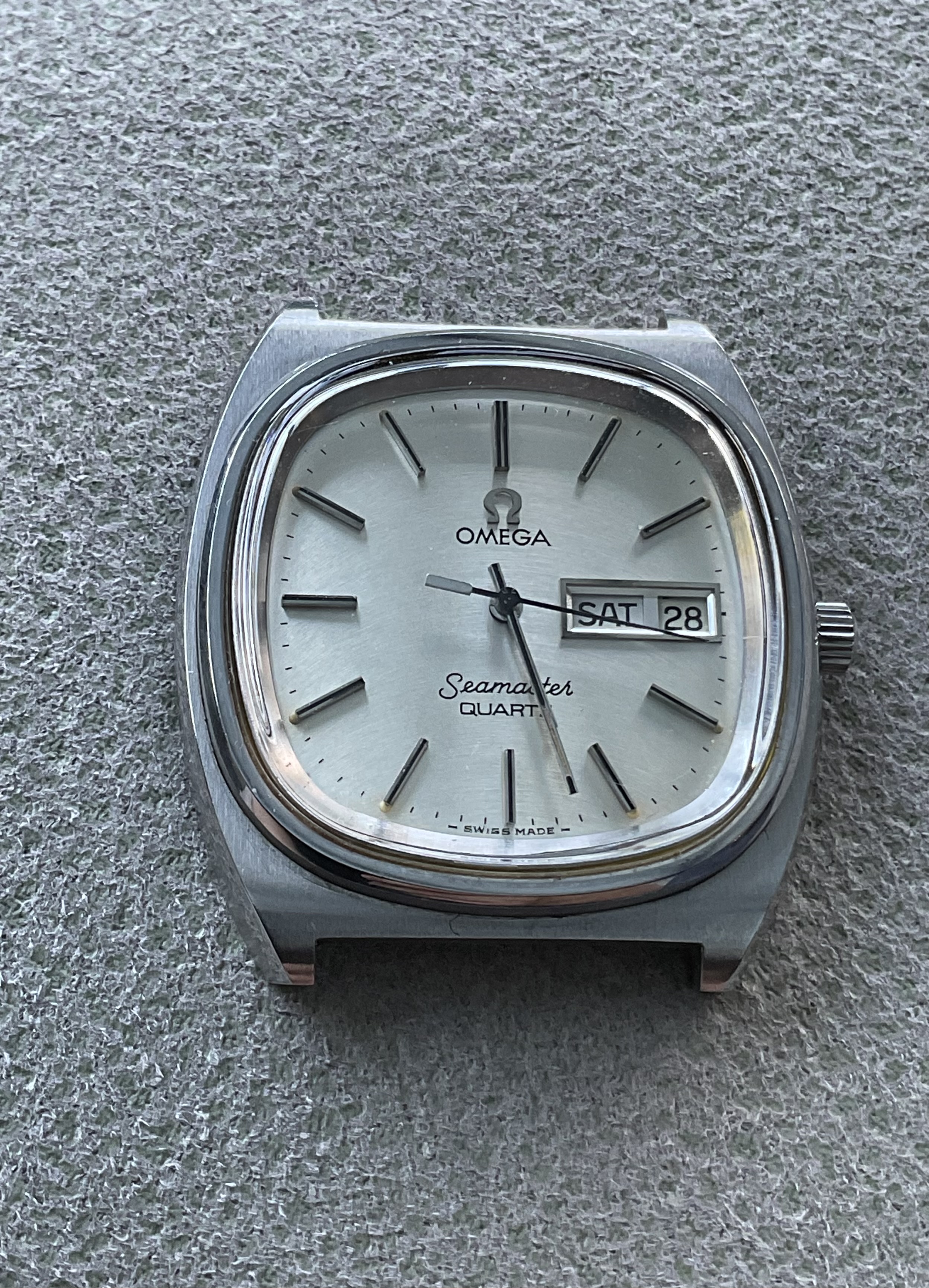

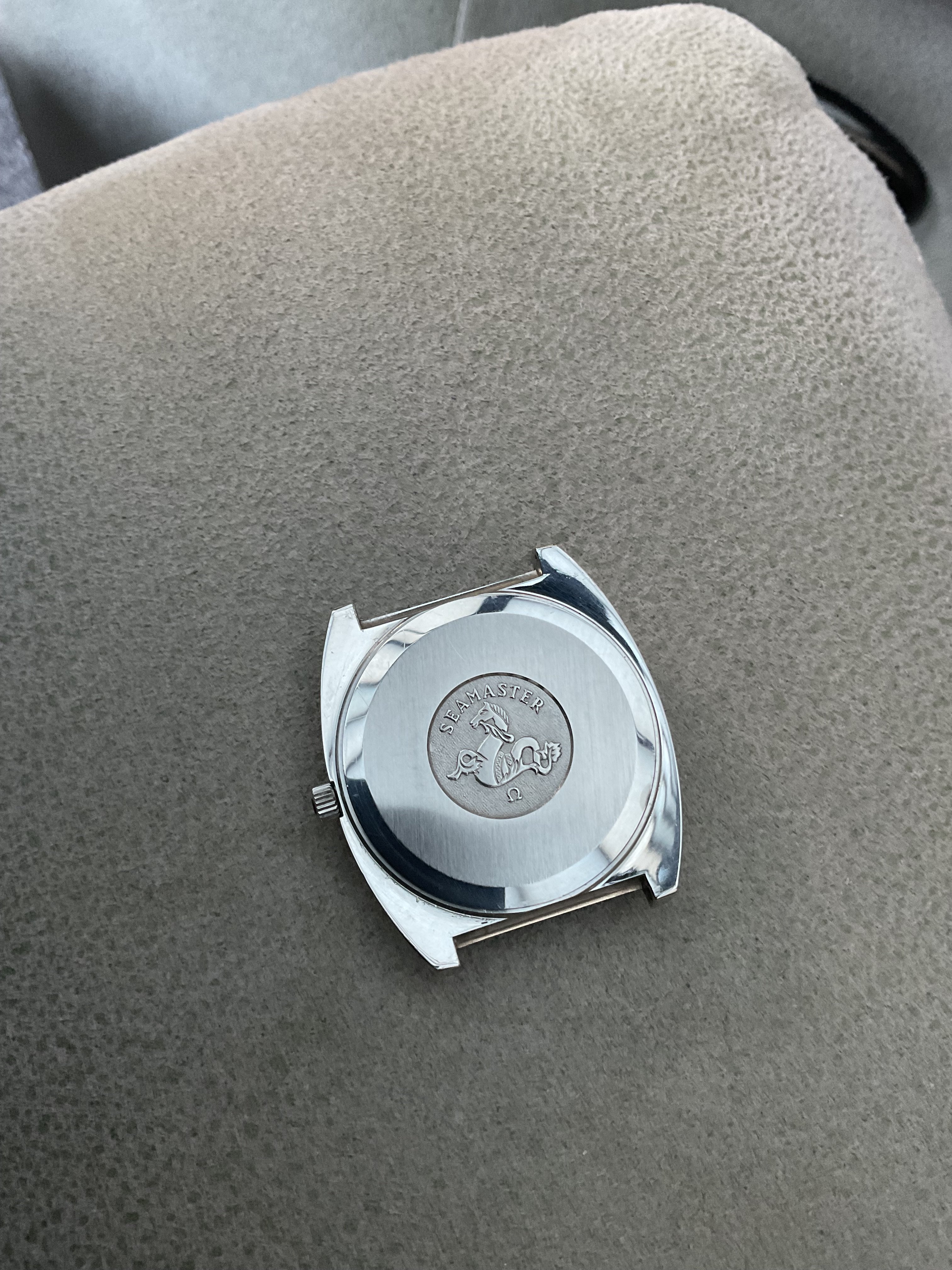

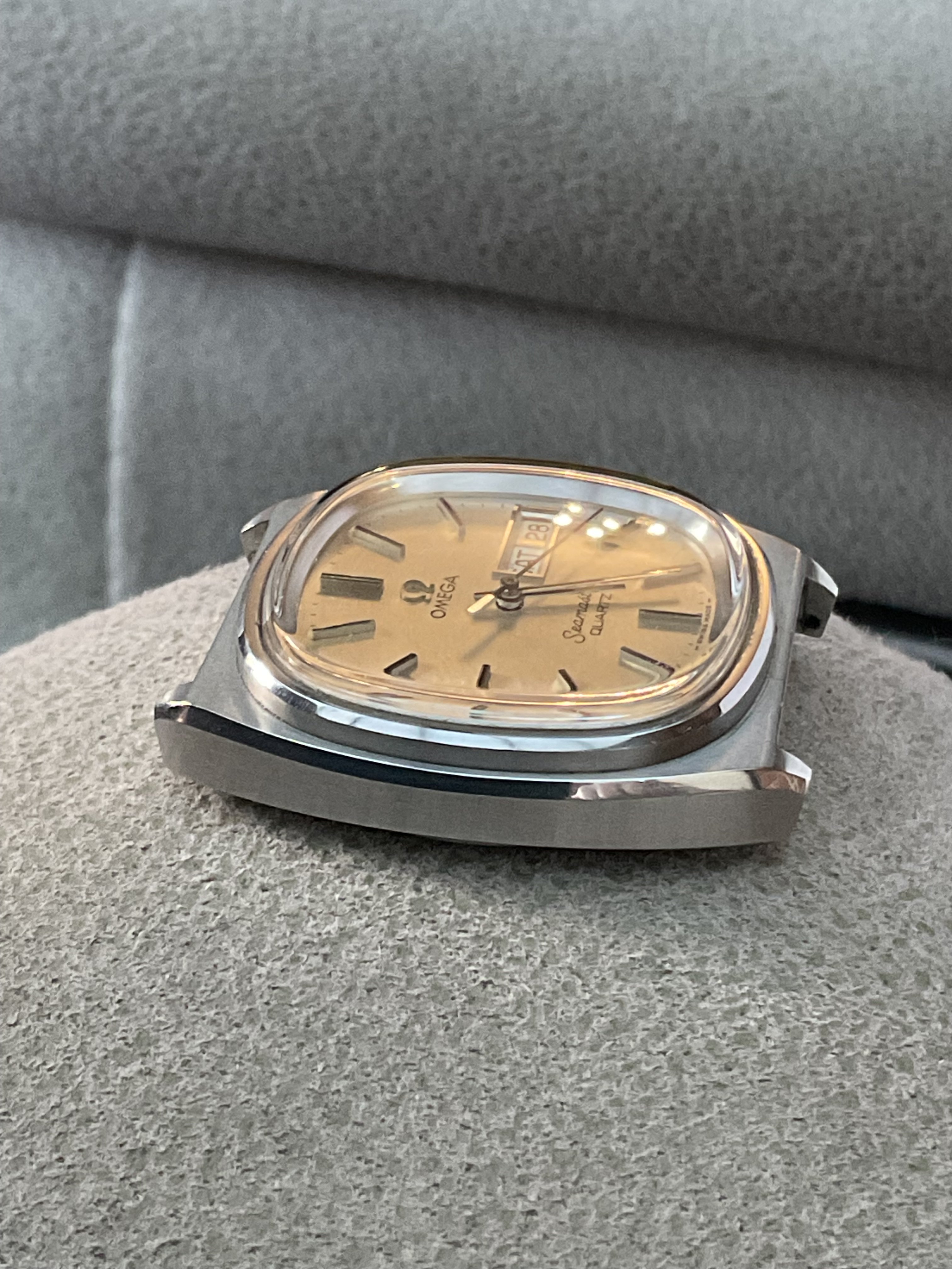

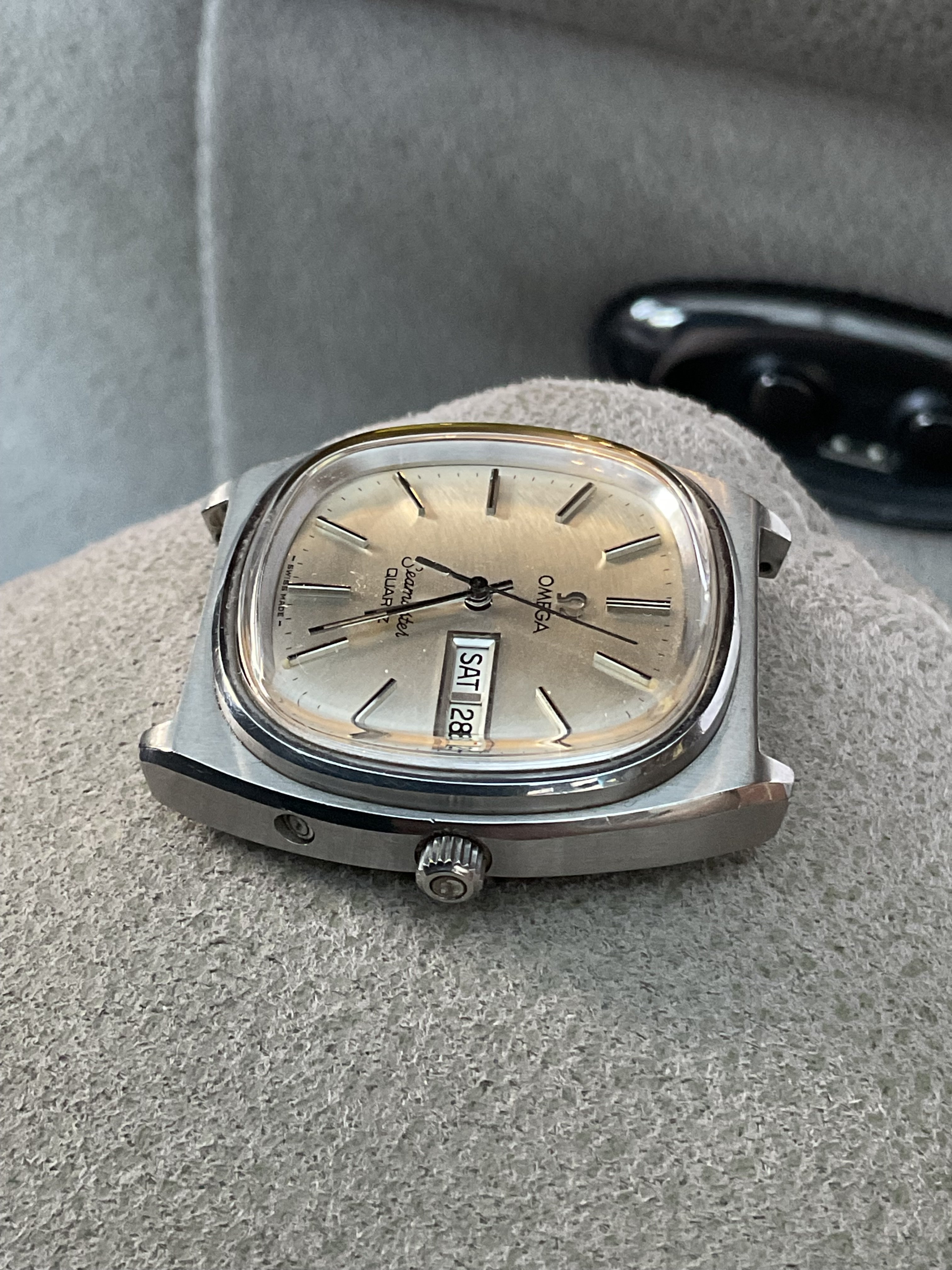

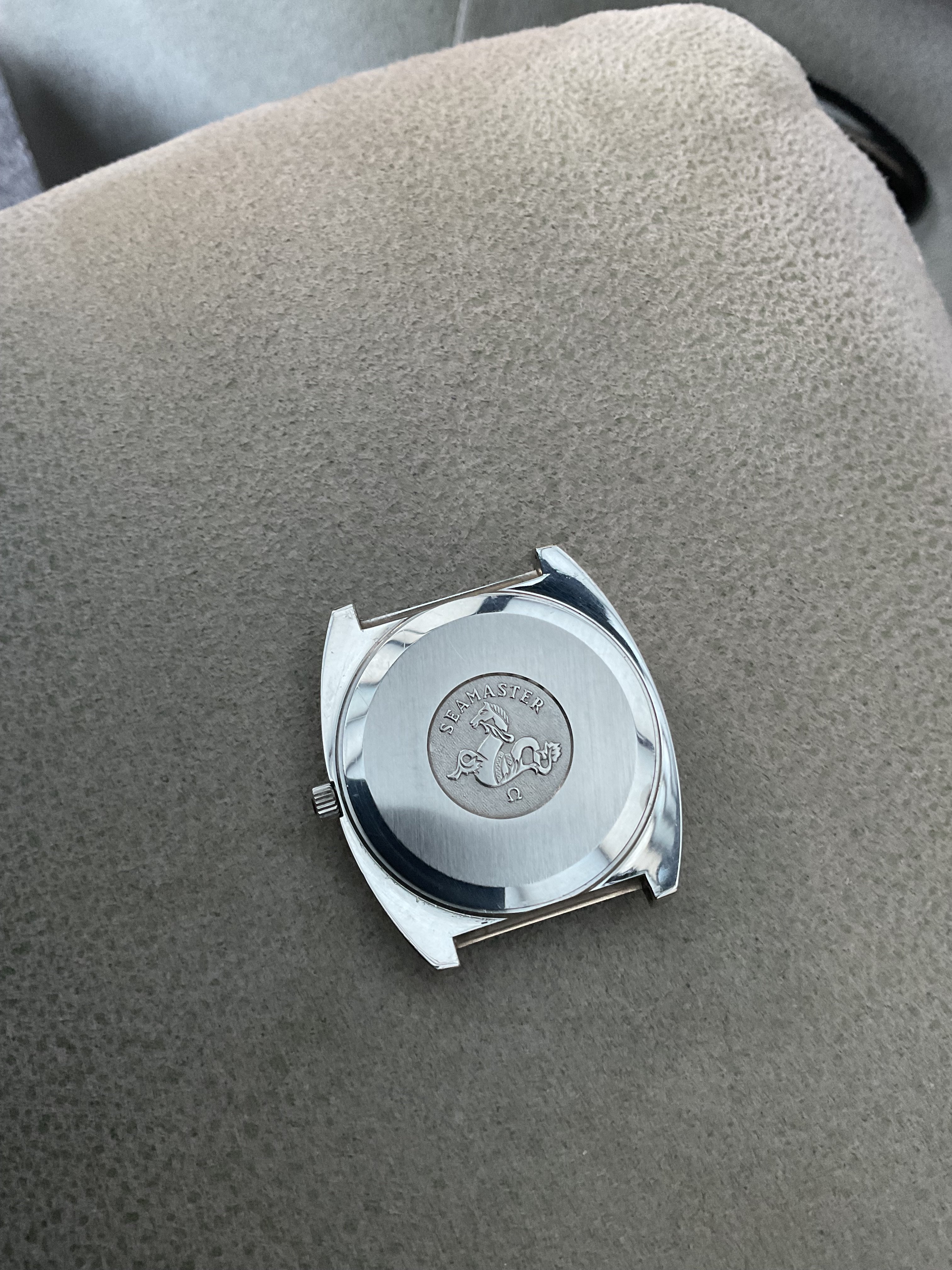

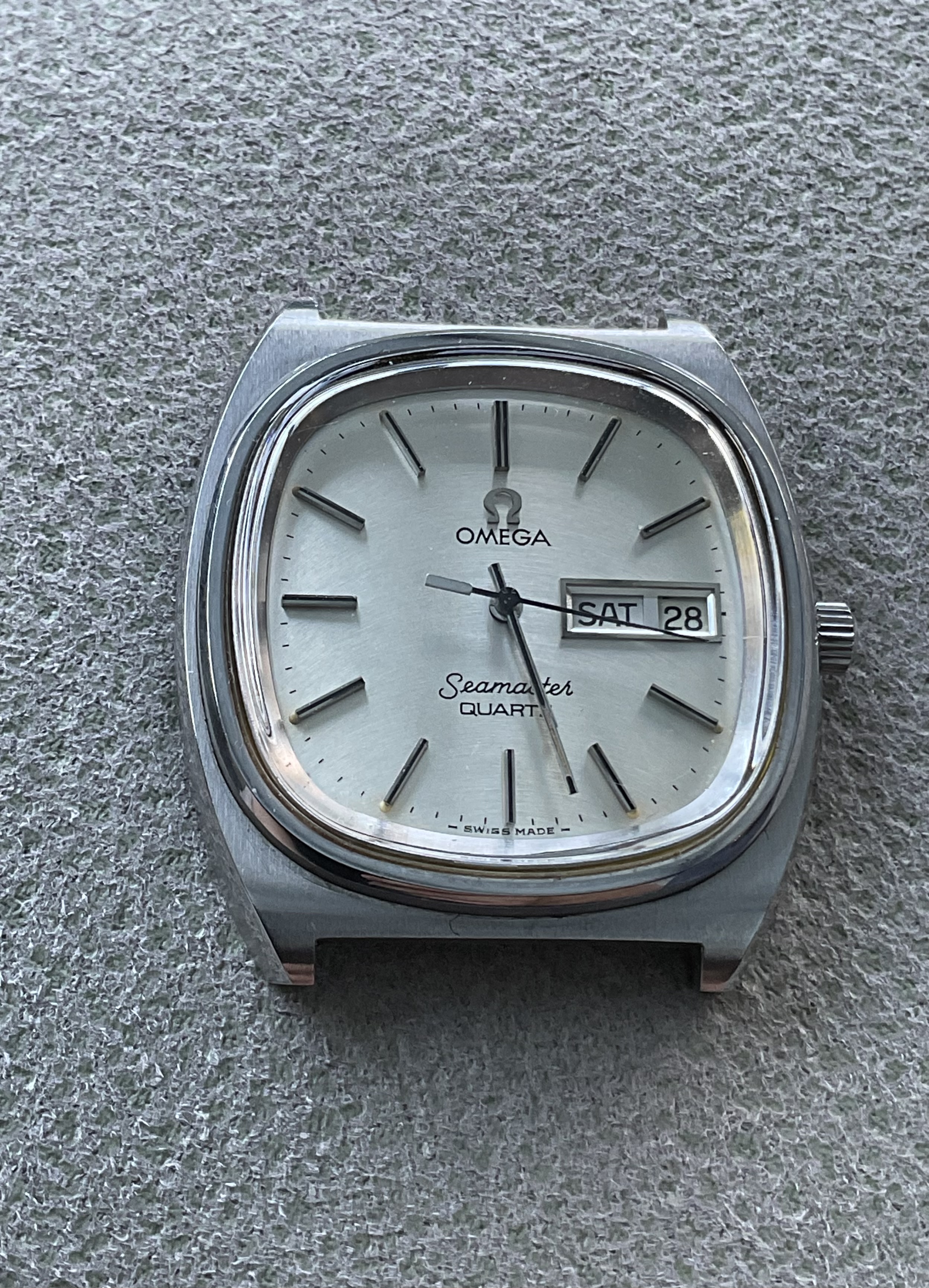

Picked up this as spare and repair with very little information and two pictures, after receiving I noticed two small what looked like droplets of water on the dial that I didn’t/ couldn’t see in the picture after opening the back cover there was like all this grease liquid everywhere under the battery on the back cover on some parts of the movement after removing the movement out of the case it was all around the outside of the dial and the droplets where Also this substance on the dial which smelted exactly like wd40. Unknowing how much has wd40 the previous owner as sprayed all over the movement probably thinking that it was the best thing to do to try and get it working I cleaned as much off as possible without pulling the movement apart to much,I rotated the small coil wheel to check for any small metal fragments magnetised to it 3 other non working watches was fixed just because of this. The smell of wd40 still lingers but after replacing the battery it jumped into life and as been ticking away all afternoon lol . I haven't seen may versions of this day date quarts Seamaster before and it’s actually in amazing condition with original crystal. What are your thoughts ?

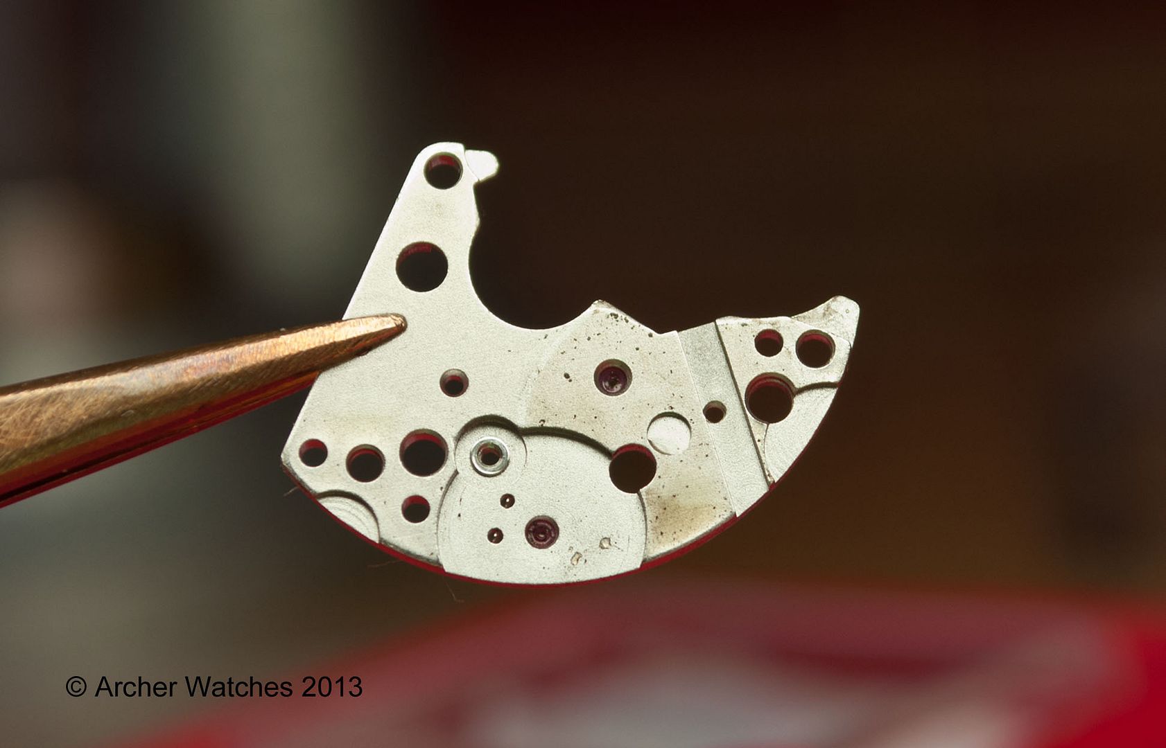

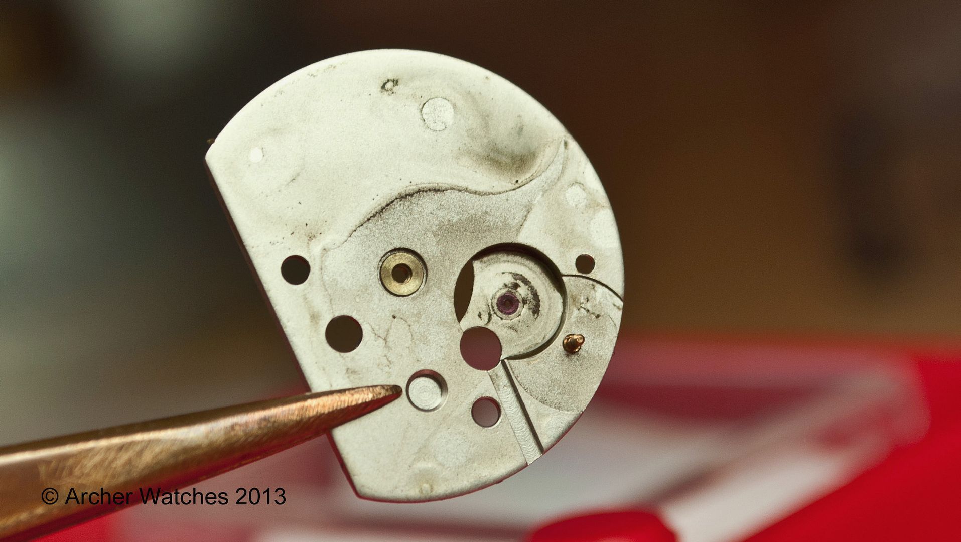

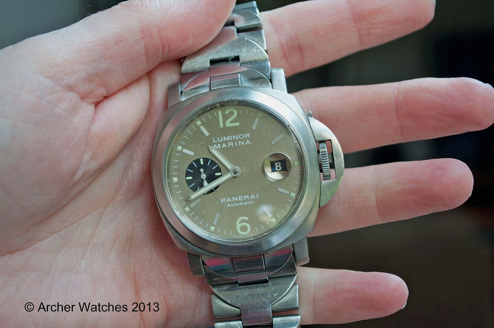

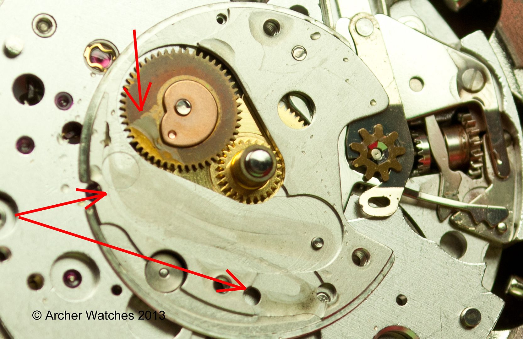

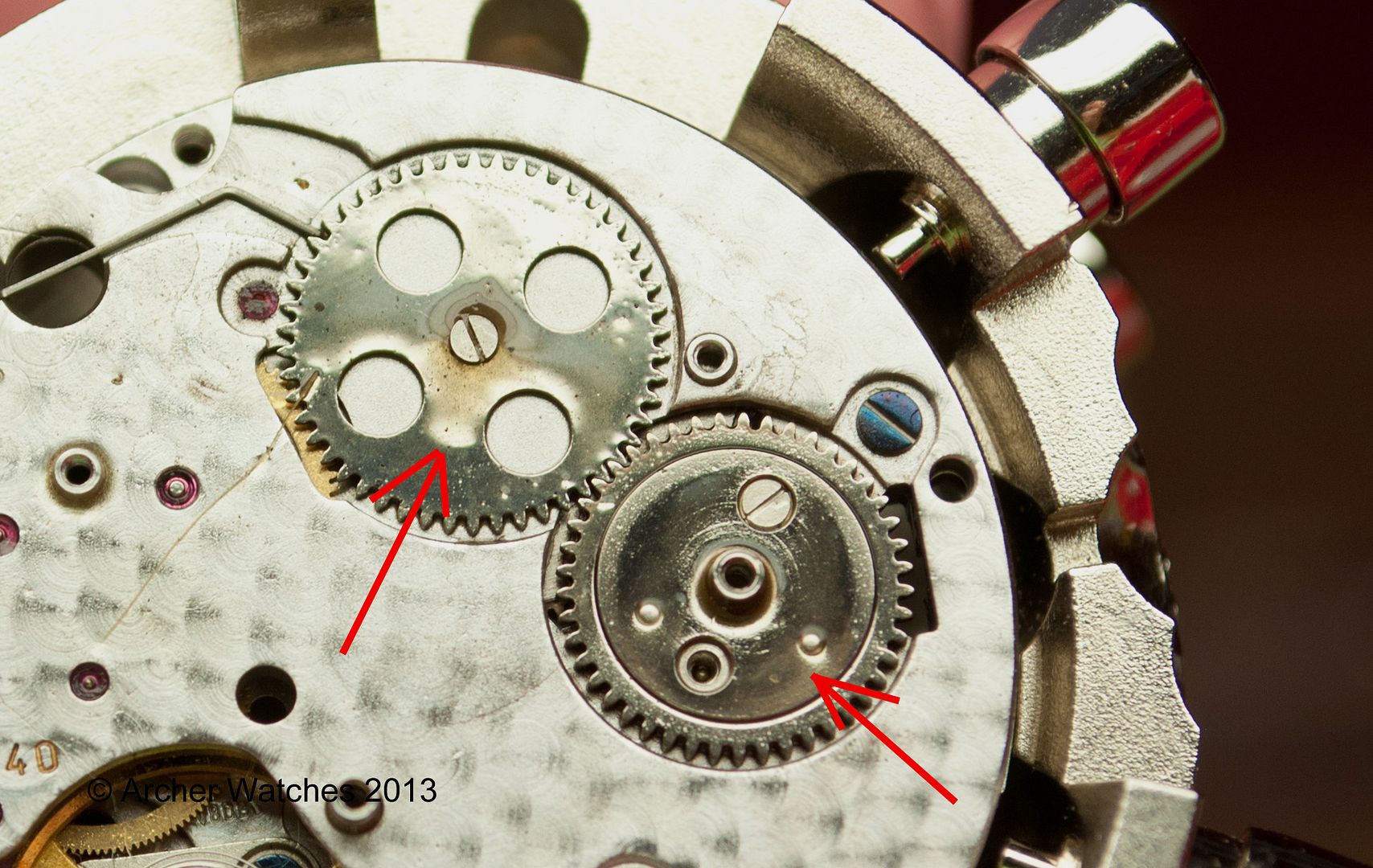

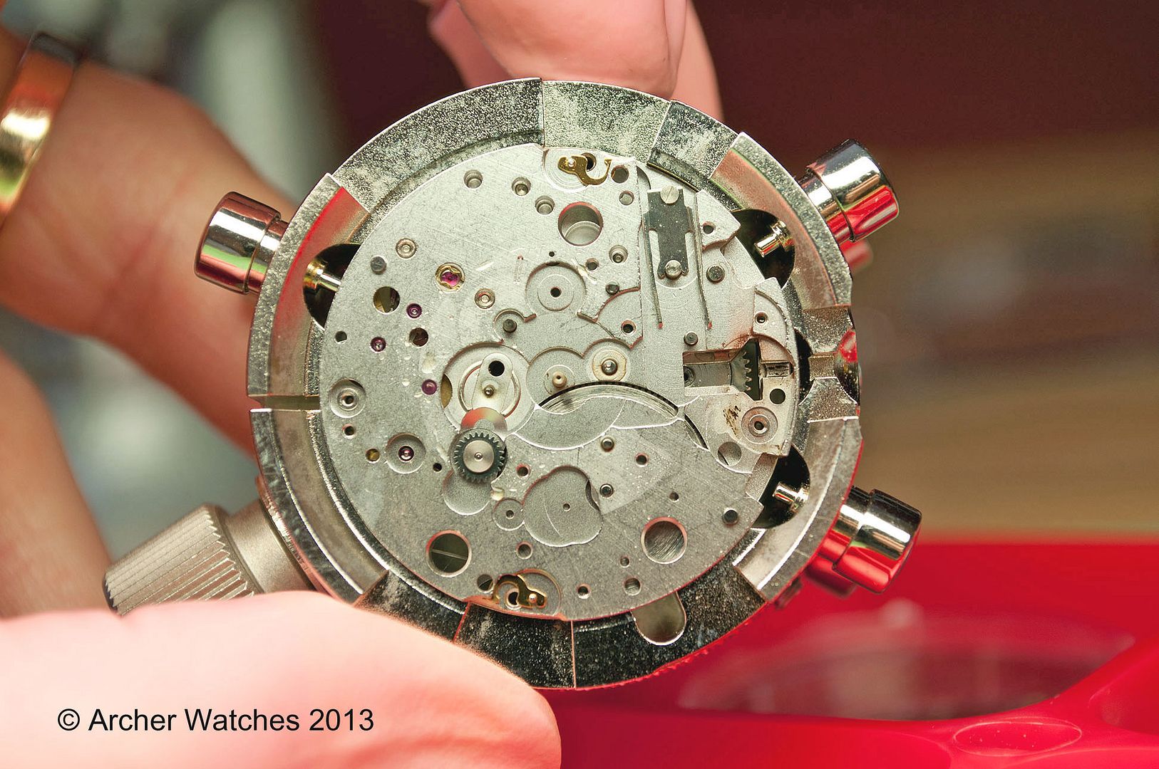

Yep - the smell is unmistakable when you open the case. I had a Panerai come in years ago that had been sprayed liberally with WD40:
Drops on the back of the date indicator:
It was all over:
I cleaned up as much as I could before putting the movement through the cleaning machine, because if I eft it with all that present, I would have had to change the cleaning solutions right away...

I often run into clocks that have been doctored with WD40. I have found that attempting to clean a clock like this in L & R 677 (mineral based clock cleaner) instantly renders the solution useless! My solution is to dismantle the clock and clean it in soap and water to effectively remove the WD40. Rinsed in water, air dry, then clean in L &R 677. If you value the Omega, I’d suggest you have it attended to. The WD40 will eventually turn to a substance with the consistency of tar, effectively gluing the watch together, rendering it irreparable! Last experience I had like this was a Waltham 23-jewel Vanguard with winding reserve indicator. This would be a nightmare for a novice to service properly. So they shot it with WD40. You’d have had to see the mess to believe it!

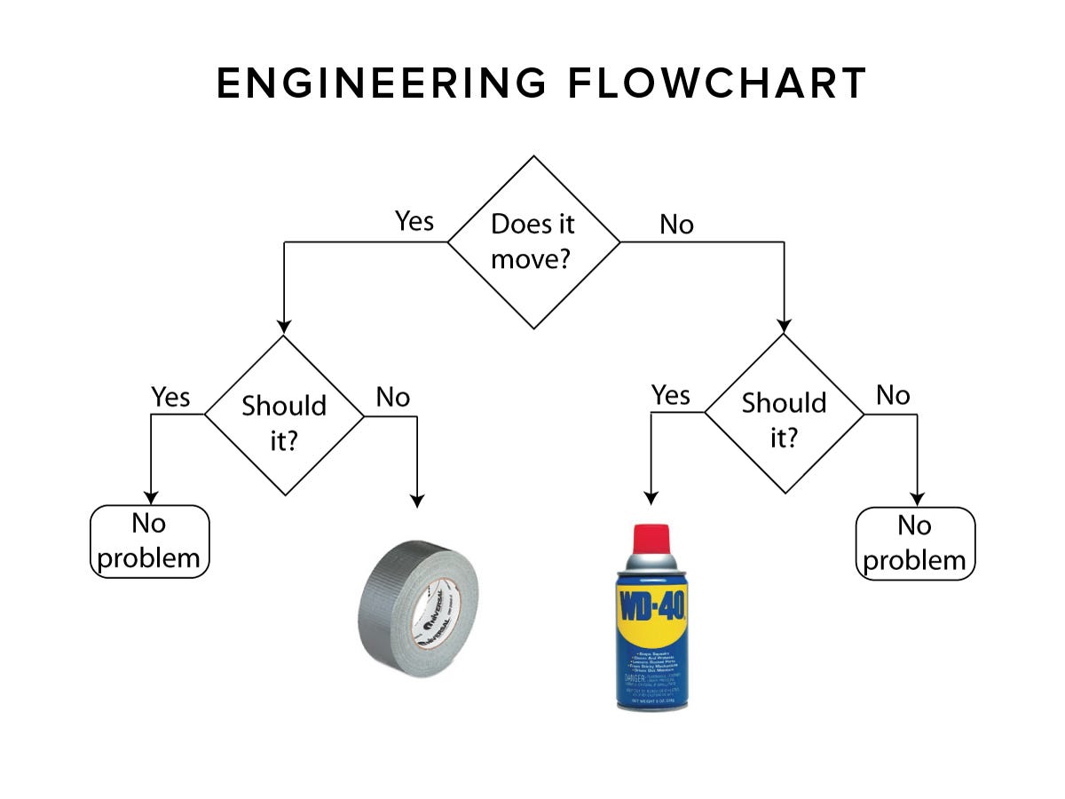

"If it moves duck tape it, If if does not move use WD-40."
LOL … I used to work with a guy whose description of his time in the service was, “if it moves, salute it. If it don’t move, paint it.” He got out as a master sergeant, so he must’ve been onto something.

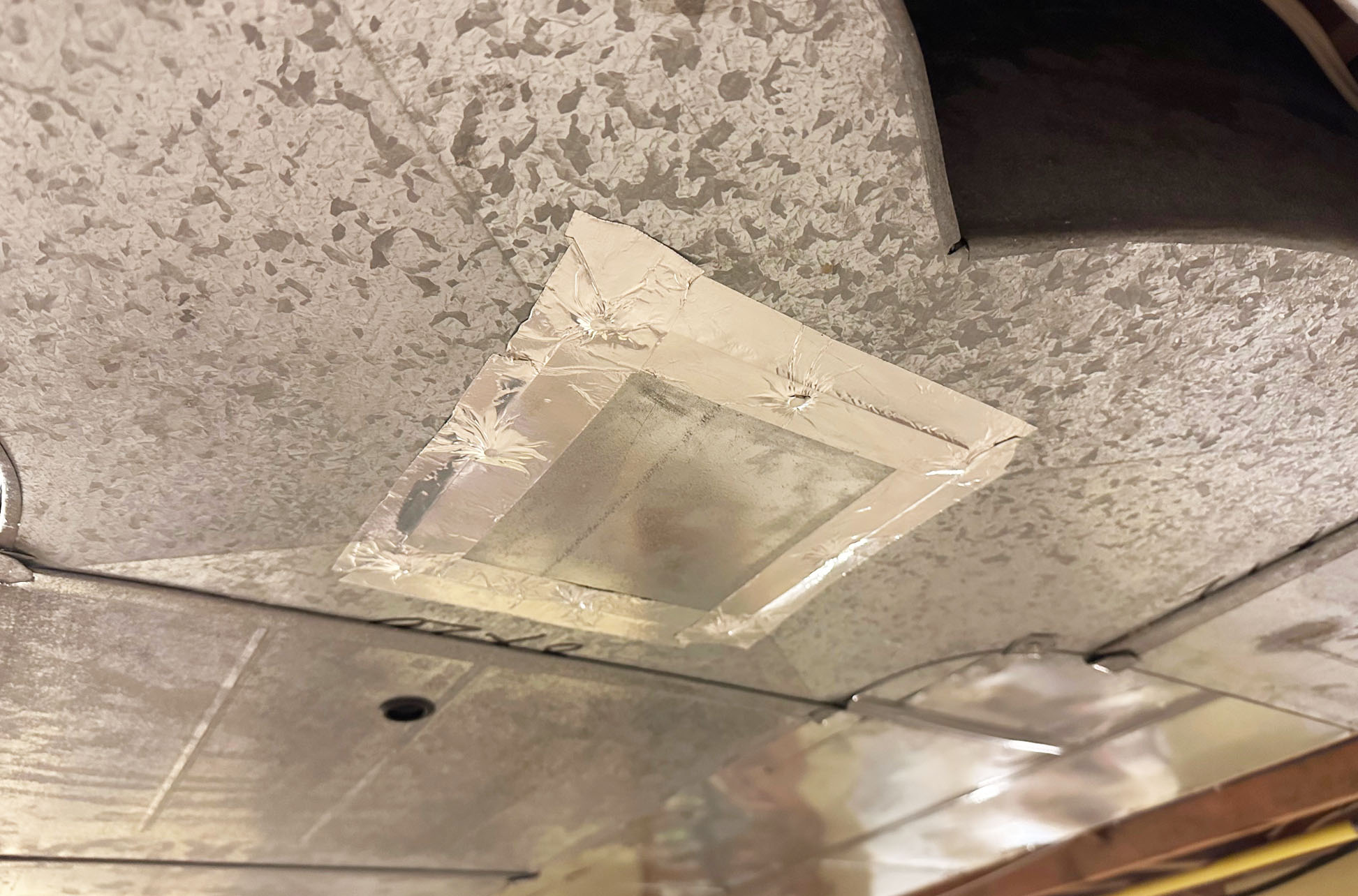

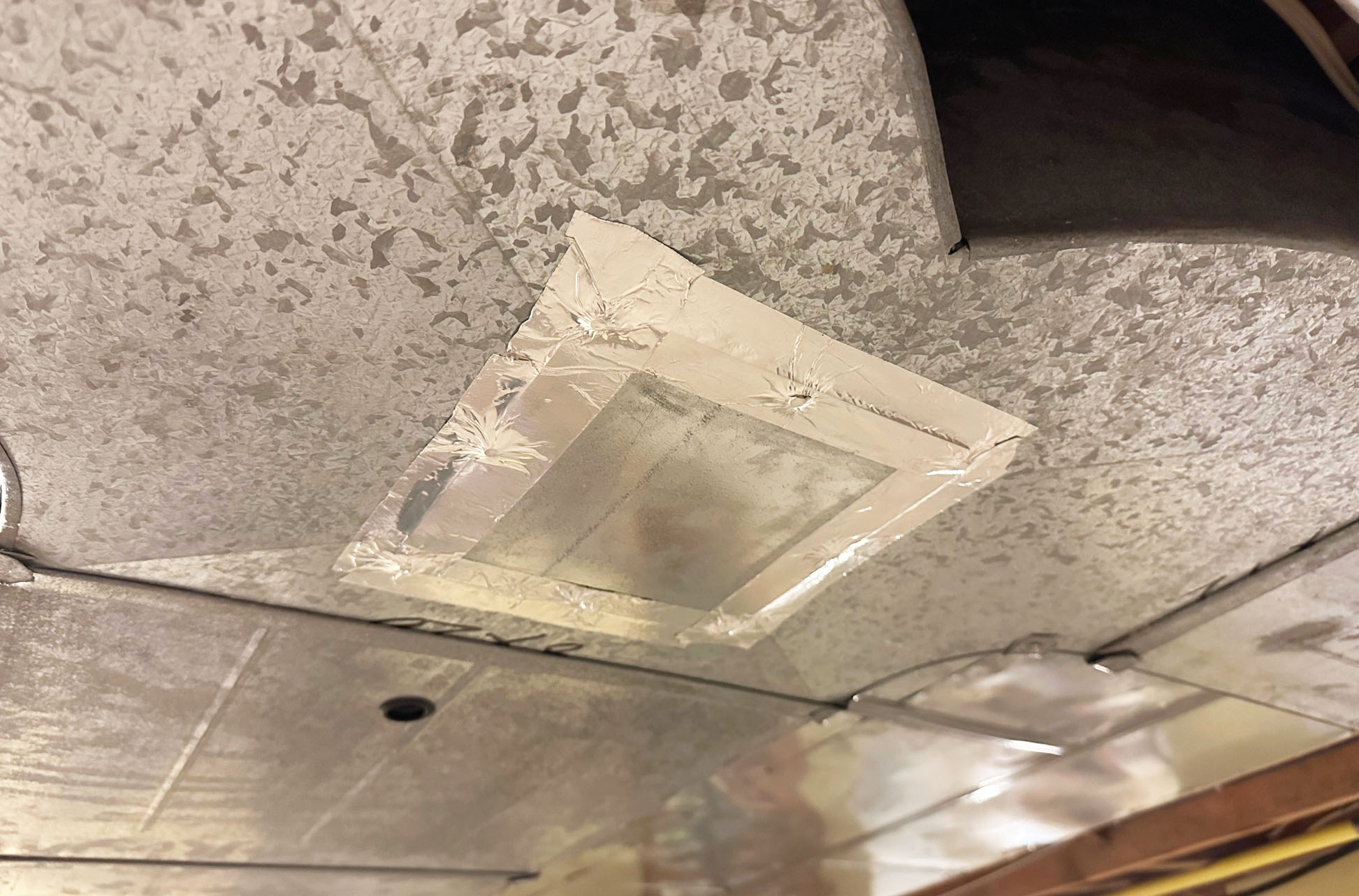

Duct tape. Used by HVAC technicians to seal joints in ducting. No cloth backing, but flexible vinyl or plastic to effect a proper seal at varying temperatures.
Or, there's real duct tape...
