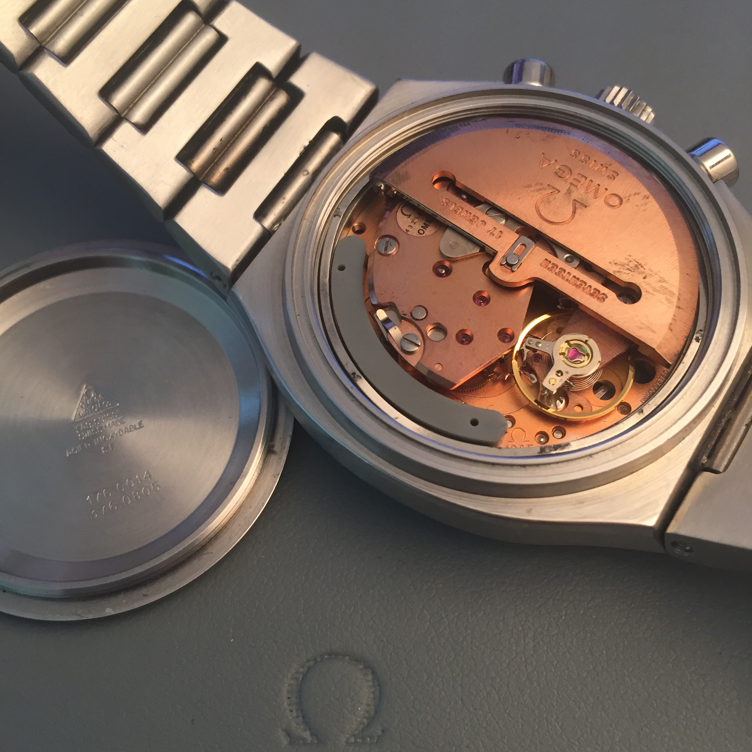

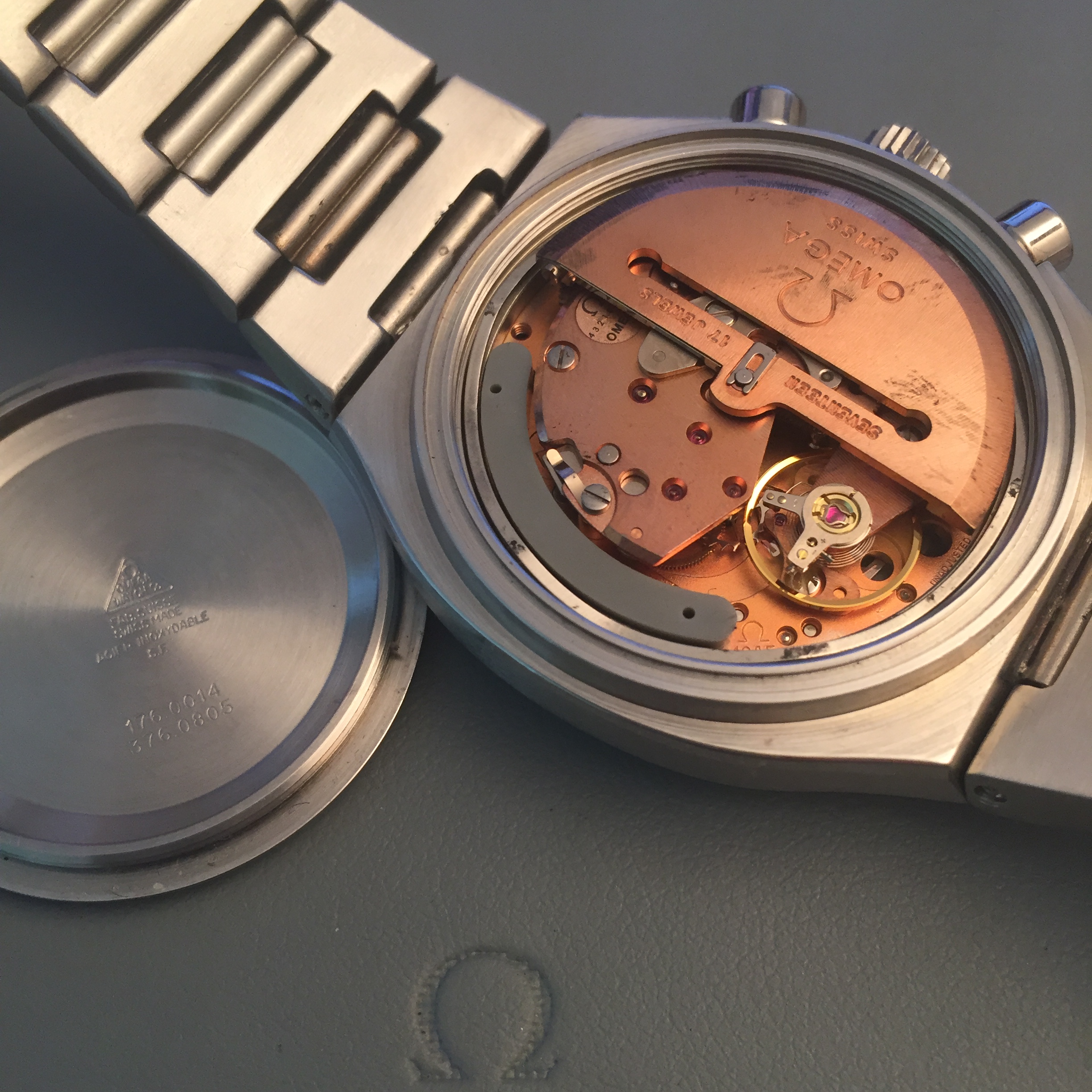

Do you know who the case maker of yours was?
Looks like GF. Guy Freres? This is the only picture I can easily find of the caseback, from when I bought it in 2016 from a forum member.

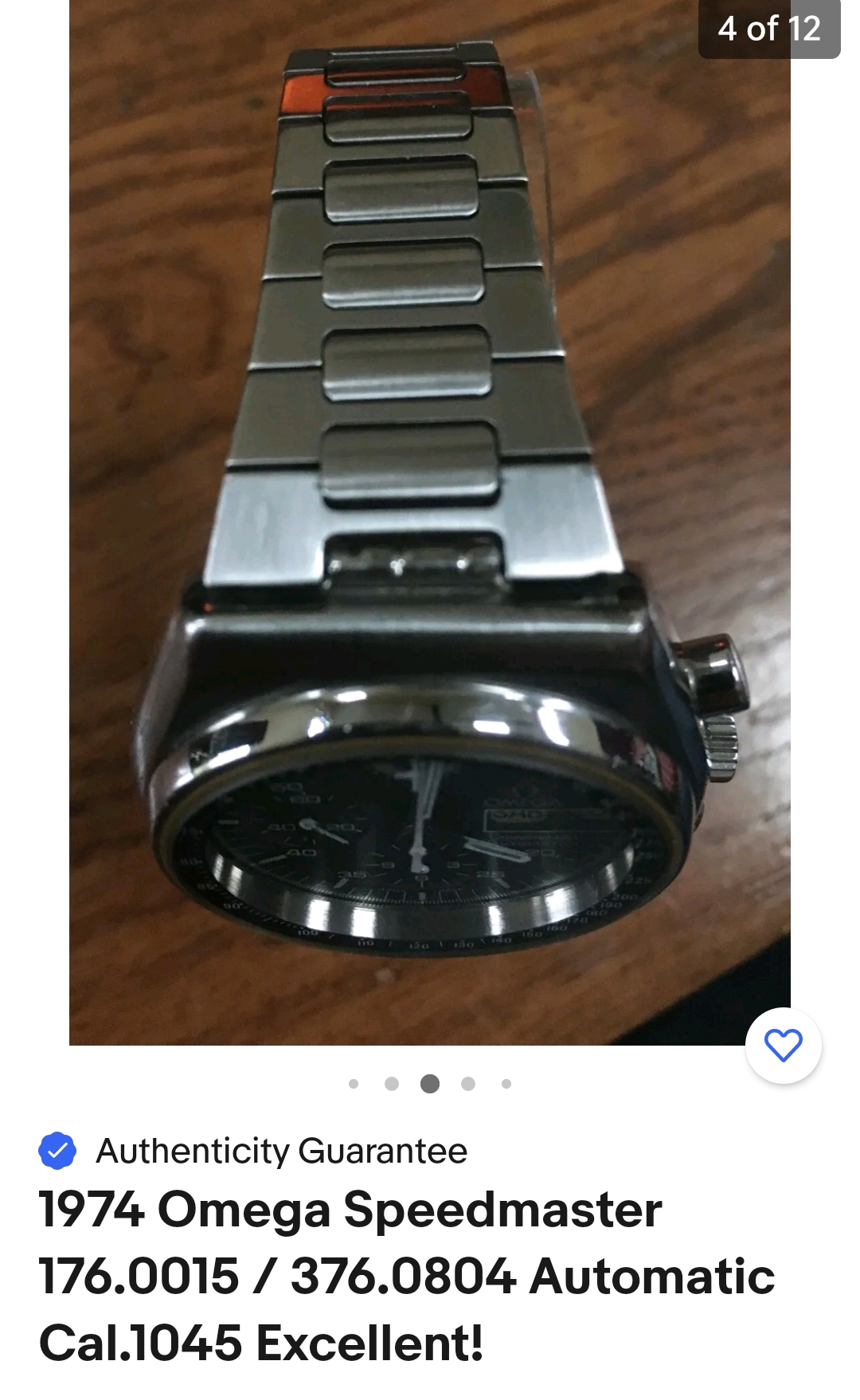

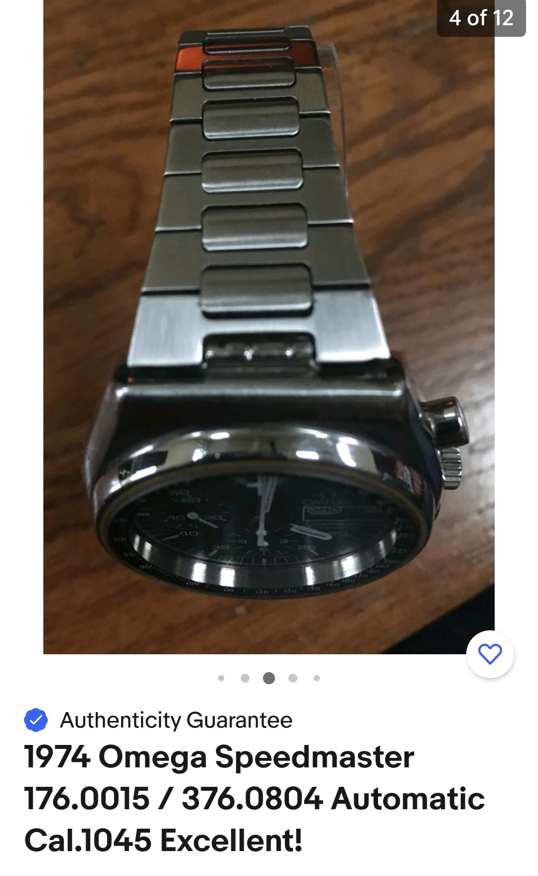

I spotted this example sold having an HF case. Looks well worn so probably not a replacement case, and appears to have unpolished case bevels. Clicking on a photo allows you to scroll through 11 higher res photos. It lends credence to the case in question's possibility of validity.
https://watches83.com/en/vintage-om...-watch-ref-1760014-cal-1045-spectacular-.html
I understand the reasoning that this is an unlikely case to fake - I get it and agree. This was one of the points I actually argued in another discussion about a unique Bulova Marine Star chrono that was questioned in another thread, with one prolific poster yelling and deriding me claiming it was fake. Here's the thread if you care to read: https://omegaforums.net/threads/thoughts-on-bulova-one-star-marinestar-val-7740.88217/
In spite of the details of this HF case and what my watch makers opinion is (which I highly respect) I remain ambivalent about whether these are fake. If someone were to come forward and relate that they had their watch serviced by Omega and it came back with this case, or the seller, on his deathbed, admits "yeah, those were fakes I was selling. Sorry.", or someone is the original owner or has confirmed provenance of a watch with this case and it's still in unmolested condition we'll probably never know for sure. My photos may just show the difference in details and quality between 2 different cases Omega used for the 176.0014. At least a good reference.

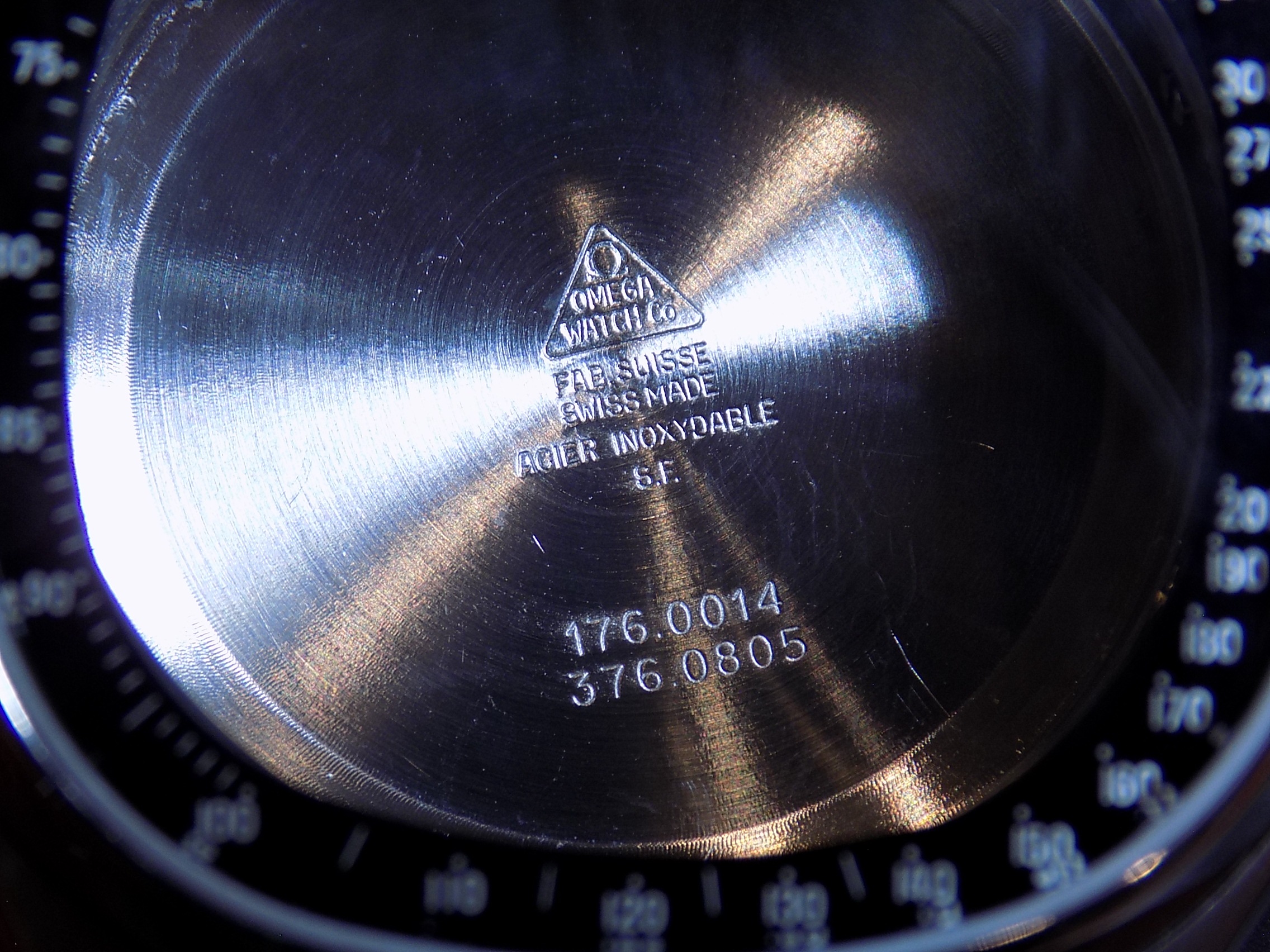

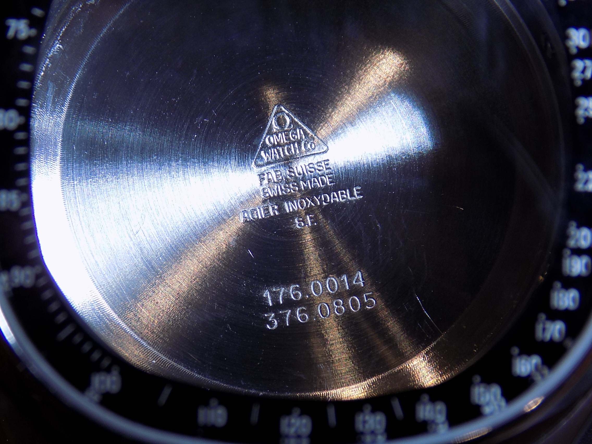

.... Original case but not from the period of the watch as been build , my extract of the mark V TV says 176.014 that means the case back as this as engraving .
Your extract may say that, but you'd be hard pressed to find one stamped as 176.014. I've never seen a photo of one. Even those listed for sale or elsewhere as a 176.014 that have a photo of the inside of the case back will actually show 176.0014. If you look through Chuck Maddox's articles you'll find that he refers to it as a 176.0014, as well. But I agree that this case isn't a production of that time period.
