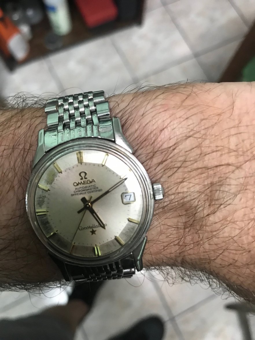

Are these hands original?
3
Clearly a novice to Omega vintage, and I am starting to look for a Constellation pie pan. I just got offered this one, and I'm pretty sure these are not the original hands. Can someone please confirm? Thanks.

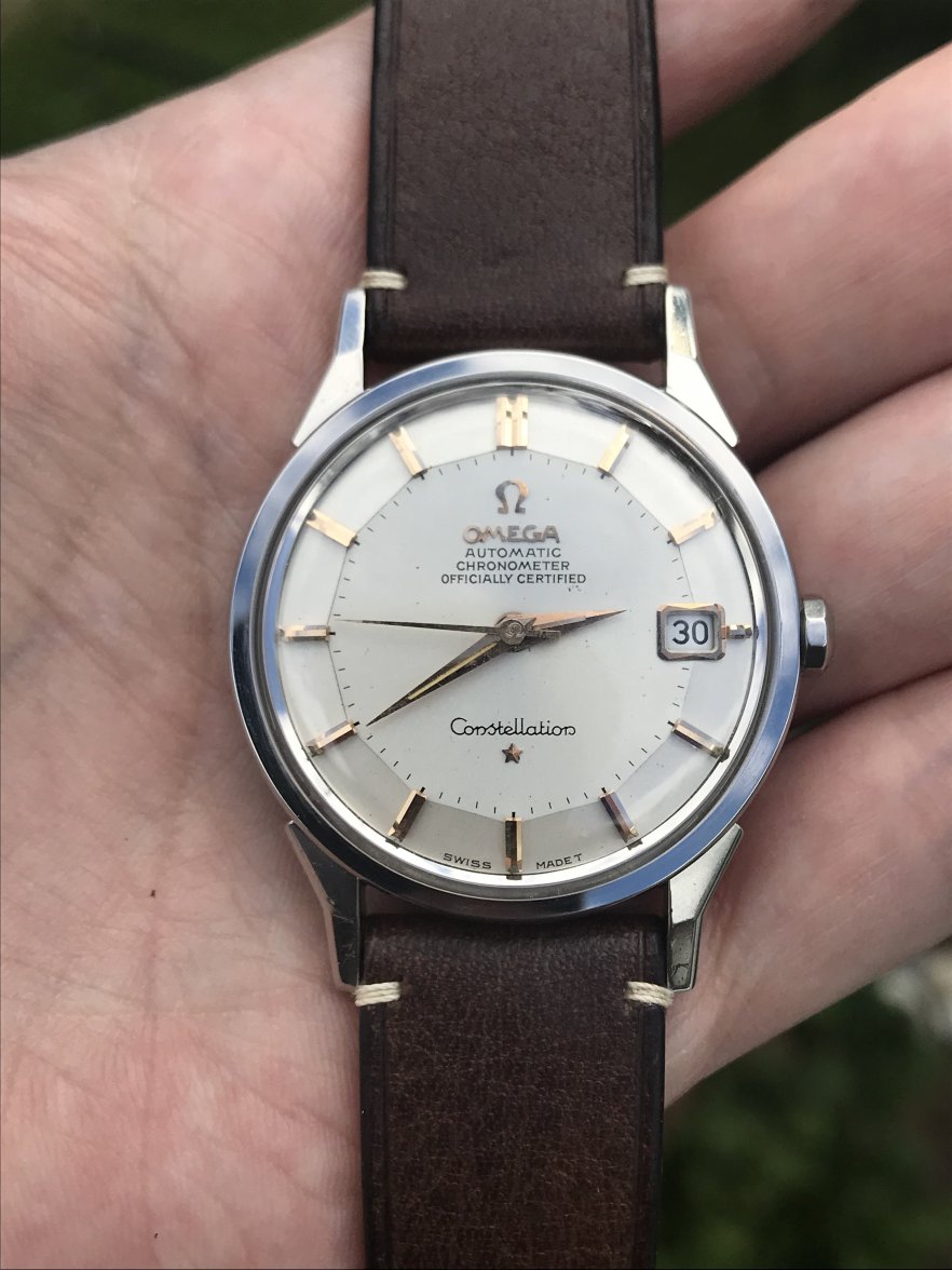

Not correct - should be dauphine like the below. Also, case is quite polished, crown is incorrect, and dial seems to have been poorly cleaned. It may also be missing the bezel? I’d pass on that one.

Correctly pointed out by @seekingseaquest this one is a clear pass!!
Despite the fact that there should be dauphine hands on this watch:
If the hands reach over the minute markers they are wrong to the watch (99 % at least)
+1 The star is too big should not be so close to "Constellation"

Thanks very much for your response!! I'll pass and keep looking.

Thanks so much! And by the way, yours looks very nice, congrats!
