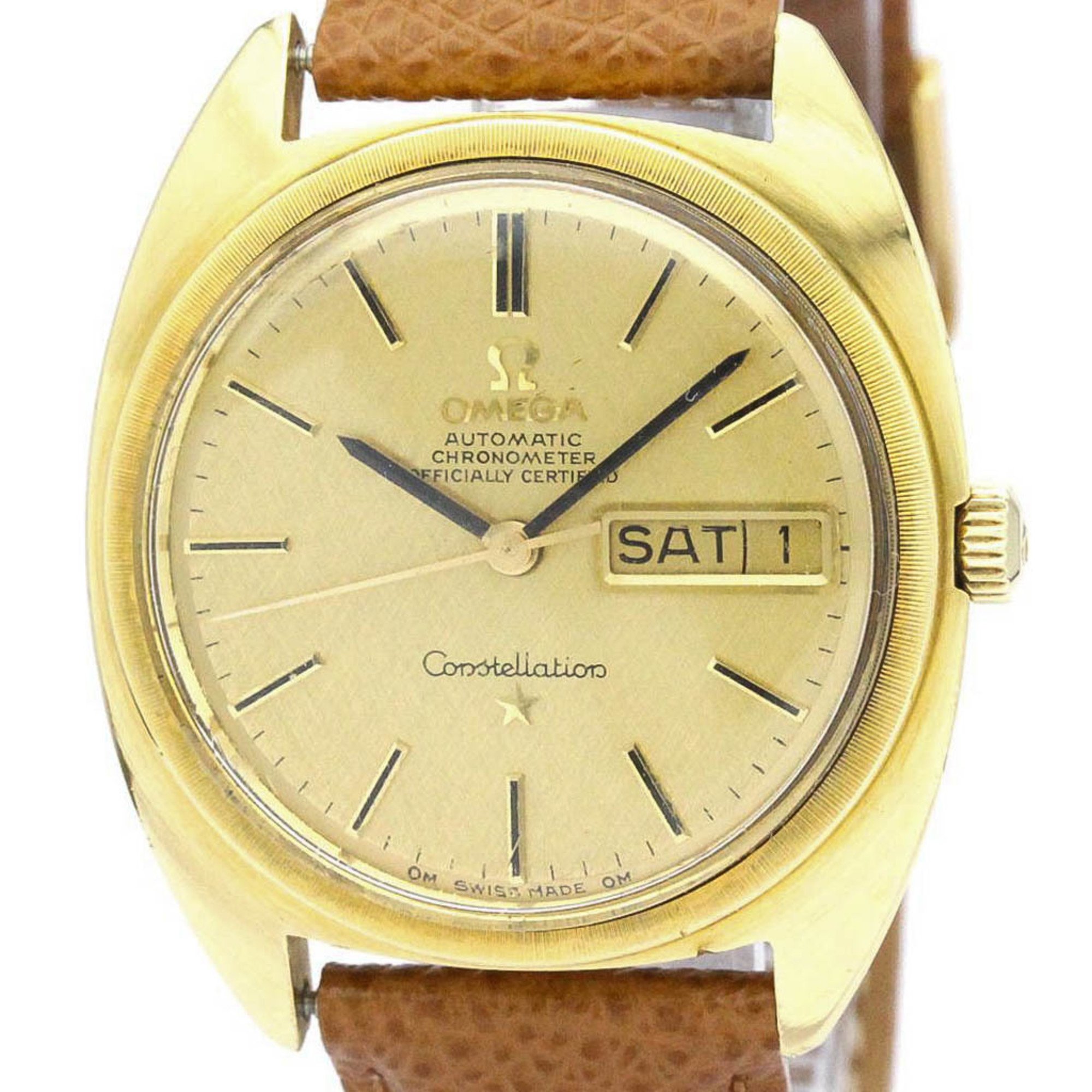

I’m potentially looking for an English day disc for a 168.019 C-shape similar to this:
I assume one searches for these via caliber (751) vs. reference number? And does anyone know if they’re still available, and a part number? Many thanks.

I'm far from an expert, but usually I try to find the parts numbers using caliber guides and search for them by prefixing with the base caliber. In this case the base caliber is 750.
The small day wheel is 750 1516. The bigger date wheel is 750 1580. There seem to be listings on eBay for both.
Hope that helps.
30,290
78,191
Day disks for the 751 are available in English, in silver, yellow and pink.
Yellow is 72207501516AJ.
Yellow date indicator is 72207501580J.
Sometimes the shade of the colours can be different from the vintage parts, so if you want the day and date to look the same, you might want to consider replacing both at the same time.

Excellent. Many thanks.
