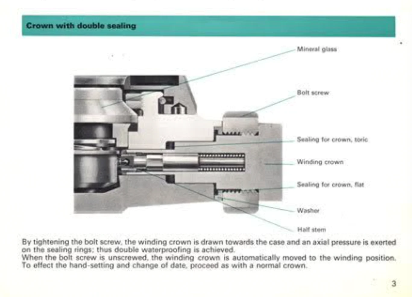

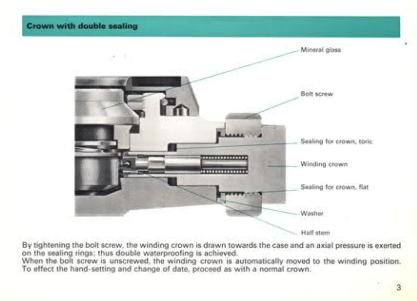

I googled, but couldn't find a schematic for a Omega screwdown crown, except the Ploprof, which seems unique. I'm wondering if when the crown is screwed down, it compresses the o-ring against a surface, improving the seal. Or does the o-ring seal the same way on the outside of the tube regardless of the position of the crown?
30,218
78,020
The only compression is the fit of the O-ring to the outside of the case tube - that doesn't change when it's screwed down.
24,816
55,164
Thanks, Al, that's interesting.
For those who might be interested, this is the schematic I found for the Ploprof, which is obviously very different. Instead of turning the crown, one turns a threaded ring that pulls the crown inwards. From the schematic, it appears to me that the o-ring is compressed against the bottom surface when the crown is drawn fully inward, and I'm guessing that's what is meant by double sealing/waterproofing. I'm inferring that since the crown is not rotating as it compresses the o-ring, it avoids shearing the rubber.
