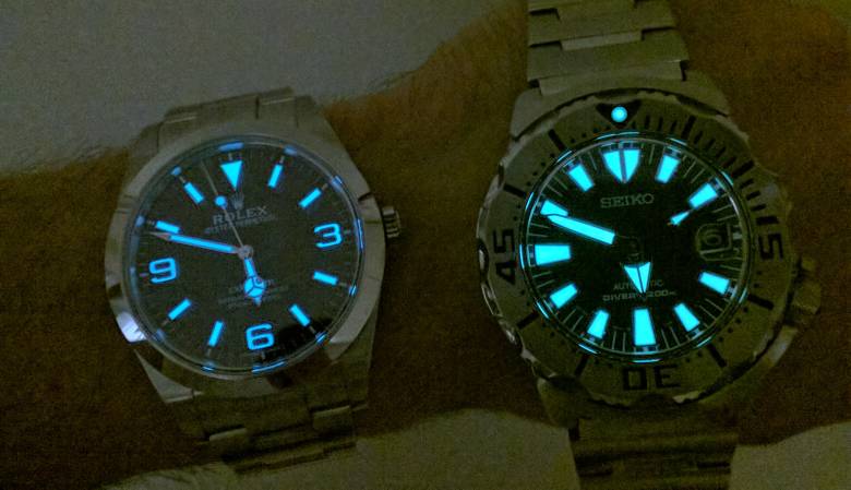

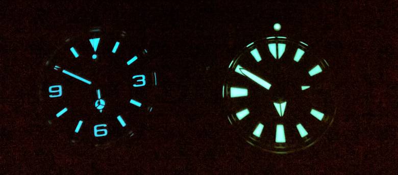

I wonder if it's because Rolex and Omega are now considered "luxury" watches whilst the Seiko is still regarded as a "tool watch". Given the much lower cost of a Seiko, I wouldn't be surprised. You'd be a lot less heartbroken if you accidentally dented a Seiko at work compared to a Sub.
Nope…..it’s about what they can see on their wrists better.
