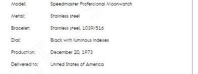

When someone orders a extract of the archives, is the entry in the Bracelet field an indication of the original bracelet which came on the watch or the one that is pictured in the images one sends in?
I ask because I ordered an extract for my December 1973 serial 145.022-71 Speedmaster Professional which I believe would have come with a 1171 bracelet stock. The picture I sent in had the watch on a Forstner flat link which is what the watch came with when I bought it used.
The archives extract indicated the reference number for the OEM flat link bracelet (1039 I think). The question is if Omega saw the Forstner bracelet and thought it was a 1039, or did my watch originally come with a 1039?

USA. See snapshot of archives below

I just received an archive extract back for a customer that I'm servicing the watch for. It's a 145022-71 delivered in December of 1972 (to the US). The extract states that it came on a 1039/516. The photos sent with the extract request were head only, so no bracelet was shown.
This tells me that they do have records of what bracelets went on these watches. So it's very possible that they used records for yours, rather than the photo. But again this illustrates the "challenges" Omega has created by asking for photos...a true extract from the archives would not require a photo, just a serial number...
