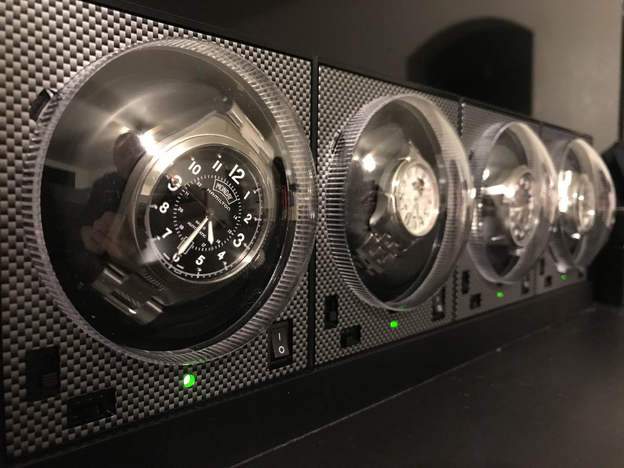

I use a Heiden Quad winder. Very little noise and reasonably priced. Maybe I'm the only one, but I get annoyed having to wind / set my favorite casual automatic the two days a month I actually get to wear it. And I rarely wear the same watch two days in a row. But four watches? I can keep them in rotation 4 at a time馃榾

I've had a Brookstone Quad winder for 5 years in my bedroom and still quiet.
